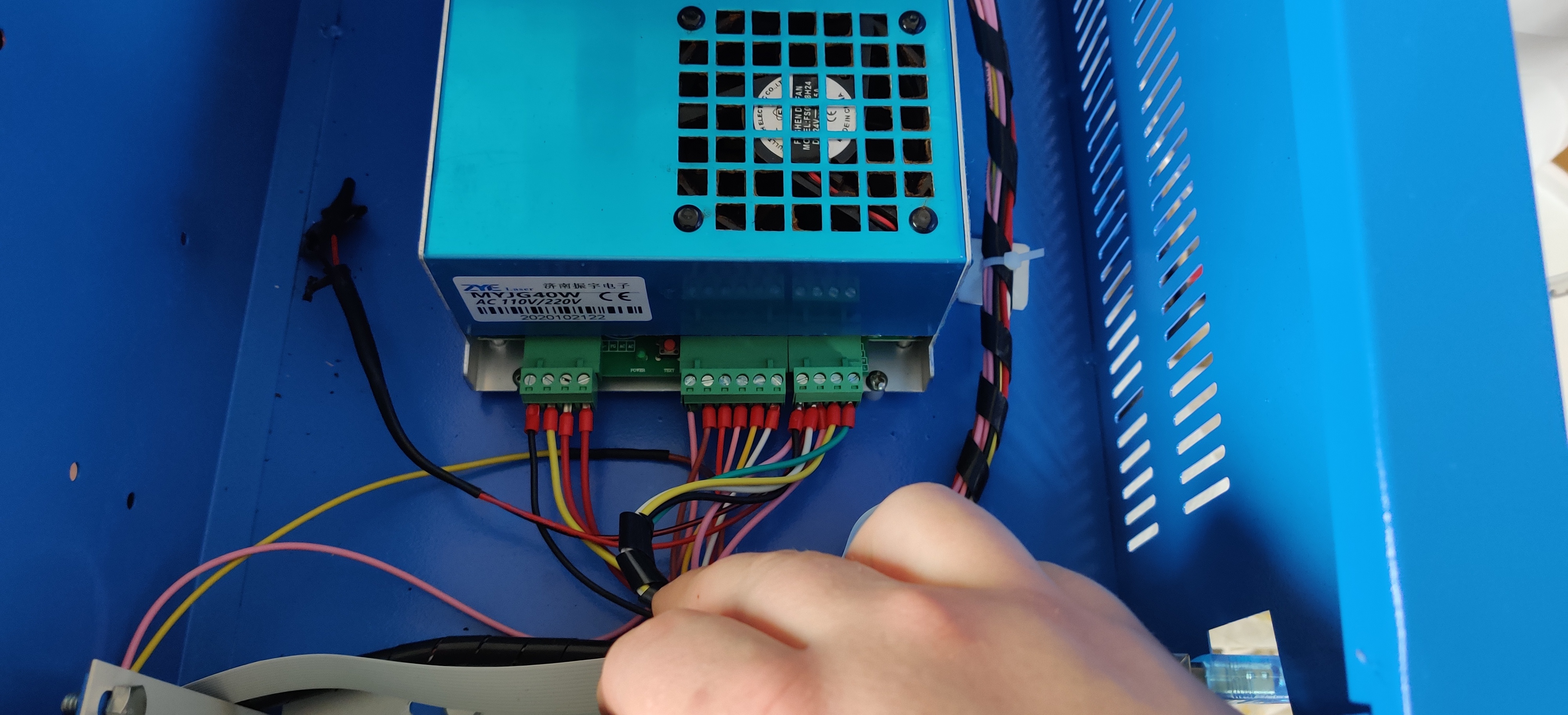

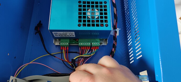

  3. Pictures of wiring in and around the LPS.

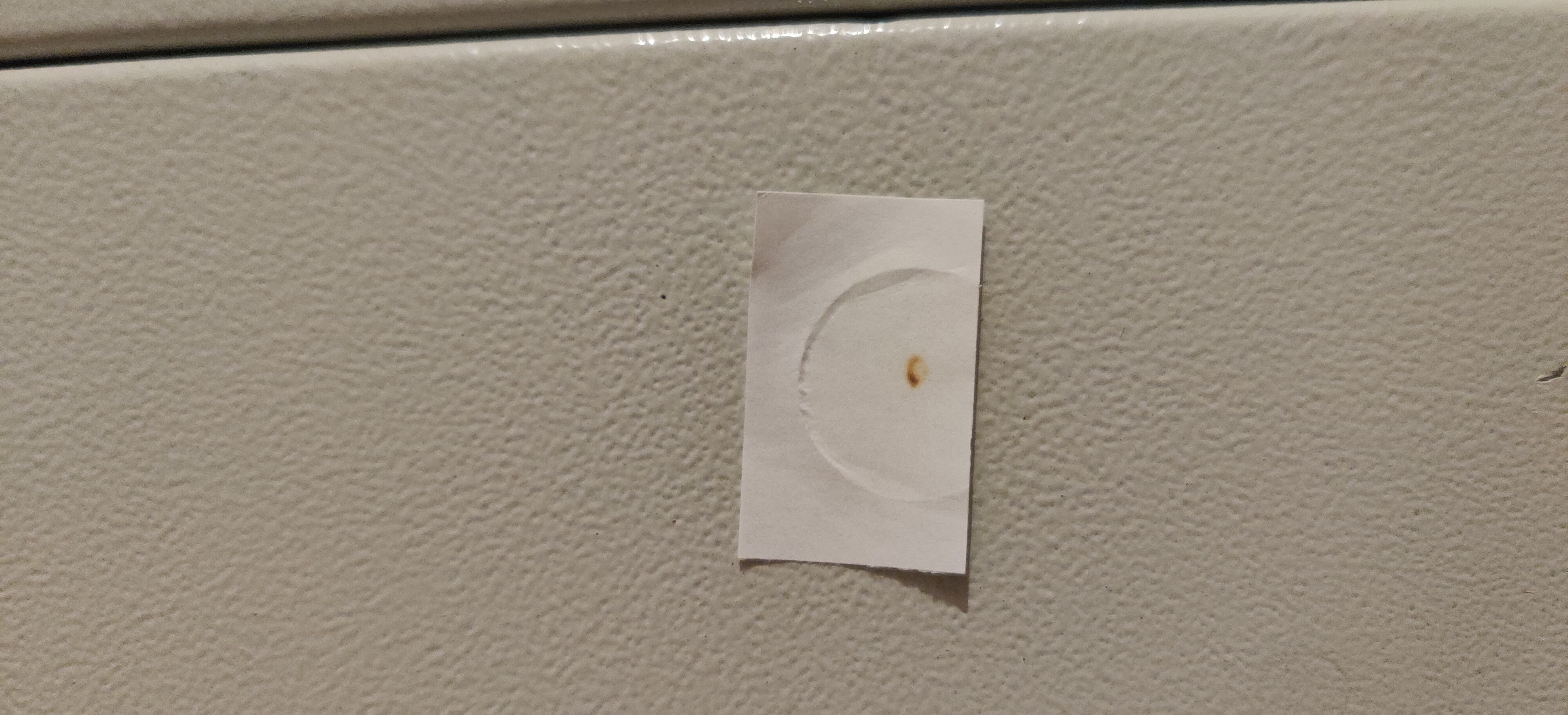

  4. Picture of a dot on “post it” taken at the 1st mirror.

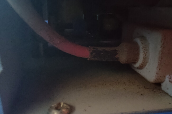

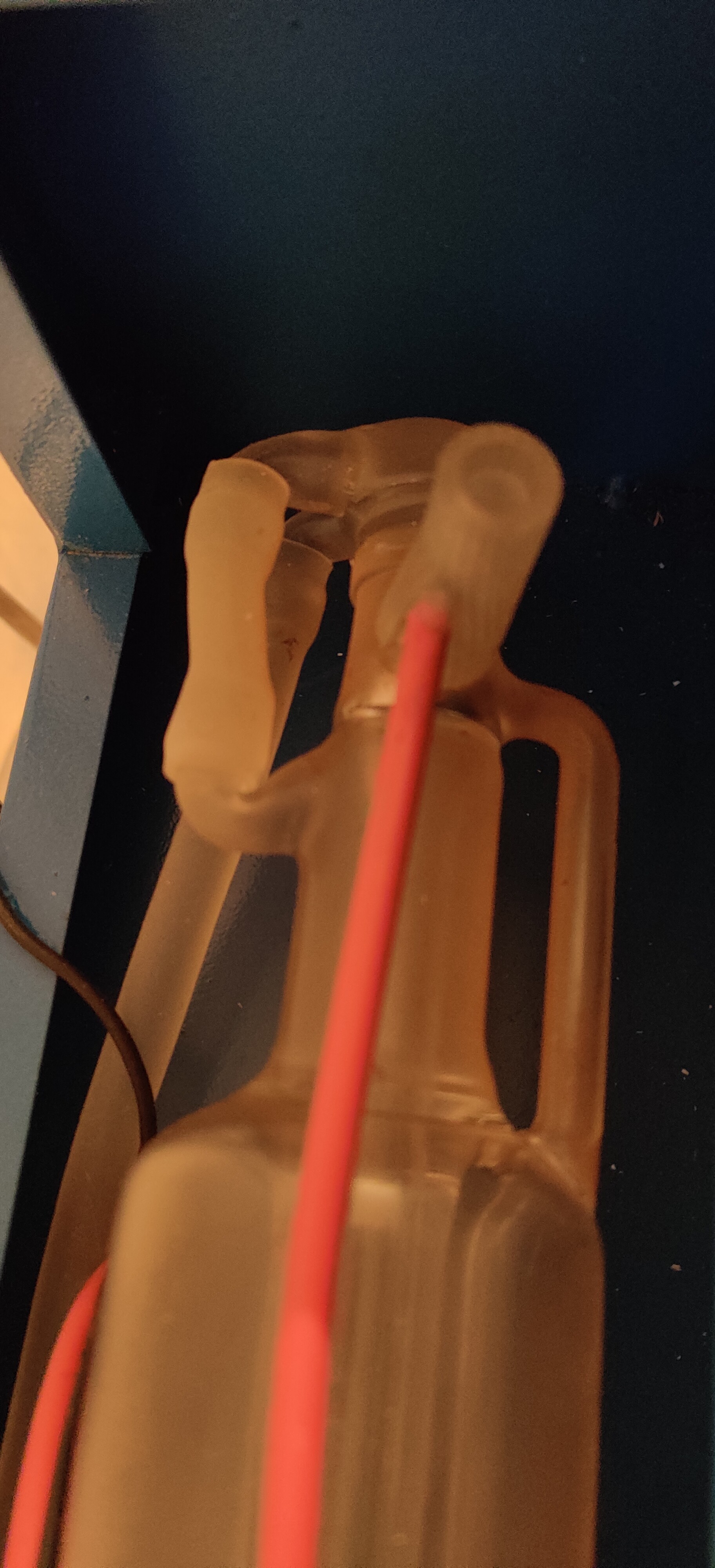

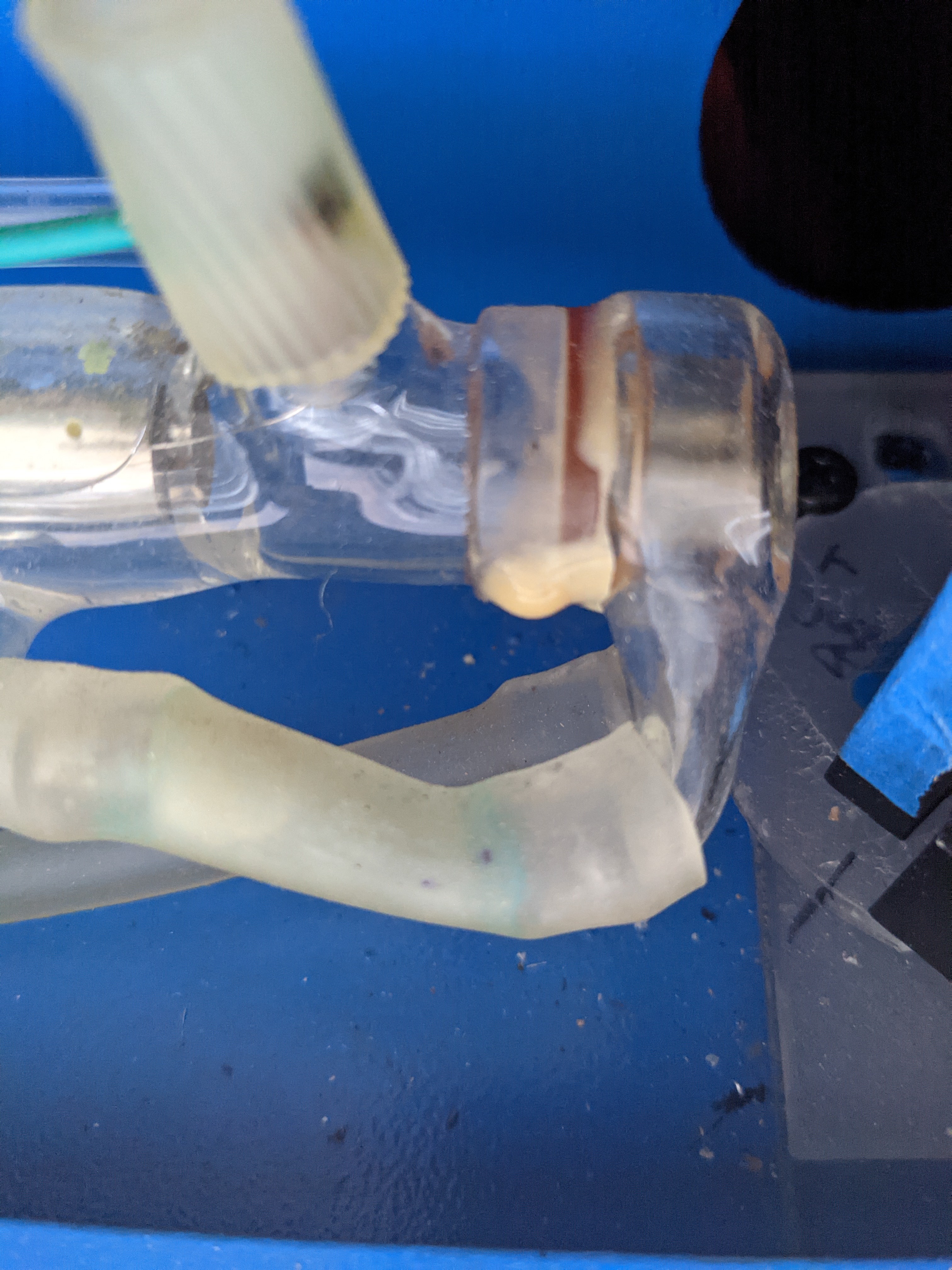

…if the arching you are referring to is that jump the beam makes at the anode ring shown by the red arrow …
then … that can be normal.
Why did you include this picture?
Is it arching there…?

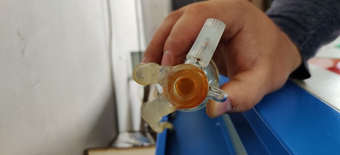

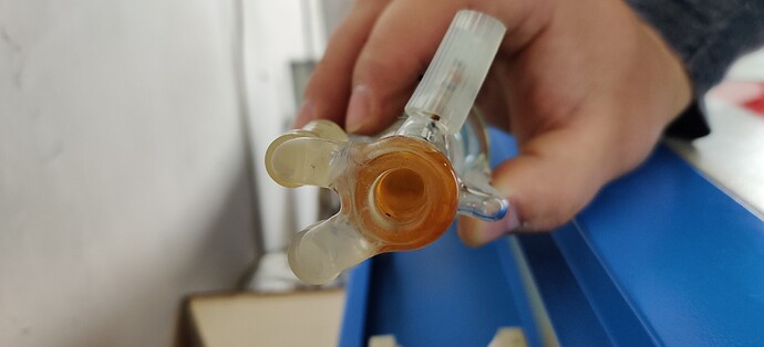

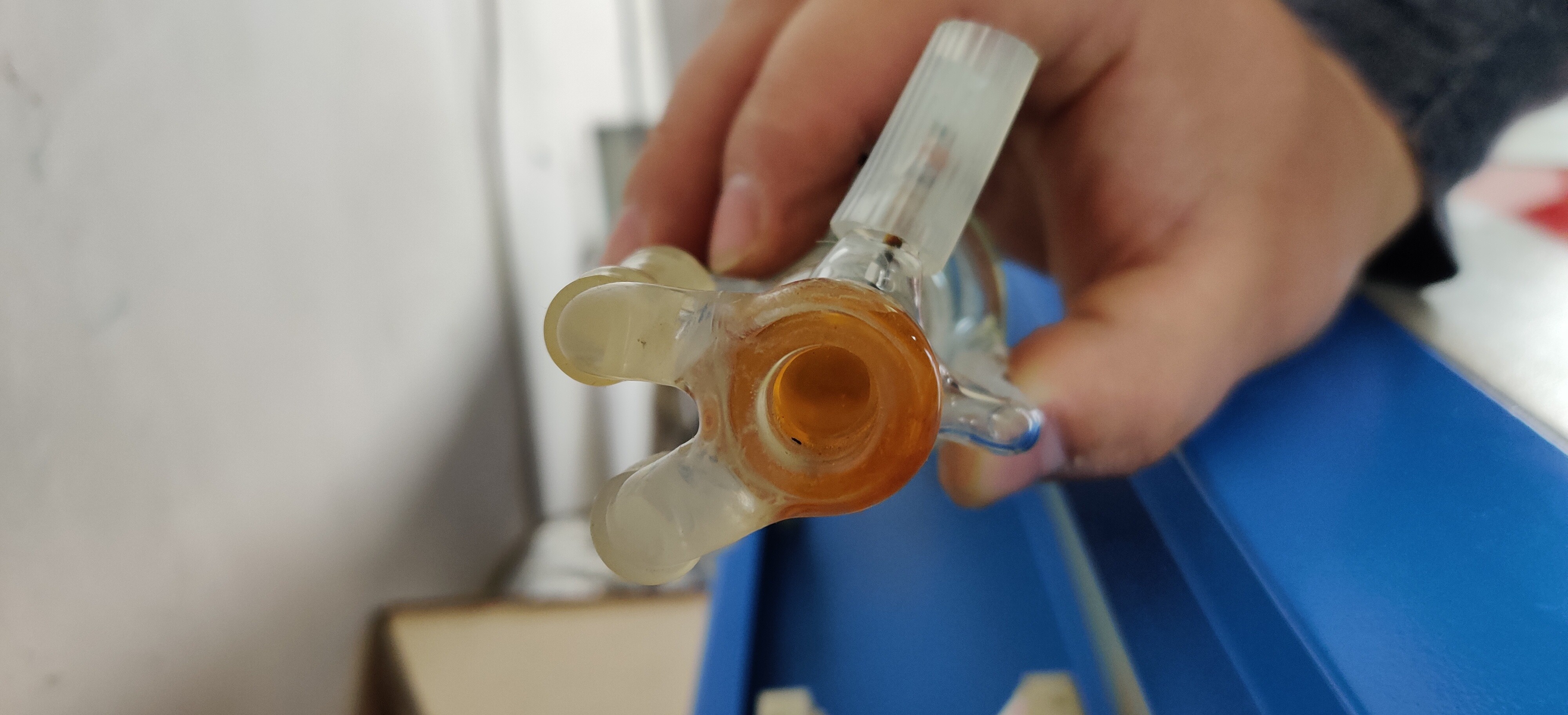

The output mirror of the laser looks discolored but it is hard to tell, at this wavelength, if it affecting anything. Perhaps it’s just a stain in the water jacket that is making it look like that.
My tubes output mirror:

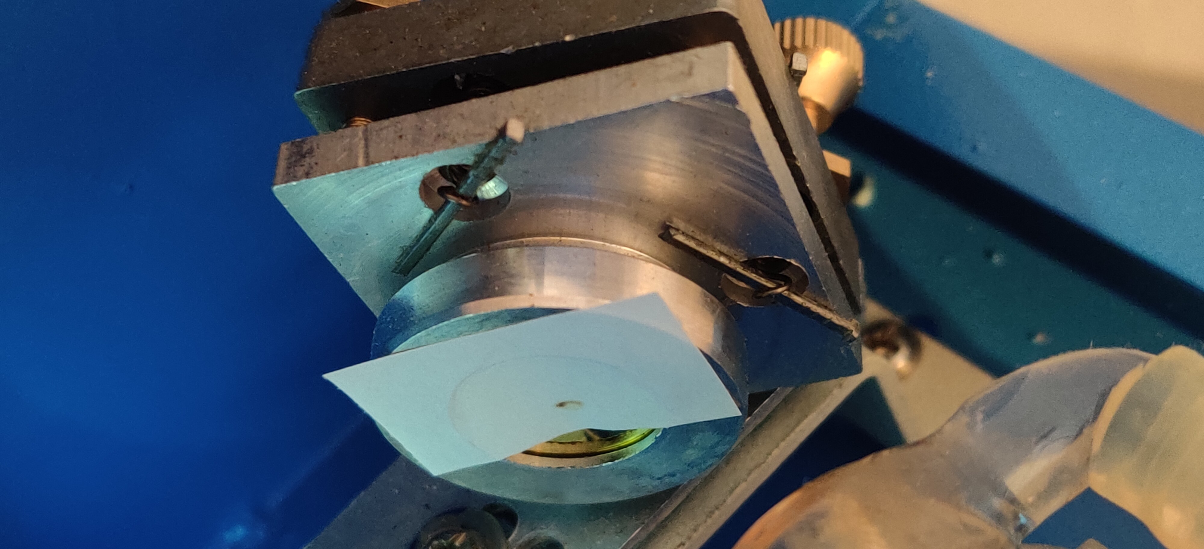

What does the beam look like going into the first mirror?
Image a spot on a PostIt at the first mirror and post a photo of the result here.

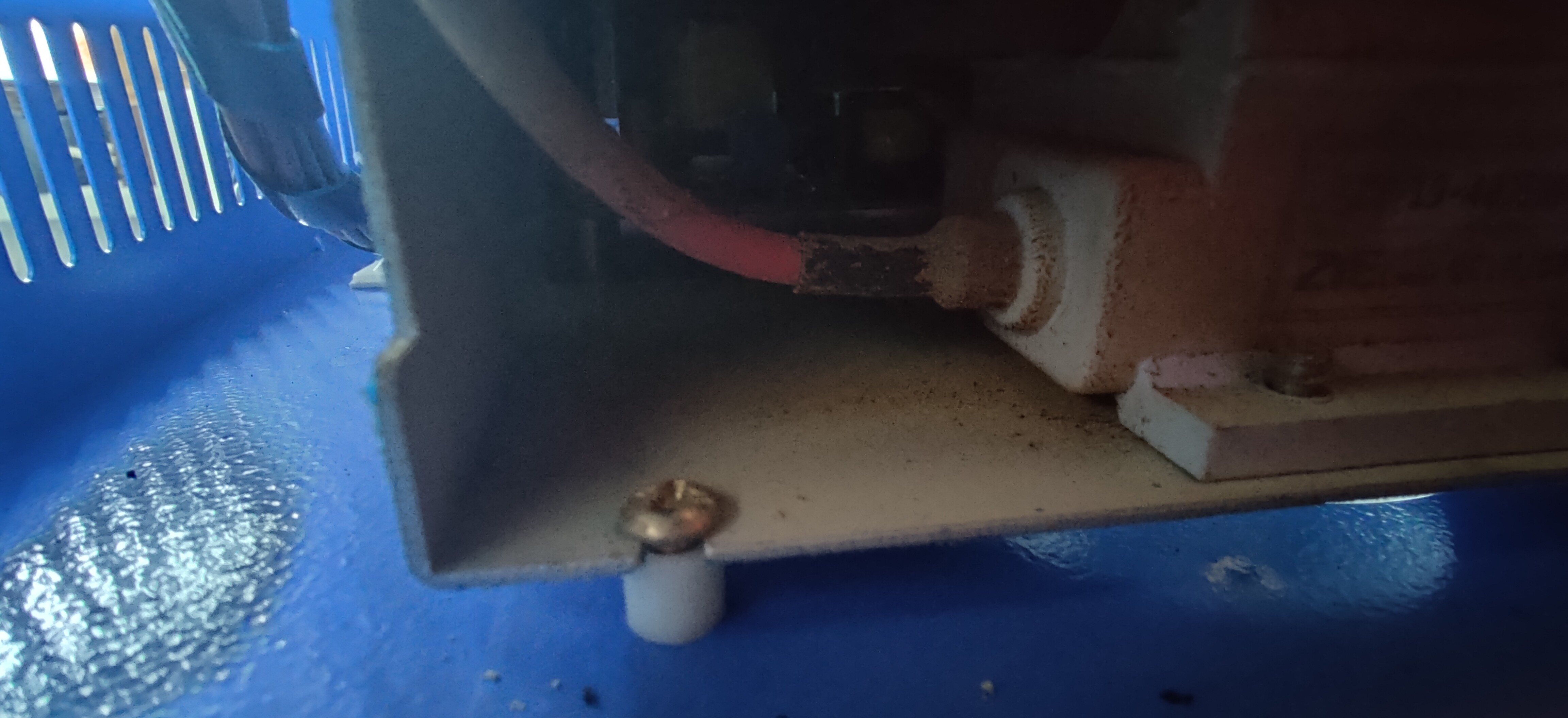

I hear hissing in the background at about 1:02–1:03 in the attached video. This may suggest a bad LPS.
It is hard to tell if the tube and/or the LPS are bad in these situations.
  • Suspicions are that using tap water damaged the HVT in the LPS.
  • Screeching/hissing and a ticklish water tank are normal symptoms of overly conductive water.
  • The poor grounding made the problem more obvious but IMO it did not create the failure. The water did.
We constantly warn users that conductive water can damage the LPS. Most ignore that warning…
Summary:
If I were to guess as to what is wrong it would be that the LPS is bad and the output HVT is arching. The arcing is less now that grounding is improved and the water is distilled but it’s still a problem.
I don’t think the tube is bad but I could be wrong. Usually bad tubes are associated with violent arch from the anode, unusual plasma characteristics and low or erratic cathode current.
I suggest:
  • Show us a picture of the output beam and if it is properly formed then that is further proof the tube is ok.
  • Ensure that the black wire on the cathode is connected to ground. It should be connected via the leftmost pin on the LPS usually labeled -L. I would simply verify that the cathode wire (black) is connected to the LPS and with a meter verify that that pin is actually ground.
If the output beam and cathode connections are ok the I would buy a new LPS.

but sometimes it hits dead center and I can see power increase when it hits flywood.

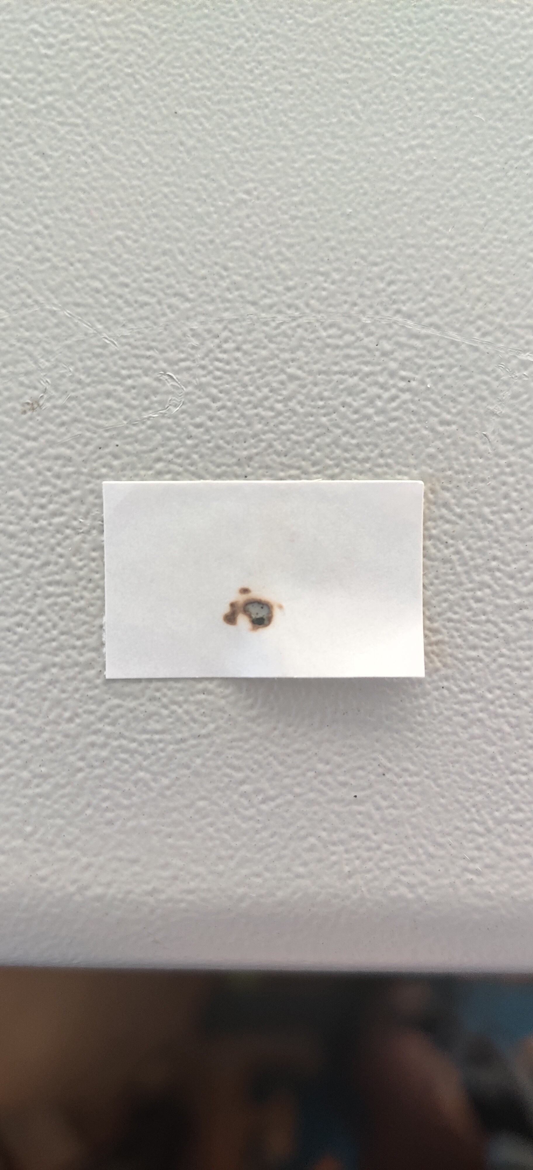

… it’s hard for me to see that spot to tell if it’s normal.
I am looking to see if it burns as a solid dot or a doughnut?
Can you do a 1-sec burn on PostIt note then take it out of the machine and post a picture of it?
Yes, it has the shape of a doughnut… BUT at first, when I started cutting it had also, but it mysteriously disappeared and became a round dot.
We need to see a clear view of the dot to be sure.
That picture being at an angle I can’t tell.
I am sorry sir, picker wong picture…
It was few seconds burn at 9% of power
Do the same at 40% power please.
9% barely ionizes the tube…
Doesn’t seem good… But like I said sometimes it hits dead center, but I can take picture of that spot because it rare thing.
if its arcing like that either you are grounding a wire or tube is dead cracked and looking at last photo of arcing i would diagnose dead tube . just check your cables

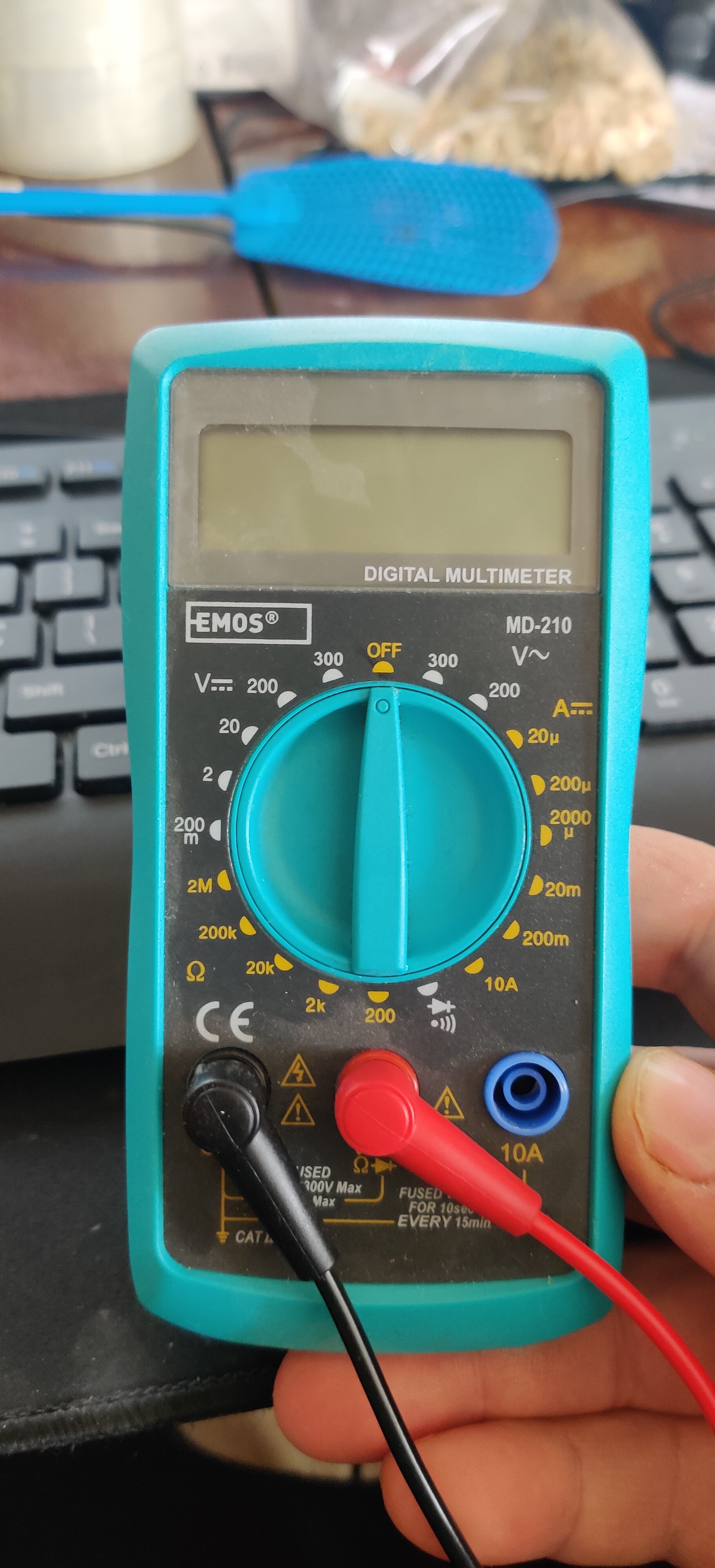

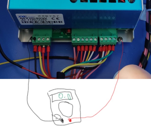

I have a cheap multimeter, but I don’t know to correctly check if the cathode grounded. I checked all wires and they look fine.

With the power to the machine OFF:
Put your meter on the lowest Ohms (omega) scale.
  • Put the black probe on the leftmost pin on the LPS.
  • Put the red probe on the screw that is fastening the LPS to the floor.
  • The meter should read close to 0hms
Thanks, it shows 0.00
Ok that says your tube is properly grounded.
I am not positive its the, or only problem but I would start by replacing the LPS.
