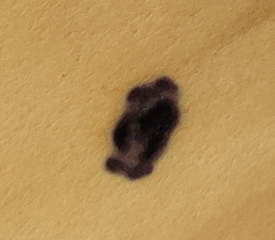

received new LPS, did a test shot at 45% and I am not sure if the beam is very nice. I bought a new tube as well, is it worth trying a new one?
Untitled
It’s a bit nicer than earlier.

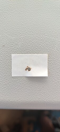

…at what point in the beam path are these taken?
from laser tube to the first mirror. Cleaned tube lens and it looks better. So might be a false alarm… Need to align everything, and check how it cuts :slight_smile:
at 40%
Definitely clean everything and do an alignment.

This is an image from tube to the first mirror
I tried to find focus, but it’s horrible…

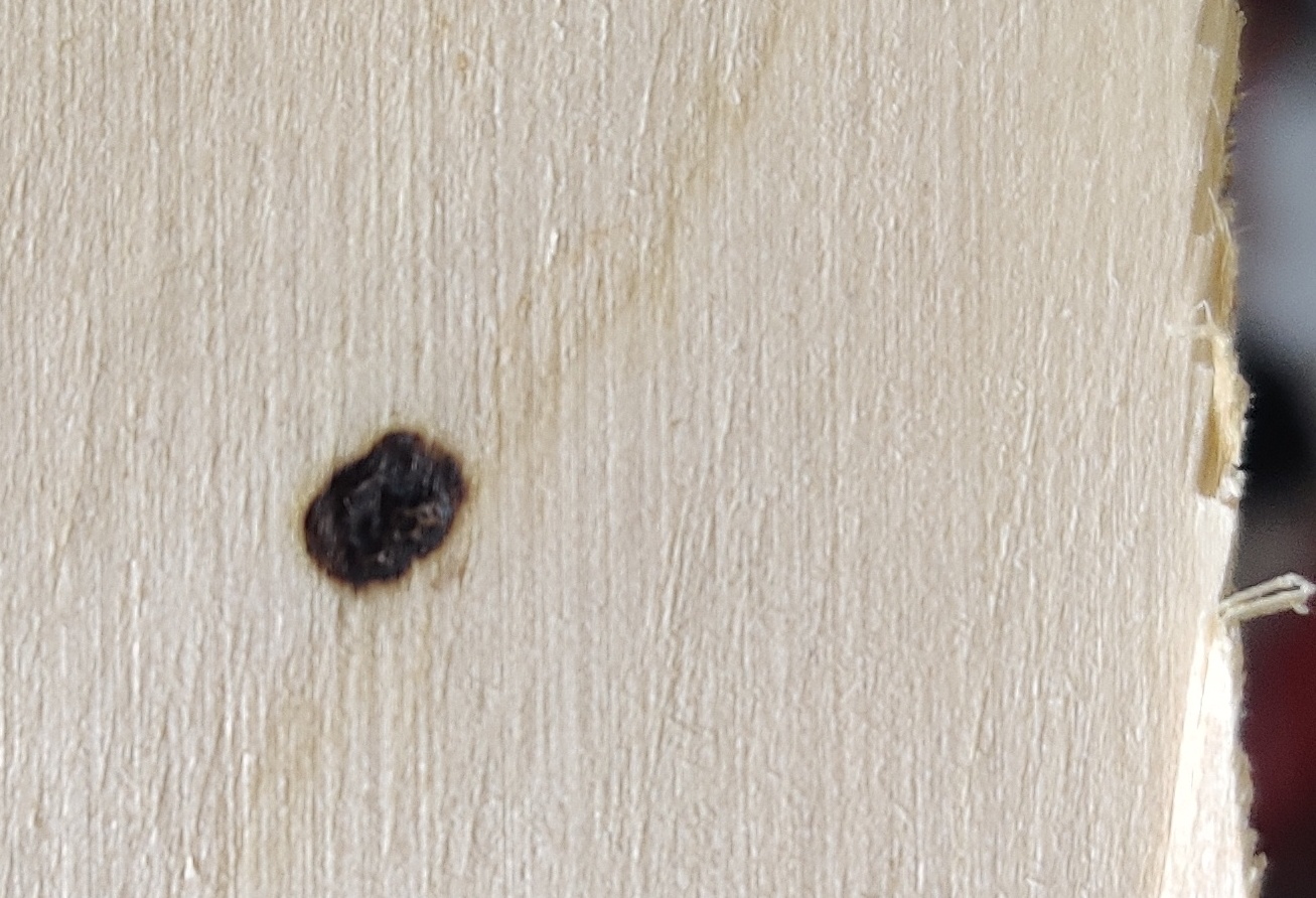

I use 3mm premium laser plywood. It used to cut at ~25% power, now it takes 65% and it leaves a mess…
Images below 65% (15mA), 8 speed, one pass. I am afraid to change the tube, because if it’s not helping I am f…
the beam goes center of the laser head nozzle.
beam now almost always goes two though the centre of anode ring.
