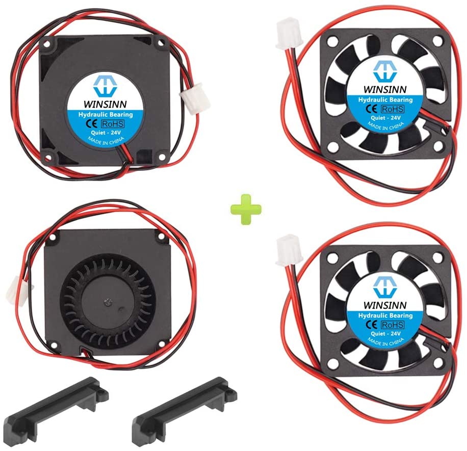

Supposed to be hydraulic bearings:
I wonder if I just needed to distribute some oil because I hadn’t used it for so long?
