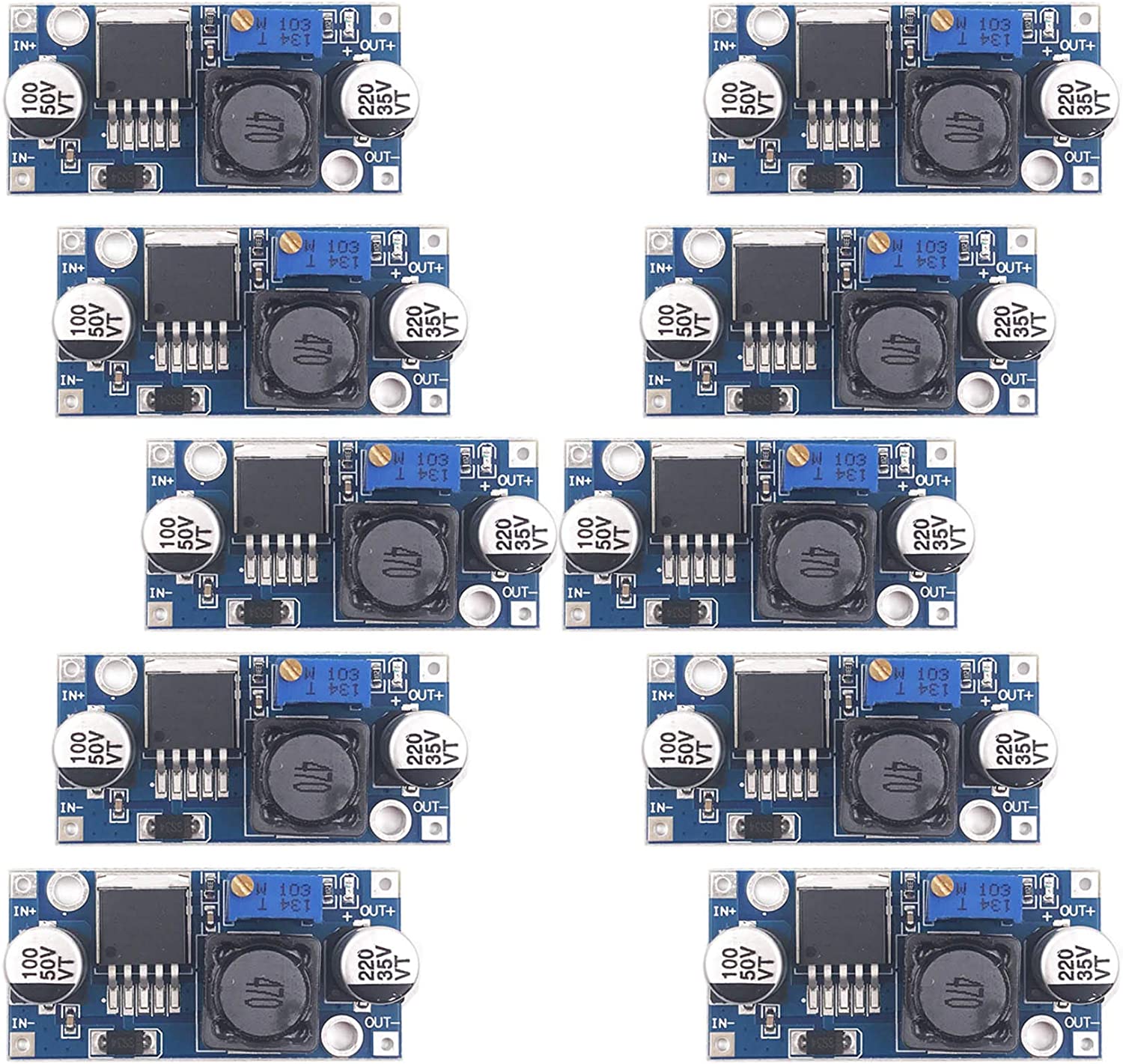

Hey everybody, I bought several buck converters on Amazon (HiLetgo 3pcs XL4015 5A DC to DC CC CV Lithium Battery Step Down Charging Board Led Power Converter Charger Step Down Module) over a year ago they worked fine back then. I could adjust the voltage down from like 12V down to 3v for my ESP32 like I expected.
But now I’m trying to do the same and none of the 5 I bought work anymore! I even opened sealed bags to try new ones. I twist and twist the voltage and current screws till my fingers are sore and the output voltage remains equal to the input. I don’t understand what happened! Did they all go bad at the same time? All 5 of them are now faulty? I know you have to twist a lot, but over 50 revolutions with no change whatsoever?

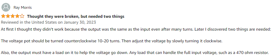

reading comments on an amazon product I noticed this:
All three boards I received tested good. As another purchaser mentioned, the terminals for POWER IN +/- and POWER OUT +/- are cheap and the screws are difficult to loosen. The potentiometers require many turns to make any changes to voltage or current, but this is desirable because it allows for minute adjustments. Ensure that voltage is adjusted BEFORE connecting a load to POWER OUT +/-, and current is adjusted AFTER connecting the load. Additionally, do NOT connect a load if the board is not powered because you risk damage to the circuitry.
I also saw this in the comment section on Amazon. :man_shrugging:

It does seem to be a cheap product one of the pots moves easily when I push it. I went ahead and ordered this one that had good reviews:
