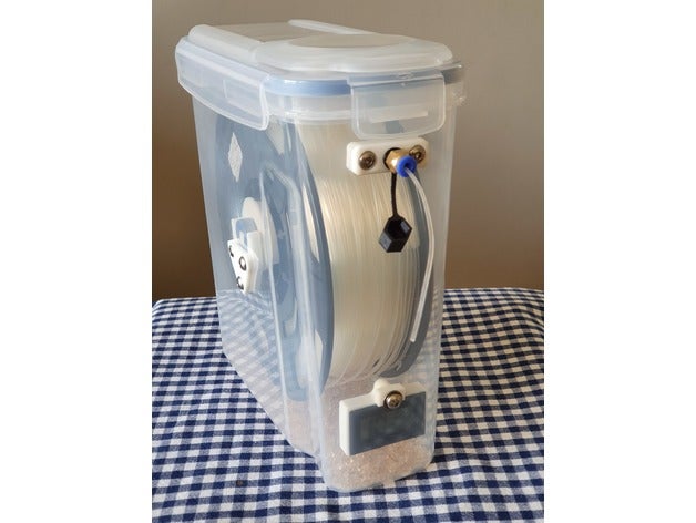

I have used this for a few years. Works great and is pretty easy to make:
Uses a Rubbermade 21cup container, thread in a 4mm pushlock fitting or bulkhead, print a bearing spool roller for the bottom, add refreshed desiccant packs you get packaged in new spools.
Container example: https://www.acehardware.com/departments/home-and-decor/kitchen-utensils-and-gadgets/food-storage/6192892
Printed Spool Roller: https://www.youmagine.com/designs/simple-200mm-to-125mm-rolling-od-608-skate-bearing-spool-holder
