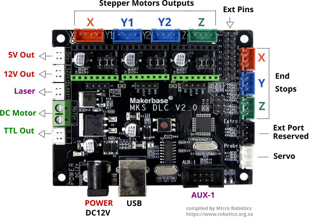

MKS DLC V2.0 needs to be driven over USB; it doesn’t have storage of any form.
I don’t have an MKS stepper breakout board. I don’t see why you would need one. The MKS DLC V2.0 has the signals brought out on a separate header right next to the step stick headers. The breakout is for boards that don’t have headers to break out the stepper signals. I have an MKS DLS V2.0 and I have the stepper motor drivers connected directly to the headers.

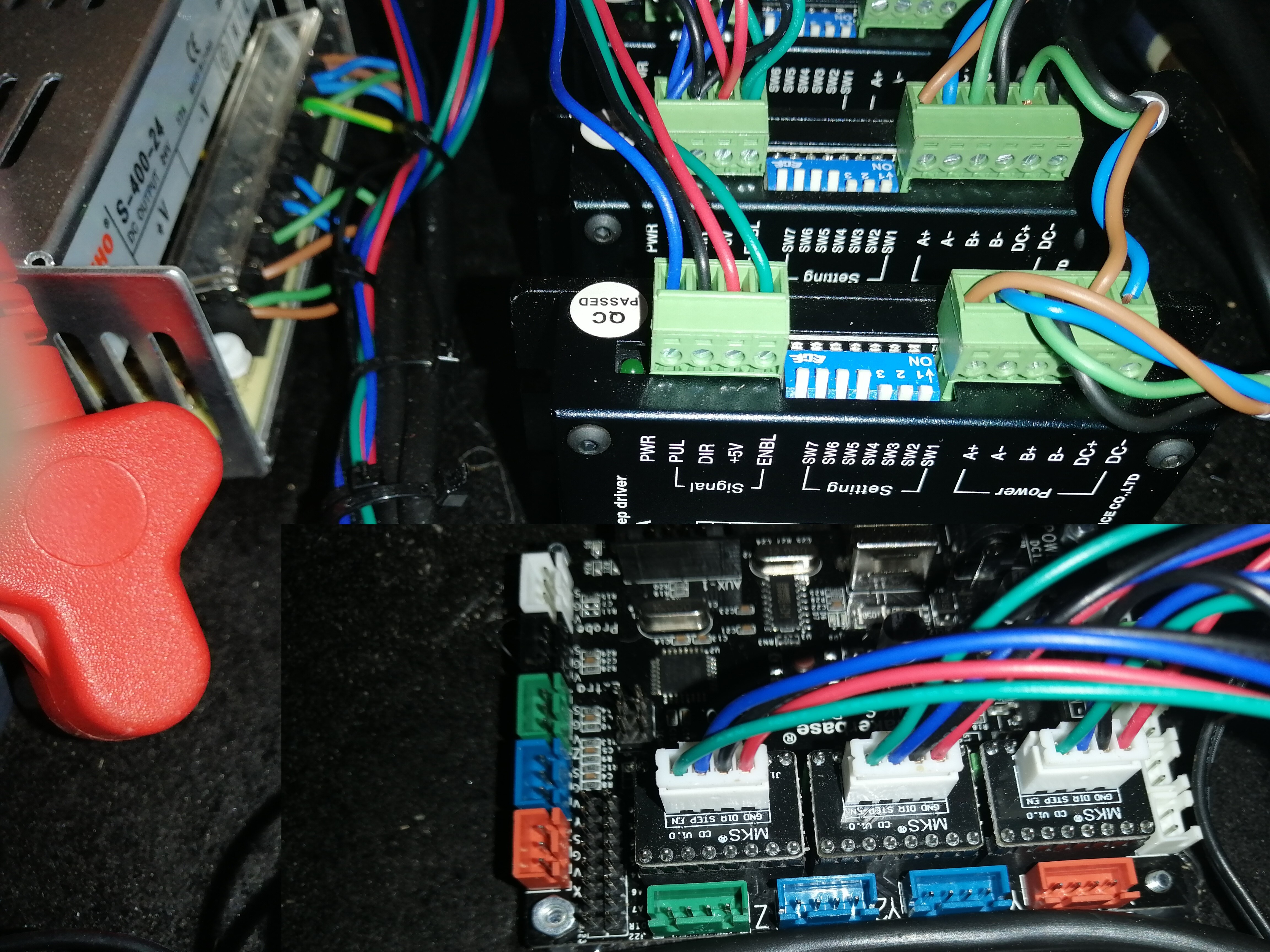

Hi
The problem is. It only have 4 pins out. I will sent a foto.
No idea then. If it were mine I’d ditch the breakouts and send +5V to the pin labeled +5V and build the firmware to use open drain for the signals — but I don’t have any documentation for the stepper drivers you are using.
Given that your supplier suggested you buy the breakouts to replicate the pins that already exist on the board, it seems possible that they also got something else wrong.
Look at those groups of four pins directly underneath the green header blocks for the step sticks labeled EN STEP DIR GND:
Those are the same connections that the breakout boards are providing. The breakout boards are for other control boards that do not provide those four pins already.

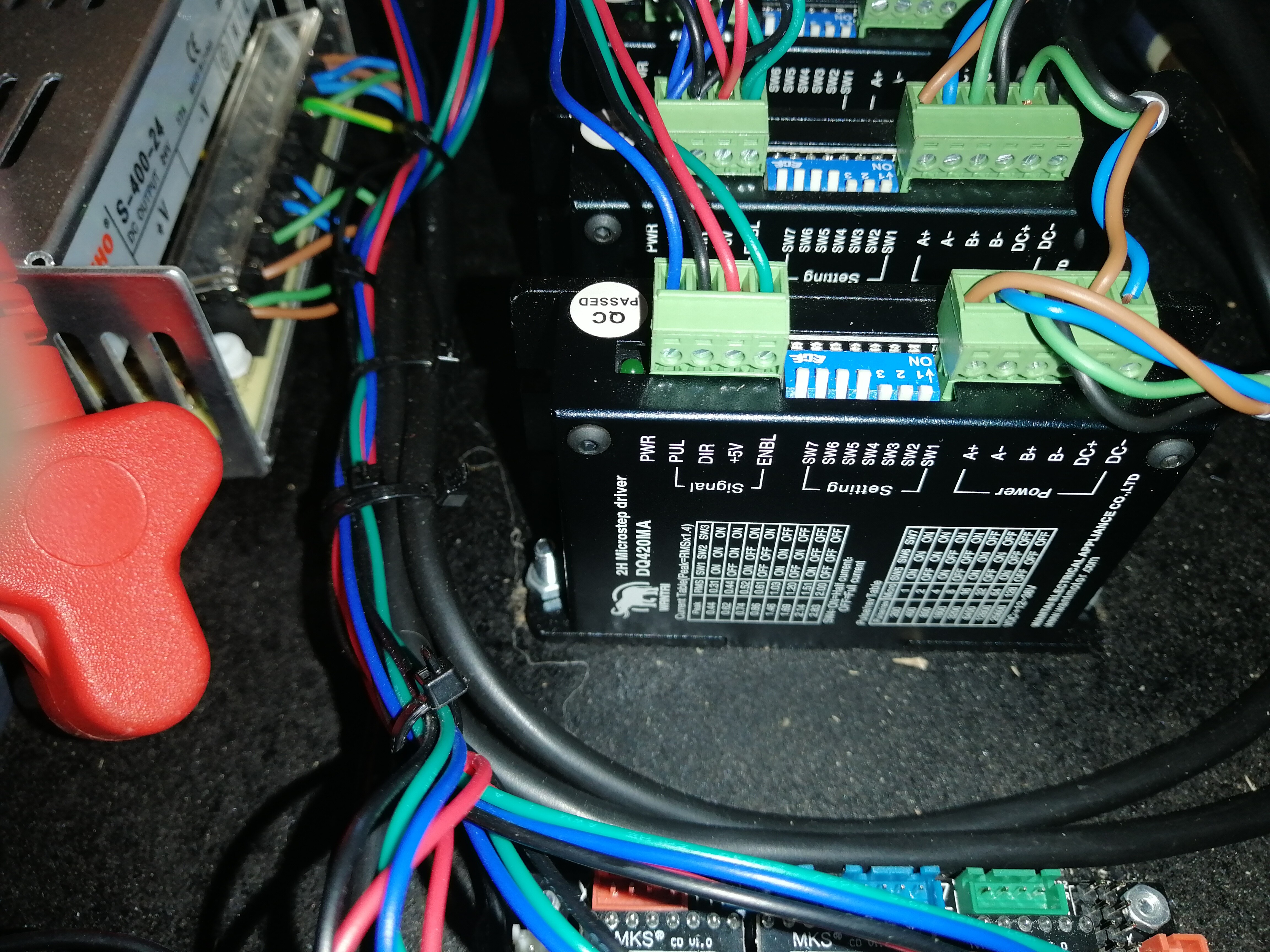

Am I seeing this right?
GND on the MKSCD is connected to 5V on the DQ420MA??
If so the 5V for the DQ420MA optocouplers are at gnd and won’t work.
Also, wondering why there are 2 wires in the same DM420MA connectors on the other axis drivers?
----Wiring table -----
From PinName Wire color To Pin
MKSCD EN Green DQ420MA ENBL
MKSCD Step Blue DQ420MA PUL
MKSCD DIR Black DQ420MA DIR
MKSCD GND Red DQ420MA +5V

Thanks for all your input. I have also thought that the GND to the +5v does not look right. As my commonsense as electrician it is not correct to connect GND to a positive it will cause a short. I even have the suppliers technician here for six hours and he did not came right ever. And he have advice to exchange the DQ420MA for the BT6600 drivers. He could not get one axis to move. Thanks for all of your advice it help me a lot. I will need the wire diagram for the bt6600
Nothing is working you are 100% correct how will you suggest I must connect. I think to remove the GND and connect the 5 v from the MKS DLC to the +5v. Will that work. I also think the GND to the +5v could not be correct. I was advice by the suppliers technician to swop the drivers for BT6600 after he could not get it to work

It can work if the firmware you are using is built in open drain mode. Otherwise it won’t.
The grnd to 5V is NOT correct. The 5V is an input to the drivers so having it grounded should not have created any damage …
You can pick up a 5V at the connector in the upper left side of the board
