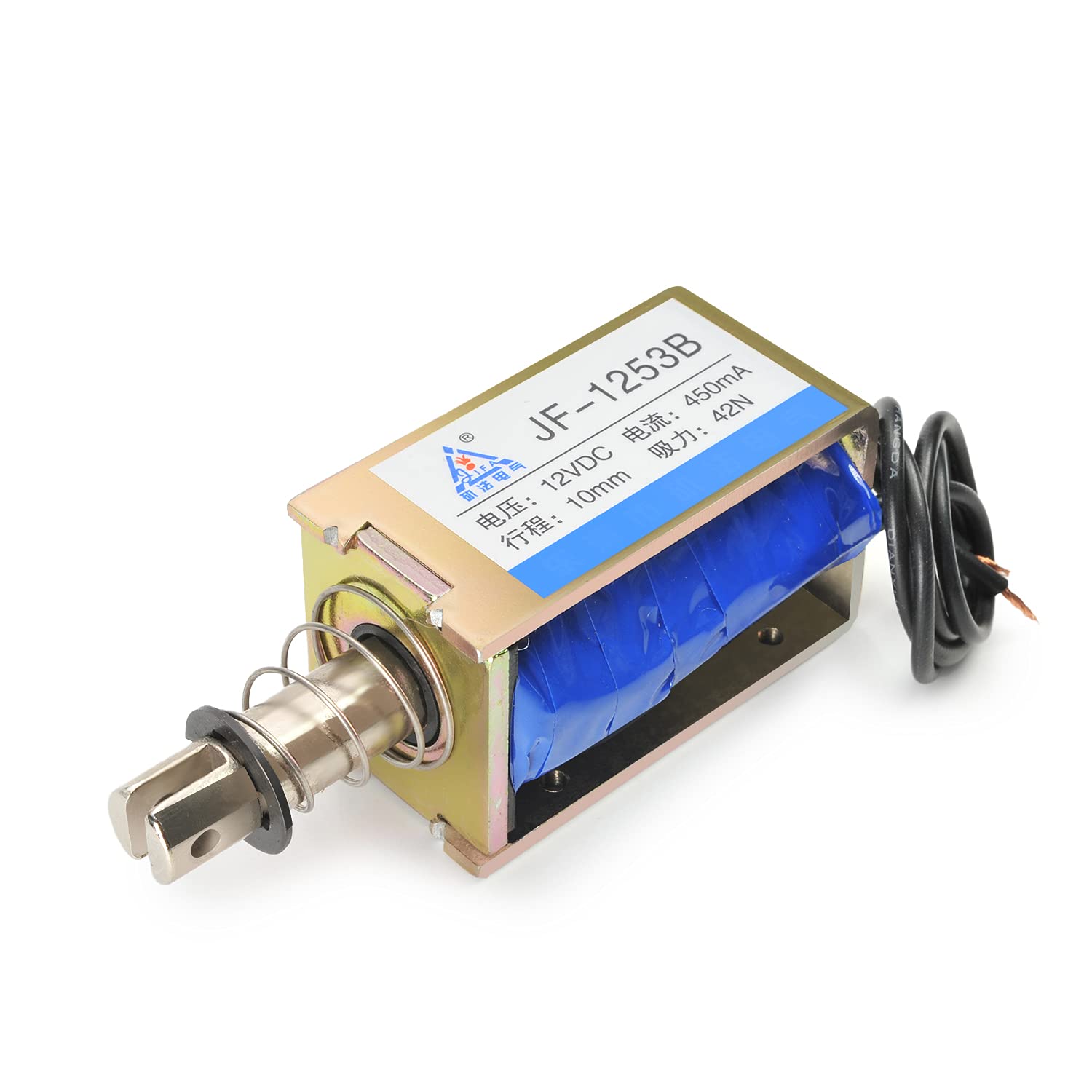

Another approach is to use a DC solenoid combined with a lever to provide a mechanical advantage.
Solenoids may provide a smaller footprint than motors. Assuming you need a fast & high torque but not a huge displacement solenoids may be ideal.
I did not do the math so this is only conceptual.

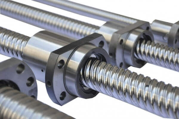

HalfNormal: I thought about ball screws, but I was concerned about pressure on the nut moving the motor, so braking is required. Since most strings, most of the time, will not be resting at either endstop, having a solid ability to stay at a given position in the middle seems really important. It looks like this is something the imgur guitarist above didn’t have to worry about with his servo setup. Braking sounds like a pain, but maybe it isn’t?

donkjr: I think this is why a solenoid would not work either. Maybe if there is a way to keep a solenoid in a specific spot, but it sounds like it takes energy if it’s not at one endstop or the other. There has been discussion on the steel forums about the idea of measuring string tension, but as a player, I’m nervous about making the computer constantly adjust for my playing. For instance, when I pluck the string, the tension goes up briefly. I really don’t want the computer trying to compensate for that! I just want it to move the lever to a position, and have it stay there until I hit a pedal again. Similarly, I don’t need the computer’s help with actual tuning, although there are systems that do that. I’m happy to tune the instrument by hand.

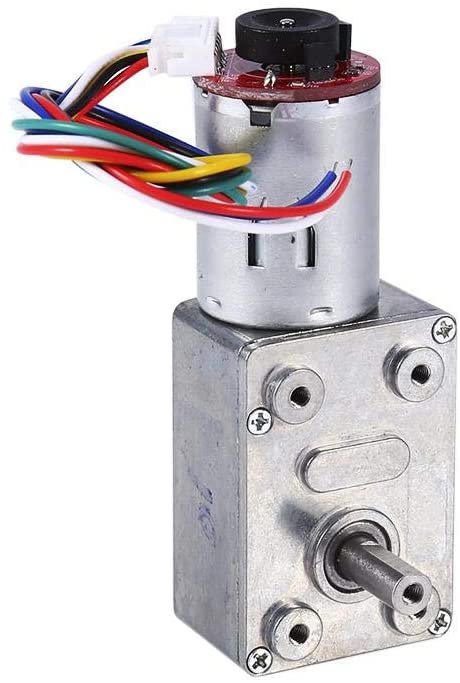

DougL: A small geared motor with both encoder and lead screw sounds really good. I haven’t seen the motors you described. I did try (but not too hard yet) to get my head around what was going on with the vertical CNC wall painter, as it sounded vaguely relevant. I will go study some more.

it has no positional feedback since it’s just controlled by the 2 DC motor power wires. You’d have to add your own linear POT and a micro controller to drive an HBridge for something like a custom servo control.
They do sell small linear actuators with PWM control but they are usually much more costly.

If you are using position feedback (closed loop system) and your mechanism can be back-driven, plucking the string will result in the feedback moving the mechanism to compensate and wow could that sound weird. I would expect this effect to be much more pronounced with a servo than with a ball screw; a ball screw will back drive, but not nearly as much as a servo which is constantly adjusting position.
A high gear ratio might damp this enough to not matter, but something based on a worm gear or fine-pitch screw is probably better than a high gear ratio. If you use a ball screw, you might want to use a stepper of sufficient torque. Then you wouldn’t worry about a brake. Note that you might have to consider intertia with a ball screw to need need acceleration planning with both acceleration and jerk (1st and 2nd derivatives) to avoid skipping steps; even if you drive the ball screw with a servo motor you would want to do the same planning to avoid overshoot and correction which might be audible.
This concern would apply to anything that is constantly measuring the angle of the lever to compensate, rather than adjusting the angle of the lever during a change and then locking it.

@mcdanlj Thank you for the in-depth explanation of how ball screws work and their limitations. Also thank you for the comparison to lead screws.

mcd: Well your thoughts are certainly a nail in the coffin for ball screws.

So far the worm gear motors I’ve seen have been quite expensive.
On a geared motor, it seems like for a quick response, I’d need a pretty high rpm on the motor, which means less gearing down. Still, the gearing would be minimum 6:1…

For ground vs. rolled, that’s for ball screws. I accidentally said it backwards before: Rolled are stronger and less expensive; ground are more precise (but you don’t need that). I just meant you don’t need the most expensive.
However, it’s not clear to me that you can get nuts small enough and still have the clearance you need, especially inexpensively. Thus trapezoidal lead screws probably win.

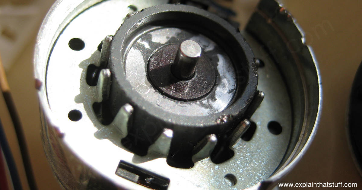

A DC motor will have much more torque for its physical size, basically because magnetic fields have inertia and a DC motor doesn’t have to change the magnetic fields as fast as a stepper. Also the DC motor has fewer poles than a stepper.
If you have a dead stepper, disassembling it will be educational! :smiling_face:

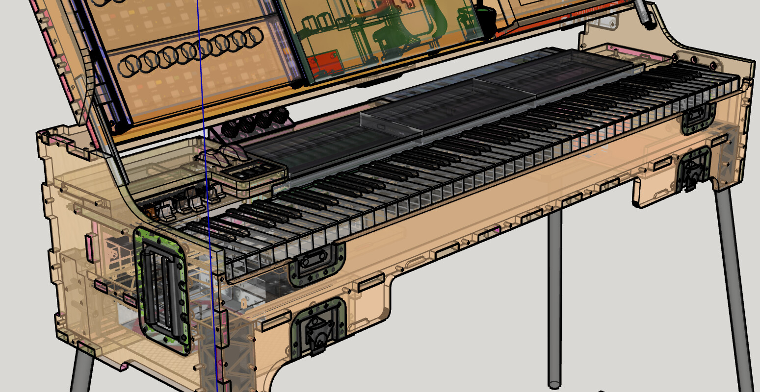

Just want to make sure you know that while sketchup is really easy to work with, it’s also modeling surfaces not solids, and therefore is easy to specify parts that are “non-manifold” and can’t turn into models for printing or CNC. Since you’ve done 3D printing you’ve probably run into this already?
Also every conversion I’ve dealt with coming from sketchup has had imprecise measurements and I’ve had to rebuild it in CAD to have precise and correct measurements.

these come in various sizes and RPMs:
That’s a nice motor/encoder.
Useful for my “gotta finish that” automated curtain project.
Not much interface data :thinking:
If referencing the link I posted, I grabbed some off ebay and have used them in my project to control them with stepper motor driver signals( Step/Dir ). Code is on github.
oh absolutely, I use fusion 360 once I get serious about a design. Before that I used openscad. But 360 is murder on a laptop because of the limited options for keycommands for navigation, which seems so ridiculous to me. And at this point sketchup is so FAST for me. I did actually make the CAD cutting plans for my keyboard in sketchup and they converted without issue. You have to directionally constrain every possible line, and type in all length values, and if you miss one, you will have lots of corrections to try to find later. This was done before I got a 3d printer:
If you are super careful, it is possible to make real stuff in sketchup, but yeah, its best for experimenting with ideas, mostly. I find if I get into fusion 360 without a really clear plan, I get nowhere.
