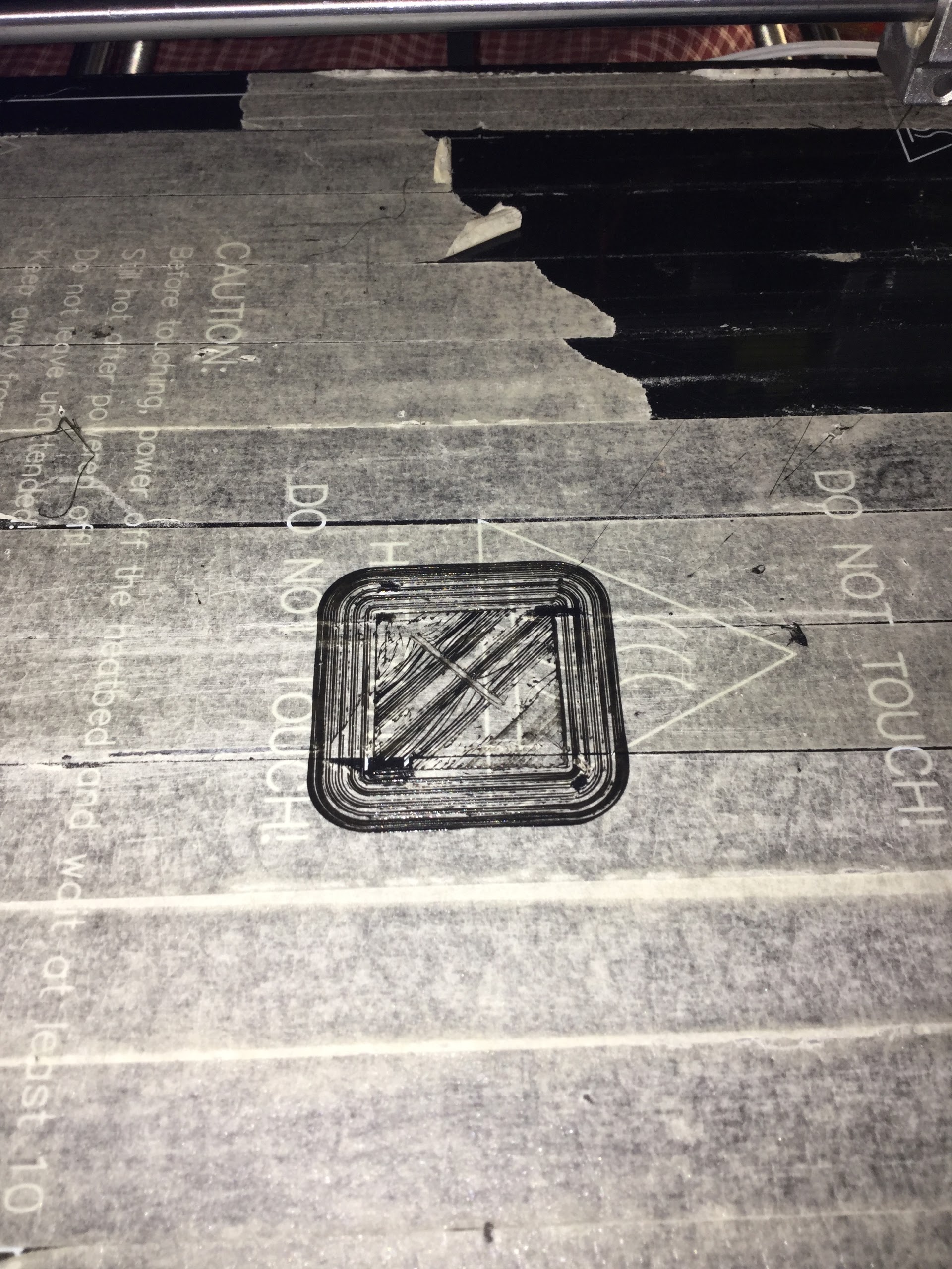

Can I get some help? My printer has been printing the first layer all wrong.
Using the 32bit mks sbase board based off of smoothie and uses smothieware, and my prints look like this at the first two layers but the layers get more solid as it continues to print the rest. What am I doing wrong? (FIXED)

Ok printing and it looks like thismissing/deleted image from Google+
I think the extruder is skipping/ not going enough steps
I’ll edit the firmware and try again

I think I know the problem, my extruder does not have enough grip on the filament. I’ll try to adjust that because if I force the filament a little it starts printing normally if I let go it under extrudes.
