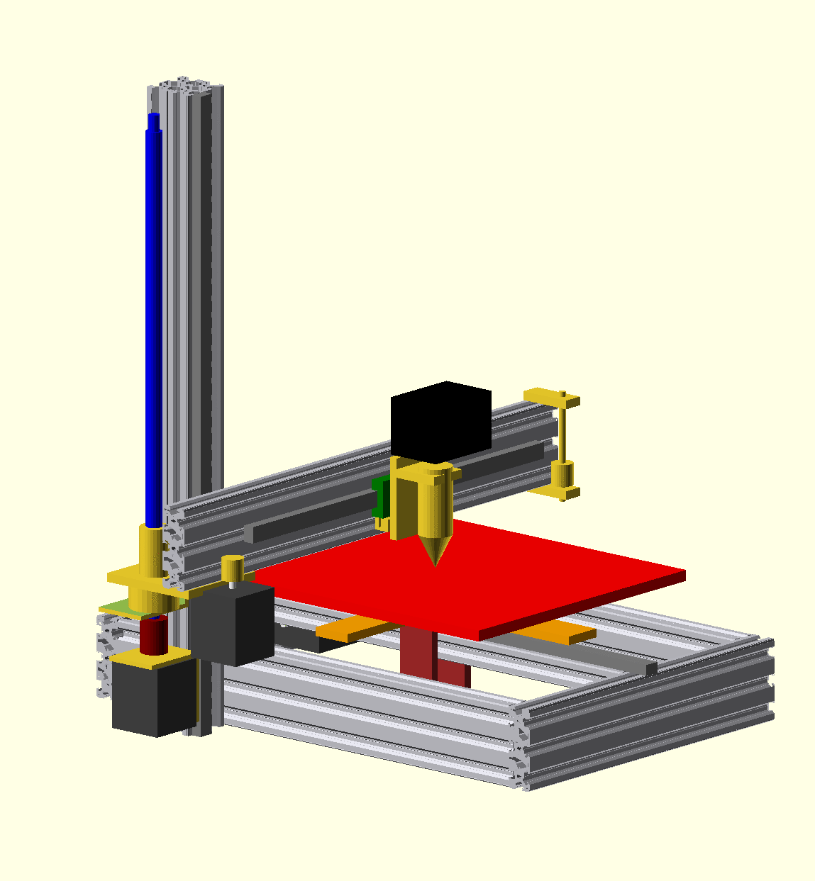

Cantilever printer design based on leftovers

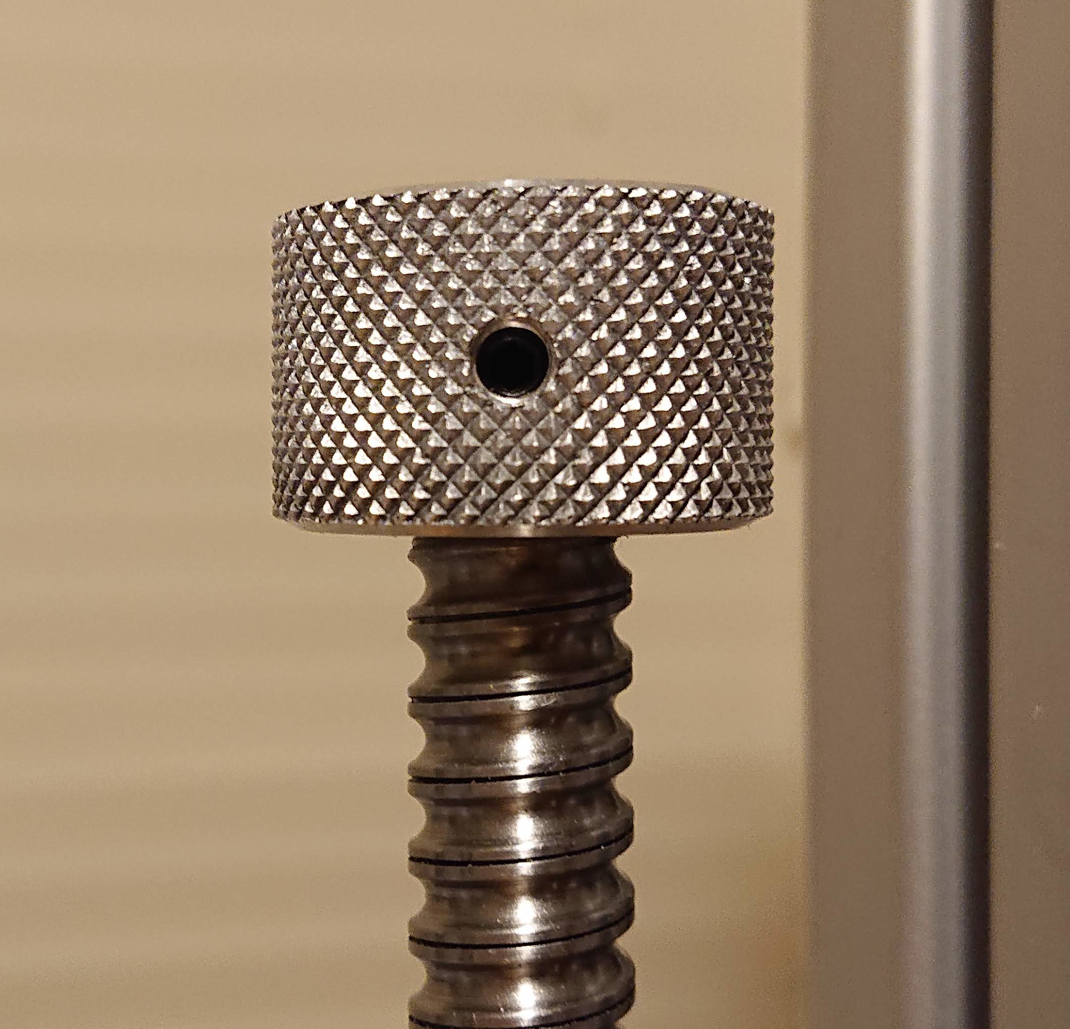

I needed a stop to make sure I don’t run the Z nut off the top of the Z screw, so I made a knurled knob that will let me adjust Z when the printer is off that also functions as a stop. :slight_smile:

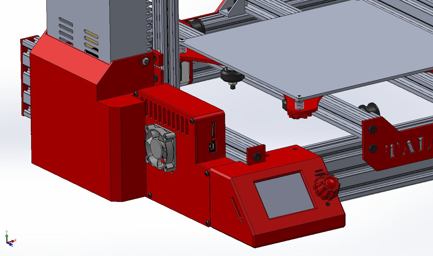

@Eclsnowman since you are using an SKR mini E3 v1.2 with at least one printer, did you get the TFT35-E3 as well? If so, did you design an enclosure for the pair? Right now, I have the pair sitting on the table next to my printer and it’s kinda ghetto, and while I could design a case I figured if I can cadge a case design off a friend why not? :wink:
I have an enclosure design for the board that could be modified pretty easily. I have one of the minis on my ender 3, and I thought I messed up the boot loader so I bought a replacement board but then figured out the issue was with flashing it a firmware above 256k without using the 512k hack. So I ended up with a second one and replaced the controller board on my Talos3D Spartan. So that’s the one I designed the electronics enclosure for, cuz the under 3 already has the standard enclosure.
I don’t have that particular TFT, I just did the wiring hack to hook the smaller tft control to it. But to be honest I like the interface better of the Marlin non-touch screen. So I almost always run the screen in Marlin emulation mode. Instead of the standard touch interface.
Give me some time here tonight and I’ll get the files together for you, what format would you prefer them in for modifying?
As usual, you do beautiful designs. :slight_smile:
I also use marlin mode instead of touch mode for pretty much everything except typing gcode into the integrated terminal, thought I might be the only one…
That design won’t work for my corexy, but it sure will for the new cantilever printer which is nearing functionality :crossed_fingers: so that would be awesome! I would have to modify for the TFT35.

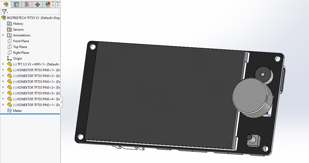

As of recently, I ended up installing Fusion360 on the windows machine, and I’m an EAA member, so SolidWorks is also free for, me so I have that installed too. So probably whichever is native is most likely to be useful. I keep working in openscad and FreeCAD because I hate lugging out the windows machine when I’m overall so comfortable in Linux. :slight_smile: So I’m pretty much the confused user in Fusion360 and SolidWorks still. Therefore, I might have some learning to do to modify the front for the TFT35.
Here is a google drive download for the files. I have them in Soldiworks 2018, as well as Step, and X_T. I also had been looking at the TFT35 V3 before, so I had a model of that and chucked it in there for good measure. Should make designing a case pretty easy. If you want any help on that front let me know because I am pretty quick at knocking things like that out. Only thing to watch for is I didn’t make that TFT35 model so an enclosure for it might take a test run to confirm all that modelers positions were correct.
Here is the link for the downloads: https://drive.google.com/drive/folders/1vlIBAw07zbvf0dH1GCBH8gQeaQIjFoda?usp=sharing
And here are some pictures of the model I had found for the TFT35, it looks like good work by who did it:

I am discovering in practice what I knew in theory: That some OpenSCAD and FreeCAD experience doesn’t make SolidWorks obvious to me. I’m guessing I’d need to go a long way down this rabbit hole to learn what I’m doing. I’ve literally only opened a few files and poked around before, never even tried to edit anything.
I want to get there, but it’s slow going. I figured out how to the the TFT35 inserted into the front cover in place of the the smaller display. But lots of “The selected component is fixed, it cannot be moved” when I try to move features on the enclosure to make them match the TFT35 display. I’m guessing there’s a way to select features and move one to match another quickly.
I feel like “I’m not a doctor, I just play one on TV”, or maybe waking up unexpectedly in Portugal and discovering that a smattering of French and less of Spanish isn’t the same as being able to speak Portuguese. I’m clearly wielding a power tool while unsure which end is the business end! :rofl:
Several of the features of the housing are designed using “in context” constraints to the assembly. So the features are actually tied to each other and their respective models within the assembly. It’s a top-down vs bottom-up modeling question. If you give me an quick sketch of where you want the display mounted on your printer I can wipe up a quick concept. I like these sort of projects.

What you have designed, without the power supply holder, and accommodating the larger TFT35 display, would be perfect for the cantilever printer! (I’ll tuck the power supply away somewhere else; it would get in the way of the X motor on the Z tower for my design.)
I hope to be less helpless when I have a chance to learn more. :slight_smile:
Do you have your current printer design in a form of Cad I could pull into SolidWorks? Like step or something similar? If so I could model the mounts for the LCD and the controller around that to make sure I’m not obstructing anything. Either that or even a dimensioned 2D front view and side view so I knew what heights to stay below (for example so I don’t have the LCD sticking above the bottom of the bed where it would come in contact with it.)
Oh, the model is only in OpenSCAD, so I’m not aware of a good way to do any import that would pull into SolidWorks. It can produce AMF, but I don’t see importing AMF in the solidworks help. I tried using FreeCAD to convert the OpenSCAD to STEP but no luck. If I’d designed it in SolidWorks I could probably just tell it to make drawings for me, but then I would also know how to modify it myself. :rofl:
I think I should just make a design that attaches to the side and doesn’t wrap around the front. It would give me more freedom to modify the printer later. :slight_smile:
