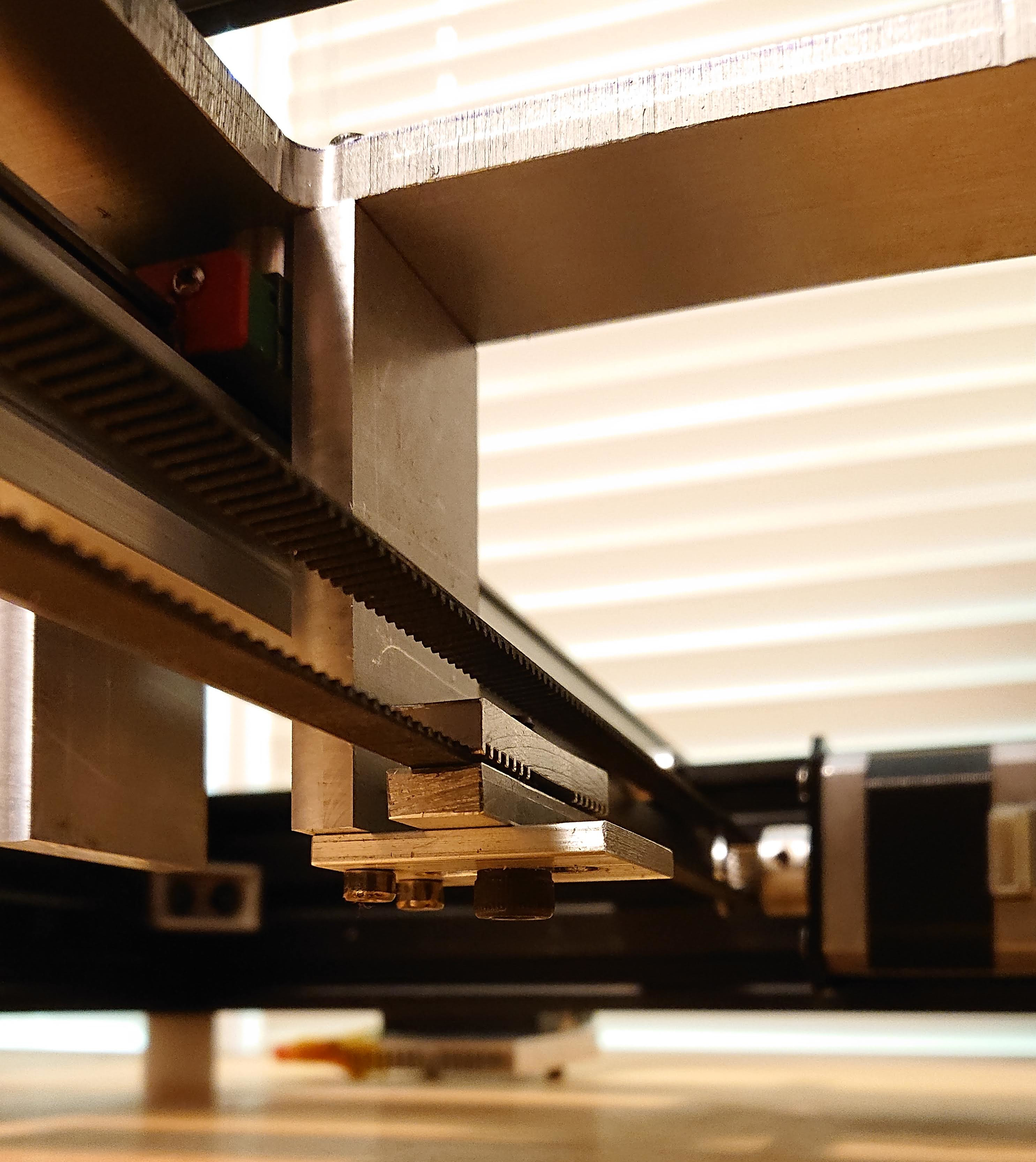

This morning I got the Y belt clamp set up. I had intended to attach the top side of the belt to the middle of the saddle, but then realized that the adjustment screw would be inaccessible. I then discovered that with a clamp piece I had already made (a test piece for the X axis clamp) it was aligned already with the bottom of the saddle, so all I needed was to screw an extension to the bottom of the saddle and fix the belt to that on the bottom side. It will reverse motor direction for Y, which is fine.
The tensioner worked great. I was able to slide everything around so that everything is square and it runs true. The clamps are wide enough to move to 9mm belt later if this 6mm belt isn’t sufficient.

I am also making some feet, because I realized I needed to hold the frame off the table to run wires under it. I lathed them out of 20mm PE round bar stock; 20mm long, 5.5mm through-hole for M5 bolt, 10mm countersink for M5 bolt head 14mm deep, M5x12 bolt into slide-in T-nut in frame. After a day of drying out my ninjaflex, I will print TPU inserts (“shoes”?) that fit into the 10mm counter-sunk holes as the bottoms of the feet. Without the “shoes,” here they are on the corner. I like the flush frame mount that works from a good square cut!

There weren’t pictures earlier; I am so ashamed of my disaster of a shop, where I am halfway through so many projects that I sometimes can’t find the tool I’m looking for, that I couldn’t bring myself to take pictures of the work I was doing in there. I back-filled pictures last night. :blush:

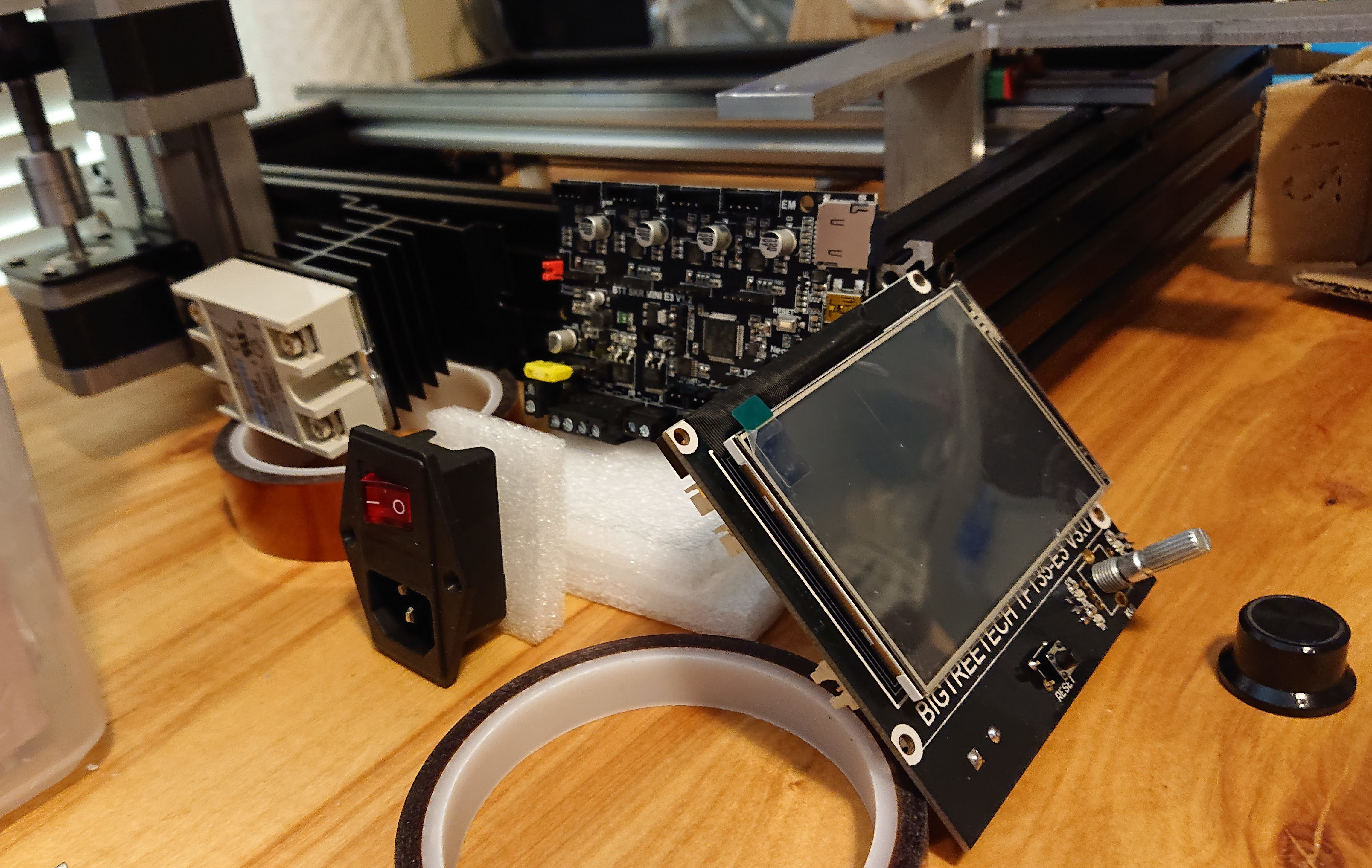

I was thinking of an arrangement that exposes the microsd card and micro-USB slot in the mini-e3, because on-board SD has lowest potential for print artifacts, and the USB port is useful, with the board set vertically for better thermal management. I want to put the 24V power supply remote under the desk to reduce noise from the fan, but make the mains power switch accessible. I need 120VAC to feed the heated bed from the SSR anyway. I like having the screen right out front, easy to get to, and I have plenty of desk space for it.
I’m attaching pictures here roughly mocking up the layout that I have in mind:
This doesn’t show the mini-e3 board as high as I would make it actually sit in order to have access to the USB port. There is plenty of room between the frame and the bed, so the case can stick up above the frame without a problem. (I just ran out of pieces of foam nearby to prop it up. :slight_smile:)
The AC inlet could be on its side with the C19 receptacle toward the back, instead of oriented vertically. That would probably make more sense than the mockup.

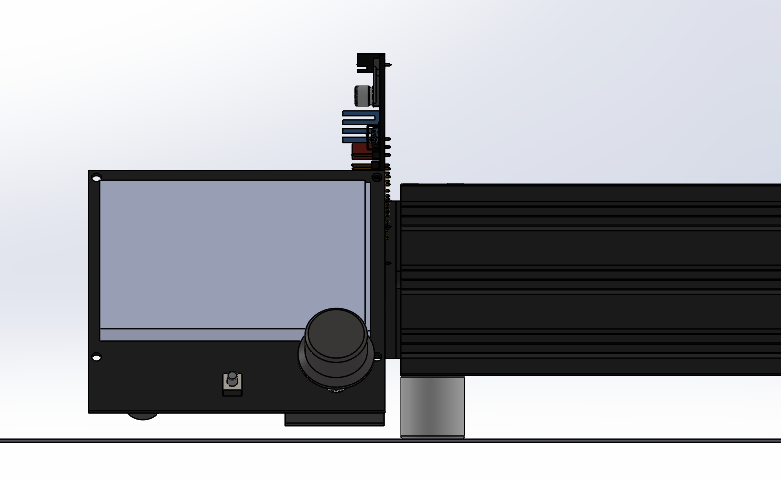

Here’s a top view:

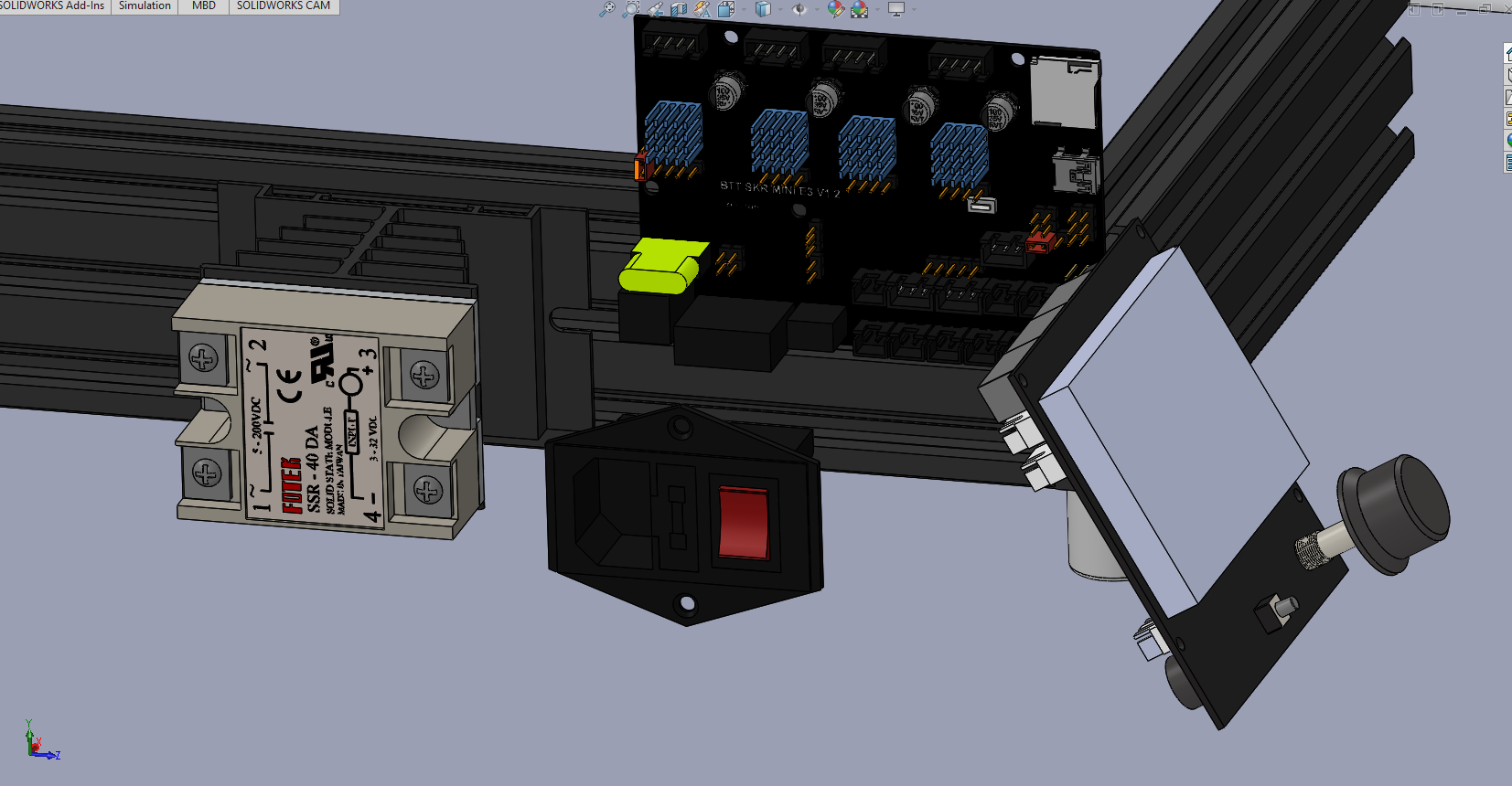

I moved the display slightly forward so that it would be possible to get at the SD reader if necessary, and rotated the switch/C19 receptacle and moved it forward.
I’m learning a little bit! :slight_smile:
Great, I’ll begin with your layout as the preliminary positioning, then and start coming up logical dimensions for the offsets. Then an enclosure to go around it that is printable. I’ll try and break it up into logical sections so it can be disassembled and printed without being a big monolithic structure, plus it’ll also make servicing easier.
Thanks! Just so no surprises, I had to remove the mates for the power socket in order to rotate it, and I didn’t try to put any back, because I know that such things exist but not yet how to set them up. :slight_smile:

If I created the x_t file correctly, the layout should look something like this:
