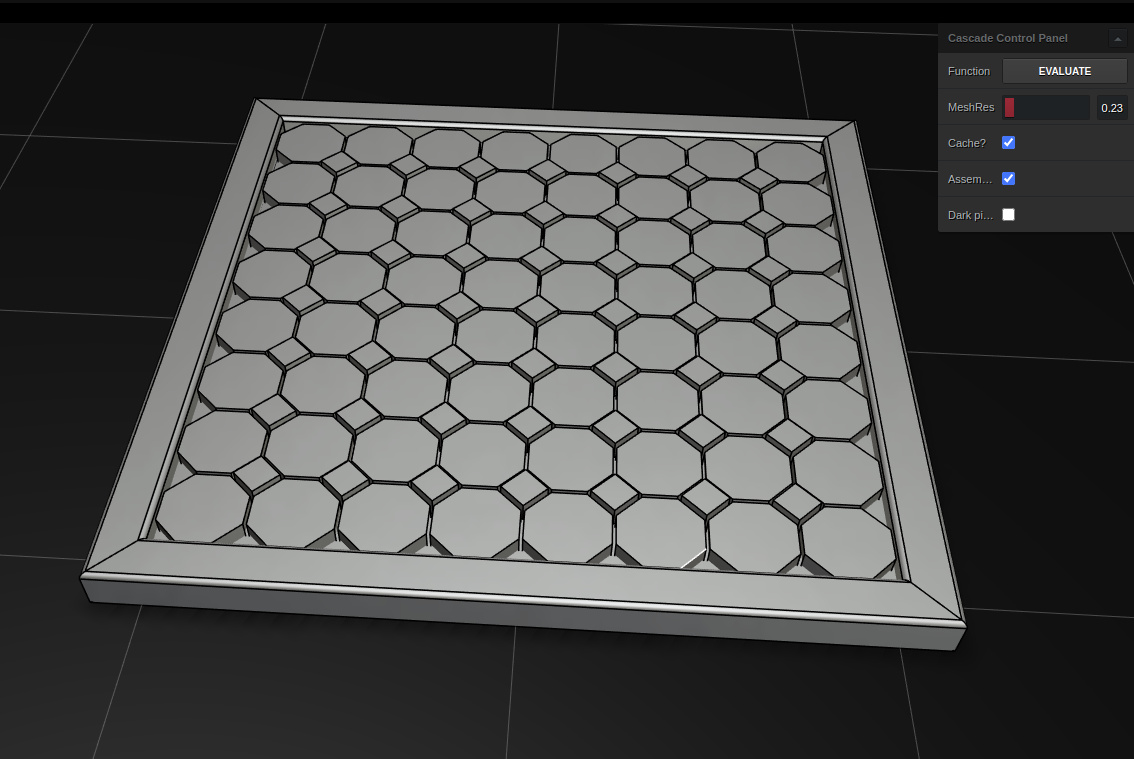

Here’s what my example code looks like to represent the playing board and pieces for the game “Pathagon” (the first complex geometric construction my eyes fell on looking for inspiration for something real to try to model):
let clearance = 1;
let partClearance = 5;
let baseLen = 25;
let units = 8;
let dWid = baseLen / 2.414;
let bezelInset = 3;
let boardWidth = units * baseLen + 2 * bezelInset;
let bezelWidth = 14;
let bezelHeight = 12;
let bezelLength = boardWidth + 2 * bezelWidth - 2 * bezelInset;
let bezelInsetOffset = 2;
let boardHeight = 3;
let pegHeight = 6;
let pegOffset = pegHeight / 2 + boardHeight;
let pawnHeight = pegHeight + 4;
let pawnsPerSide = 14;
let assembled = Checkbox("Assembled", false);
let darkPieces = Checkbox("Dark pieces", false);
function pawn() {
    let pawnLeg = baseLen - clearance;
    let basePawn = Box(pawnLeg, pawnLeg, pawnHeight, true);
    return Intersection([
        basePawn,
        Rotate([0, 0, 1], 45, basePawn)
function peg() {
    let pegLeg = dWid - clearance;
    return Rotate([0, 0, 1], 45, Box(pegLeg, pegLeg, pegHeight+0.2, true));
function baseBoard() {
    let board = [Translate([0, 0, boardHeight / 2], Box(boardWidth, boardWidth, boardHeight, true))];
    for (let x = 1; x < units; x++) {
        let xOffset = (x - units / 2) * baseLen;
        for (let y = 1; y < units; y++) {
            let yOffset = (y - units / 2) * baseLen;
            board.push(Translate([xOffset, yOffset, pegOffset-0.1],  peg()));
    return Union(board);
function bezel() {
    return Translate([0, 0, bezelWidth / 2],
        FilletEdges(
            Difference(
                ChamferEdges(Box(bezelLength, bezelHeight, bezelWidth, true), bezelWidth - 0.01, [1, 5]),
                [Translate([0, boardHeight-bezelHeight/2, bezelWidth / 2 - bezelInset / 2], Box(bezelLength, boardHeight, bezelInset, true))]
            1.5, [15, 19]
function bezelSet() {
    return Rotate([0, 0, 1], 90, Union([
        Translate([0, -(bezelHeight / 2 + partClearance/2), 0], bezel()),
        Translate([0, bezelHeight / 2 + partClearance/2, 0], bezel())
function pawnSet() {
    let pawns = [];
    for (let y = 0; y < pawnsPerSide/2; y++) {
        pawns.push(Translate([0, boardWidth/2 - baseLen/2 - y * (baseLen + partClearance), 0], pawn()));
        pawns.push(Translate([baseLen + partClearance, boardWidth/2 - baseLen/2 -y * (baseLen + partClearance), 0], pawn()));
    return Union(pawns);
if (assembled) {
    Translate([0, 0, bezelInsetOffset], baseBoard());
    let b = Translate([0, boardWidth/2 + bezelWidth - bezelInset, bezelHeight/2], Rotate([1, 0, 0], 90, bezel()));
    for (let n=0; n < 4; n++) {
        b = Rotate([0, 0, 1], 90, b, true);
    for (let x=0; x < units; x++) {
        for (let y=0; y < units; y++) {
            // show that every position could be filled with one of the 28 actual pawns
            Translate([-baseLen*units/2 + baseLen/2 + baseLen*x, -baseLen*units/2 + baseLen/2 + baseLen*y, bezelInsetOffset+boardHeight], pawn());
} else if (darkPieces) {
    Translate([baseLen/2 + partClearance, 0, 0], pawnSet());
    Translate([-(bezelWidth + partClearance), 0, 0], bezelSet());
} else {
    baseBoard();
    Translate([boardWidth/2 + baseLen/2 + partClearance, 0, 0], pawnSet());
    Translate([-(boardWidth/2 + bezelWidth + partClearance), 0, 0], bezelSet());
It’s kind of cool that you can play with this model just by following this link that includes the entire text above, compressed and encoded!
