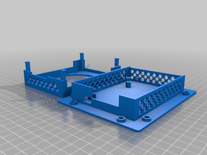

I have successfully used friction clips of various types including printing in PLA. Here’s one:

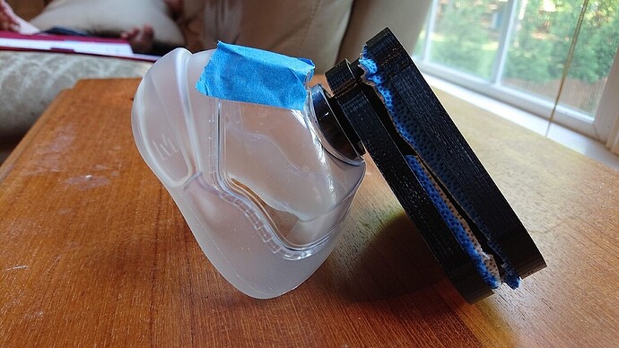

I also did something with a similar purpose where I made little bumps that are designed to interface with layer lines for a secure fit, when I was designing a canister filter based on Halyard surgical wrap as a filter back in the worst of the pandemic, working with some health care professionals:
Nice work you did on the respirator cartridge! :ok_hand:
The friction clips may be then a solution to test.
