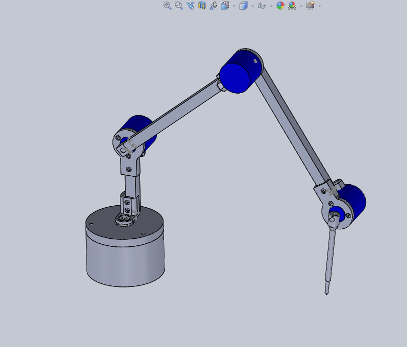

When measuring physical objects sometimes calipers, squares, rulers and height gauges feel inadequate and accuracy is questionable depending on what you are measuring. I wanted a tool that can pick up any point in a 3 dimensional space and easily import into my CAD software of choice. I found an design by Nikolaj Møbius from FabLab RUC that got me pointed in the right direction for a cheap alternative to a $3000 want to have “problem”. A few other makers have made arms of various “quality” but there was no definitive guide that I could find. I started out modeling various methods of mounting the encoders and 3D printed 3 or 4 variations before coming up with a suitable setup that was ridged and repetitive in positioning.

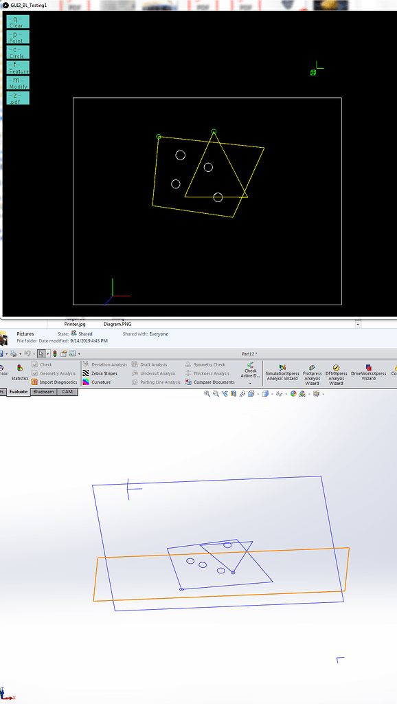

The finished 4 axis arm below is a repeatable and accurate (~0.2mm). Worked well, but did not give me the freedom that I want to have with the tip (end effector). The arm uses an Arduino to read the encoders with a serial connection to a computer where you can run a Processing sketch that gives you a visual representation of the 3d space and the ability to export point cloud and DXF model (both 3d and 2d). I have modified the original proof of concept Nikolaj produced.
If your interested in the arduino code, I have a GitHub repository with the 4 axis software if anyone wants to build their own.

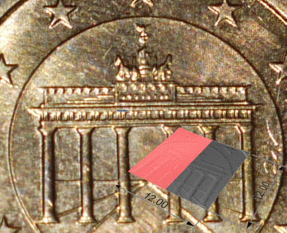

There was a discussion when our quality dept was moving, to keep it in business or not. But the softwareupdate including calibration would have been 2200 Euro, so I had the chance but did not take it due to the cost / benefit balance. At that time I built myself a cheapish tactile head for my CNC and Im rather happy with that until now… afterwards they additionally decided to update and to keep the device, so its gone.
This is the result of the tactile head… looking closer you can see the printmarks of thr carbide needle I use as a probe… (right side of the coin)
Sample

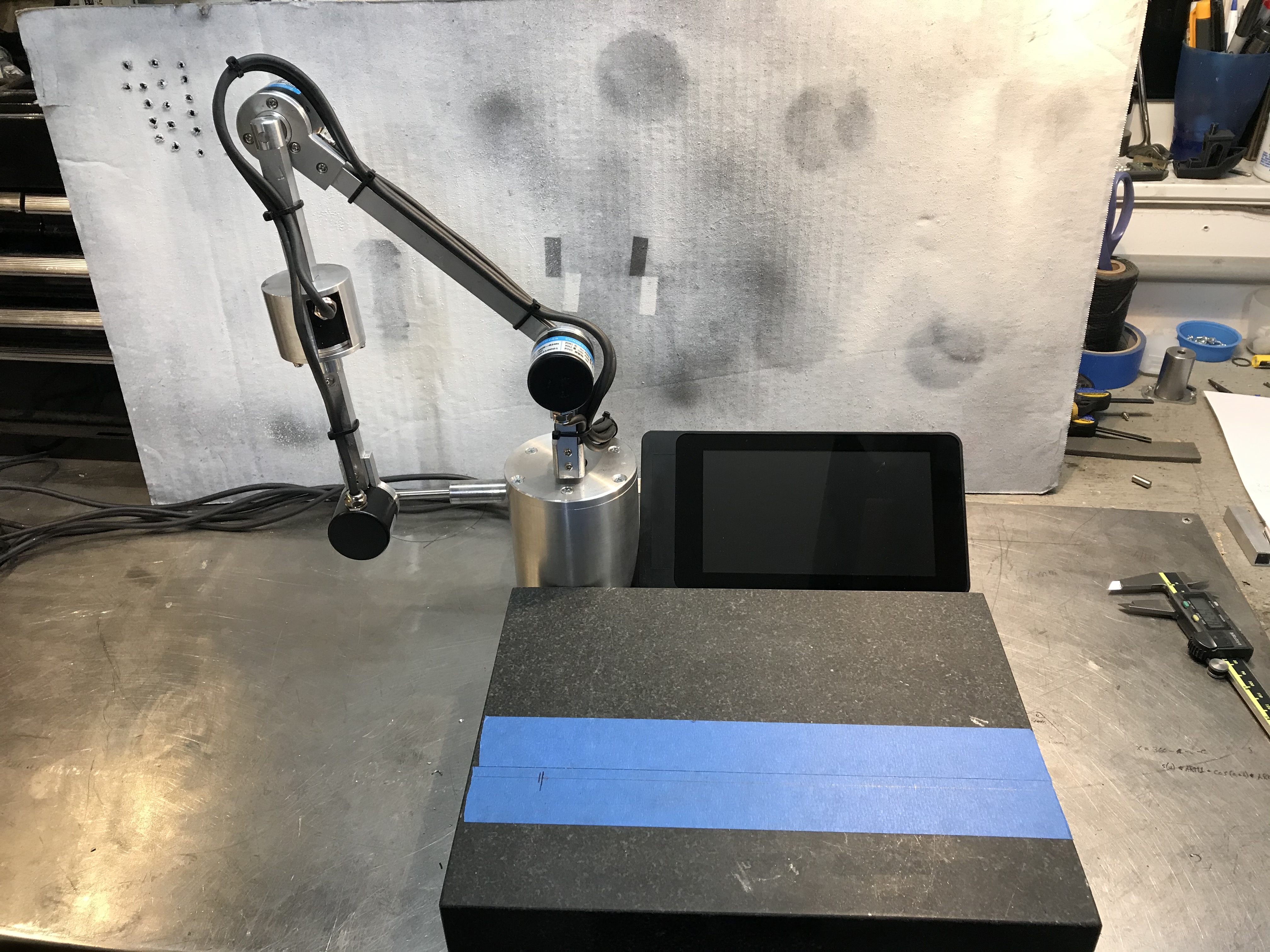

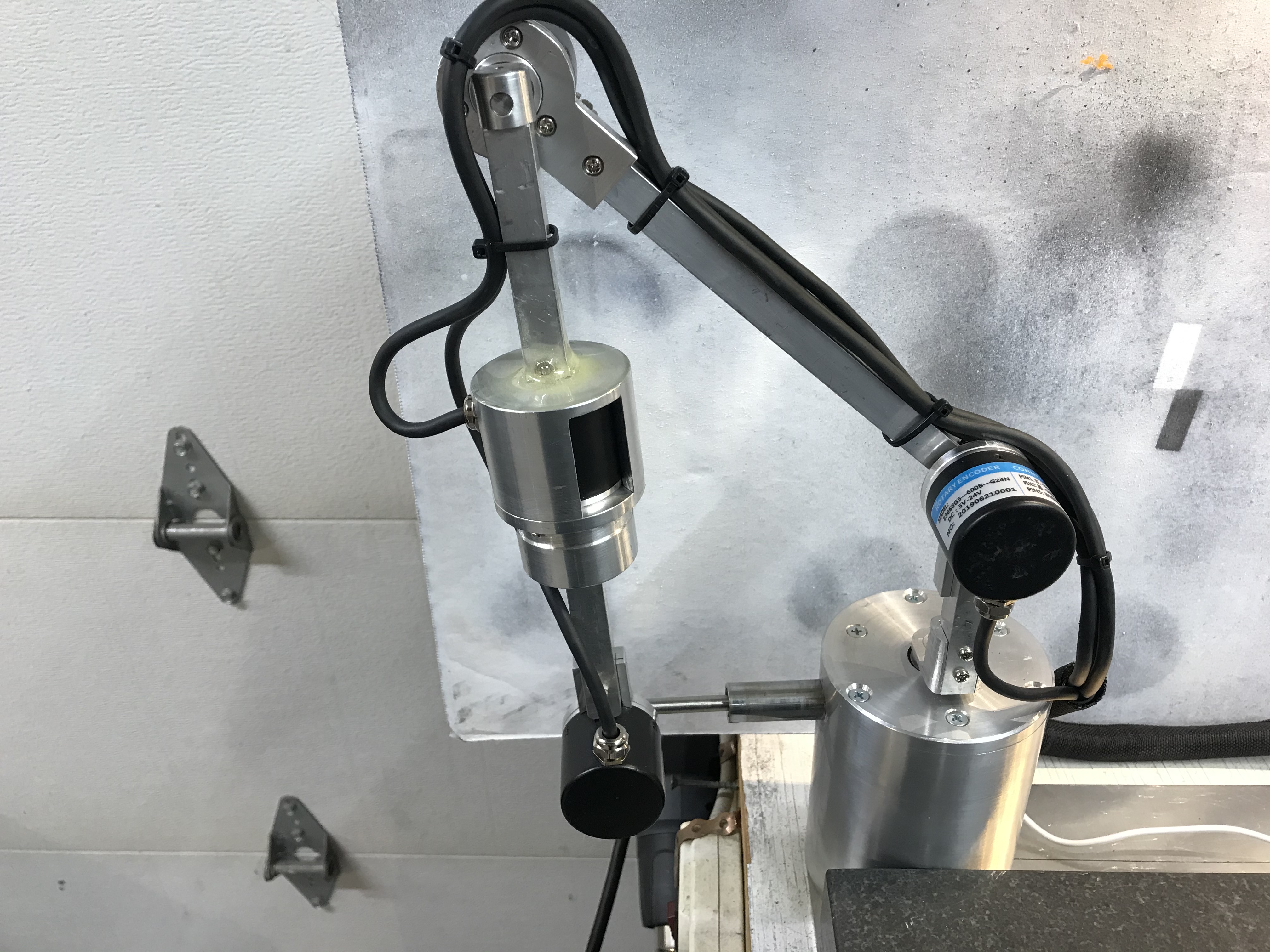

CNC is back in business with new Spindle Bearings! And a week later I found time to get back into the shop and re-make a few parts to finish off the 5th Axis. I also received an enclosure for the Raspberry-Pi and touch screen. Should be a nice package. Still chasing some software calibration items but getting close to having a respectable arm in terms of accuracy.

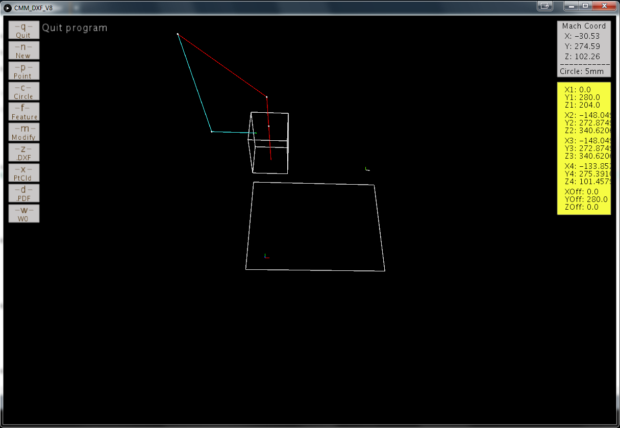

A bit more progress today. Mostly working on the Processing sketch to make troubleshooting easier. I increased the serial communication message to include the locations of each joint. Then in Processing I included each point and arm. Now I can see each movement of the arm in real time on the screen, not just the end point.
Well I have the arm complete and in use in my shop now. Been radio silent the past month getting allot of things sorted out. I have updated the GitHub repository with the latest code for both the 4 DOF and 5 DOF arms though I have not progressed much on the 4-DOF version as its no longer applicable for my application. I abandoned the Raspberry Pi portion as it was a pain to move DXF files and PtCloud files to my desktop for work in CAD. 99% of the time it will be on my work bench anyway and if I want/need to go remote it can work on my laptop just without any extra work. I do wish the graphical interface was better though.
