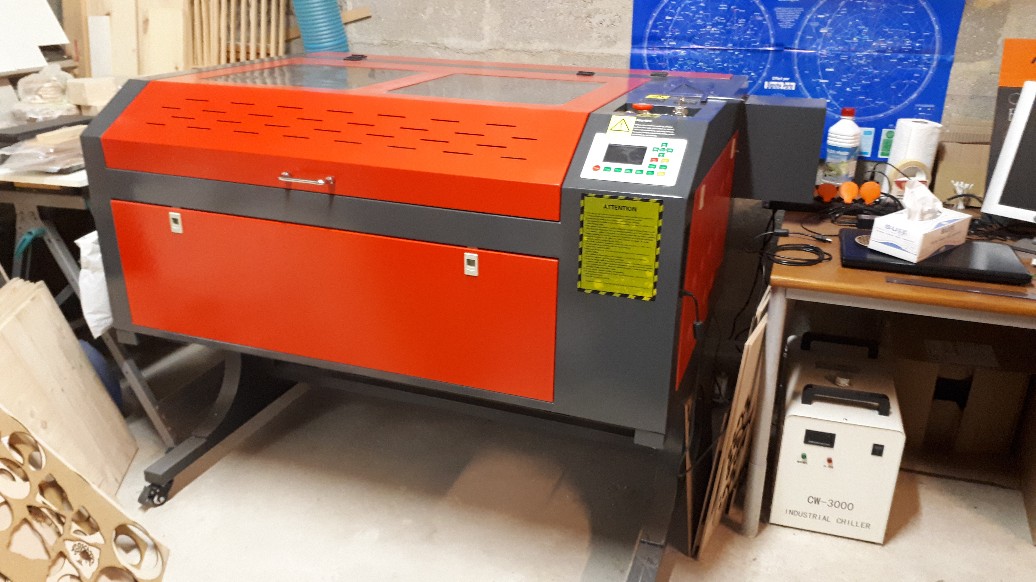

I have recently bought a Chinese laser cutting machine which works quite well. Here is a picture of the machine:
However, when cutting plywood or acrylic, the smell is quite high and I believe it’s not healthy to breathe the vapors.
So I’d like to change or upgrade the exhaust fan. The wall output is 2.5m higher, as the machine is undergournd.

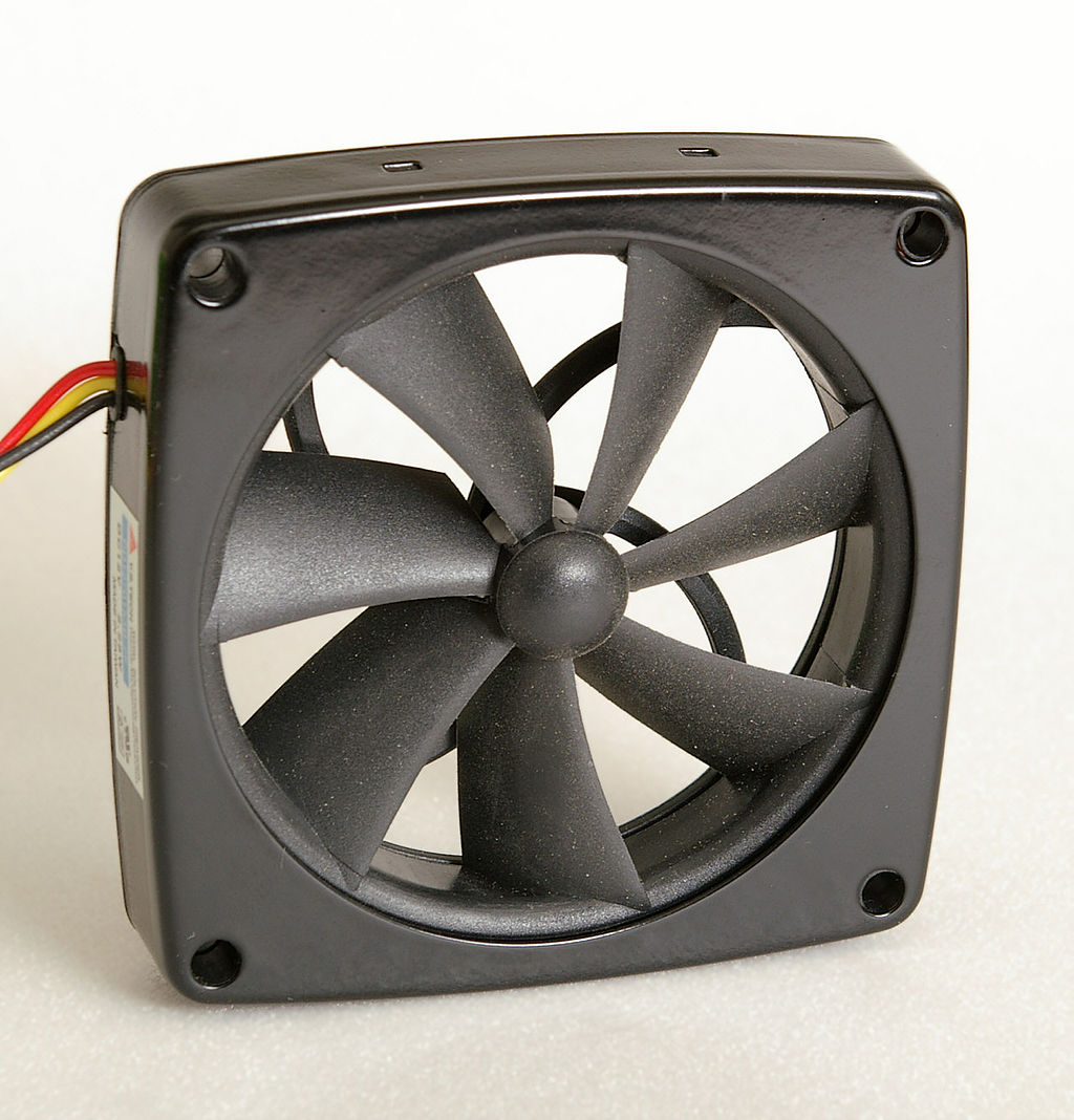

The machine is equiped with a small fan, see below:
and I don’t think it’s powerful enough.

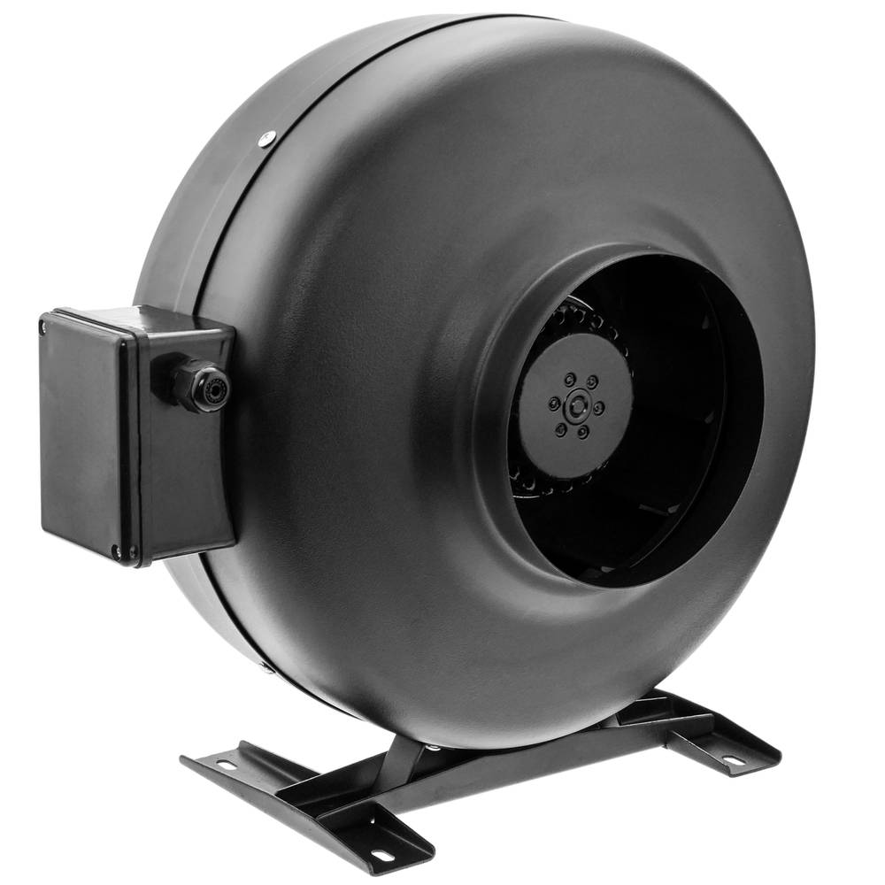

I’m thinking of buying this kind of fan:
chinese fan
The price is around 80€. Any advice on this kind of product?

The fans you have found have no input flange. Have you considered a centrifugal duct fan instead? Should be similar in price, but it’s designed to work in a duct so you won’t have to make something up to fit it to the duct. Also, the fans you found are loud (~90dB isn’t quiet); you should be able to get a quieter duct fan.
I would remove the existing muffin fan entirely. It probably doesn’t matter one way or the other, so why keep it?

  • That looks like a higher-power cutter, 80W maybe? You have a CW-3000 sitting next to it, which isn’t a refrigerated chiller, it’s just a radiator. You can do what you want, but probably the most common problem new users on this site have is “my laser has two dots now” because their tube has shifted into TEM01 mode, and that’s one of the common failure mechanisms for a tube that isn’t cooled right. A refrigerated chiller should cost less than a replacement high-power tube.

Also recommend removing the old fan. Serial exhaust fans are not additive. The old fan would most likely impair the performance of the new fan.

  • The “chiller” (or so called by the seller) is indeed a CW-3000. I expected it to be a real chiller. Anyways, that’s not my main concern. But thanks for the update.

It’s basically fraud that people list the CW-3000 as appropriate for any laser, let alone a high-power laser. Whether you need a CW-5000 or CW-5200 for a 100W laser probably depends on maximum ambient temperature.

The cutter is in an underground garage, so the temperature stays roughly constant around 20°C.

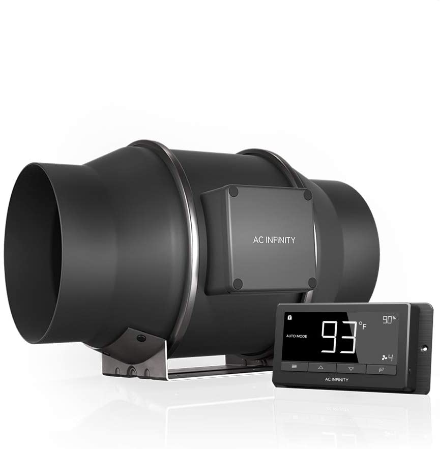

Thanks Don, it’s very nice but too expensive. I have it at 250€ incl shipping.

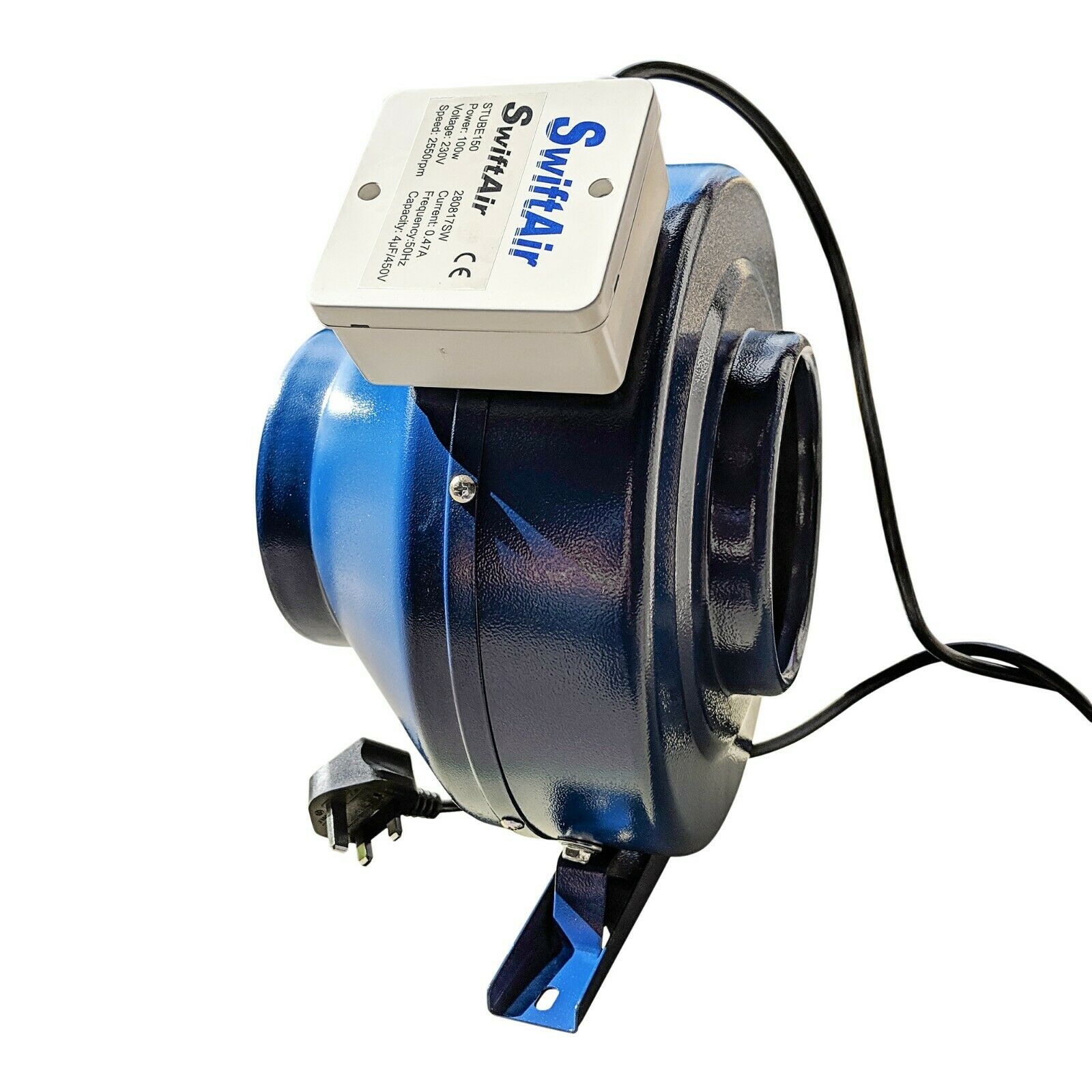

I think the swift air.
It looks like it has mounting flanges and its a little more powerful.

That might be saving you so far. Usually the CW-3000 will stay a few degrees warmer than ambient, so you might be running ~23⁰C water through your laser, which might be in spec. :sweat_smile: My shop is underneath my garage, underground, but here in North Carolina, USA the shop is definitely warmer than 20⁰!
The SwiftAir definitely looks like a typical radial blower; the white one is axial and looks optimized for velocity over volume.

Yes, the temperature display shows that water temperature remains between 23 and 25°C, sometimes up to 26.

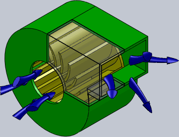

The centrifugal fan is well explained on Wikipedia:
Centrifugal fan
Is ‘radial’ the same as ‘centrifugal’?
Do you mean I should consider the radial / centrifugal fan, knowing that the hole in the wall is 3 meters away?
The real difference is the orientation of the blades, and the air movement I’m talking about is the movement immediately across the blades, not where it is eventually directed to.
The SwiftAir at looks like a common design that moves the air centrifugally / radially out into a manifold and then directs it downstream.
The wikipedia page is right, but imagine that instead of one exit path at a right angle to the input air flow, the air is collected in an outer manifold around the entire impeller and then directed in the same direction it came in. I don’t have a cutaway to show it, but that’s why it is so much wider than the intake.
In the ebay listing, you can click on Lire la description complète and it is clear that it is a radial fan. The input duct is connected on the flat side. It pushes air out from the center (that’s why it’s so muc wider) into the widest section, and then the cone on the exhaust side carries the air from that wide outer section to the exhaust duct.
Does that help any?
