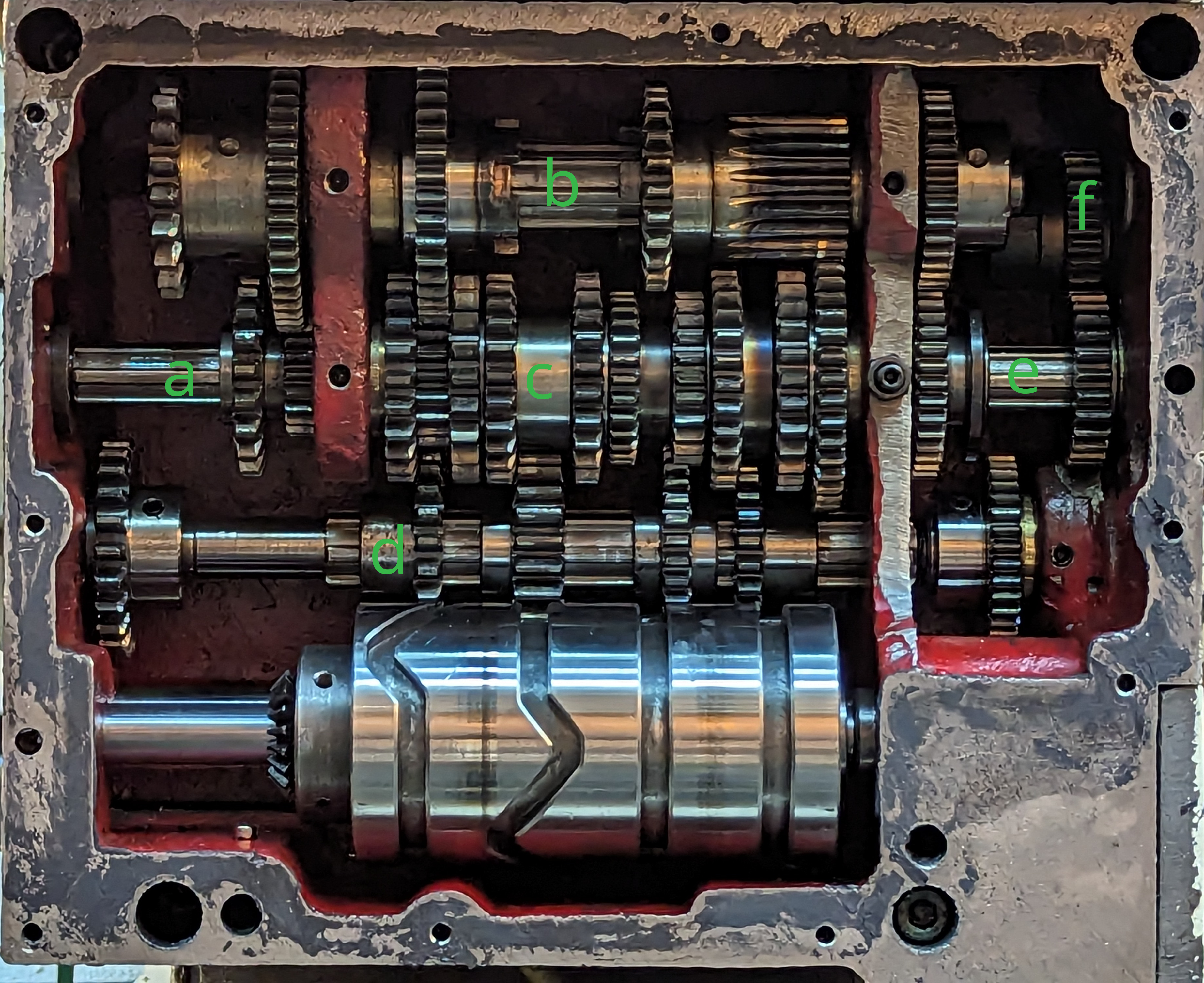

Rotational domain definition​
The manual doesn’t have names for this, so I have to make something up. There are six independent axes of rotation in the gearbox. The gearbox is driven from the change gears on the left, and drives both the lead screw at the top right and the feed screw at the bottom left. I’ll call these independent axes “rotational domains” and refer to them with lower-case letters a-f, since upper-case letters and numbers are both used for settings. They aren’t labeled strictly in order, because different configurations drive them in different orders.
  • Zone a: Input from the change gears; terminates at the first divider
  • Zone b: The entire topmost axis, through both dividers
  • Zone c: Coaxial with zone a, but terminating on each side at the dividers
  • Zone d: Connected from wall to wall; holds a driving gear from a engaged only in the C configuration, a series of four gears that engage with 8 of the 10 gears in zone c selected by the 1-8 setting cam at the bottom, an output gear to the right of the rightmost divider, and finally directly drives the feed bar out the right side.
  • Zone e: Coaxial with zones a and c, has one sliding gear that couples b to f (Y configuration), leaves f uncoupled (X configuration; drives only feed bar not lead screw), or couples d to f (W configuration)
  • Zone f: The lead screw output
Driving Orders​
The A/B/C and W/X/Y selectors affect the order in which the domains are driven. I denote x driving y as xy** here.
  • A/B: a→b→c →d
  • C…Y: a→d→c →b→e→f (used only for the lead screw; in these configurations the feed bar turns at the same rate relative to the input regardless of R/S/T or 1-8 settings)
  • W: d→e→f
  • X: Drives only the feed bar (direct from d) without engaging the lead screw at all)
  • Y: Used only with C to drive only the lead screw (b→e→f)

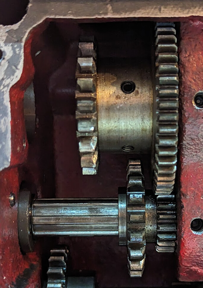

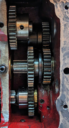

Configuration Close-ups​
Here are pictures of the relevant section of the gearbox for each separate configuration option, with some description.

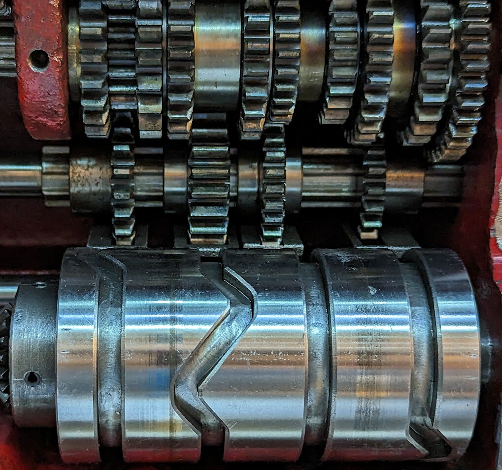

A/B/C Selector​
A​
Input a coupled to b domain 20:50
B​
Input a coupled to b domain 19:19
C​
Input a coupled to d domain 19:22

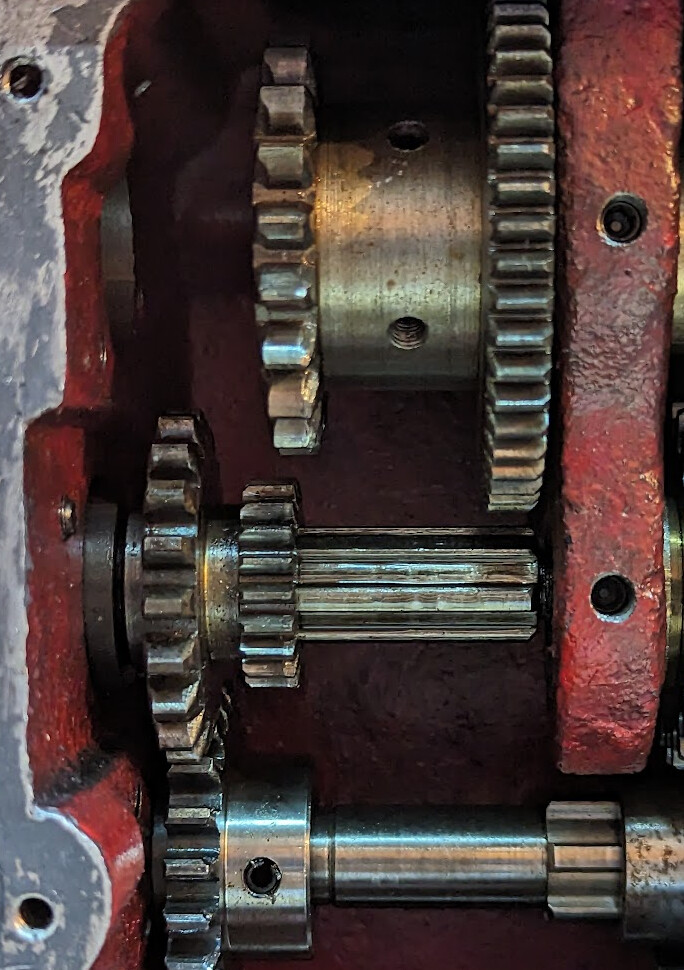

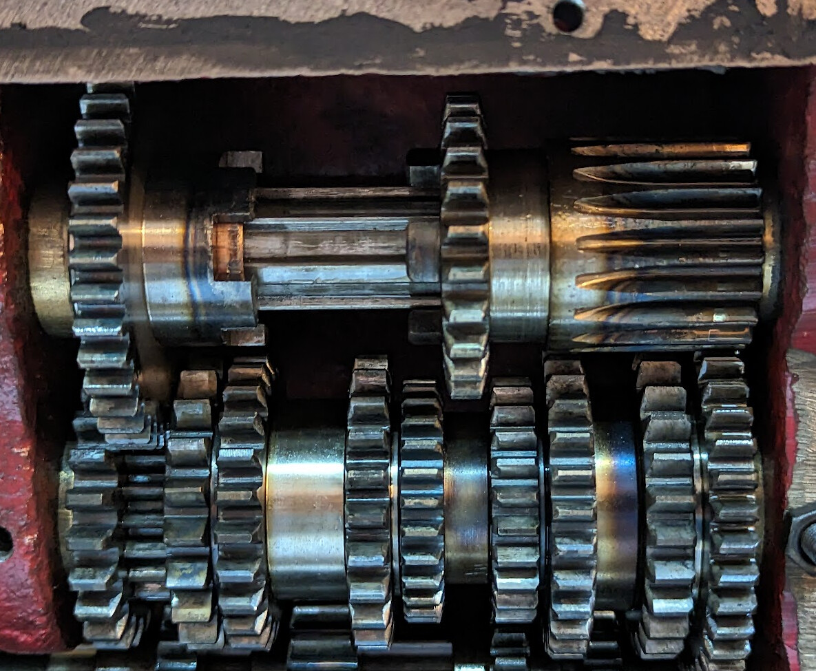

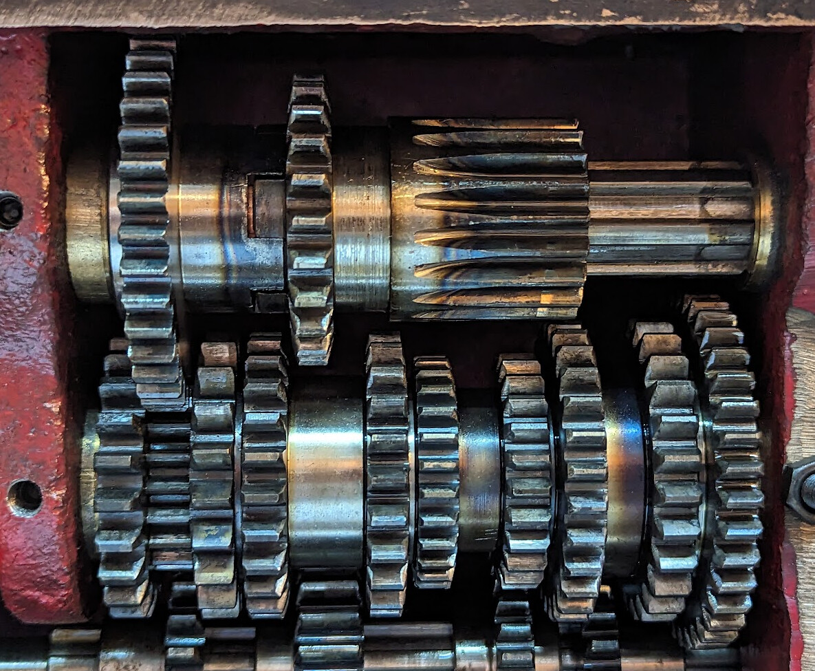

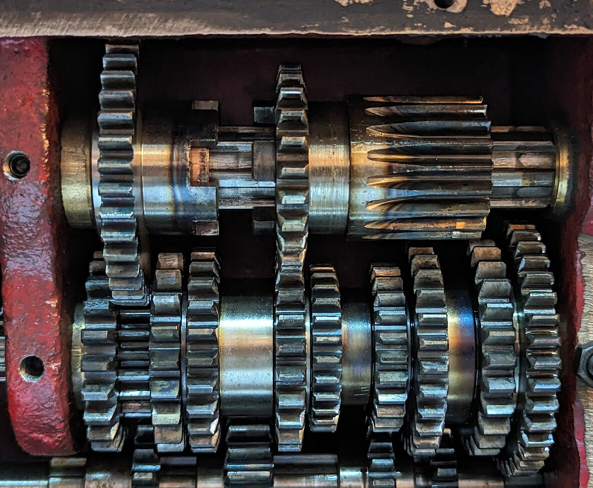

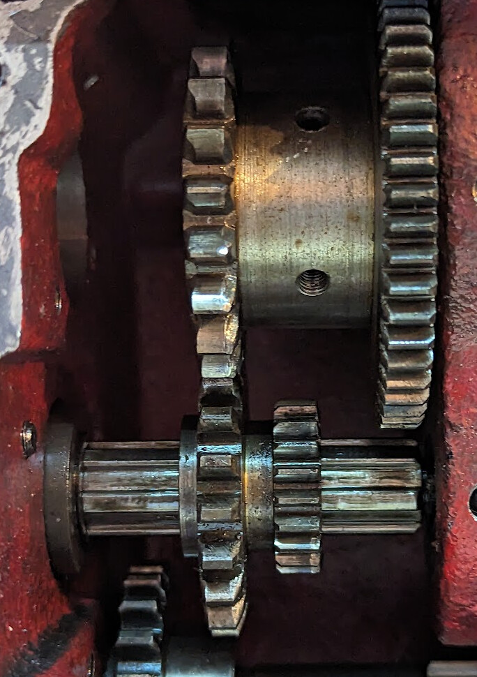

R/S/T Selector​
R​
Note that the 38:19 pair are always engaged with each other; in position R, a castellated pair couples the spline of axis b to the otherwise freely-rotating 38-tooth gear at the top left of this picture.
S​
Here, the castellations are disengaged, leaving the 38-tooth gear as an idling gear driven by axis c, but coupling b:c at unity through a pair of 23-tooth gears.
T​
Here, the long 19-tooth gear at the right on axis b engages a 38-tooth gear on axis c.

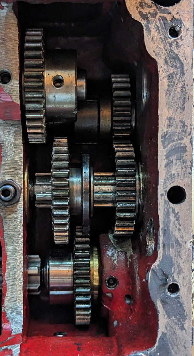

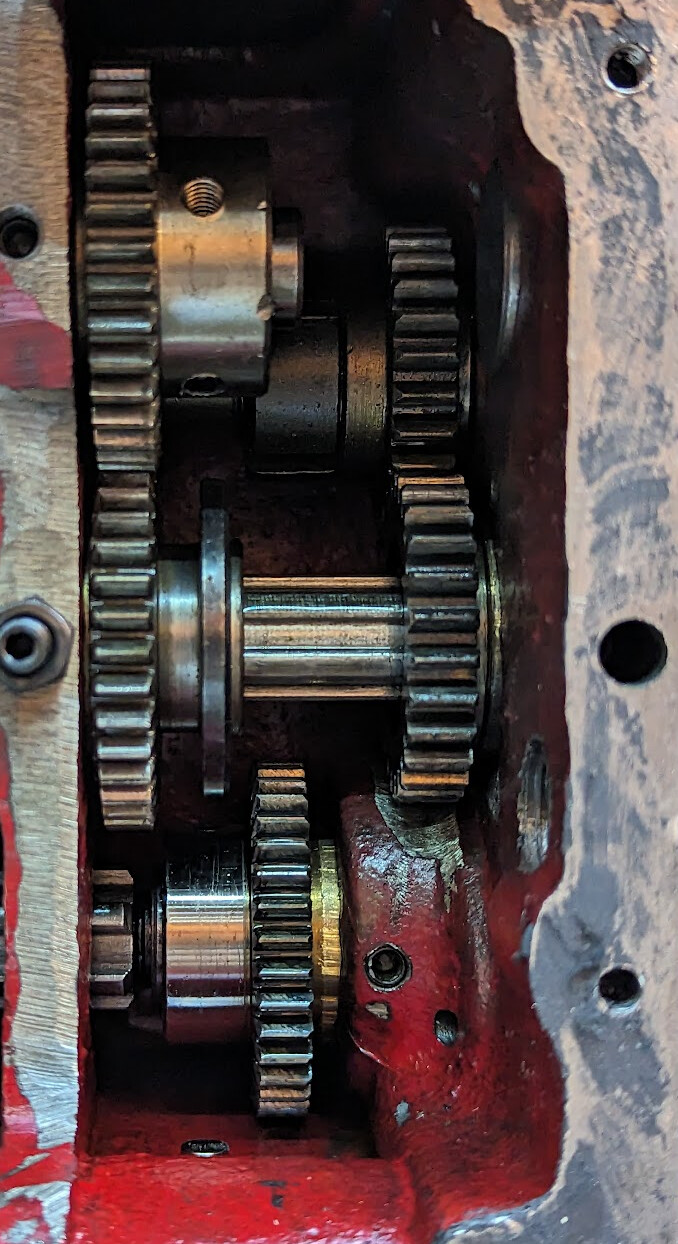

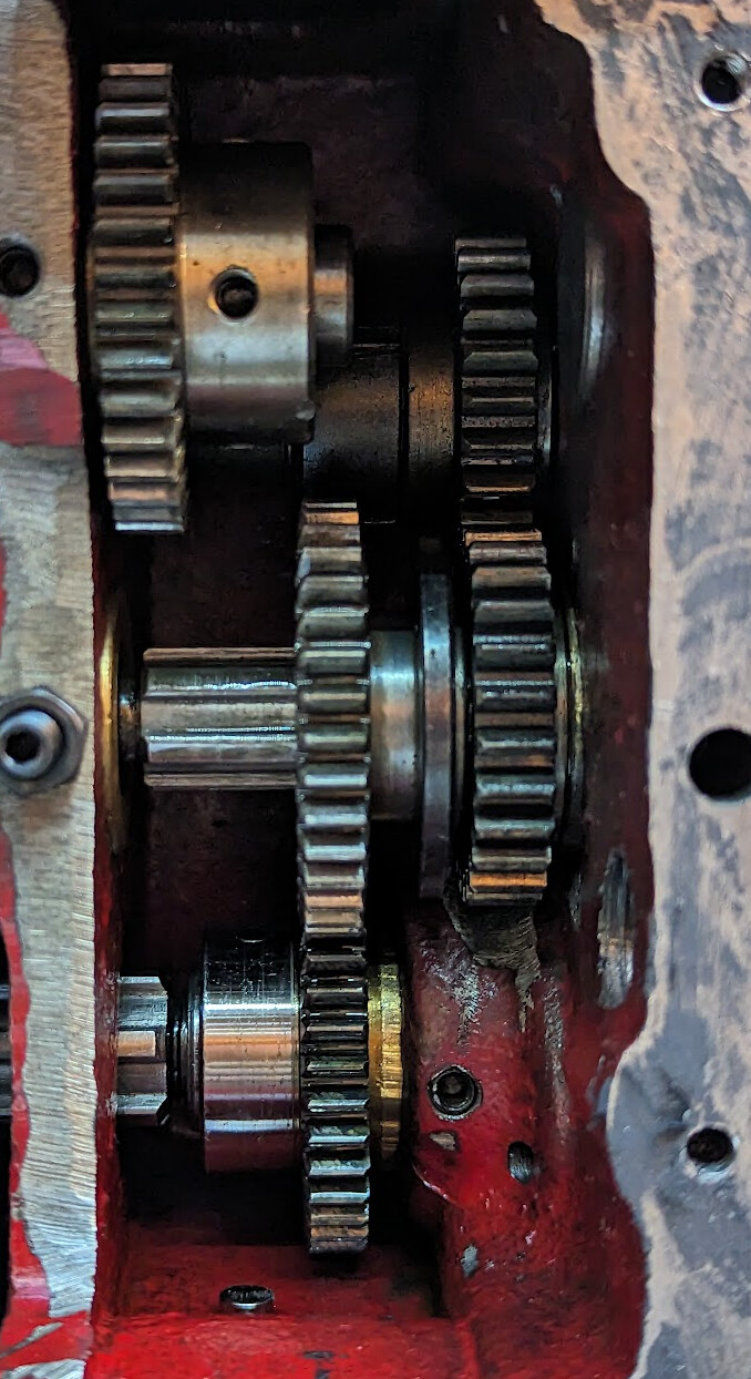

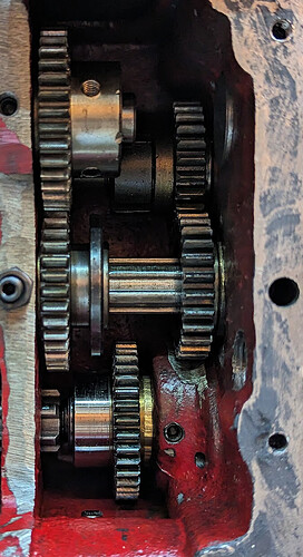

W/X/Y Selector​
The W/X/Y selector determines which domain, if any, drives the lead screw.
W​
The d domain drives the lead screw
X​
The e domain is disengaged, and the lead screw is not driven
Y​
The b domain drives the lead screw

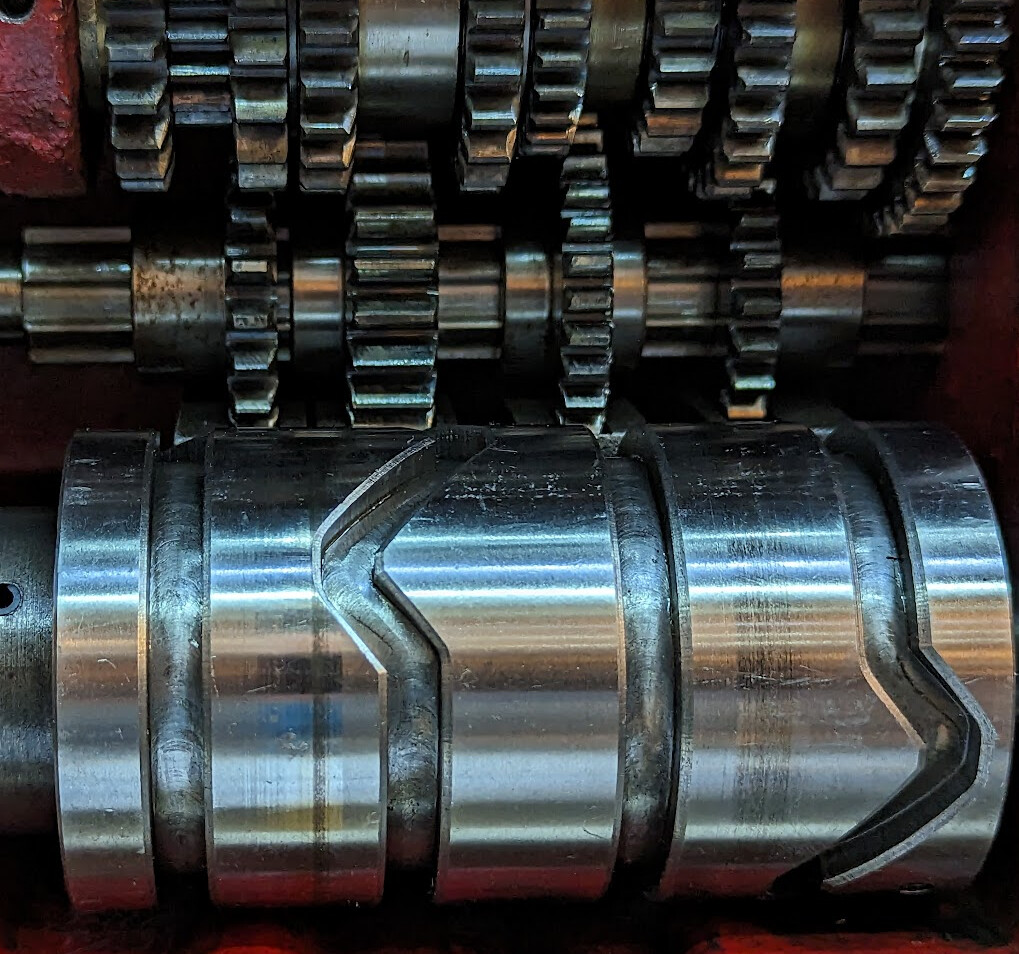

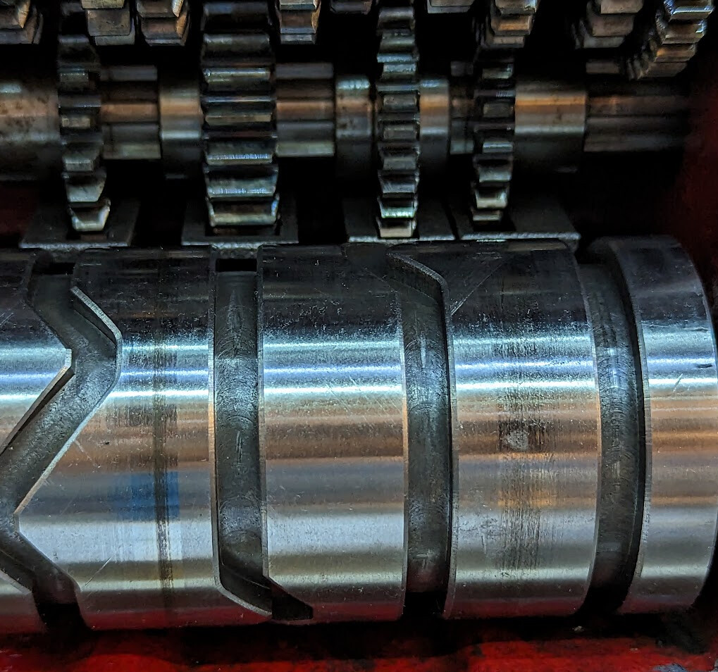

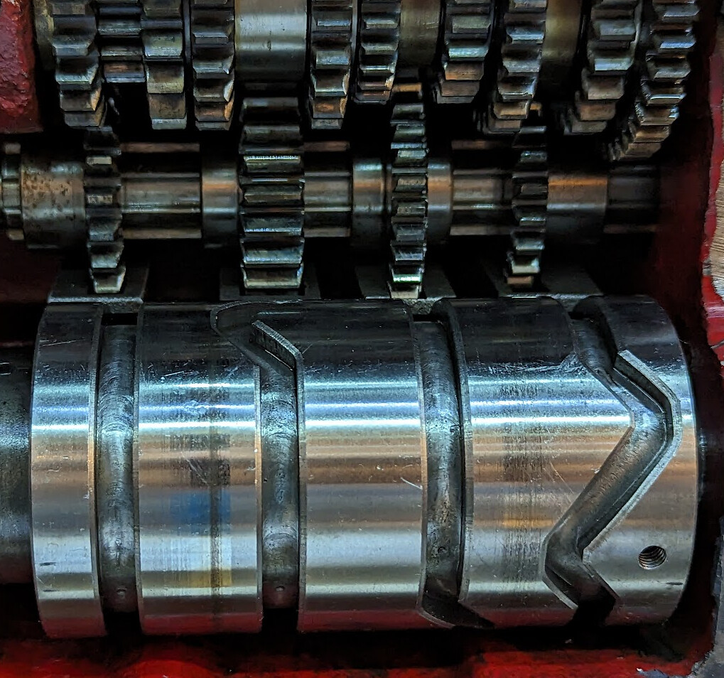

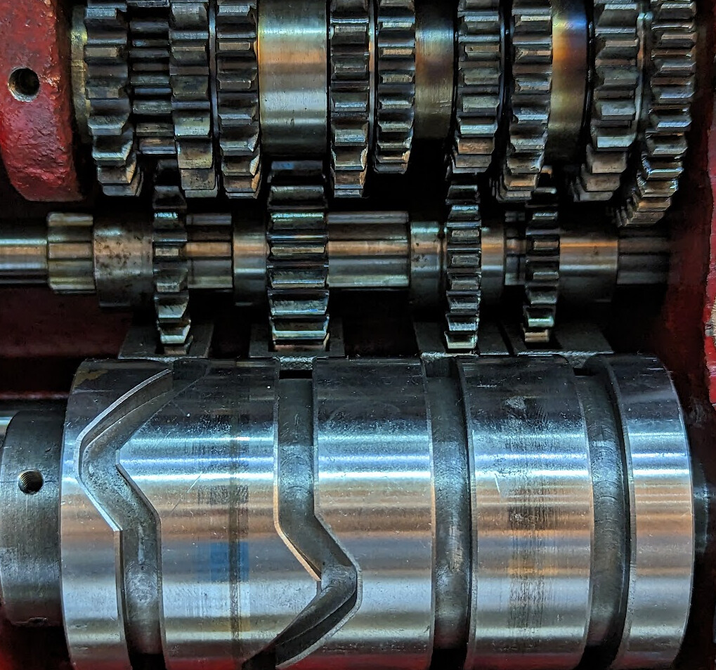

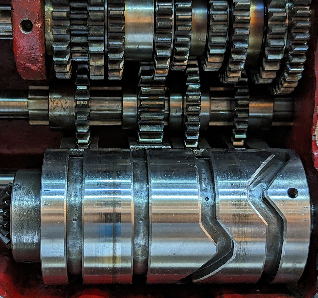

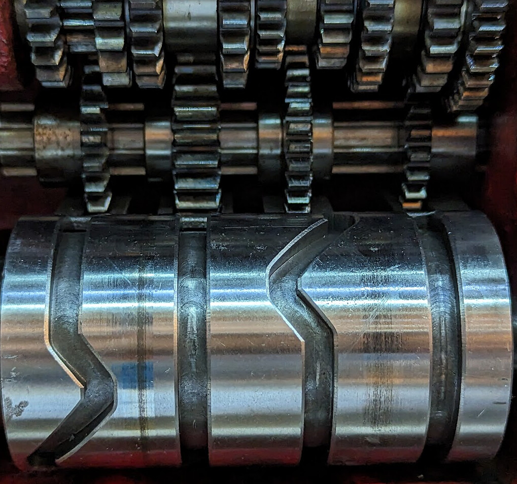

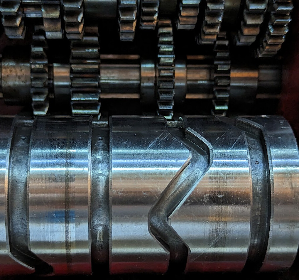

1-8 Selector​
When reassembling the gear box, one of the trickiest bits is to make sure that the number selector is correct.
1​
24:33
2​
27:33
3​
20:22
4​
22:22
5​
23:22
6​
24:22
7​
26:22
8​
28:22

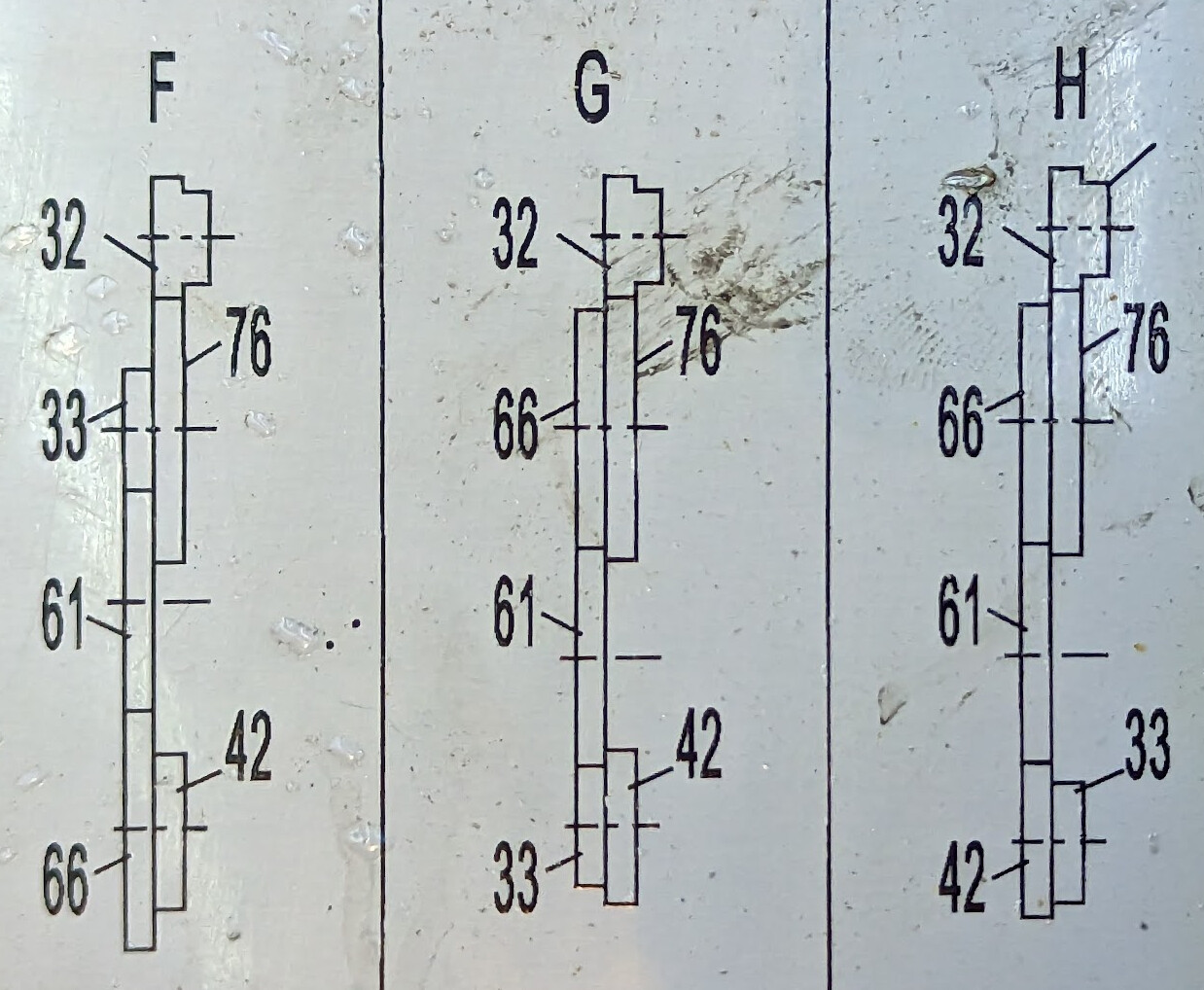

Feeds and Speeds
Here’s all the data from the front plate, in mostly-textual form, to use to understand the ratios.
Note that this doesn’t cover the feed rate calculations because it doesn’t include the apron gears and the bed rack pitch. It only covers difference between feed rates.
The lead screw is 8 TPI. The input to the change gears turns 1:1 with the spindle. This should allow exact calculation for all lead-screw-driven pitches.
Change Gears
  • F: 32:76 33:66
  • G: 32:76 66:33
  • H: 32:76 66:42 (Used only for worm cutting, as part of approximating pi
