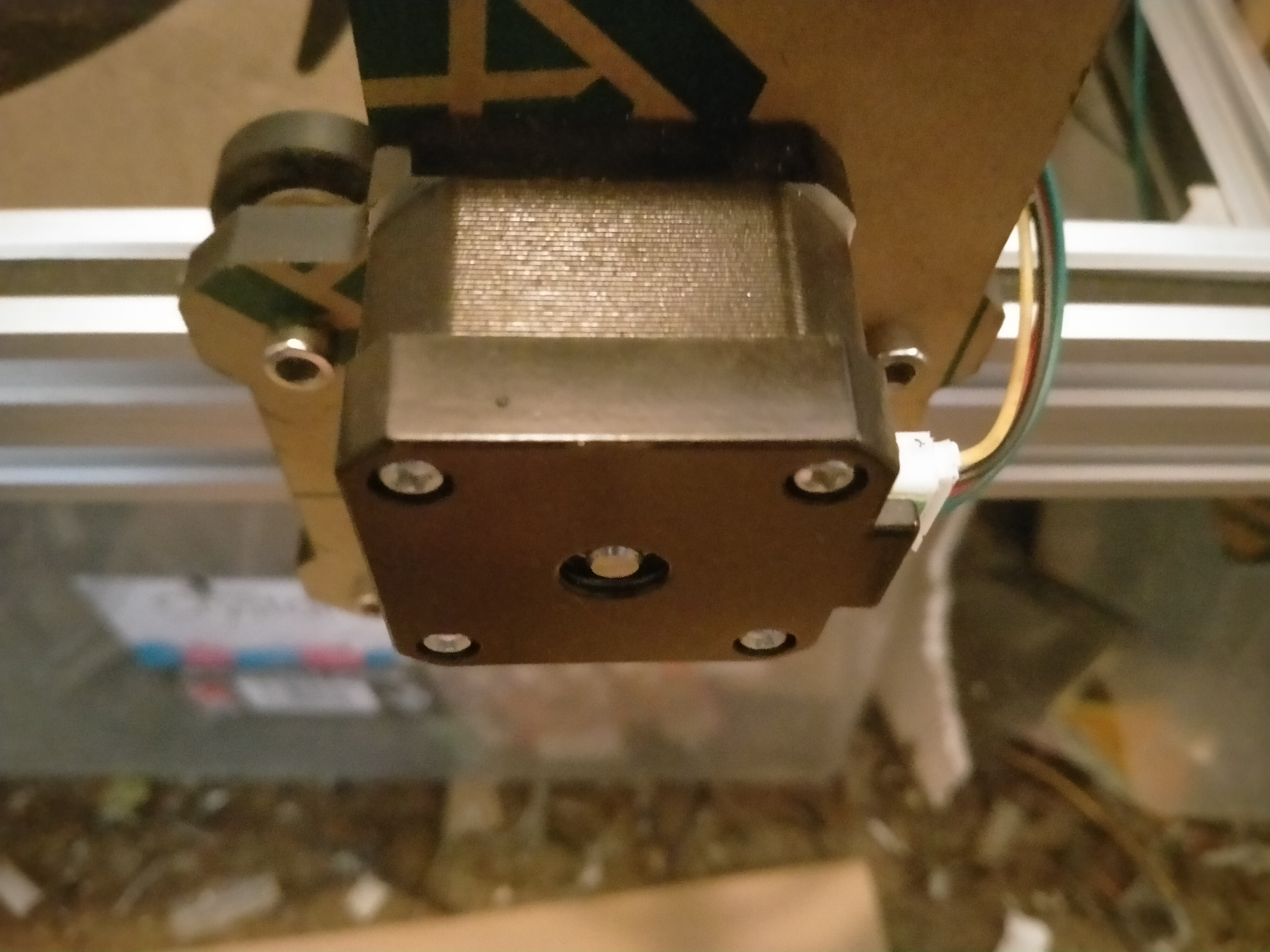

does it come with 1.8 or 0.9 deg motors?
Difficult to say - they are unlabelled, a little smaller (shorter) than a Neema 17. They have the same 6-pin connector, so I’m guessing they are cheapo copies.
I seem to remember that for 3D printers the 0.9 motor gives better results (less VFAs), but I don’t know whether the same thing applies in an etching/cutting scenario…
NEMA17 only applies to the footprint, not the length.
Unlabeled almost always means 1.8° motors.
you might be able to figure it out if there are no numbers on the motors to find the specifications from looking up. To figure it out, you’ll need the steps per mm from the firmware, the micro-stepping set on the stepper driver board and the size of the belt drive gear on the motor.
Yes, 0.9 will get you better resolution than 1.8 and on belt drive systems, as opposed to screw drive, it’ll be more noticeable.
The small NEMA 17’s on K40 laser cutters are 0.9 deg motors. I was surprised at how low power and small they were also but when the laser head is light they don’t need to be too big. CO2 lasers have much lighter laser heads than laser diode machines.
I’ll see how it performs with the supplied motors. Fortunately I have several spare steppers lying around and I’m pretty sure that at least some of them are 0.9, so I can swap them out if the quality is a concern.
PS - Michael, I’ve learned something new today - didn’t know that about the footprint.
