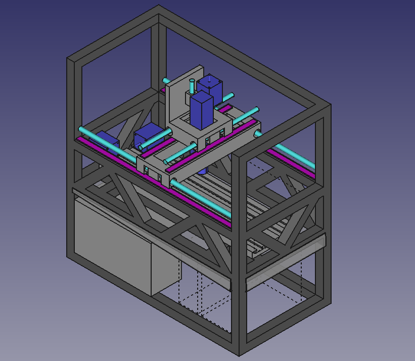

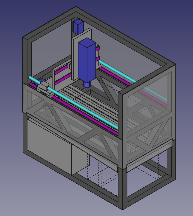

Here are a few FreeCAD screenshots of where the design stands today. You’ll note that there are a lot of missing parts. This CAD model mostly serves as a starting point for a discussion of the major components and where they are located.
Rails are in pink.
Motors are in dark blue.
Ballscrews are in light blue.
The tube-steel frame is in dark grey.
Front:
Side:

Ok, I just merged a new CAD model and the beginning of a bill of materials into the Chella mill codeberg repo’s main branch.
The Y and Z axis need to be reconsidered as the positions of the rails, ballscrews, and motors are goofy.

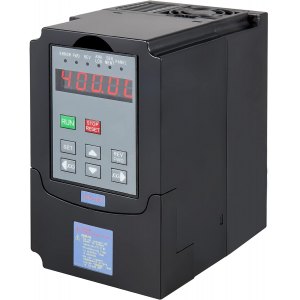

You’ll actually want a single-phase 220V VFD and three phase AC motor. The VFD will put out three-phase at a variable frequency. There are ~infinitely many cheap VFDs out there that are more or less clones. One issue is that some will say that they talk RS485 / modbus but there isn’t a lot of protocol compatibility between them. Most of them can be speed controlled from the display directly, or remotely by a reference voltage, generally as a 0-10V voltage, and breakout boards specifically for interfacing with 0-10V speed control are available.
I think this is the big brother of the 1.5kW unit that’s on my belt grinder, which allows me to remote the display from the unit with an RJ45 cable (ethernet cable, but not ethernet protocol, it’s just wires) and does not have modbus:
That obviously won’t do anything for your interest in someday doing spindle indexing, but could help you hit your cost target for the whole thing. :smiling_face:

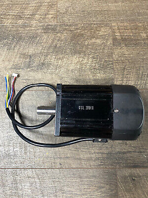

For a motor, most mills this size are moving the work not the head, so the spindle motor might be more of a challenge. A 2.2kW TEFC three-phase motor is often going to be pretty big. I see a lot of 56C frame motors of that spec. The motor on my PM-30MV is smaller, but still substantial for something that’s going to move around on a gantry in two axes:

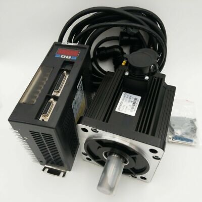

You probably want to search for an AC servo motor. Here’s an example NEMA52 AC servo bundled with a VFD that can talk serial:
Thanks to your advice and some research, I am coming to the conclusion that an AC servo motor makes the most sense in every way except cost. :slight_smile:
It can be lighter than a TEFC motor and I won’t need an external encoder on the spindle to interfere with my desire to eventually add ATC.

I’ve rewhacked the gantry design a bit now that I’ve had a chance to play around with various options. It turns out that the shape of ~every moving gantry out there is a pretty good shape. :person_shrugging:
The current placeholder model for the spindle isn’t right as I intend to buy an unpowered head and drive it with a servo.
