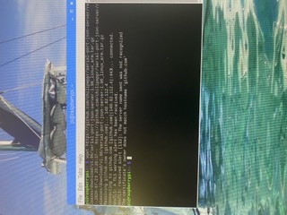

I am am new to this, I have been trying to load this with that command for two days at work and I can’t get by the first line that you posted above, the https is highlighted in red with a syntax error: invalid syntax. I am guessing that I don’t have wget installed but I can’t install that either.
Hmm. Can you post a screenshot?
sorry don’t know what the allowed size is, I cant just do a screenshot because I don’t have a connection here at work but now I something different maybe due to restart.
If you cant read it at the bottom it has certificate’s owner does not match host name ‘github.com’
I think you can do a non-SSL version of that link to download the file. Maybe try that as a workaround.
You probably have a corporate proxy that takes over all outgoing SSL. You can hope your corporate proxy is doing its job right and get no worse security than a non-secure http URL by providing the --no-check-certificate option to wget.
