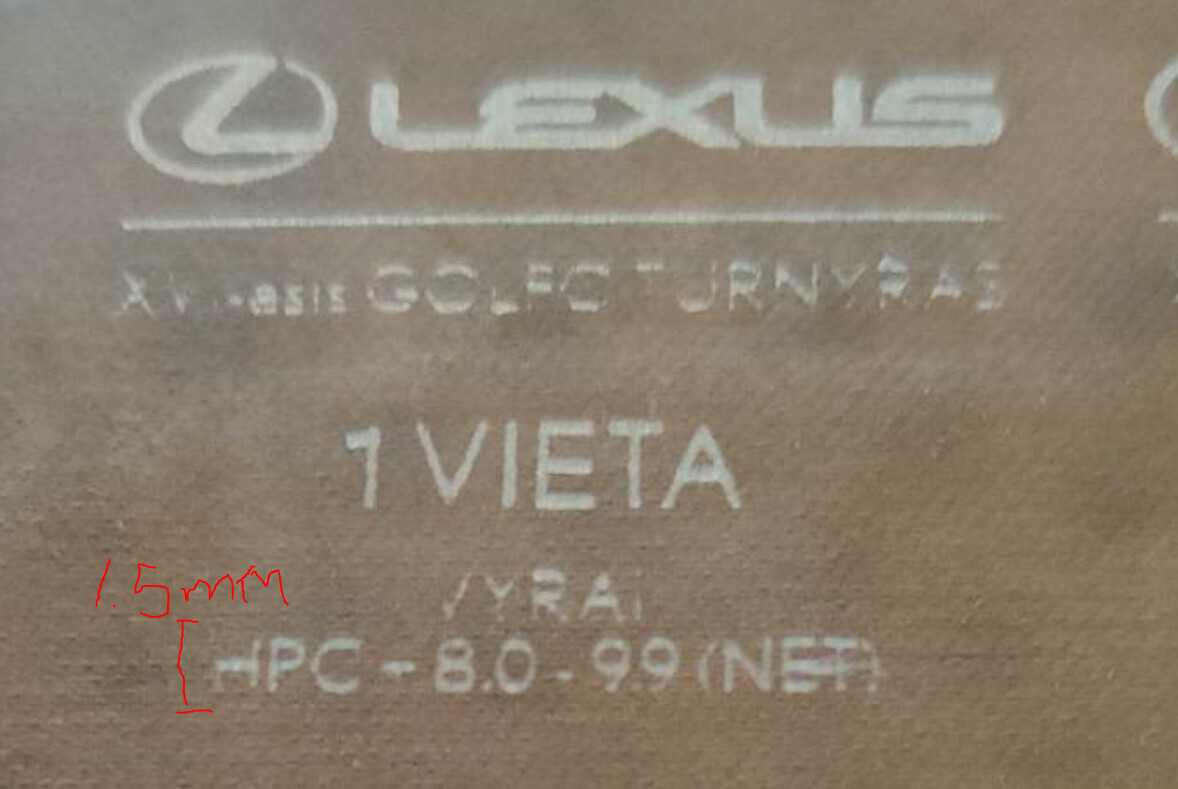

Hello everyone,
I bought an 80W Chinese red laser With Ruida 6442.
I am trying to engrave small (1.5mm height) text and it missing details. I have tried various settings the best working is 300 speed, 25% power, and 500 Lines per Inch.
The lens is 18mm FP 50.2mm - maybe buying a new better quality lens would help? Or select the one with a lower FP 38.1mm or even 25.4mm?
Or it’s simply a Chinese-quality laser and I can’t do anything about it?
The bigger engravings look quite nice.

Would it help to buy lower focal point lenses? 38.1mm or even 25.4mm? or its just laser limitations? Maybe new mirrors would help?
I have no direct knowledge here! But I personally bought a 100W laser because I wanted to cut more than to engrave, and am expecting lower engraving quality as a tradeoff for higher cutting power. I have read that higher power tubes generally have lower resolution because of the greater energy needed to “strike” — @donkjr were you the one who explained this to me?

Thanks for your response. I have ordered, lower FP lenses will let you know how much it helped.
CW-3000 yea… it sucks. I have disassembled it and to out the radiator and put it in a separate 50L water tank. So in CW-3000/laser system flowing distilled water and around the radiator cold water from the “vell”, if outside +30C it might need a few water changes, its sucks but at this moment don’t want to spend 600$ real chiller.
What you are getting is the result of excessive speed - notice your verticals in the last 2 lines are fainter/missing because the laser does not have time to “ramp up” the power at that speed - try slowing down to +/- 100mms and see if that improves it. A shorter focal length will likely help as well but I would suggest checking your speed will be as effective. Just FWIW. Cheers
