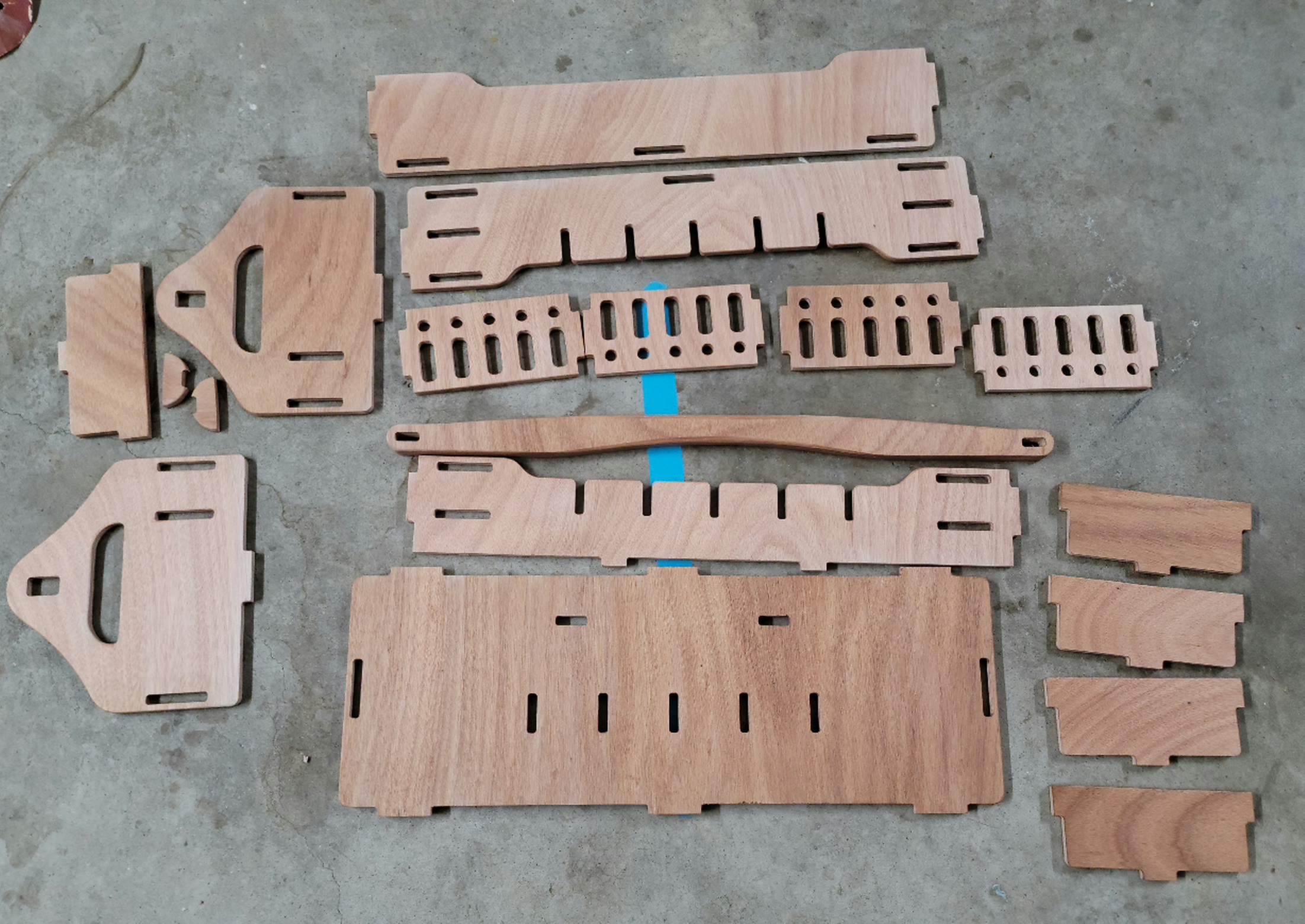

As I prep for beginning my wooden boat journey, I built the CLC Tool Box as a sort of easy starter project. Unsurprisingly, CNCed marine plywood is much the same as it would be off it were laser cut.
Here are the components messily knolled. At this point I think that I had done a quick 80 grit sanding to remove the nubs and clear up the little fibers that were still hanging on.
Here is the assembled box. I sanded to 220 grit, wiped with mineral spirits and then applied paste wax. This box is likely to get pretty beaten up during the boat construction.

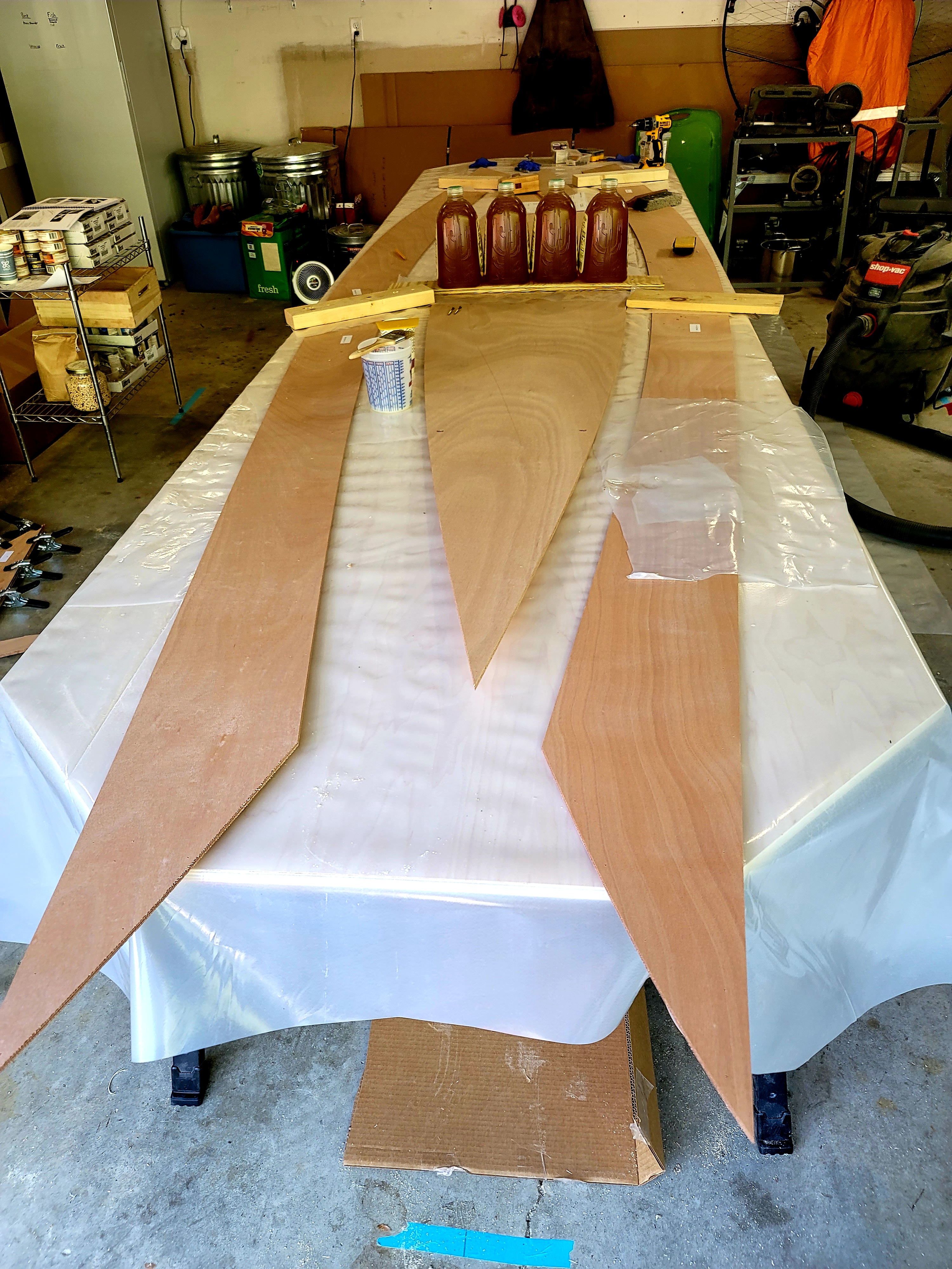

I have glued up the puzzle joints for the frames and also the skeg. This is my first time working with epoxy. I was a bit nervous about messing it up. The instructions mentioned making the epoxy a mustard consistency. What kind of mustard? Grey Poupon? Dijon? Yellow Mustard? In the end, I made it like a yellow mustard, I think.

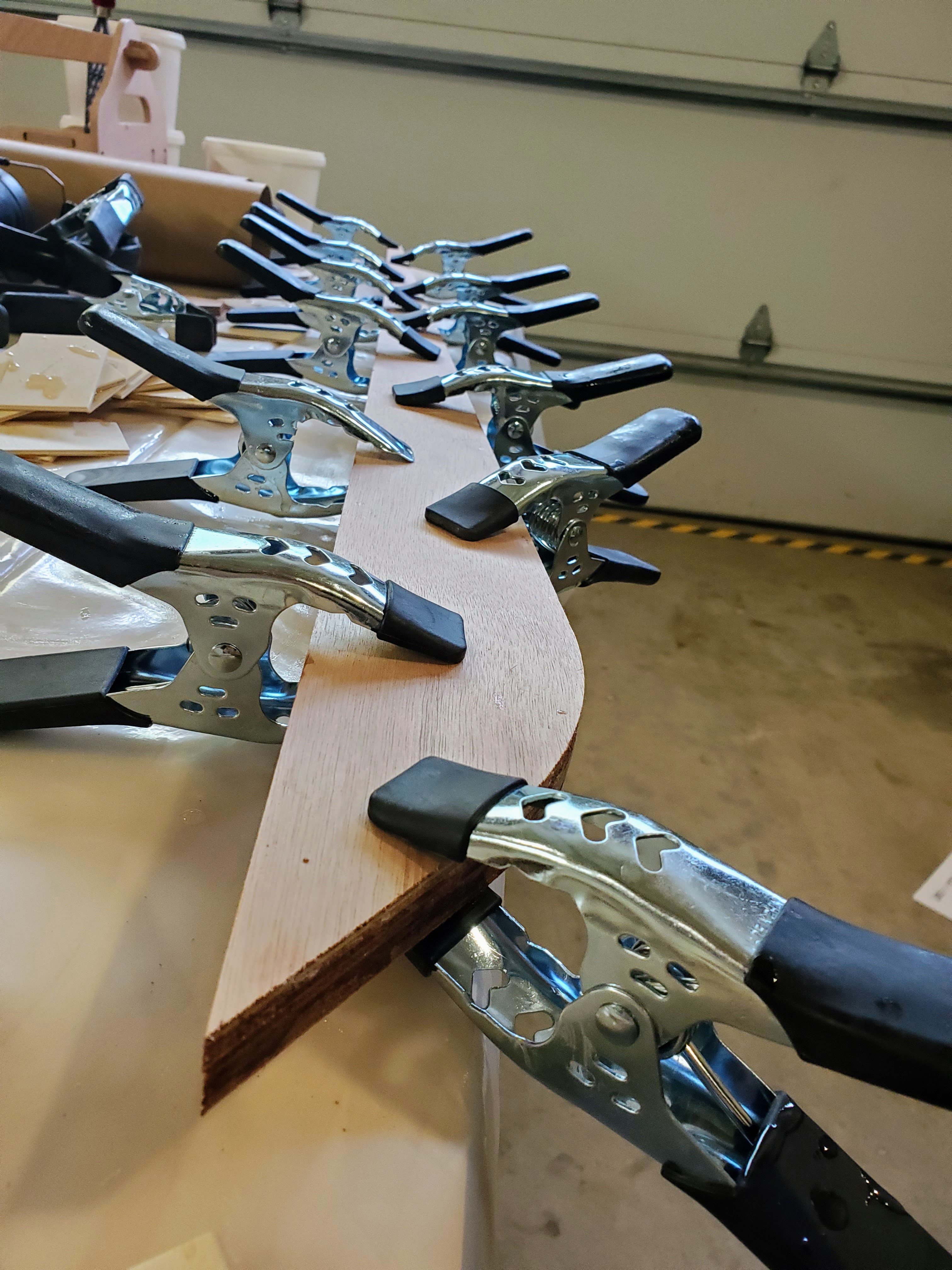

Here is the skeg, clamped up. Initially I had put those little pieces of ply under the clamps but I was worried about glueing them to the skeg with any epoxy overrun. So, I removed them. I will cut up some plastic to put under each piece of plywood in the future.

Once the frames have cured I will move onto epoxying the doublers onto them. After that I can sand the frames. I also need to epoxy the transom at that point.

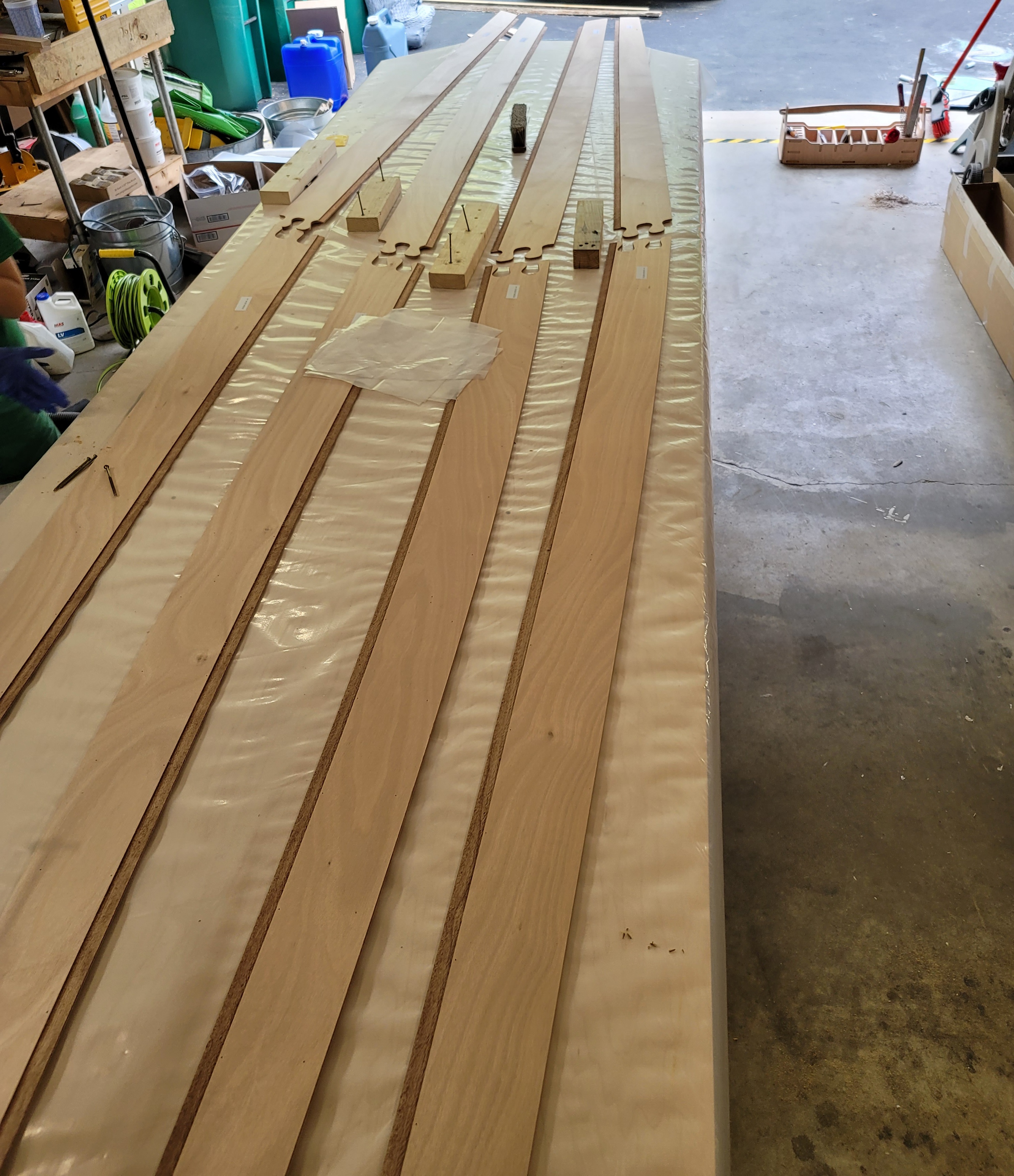

Here is the bottom and the first panel. The puzzle joints have been epoxied and are now clamped down to the table to ensure that they stay flat and married to each other. We’ll see how they look in 24 hours.
I have never used epoxy before this project. I have discovered that getting the epoxy to fill a joint isn’t as easy as one would assume. I have had to go back and force epoxy into dry joints after I discovered that there wasn’t enough after the 24 hour curing period. Not a huge deal but it is frustrating.
These are strakes three and four. You can clearly see the puzzle joints (prior to epoxy application.
Securing a puzzle joint for curing after epoxy application.

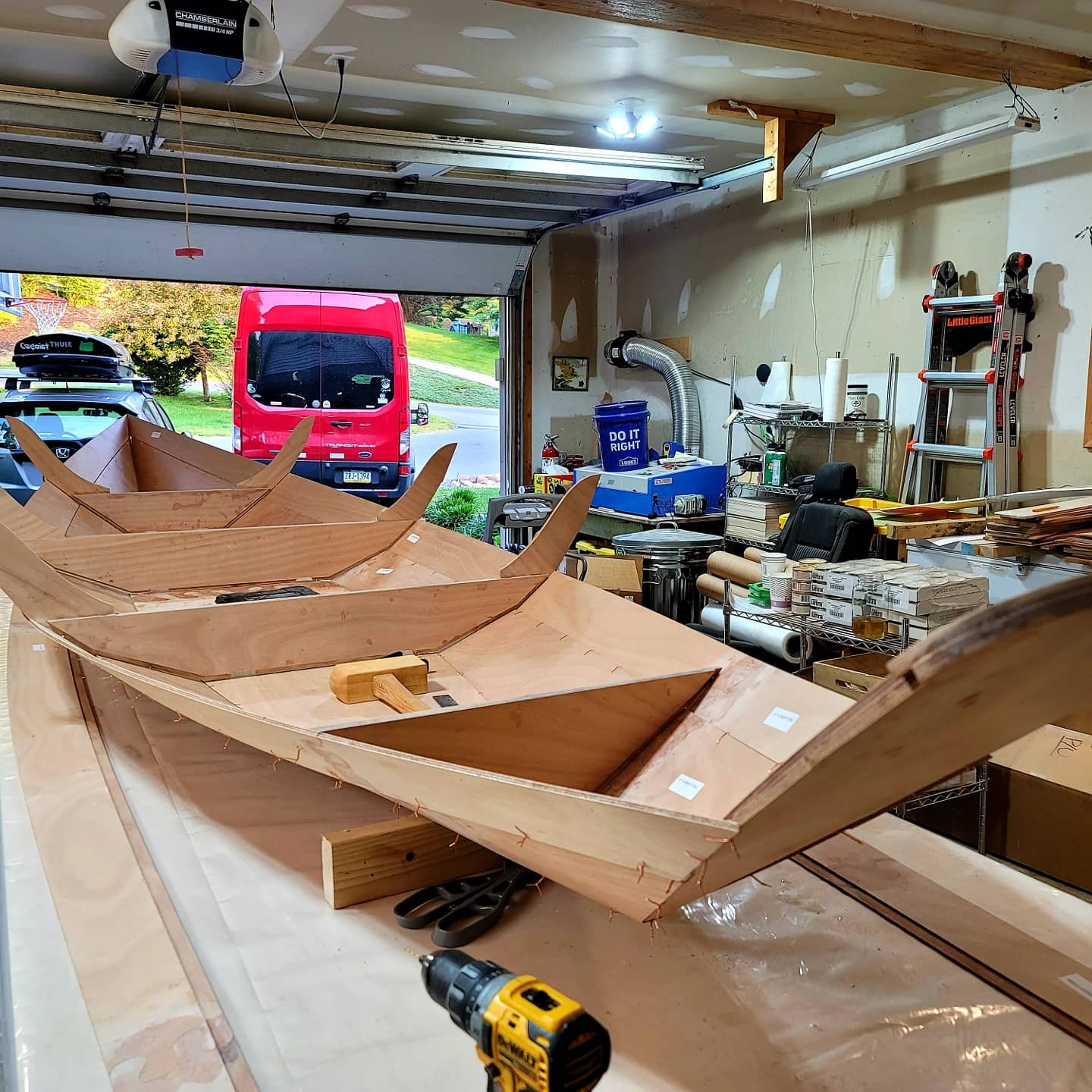

Things are going better today. My children, wife, and I began the stuffing prices for the boat. At this point, I have assembled planks one and two on both sides. Yesterday, during the stiching of the framesi ran into she tricks mating the surfaces. Got that fixed today. Here is the progress since last update.
Stern
Bow
Stern
One last of the bow

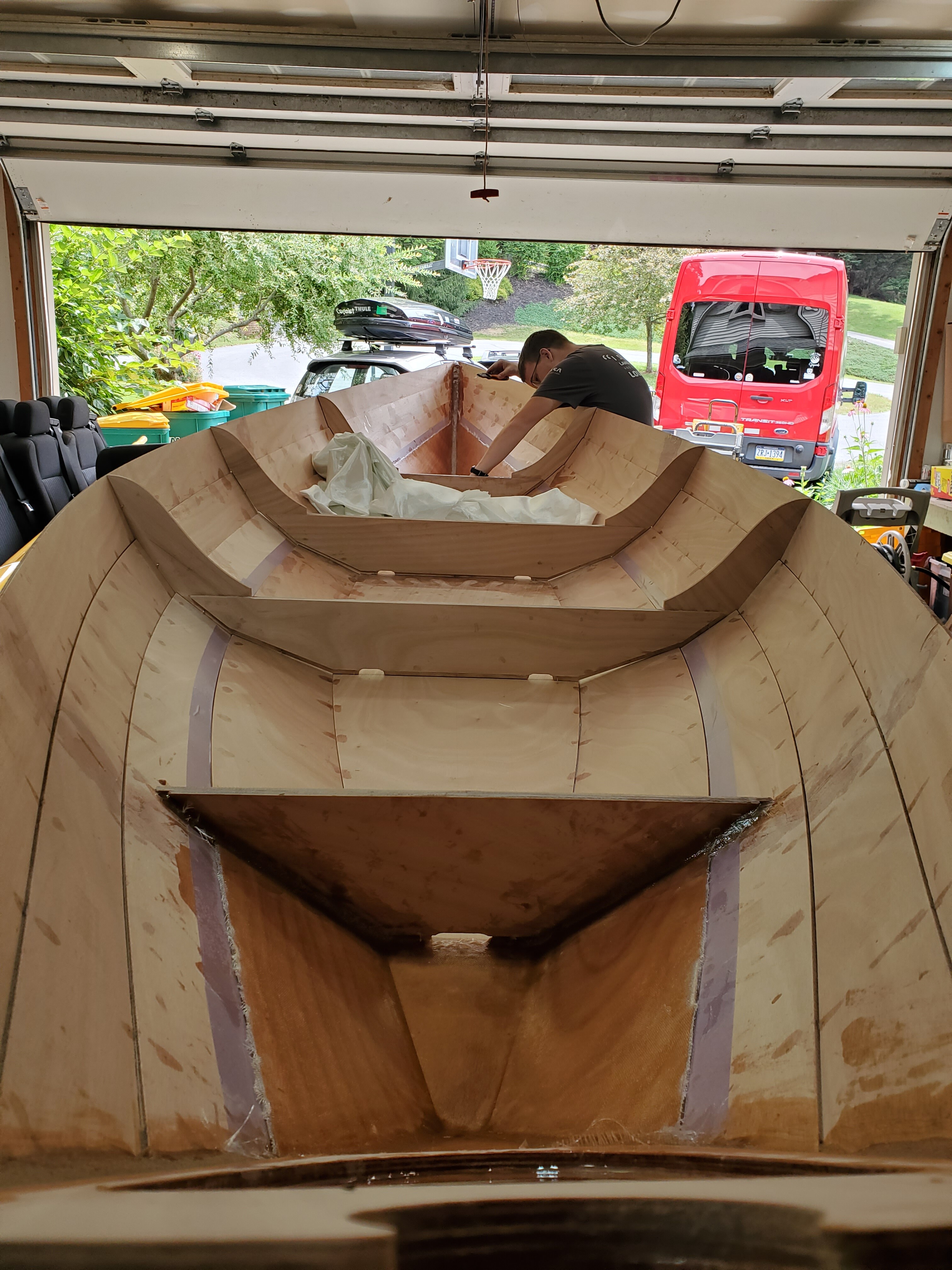

I have laid down the fiberglass on the forward and two rear-most compartments. First I had to fillet the bow and transom, along with the seams at the bottom of the lowest strakes.
I have also installed the breasthook.
Next steps: finish glassing the interior and then flip the hull to glass the bottom strakes.
