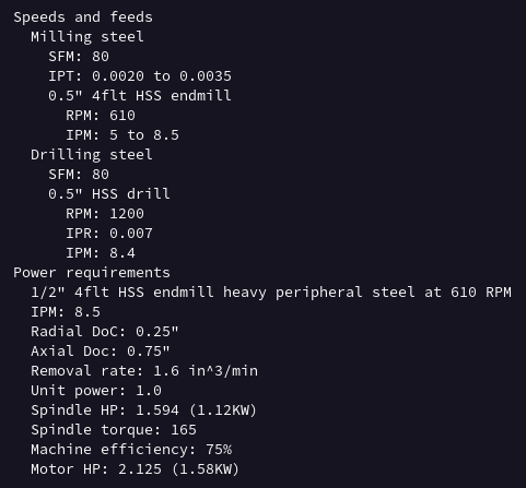

Here are my current numbers for target speeds, feeds, and power:
This is my first attempt at calculating power for a new machine design so if any of you have more experience and want to weigh in then I’m open to suggestions.
There seem to be a couple of common spindles like this one from RATTM that have a BT30 taper and ATC but they all seem to be designed for higher speeds like 15k to 24k RPM, presumably for softer metals and plastics. For steel I want more like 600 to 1200 RPM.
There are also a few kits like this and this that can be belted to external motors so perhaps I could use a motor with the right power curve for steel.

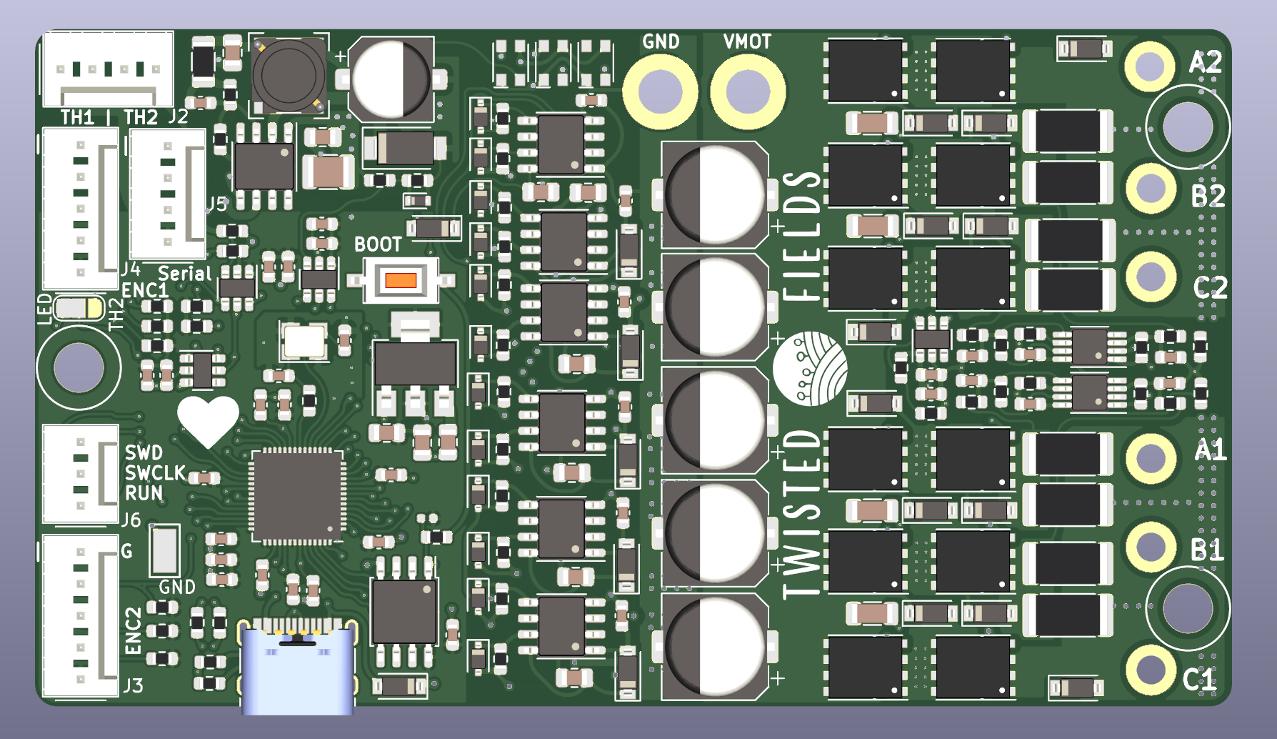

Linking to our conversation over on Mastodon, where Taylor mentioned another open source controller under development that’s a closer match for a machine servo controller, and is inspired by their work.
At this point, it’s still alpha with needed changes, but it looks interesting:
However, it doesn’t look like it has an option for using the position sensors integrated into the body of the servo. It’s clearly designed specifically to screw to the back of an open BLDC motor, not something to put in a mill environment. So it would require some redesign to be usable in this role.

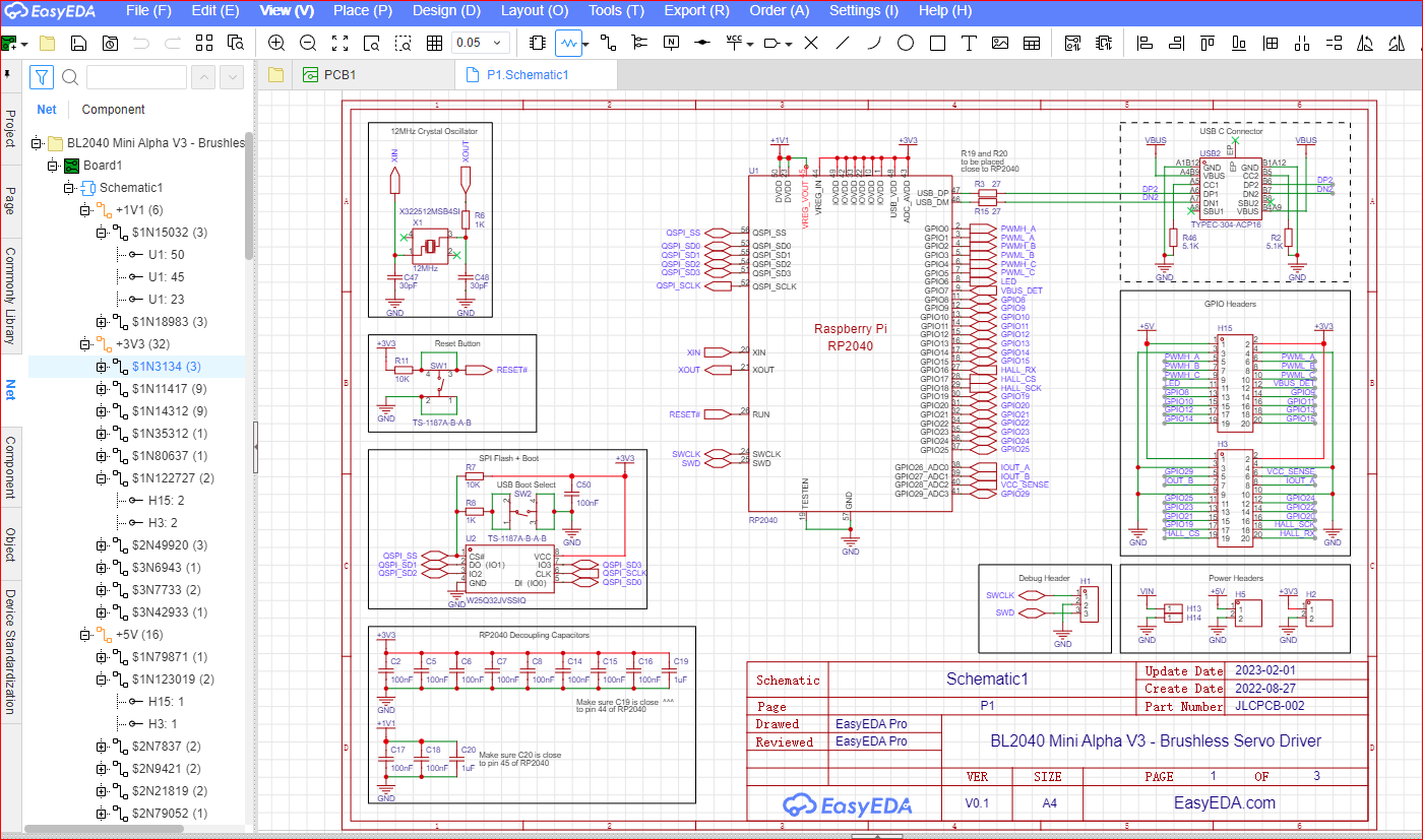

I’ve been reviewing the schematics for the current Twisted Fields controller. They added a whole second microprocessor and I think it owns at least CANBUS and E-stop comms/control. I think that’s not too hard to drop here, but because the schematics very heavily depend on named nets and draw very few wires, I’m finding it hard to trace with easy confidence. Of course I do the same with my own circuits to avoid a mess of wires on the schematics! :relaxed:
Don’t know if you are aware, but if you open the “net view” all the connections for a net are shown and when you click on one, it will target (red crosshairs) that item in the schematic.
I found this helpful tracing stuff when the nets are drawn using the port indicators vs wires.
Ah, I was in the Twisted Fields controller in KiCAD, which doesn’t have all the blocks called out and labelled like nekosystem’s project in EasyEDA.
But KiCAD has an equivalent capability:
