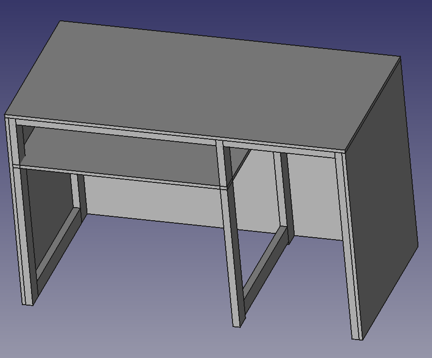

Ok, here’s a rough drawing of the bench. The pocket on the right is where I’m thinking of running the CNC mill. The lower left pocket is where the CR-10s5 sits.
The measured dimensions of the right pocket are:
height: 1160mm
width: 600mm
depth: 1140mm

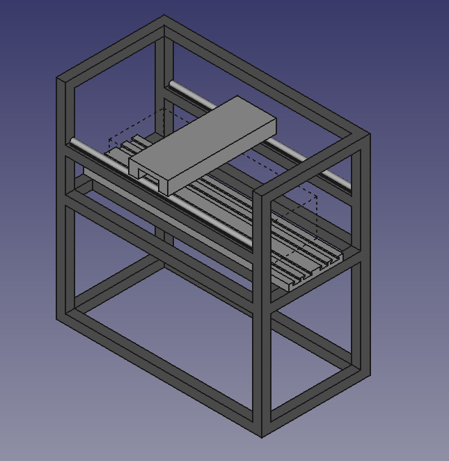

I’ve started roughing out basic shape and placement of the frame and table in a FreeCAD project.
The dotted box is the target motion envelope:
It’s all driven by parameters in one of FreeCAD’s spreadsheets so that I can play around with different options:
Here’s the same model with different parameters:

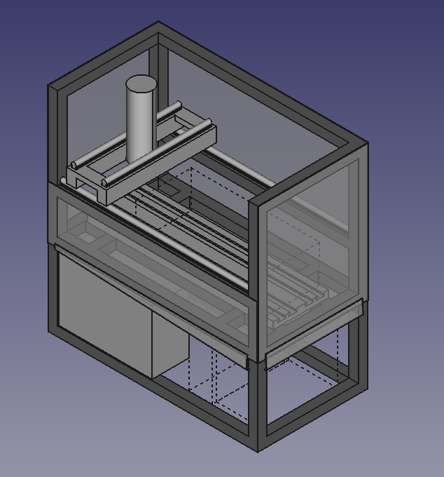

I sketched in a couple of tank+pump placeholders on the lower shelf as well as a tilted swarf and liquid tray below the table.
The control box sits toward the front on the lower left.
With the total footprint that I have for this and the cutting envelope that I want (dotted lined box above the table) I think that I can leave space on the left side of the table for some sort of ATC rack.
