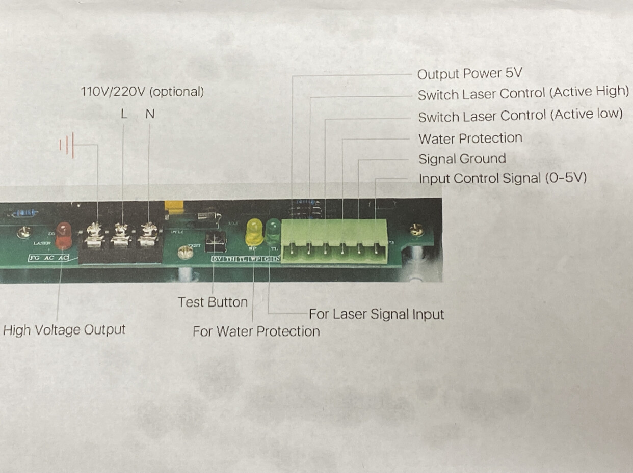

A picture of the LPS input connector would help unless I missed it.
This is the Amazon listing that I bought the power supply from:
I don’t know where I found this image, but it does seem to coincide with my setup.
FG is that ground that is on the left of L in the leftmost screw terminal block. It should be directly wired to the frame and the cathode should return directly to here with a single wire. The cathode should not be connected elsewhere on the frame.
@donkjr
This seems like a dedicated place on the power supply for the cathode to return to. Is that not true? What is the intended purpose of this wire if not the cathode return?
Yup, that is the cathode connection.
You can check with a meter to see if it’s connected to FG while you have the unit unbolted.

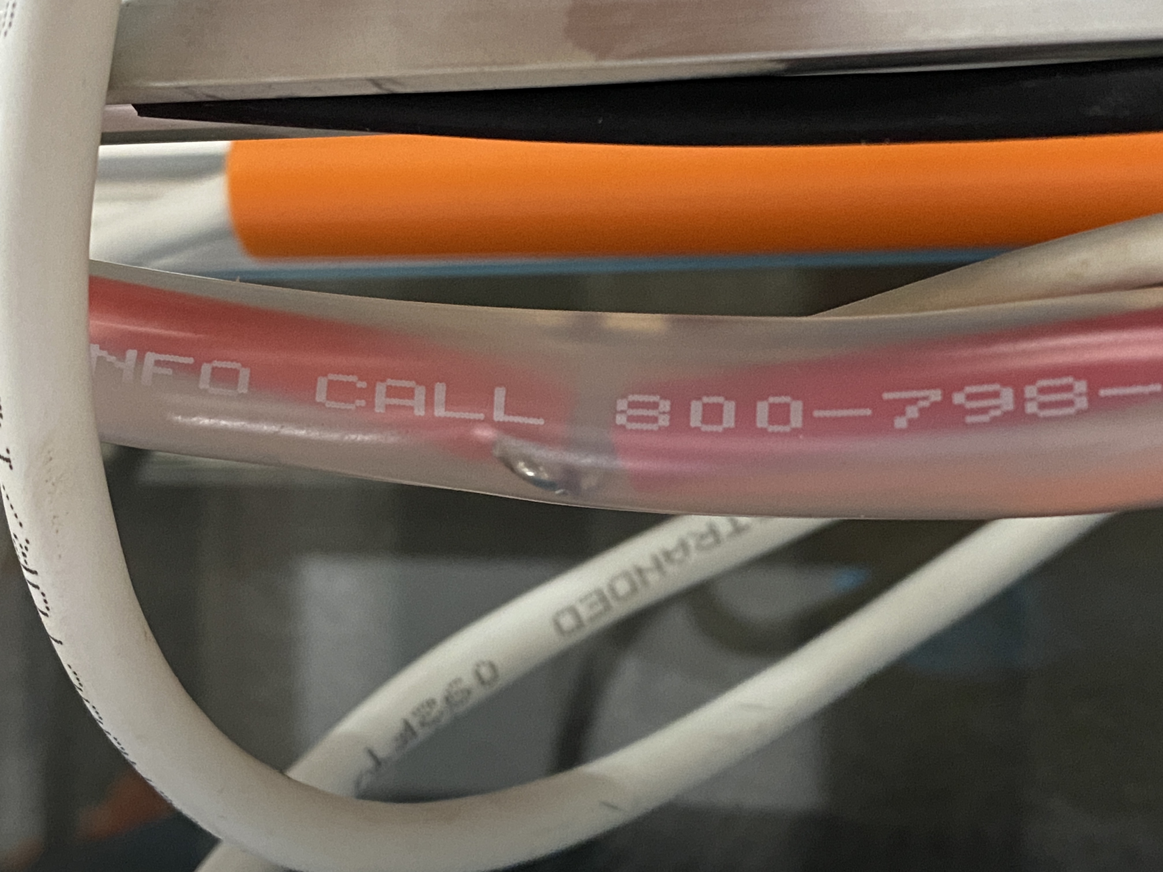

Well, today is dry and warm, and the machine is back to its old antics. I was even catching some arcing happening again so I lined the anode with some silicone tubing and then injected it with silicone caulking. Now its not arcing, but the Z-Axis is moving by itself again…
This is what the new anode insulation looks like:

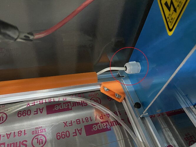

The wiring and Arduino now all reside within the machine. The Arduino is much more “directly” connected to the steppers and end-stops. The high voltage (110v supply) is also much further away from the low voltage (Arduino, 24v, and end-stops).
I just burned a design and made it all the way through without the z axis moving. I’m thinking that maybe the low voltage stuff was just too close to the high voltage or possibly the bulkhead connections I was using to pass the end-stop lines from inside the machine to outside the machine were susceptible to noise???

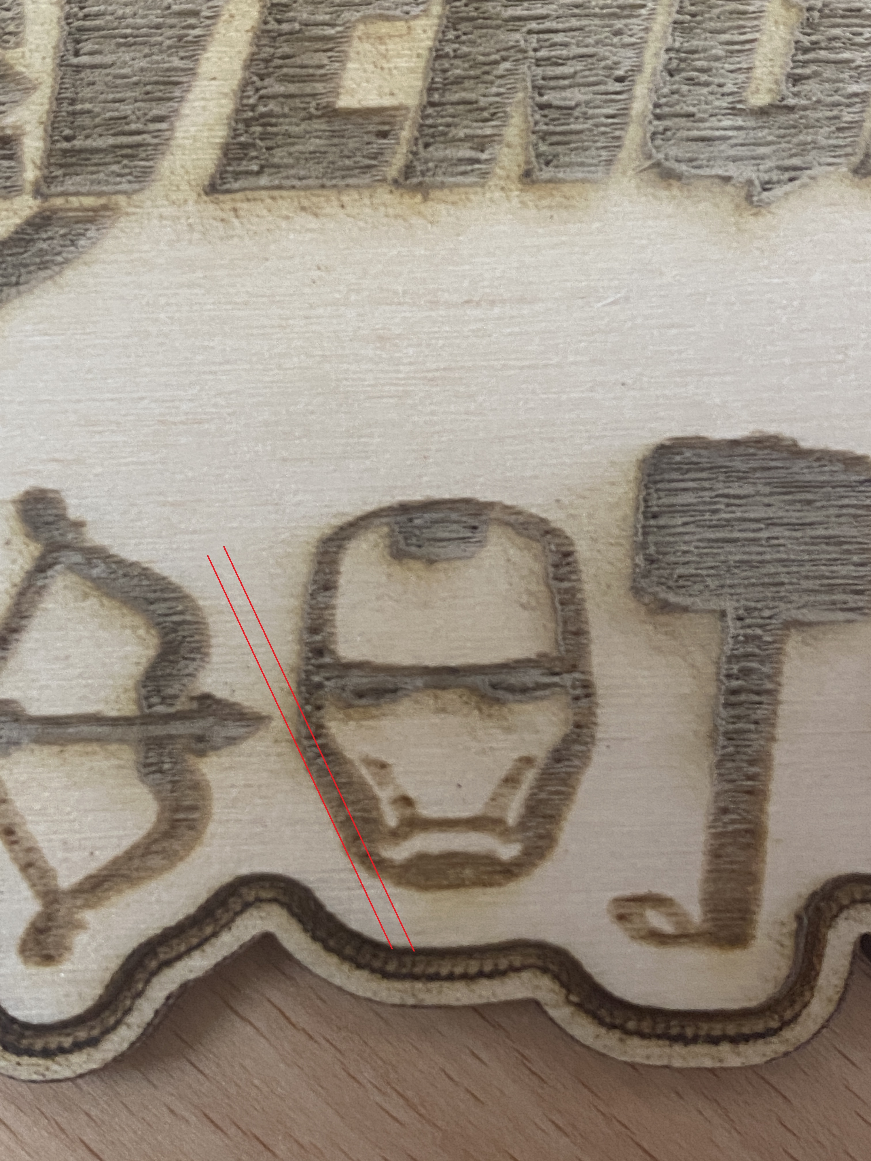

Anyways, a new problem arises. The burns look “blurry” now.
In the attached image of Iron Man mask, I have highlighted with red lines a portion that more or less shouldn’t exist. The area between the red lines (from right to left) is decreasing in burn intensity. The laser is creating valleys __/ instead of cliffs |__| and the valley portion \ / is adding about a half a millimeter to the design.
This makes the burn look very imprecise. Any idea what setting in LightBurn or GRBL to adjust?
Things I have tried:
  • Increasing Overscanning
  • Performing Scanning offset adjustment
For me this looks like too high speed and power for the engraving. Wood needs some time to get brown.
This could also be related to the PWM frequency:
Grbl on arduino is quite limited in PWM frequency settings because it only uses prescalers and the default is only 0.98kHz (see How to change PWM Frequency. · Issue #1398 · grbl/grbl · GitHub).
With 1000Hz PWM (=1000 pulses per second) the maximum feed at 0.1mm resolution (=pixel size) is only 100mm/s!
I got good results with a PWM frequency of around 2 kHz on the K40 laser. You might also test the 7.8kHz setting.

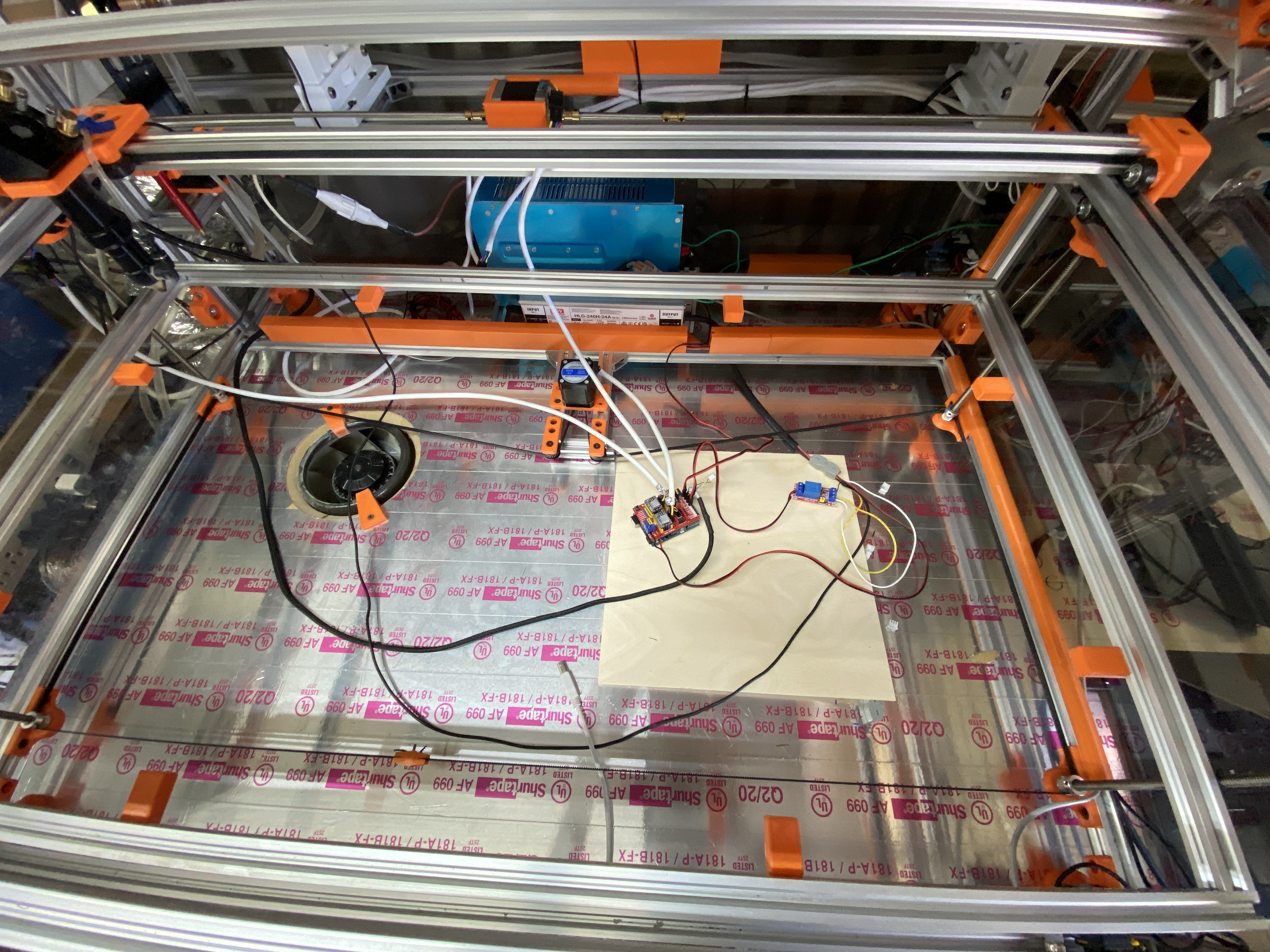

Can you post some pictures that show the new configuration you referenced in the last post?
@donkjr
I wish I could say my main issue was solved. I don’t want to say that because it puts my integrity into question :slight_smile:
I reconnected the Arduino, this is what the setup looks like:

@cprezzi - yep, it was a PWM issue. I reprogrammed the Arduino with the 7.8Khz PWM and the my valleys turned into cliffs! Thank you.
