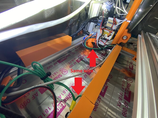

This is where I show it connected to the IEC Socket.
I disconnected the ground for the 24v power supply because it is the one that is connected to its own negative DC.
I would shorten the green grounding wire that goes from the LPS and DC supply to the frame, [that is bundled] unless there is a reason for the extra length.
I don’t see anything connected to V- of the 24V supply. Are the DC ground and AC safety ground on that supply connected internally?
How is the DC supply to the Arduino connected and routed?
How is the DC ground on the LPS connected & routed?
Post a picture showing the LPS connectors from the top if possible.
Post pictures of the ANODE wires routing

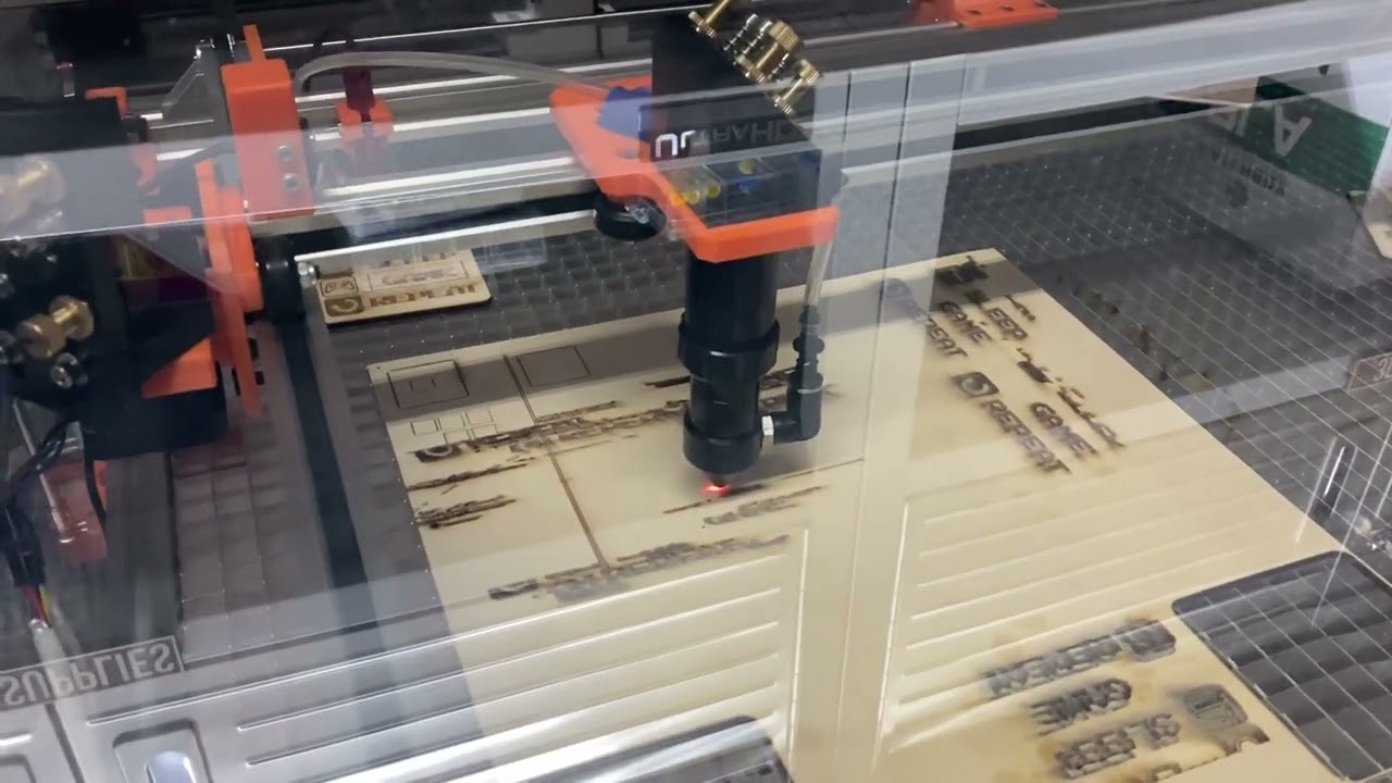

This post visually represents the strange behavior. In few words, when X is supposed to move left, it moves right, then 2 seconds later it moves left when it should move left, two more seconds it moves right when it should move left. Sometimes stopping altogether when it should be moving. It is erratic behavior.

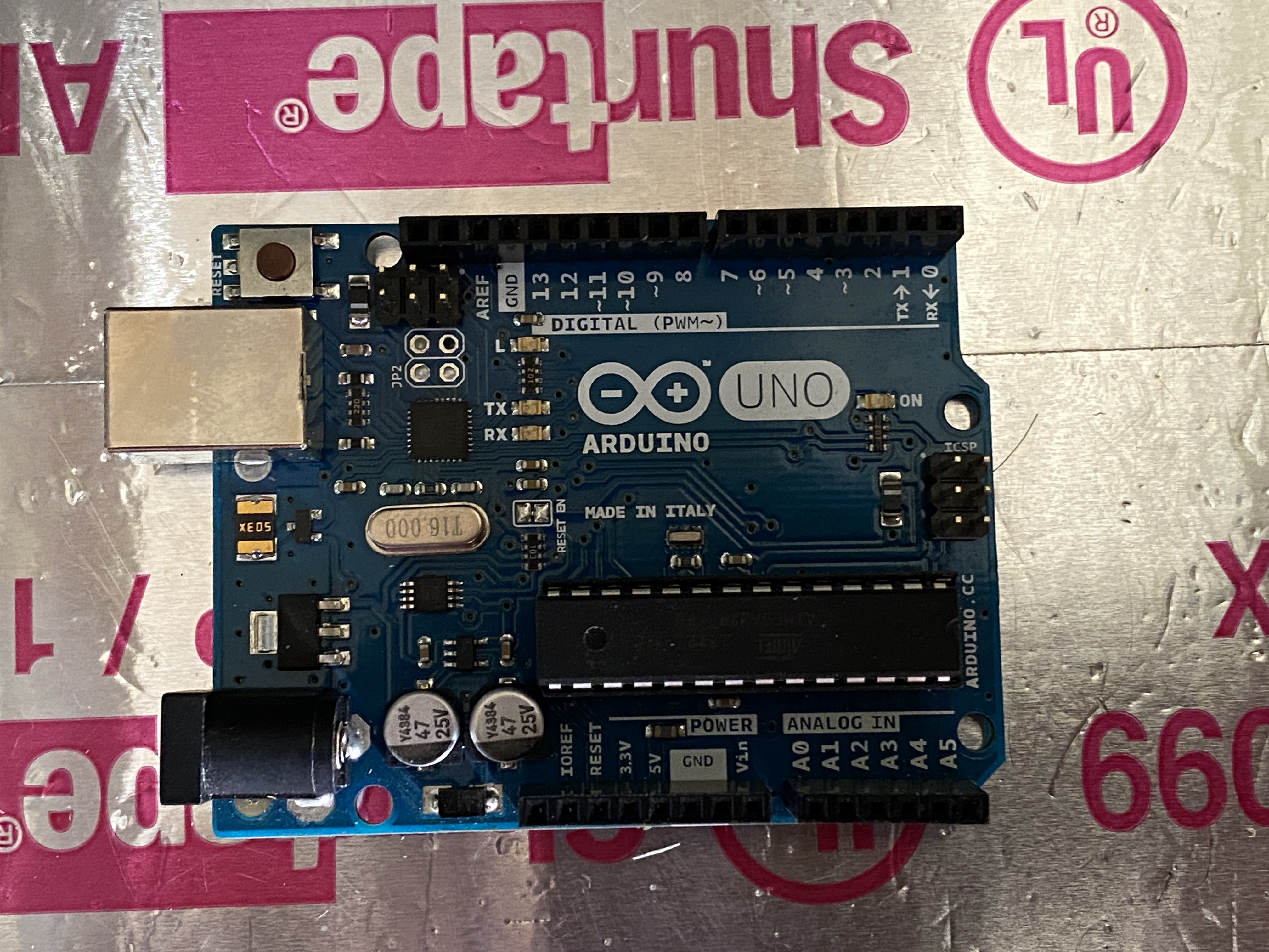

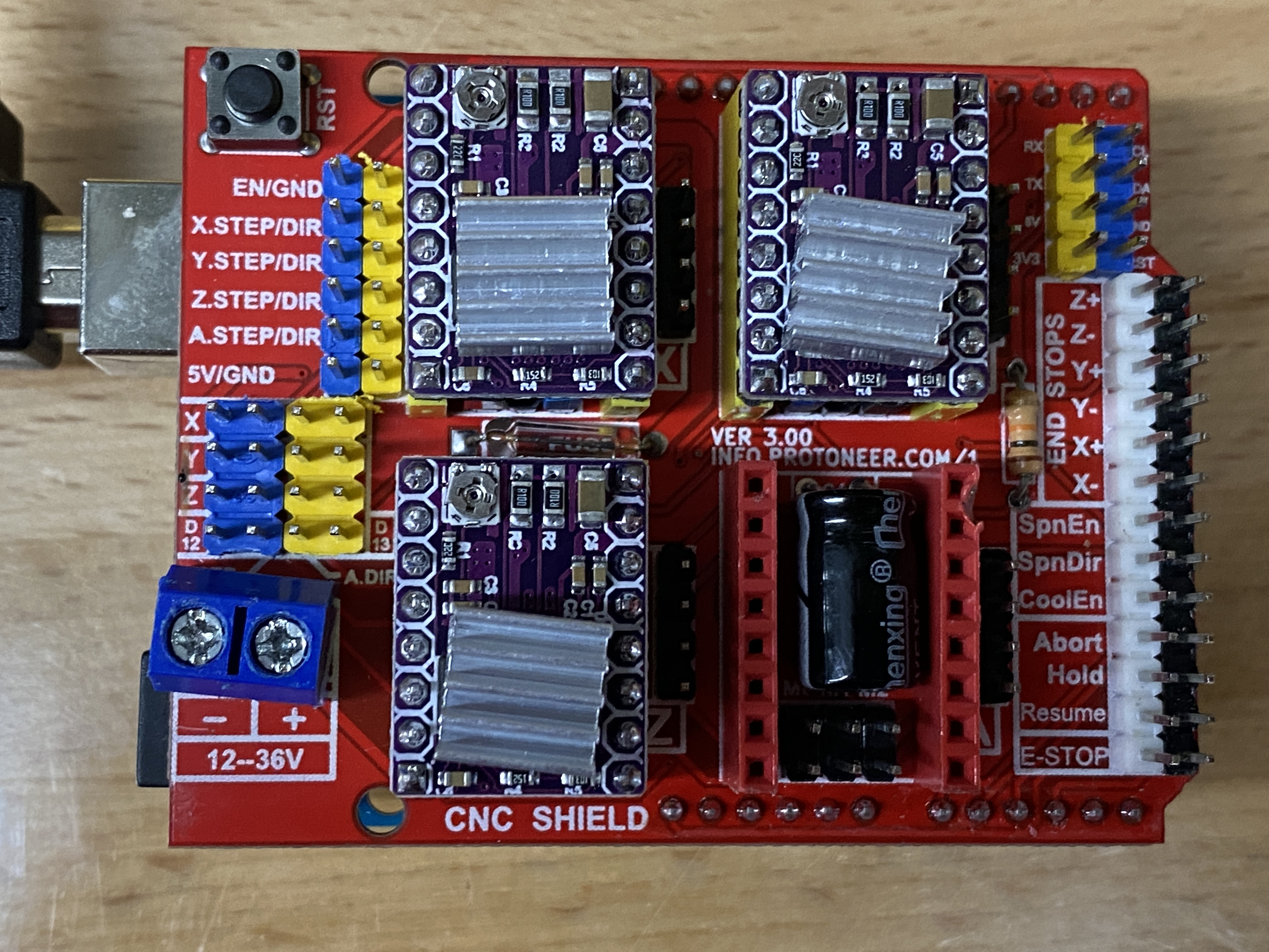

Here is the legit Arduino Uno board, prontoneer CNC shield, and I snip of the scope connected to a coil pair from the scope on the x axis. I’ll connect the scope to the power supply of the Arduino and upload shortly. :
We need to see how the Arduino power and ground are connected and from what.
Edit: I think I see it connected to a screw terminal at the lower right of the shield?
Provide pictures of its location, mounting and power wiring.
If I recall you have a 24v supply how are you getting 12v for the Arduino.
Stepper coil traces probably won’t be easy to decifer.
Yes, it’s the lower right. The CNC shield has an allowable voltage range input from 12-36v. I have attached a photo of just the Ardunio and CNC shield without any wiring so you can get a better view.
Currently the Arduino isn’t mounted to anything because I’ve had to dump the guts of my control box out onto the table to do all of this testing. I will get a photo of how it’s connected once I get it reconnected.
The Arduino can’t run on 24v so there must be a regulator/converter on that shield.
Do you have a schematic or can you point me to the manuf web site for that shield.
The reason I am poking at this is converters are notoriously noisy if not done right.

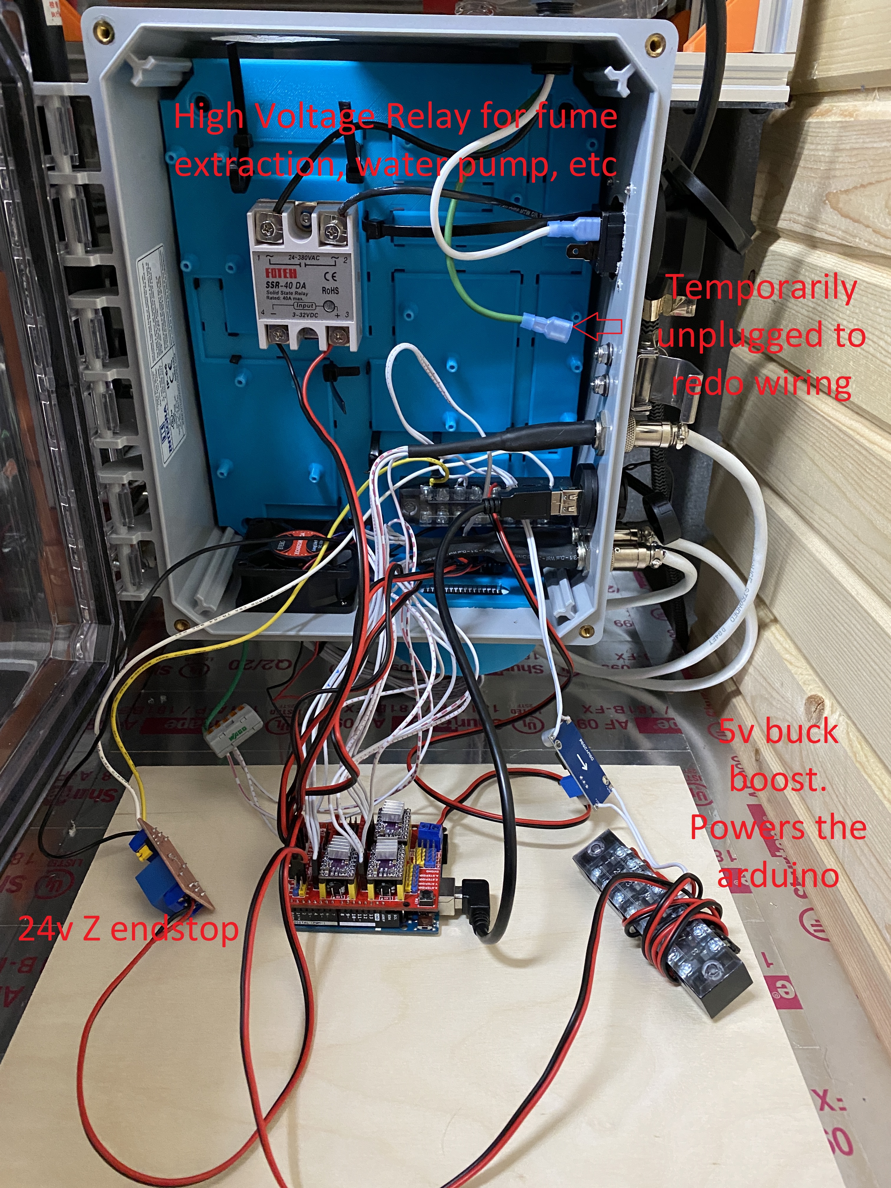

So the Arduino is in a separate box from the laser frame? How long is the wiring into the frame.

Here is the current layout:
Here is the website for the CNC Shield: https://blog.protoneer.co.nz/arduino-cnc-shield/
@dougl yes, the 5v could come from the usb port or the barrel jack or the CNC shield does have a 5v breakout pin that goes straight into the arduino header.
Just being clear here, the 5V pin on the protoneer is just a pass through, there’s no buck converting on the protoneer supplying 5V to the arduino, right?

Yes the Arduino is in a separate box from the laser frame.

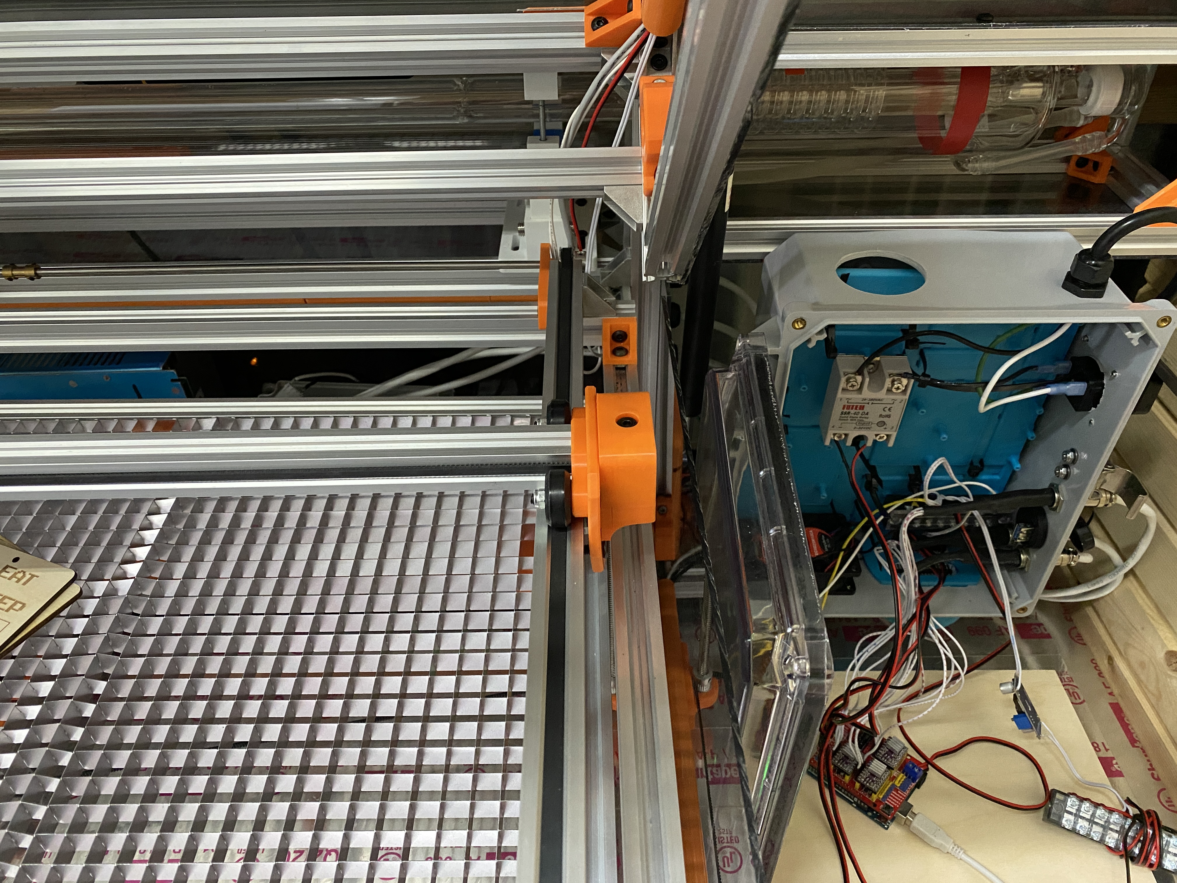

The stepper motor wires are at least a yard long. The end stop wiring is roughly as long as their corresponding stepper motor wires. The 24v power leads are 24 inches or so.
In this photo you can kinda see how far the separate electronics enclosure is from the laser power supply.

Thanks for photos I think we now have a full picture.
BTW: nice build. Many makers do not pay attention to wiring design and electronics packaging and it makes solving this kind of problem all the harder.
