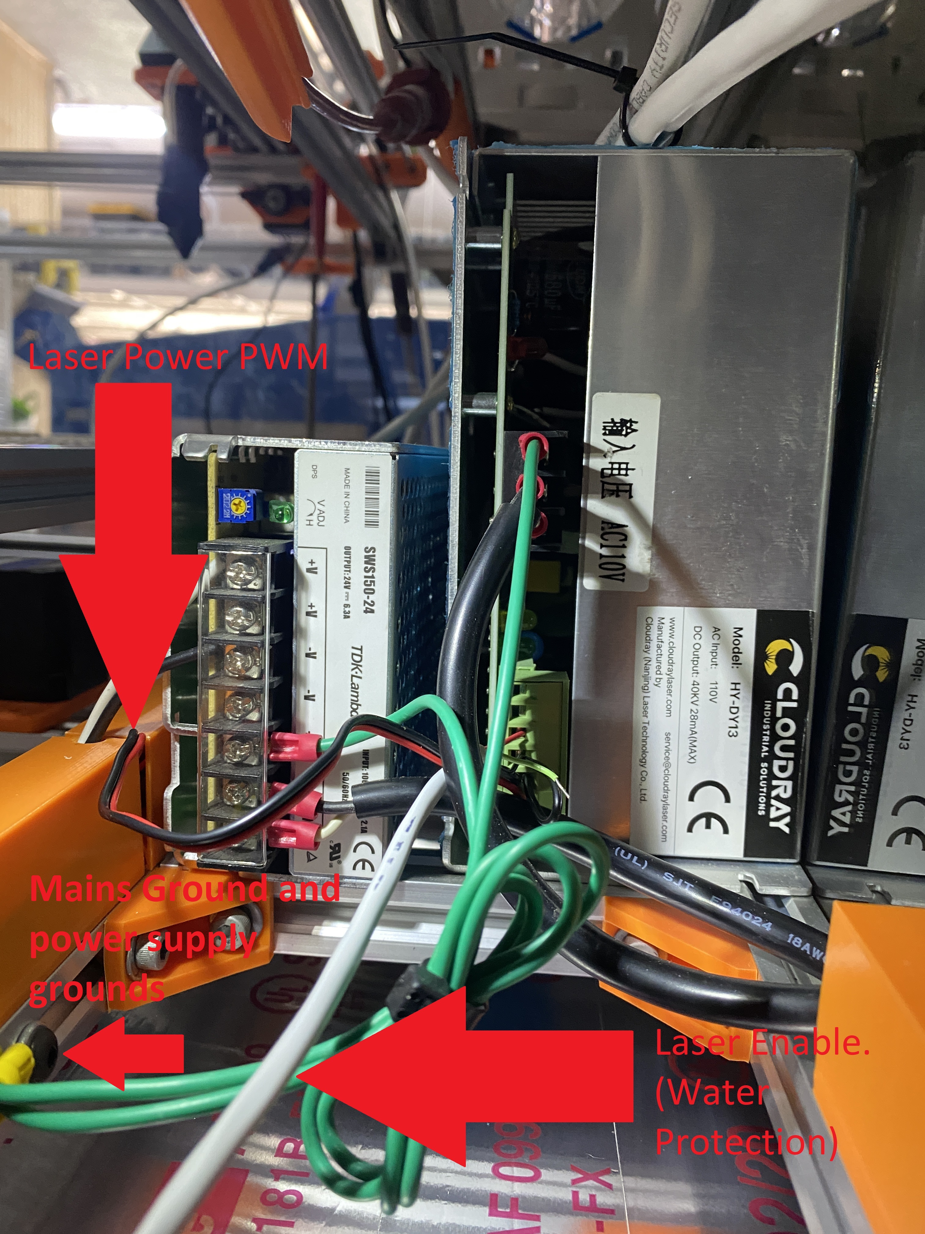

Here is where the cathode returns from the ammeter. It’s essentially a black box. I guess I could go taking apart the LPS…

Wiring between the LPS and the controller.
AND
Connector side of the LPS
There is really only one set of wires, and that is the laser power PWM wires:

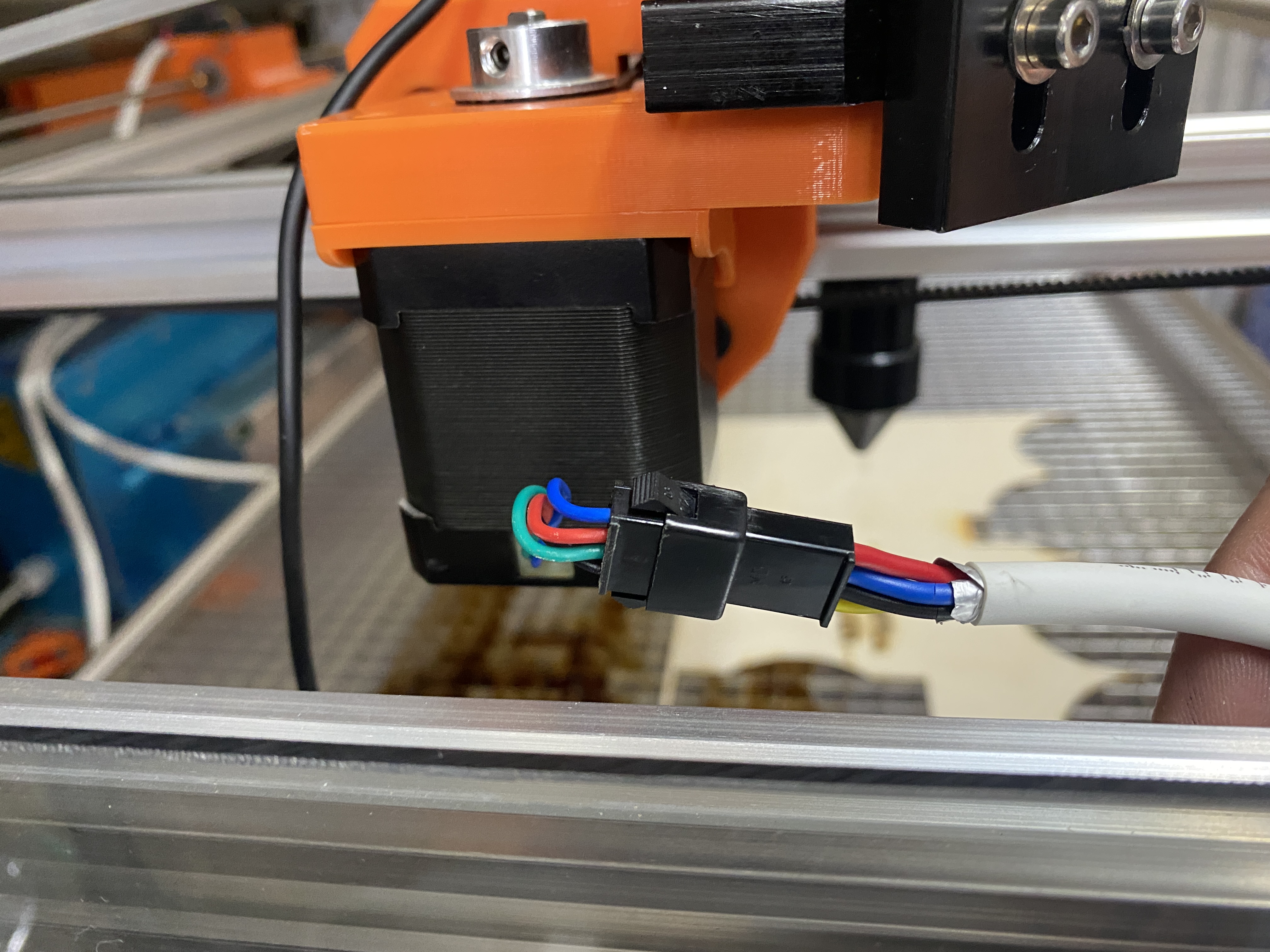

Wiring from the steppers to the controller:
All steppers use the same JST SM connectors

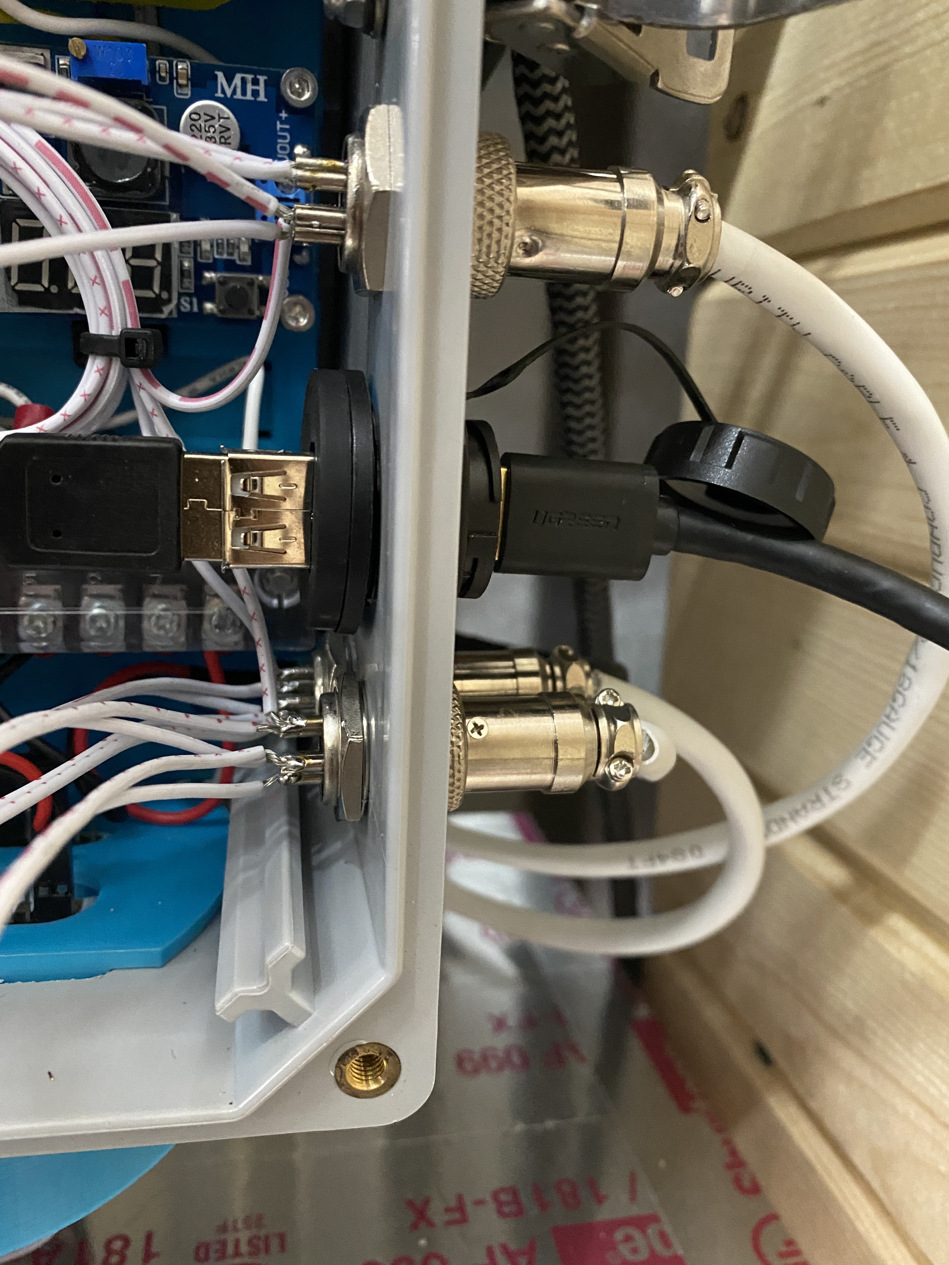

Aviator connectors. Slightly concerned about the connections on the inside of the box as they are a little exposed. I’m not sure how others have done up these connections.

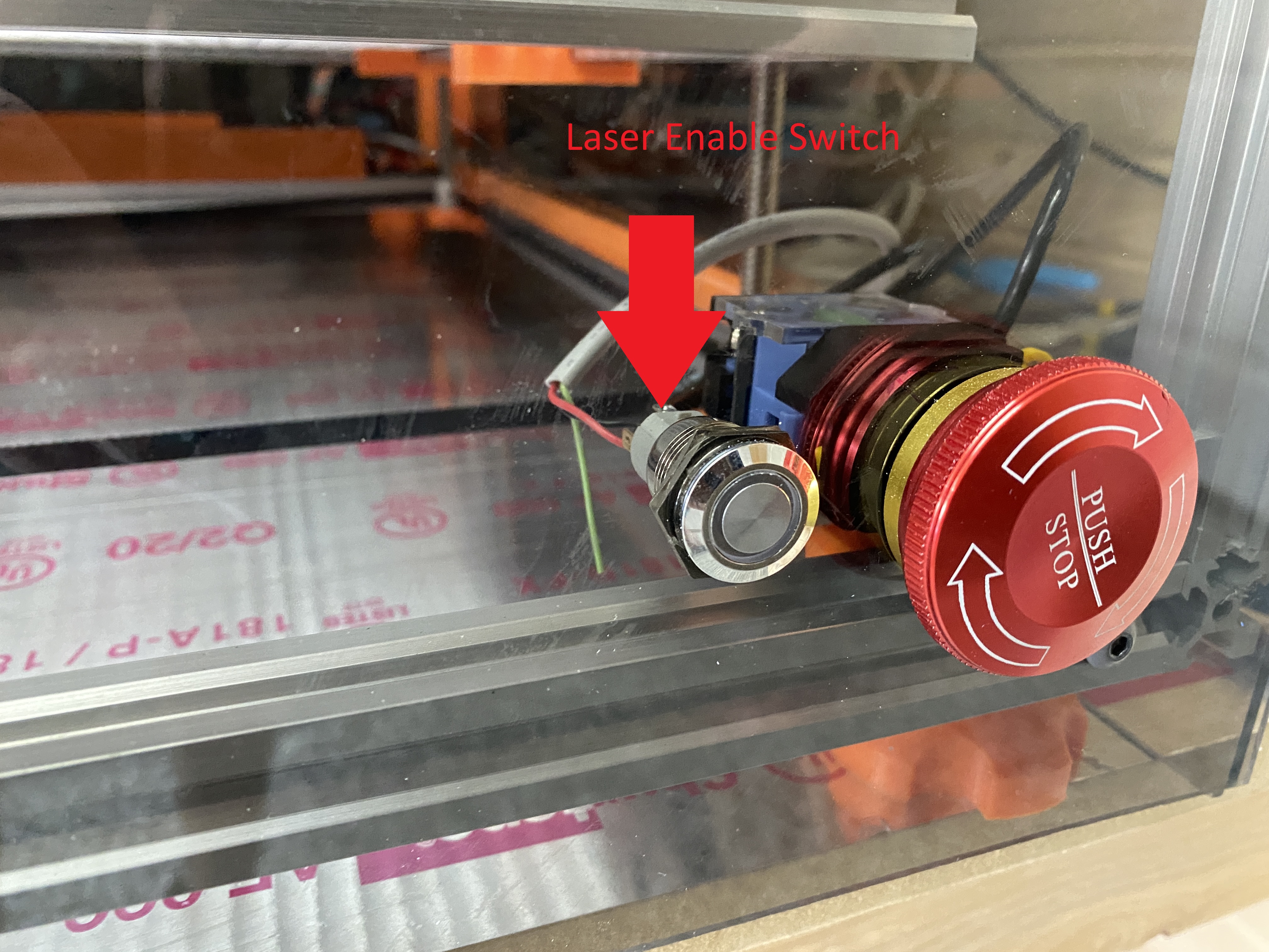

Wiring for this: I have a manual enable switch on the Laser Power Supply.
You can see the Laser Power Supply side of this connection labeled in one of the photos above. This leads to the switch shown in the image below. It’s really the water protection switch, I’m just using it for enable/disable.

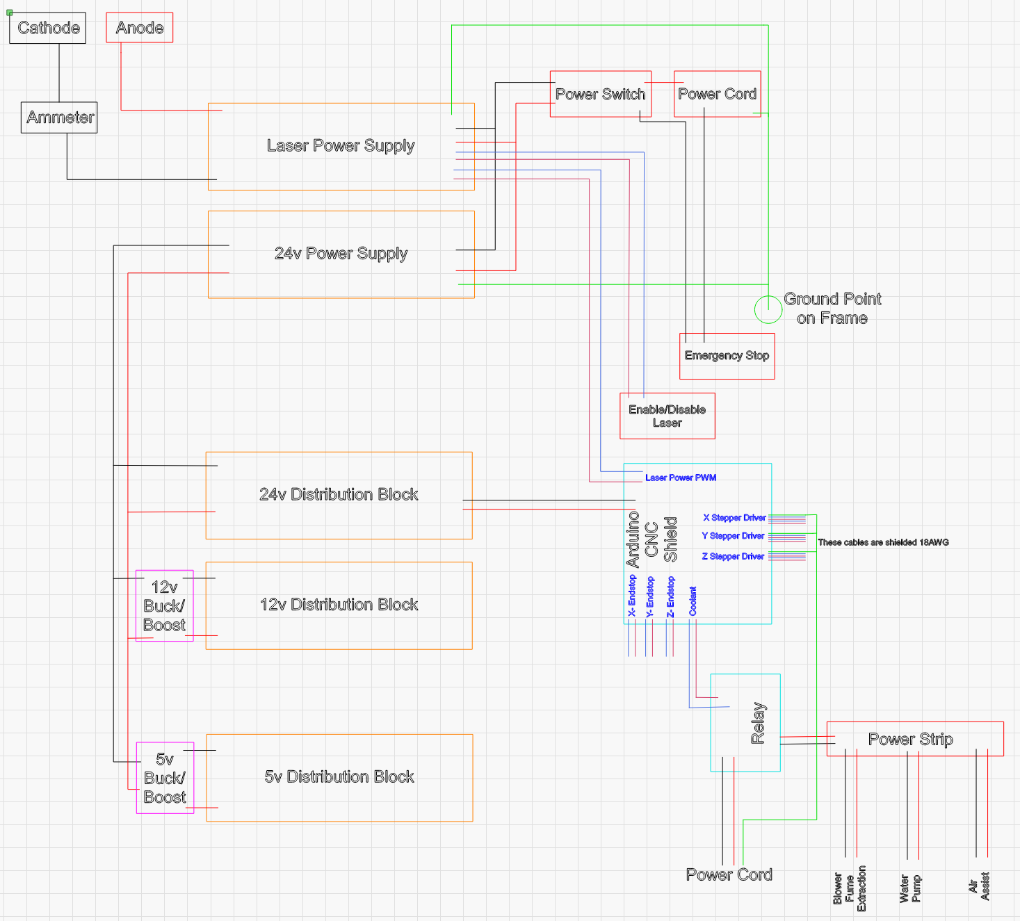

Do you have a schematic of the build?

I have labelled the images above. I do believe this is how I have the machine setup.
This is interesting. The high voltage stuff does come close to the laser power pwm line. The stepper motor wiring has been drawn as far away as possible from the high voltage stuff.
This is a lot to take in. Let me know what you think.
Edit: Updated Laser Schematic with Enable/Disable Switch
There is no ground coming from the IEC socket in your photo.
I can see that the two grounds from the PSUs are bolted to the frame, but there is no ground coming from the right side where the two AC/AC wires are coming from.
The two power supplies should be directly wired to the ground of the IEC socket.
A ring terminal bolted to an anodized aluminium extrusion with a captive nut won’t make a good connection.

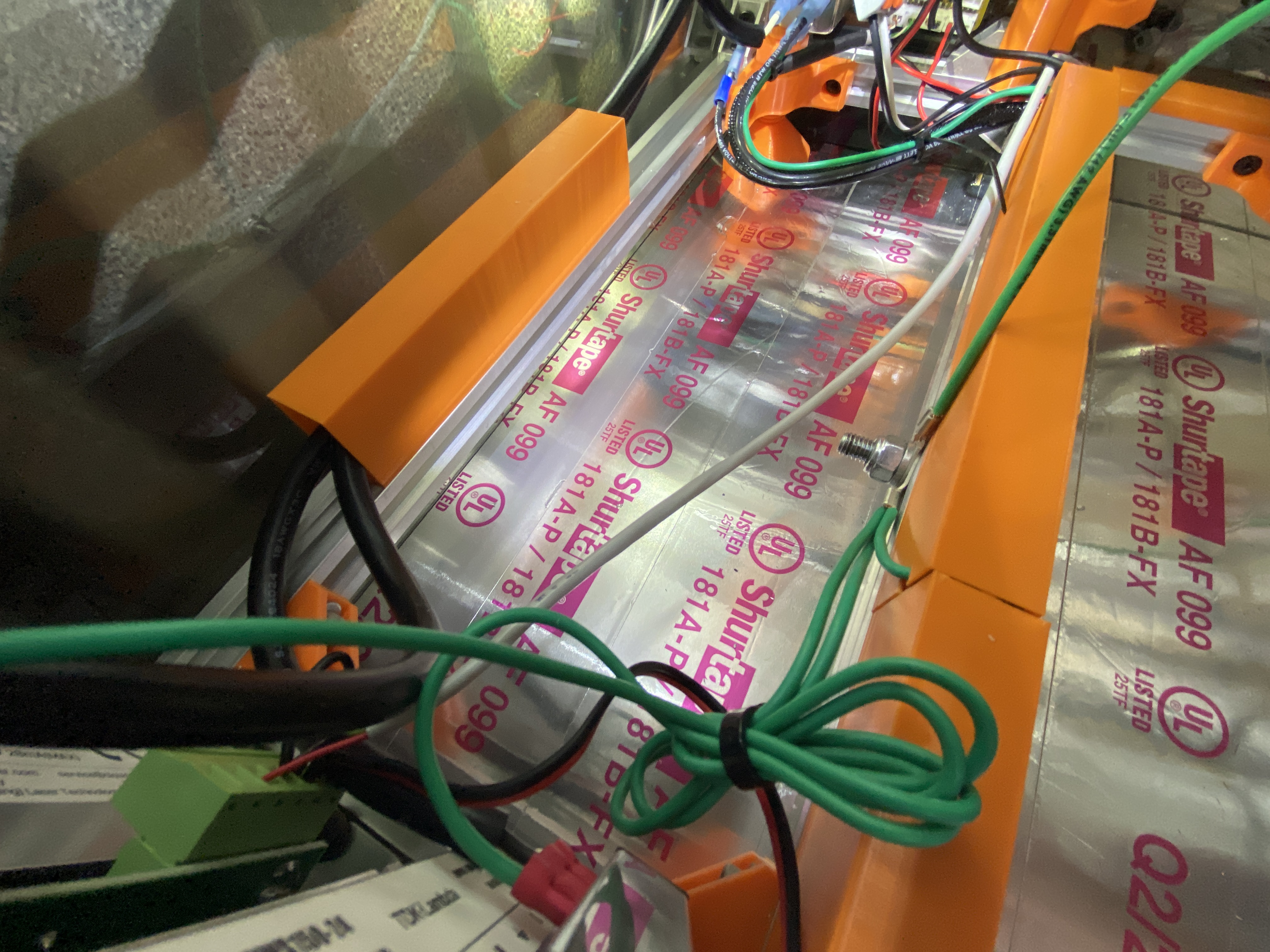

@tomatsu Here is another angle that shows that all three wires are in actually crimped together and then using a t-nut, bolted to the frame of the machine.
How do recommend grounding to the aluminum extrusion?
In the interim, I have redone the ground point. I drilled a hole through the aluminum extrusion and put a bolt through it with a washer and a lock nut. I sanded the surface prior to bolting it tight.

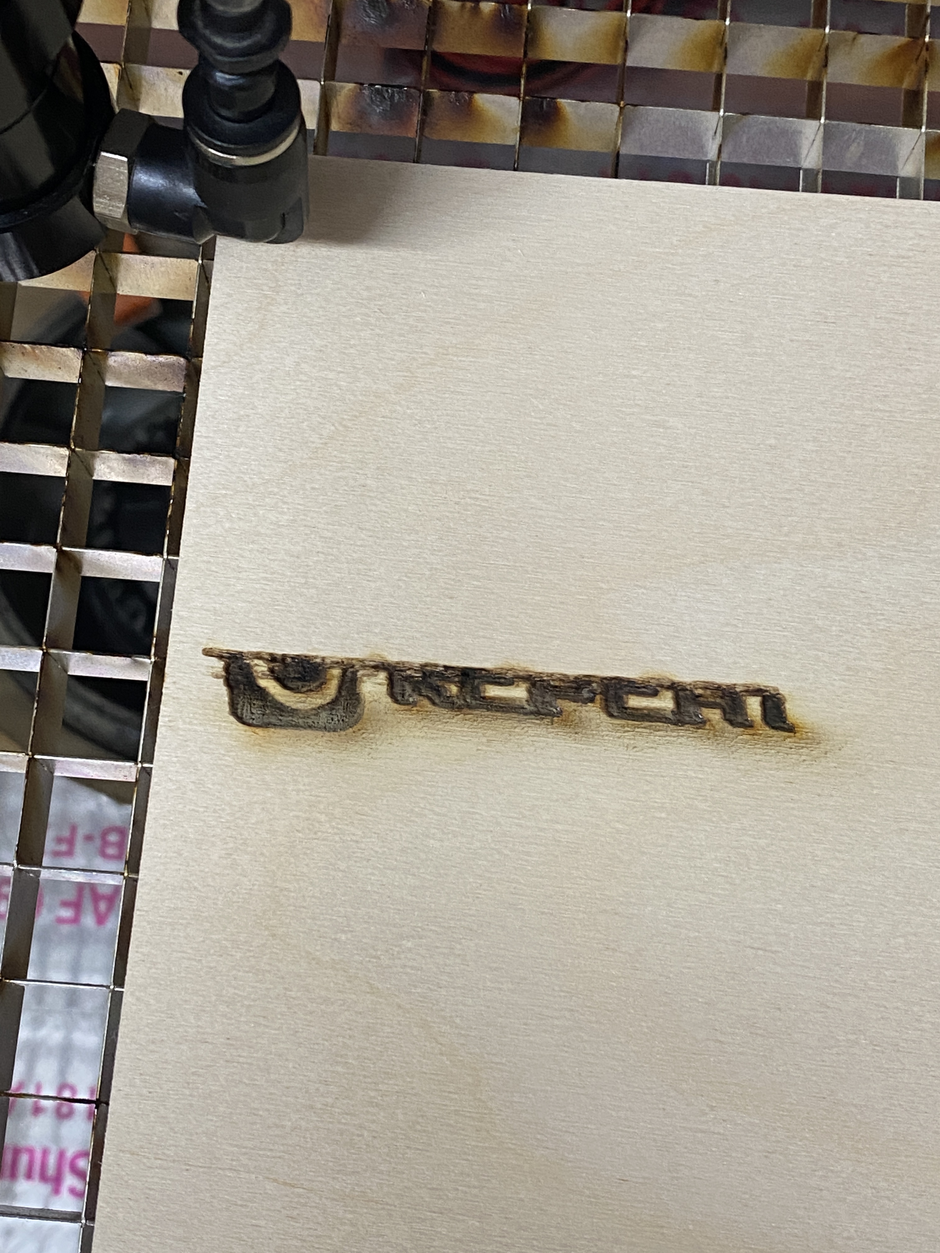

To my dismay, no of the above helped. The X-axis shifted and the Z-axis is moving upwards slightly when it shouldn’t be moving at all. This of course eventually leads to the laser head crashing into the work material and really botching everything…

Looking at your circuit diagram, be aware that many power supplies connect ground to the negative DC supply. You can test that with a multimeter. This may be giving you ground loops that you don’t recognize.
@mcdanlj thank you, I did identify that my 24v DC power supply did have ground connected to the negative rail. I disconnected the ground wire, and tried to burn something. Same story. Wonky behavior. I’m not sure what to do to properly ground this power supply now.
