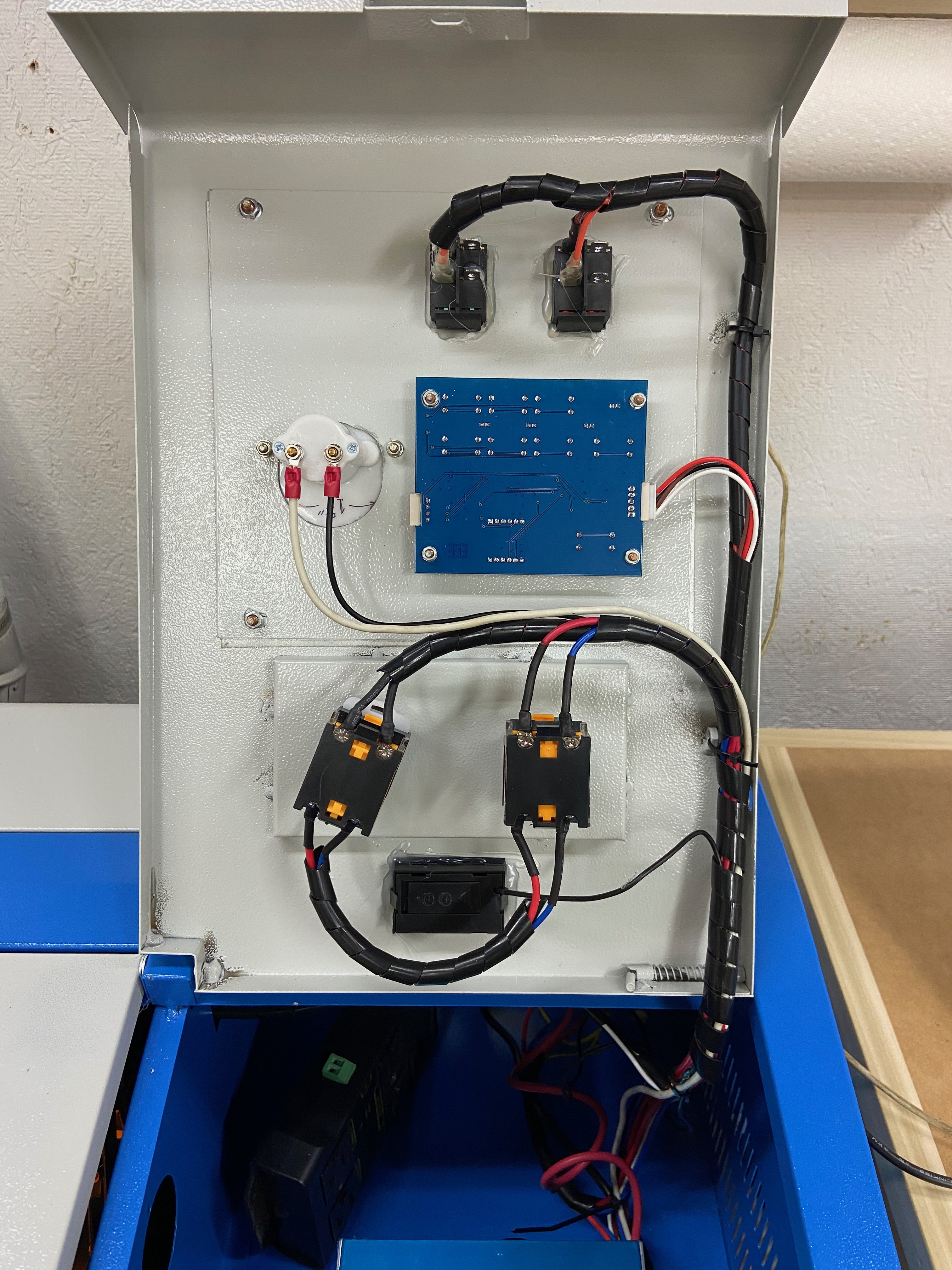

This morning I was successful in installing my new Cohesion3D LaserBoard and mA meter. I wanted to install the meter so I can utilize the digital board to set the power, but really know where the power is set with the meter.

Seriously… I see your wiring shows the same attention to detail as the cabinetry. Would I guess right that the Shapeko in the corner of the image was involved some of those cabinet components?

Surprisingly, that’s from the factory…so when I tore it apart, I had to put it back.
