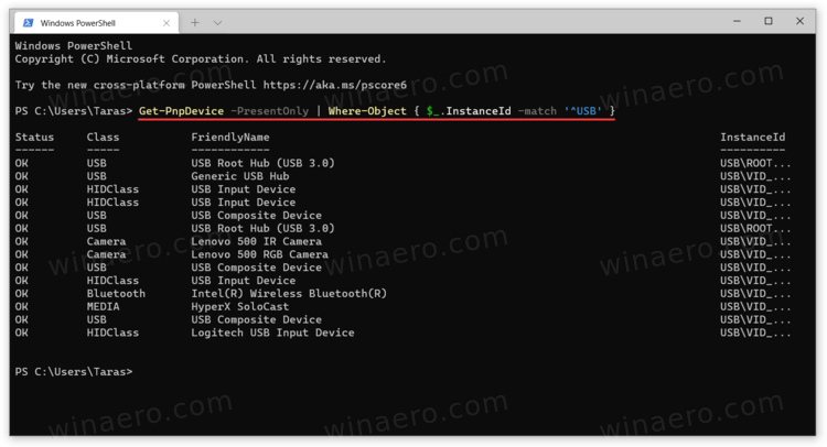

Try listing the USB devices via PowerShell:
Still nothing, I have sent an email to the seller. Everything I can find on the internet points to the board having gone out. We shall see what they say.
