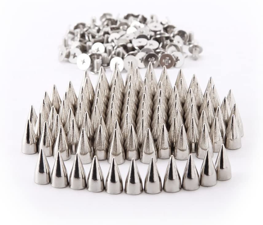

I recall one about using leather “studs” which are cone shape. might help you find it using that term in your search vs pins :slight_smile: I know I considered building one at some point but got lazy and still use honeycomb on a small lab jack lol

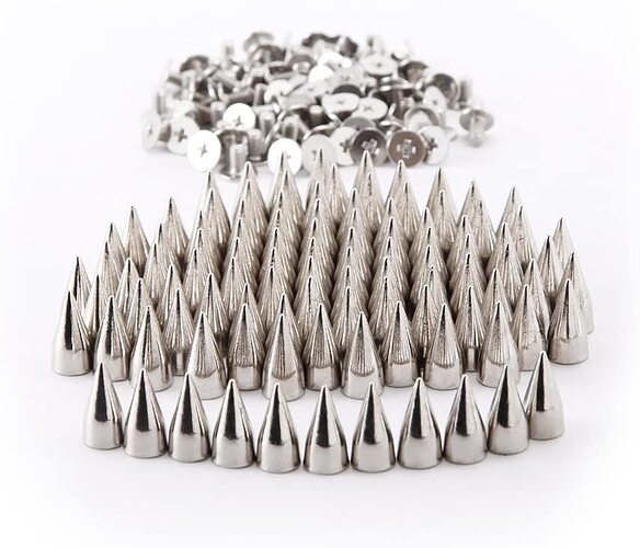

I use these stud spikes, with short [all-thread] screws, under objects placed anywhere on the bed.
