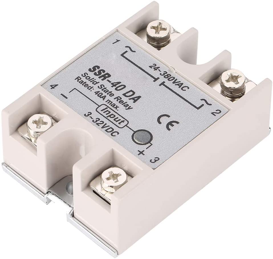

please explain to me which relay to buy and how to connect it?
On the MKS SBase board, the flood output is on Pin2.7 which is a mosfet output for Heater1.
The relay needs to be matched to your spindle needs (ac/dc, voltage and current) and the relay magnet needs to be for your power supply (the voltage you connect to the 12-24V input on the MKS).
For an AC spindle use something like this:
For a DC spindle of up to 60V use something like this:

my spindle is at 220v, is the first relay ok, I connect the + and - of the relay to the + e- pin 2.7?

@marcy
Yes, the first SSR is ok.
Just connect the SSR + input to P2.6 (flood) + and - to P2.6 -.
