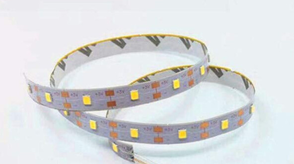

I’d like to know how to connect a single LED (from a strip) to a battery. Is it as straight-forward as cutting the light out and making the connections???

A picture of the strip would be helpful.

Chances are very good that a coin cell will just work with those LEDs. However, due to the limited available current from the coin cell, be aware that it might not be full brightness, and the brightness might depend on which type of coin cell you choose.
You can cut across the strip where the pads are and then connect + and - 3V to those pads.

I cut out one of the lights and connected it to a 3V battery and it works! It’s probably time to share what I have going. I plan to make a golf ball mark with this set-up. Now that I know that I can power a single light with a 3V battery, I can make the rest of the device.
