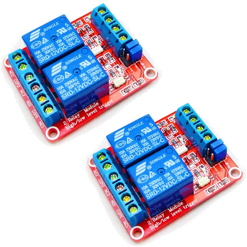

This is the relay board I purchased
I have DC+ and DC- connected to 12V the power supply directly. I have In1 and In2 currently connected to the positive terminal of pins of E1 and E2 and the relay remains active. I did also buy a 5V 4 relay version if that would work out better?
Both of the boards look to me like they expect signal relative to a common ground (labelled DC-). The E0 and E1 terminals on the SBASE could directly drive a relay without the intermediate logic-level circuitry on those boards. It doesn’t show any obvious place to connect directly to the relay on those boards. If I were doing this, I’d just be connecting two relays, one each directly to E0 and E1, and skipping the signal board.

I think the red relay board has internal pullups (and optocouplers), so no extra pullup resistor should be needed.
@cprezzi that makes sense! Thank you!
@Jonas_Concepcion This is where product links would have come in handy! Looks similar to this:
That lets me see more higher-resolution pictures (though still not a schematic) and that one looks like it has a 2.2K resistor on board for each channel, which is a pull-up resistor if you choose the L side to jumper, and a pull-down resistor if you choose the H side to jumper.
