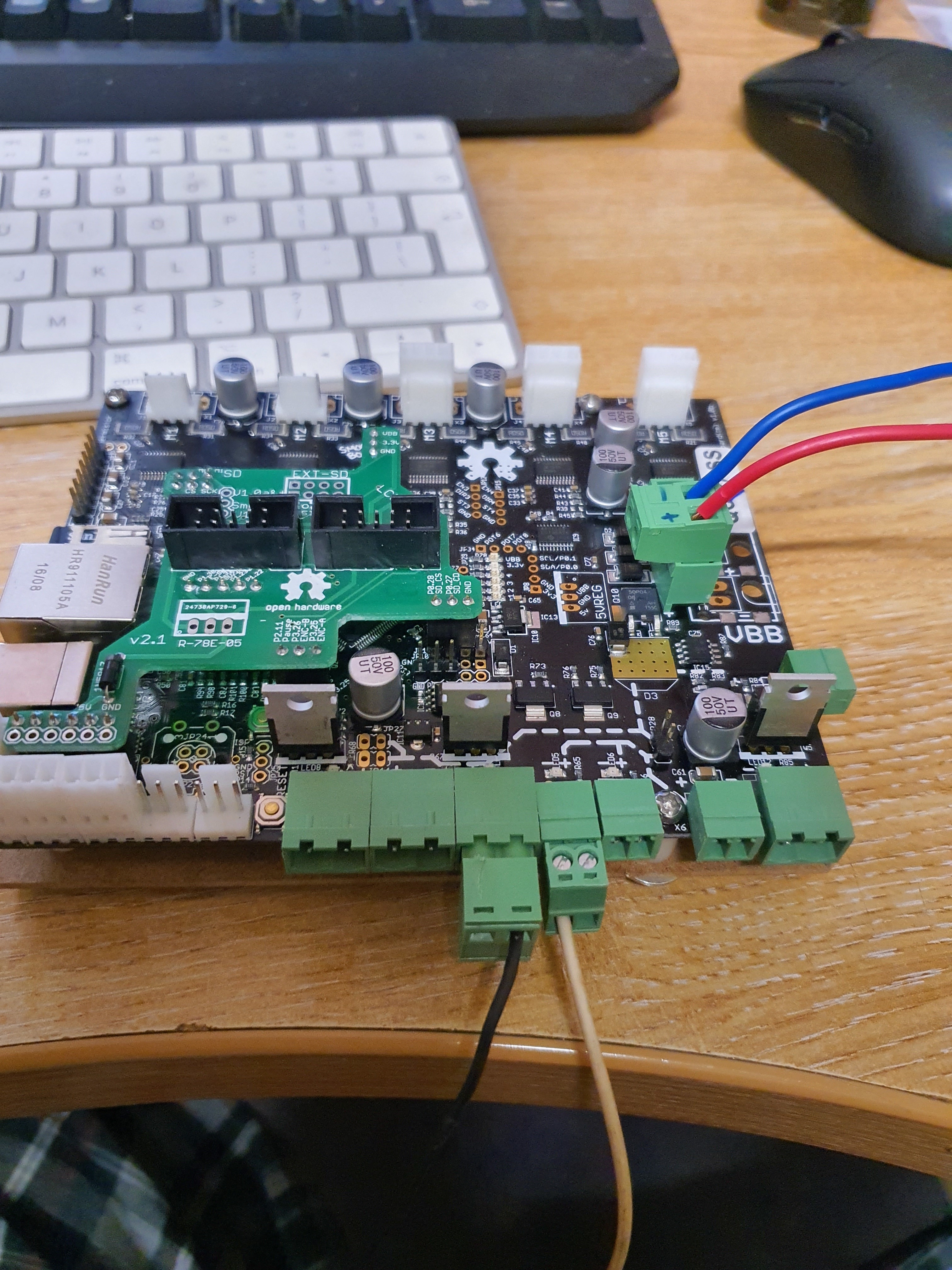

Connections to Smoothieboard
smoothboard 5xc v1.0b
I have the following connections on the psu from left to right TH TL WP G IN 5V
I have the in connected to pin 2.4 and the g to a gnd pin close to it
where do the other connectors from the psu go please I have looked at the smoothie page but am unsure and don’t want to blow up the board
many thanks in advance

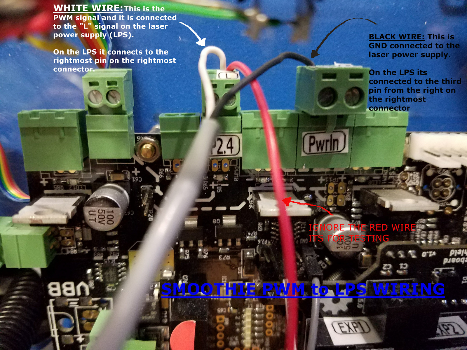

Here is an example of the wiring to the LPSU to the Smoothieboard. Credit to @donkjr and his very informative blog on K40’s: http://www.donsthings.blogspot.com.
This is also how i have mine wired and it works well(Smoothieboard 4xC. I did have a mosfet fail on me a while back but an easy swap to the other large mosfet right next to it solved that. I also torched a driver on x by moving the gantry a bit too fast so i am also utilizing M3 and M4 drivers instead of the first two but that was a simple config change and done :slight_smile: but I digress…)
This wiring setup means that you still have the potentiometer on the front panel conntected to 5V, IN, and GND to control the max power output and to allow for on the fly adjustments if its too dark, etc. There is some setups that run the in from the boad also but i never trusted them as they can overdrive your laser tube much easier. Better safe than sorry :slight_smile:
thanks this is what I have …do I need another connection somewhere
the red and black wires go to a 24v psu
the white goes to TH
the black goes to G
when you say wire TH to psu 5v do you mean to a connection on the smoothie board next to the main power in connections

I have the shell of a k40 and it now has a 50w psu with a 50w tube the problem I have is with wiring the new cloudray psu to the smoothie …
would anyone be able to mark a picture of a 5xc showing me what to connect to what to make the laser fire …soldering pins to the board is something I can do but working out what pins do what from the smoothie pages is not something I can do
many thanks
