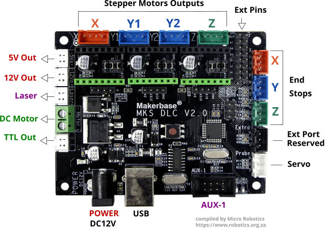

I found images for MKS-DLC but not DLS.
I’m assuming DLC here:
See the 4-pin headers under the green 8-pin headers on the image @donkjr posted? Those are the EN/STEP/DIR/GND signals. They go to EN/CLK/DIR/GND on the LV8727 drivers. You can use normal dupont 4-pin cables for that. Here’s an example that I happen to be using right now for exactly this purpose:

That helps a lot. I wasn’t sure where to take the stepper signal from as it seems to be available in three places. Also, I really needed the settings for the dip switch. I was going to have the silk screen translated but now there is no need.

Not exactly sure what you mean; there are three; one for each axis, arranged horizontally on the board (as shown in the image).
If you meant the different kinds of headers:
  • The black 4-headers are labeled with signals and have the signals on them
  • The green/black stepstick headers also have signals embedded in them, since they convert from those signals to stepper motor control. (For other boards that don’t break the signals out to a separate header, External Stepper Driver Adapter for Cohesion3D Mini - Cohesion3D can do that from the stepstick socket.)
  • The red/blue/green connectors are for the stepper motor, and are provided from the stepstick if you have one, and are not connected otherwise.

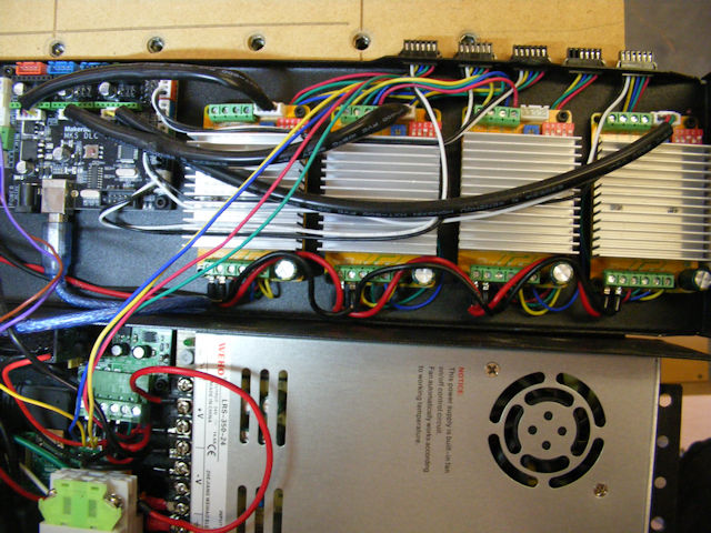

I have my control box open and remembered your request. Might be a bit late but I’ll upload them anyway. You might see the disconnected blue wire: I tried connecting it to ground with no ill effects that I can confirm. But since I cannot command the spindle to turn since replacing the bad RPi micro SD card I have a feeling something is wrong in here so I have disconnected that blue wire again in these photos.
DSCF0001S DSCF0002S DSCF0003S DSCF0004S DSCF0005S DSCF0006S
