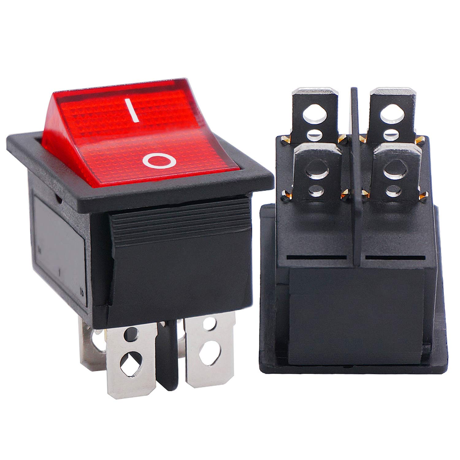

Yeah, I’m thinking I had better go with illuminated, 4-pole rocker switches for this application. Something like these:
That looks more likely to work well. Sadly you can’t just drill a round hole, so you’ll need a nibbler if you don’t already have a square hole to install it.
You can just put it in between hot supply and outlet for the switched socket in position 1, and ignore position 2 that is for DC, and it looks like it will do what you want. :crossed_fingers:
Thanks for the confirmation! Yeah, I already have the holes milled in the Al panel, so I’ll have to cut those out with a larger rectangle and 3D print a “patch” to house the 3 new rectangular switches. I’ll use blue filament to match the K40 case. Maybe it won’t look too bad. As long as it does the job, I’ll be happy.

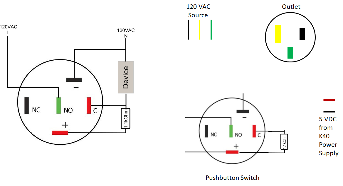

Your original switch is rated for 5A 250VAC and the LED is 15mA 12V AC or DC.
Because a LED is a half wave rectifier, you can just add a resistor in front of the LED to reduce the voltage.
I’m just a bit concerned that you wrote it’s already working with the LED permanently on! Without any additional power supply or components? This would mean you have connected the LED to 120VAC, which should destroy the LED (or it is not the specified switch).
If the switch is as specified and you like to switch 120VAC (which is ~ 170 V peak), you need a resistor of about 1053 Ohm in front of the LED. So use a 1.1kOhm resistor.
Here is the diagram:
grafik
@cprezzi oh, good point.
@cprezzi good catch. @dwburger actually indicated he was powering the Led with 5v from the LPS.
Thanks for the thoughtful and helpful reply! I get the need for a 1.1kOhm resistor, but not sure about what’s meant by “Device”. I’ve created a new graphic below showing your drawing on the left and a cartoon-like drawing of what I’m trying to create on the right. I made the neutral line yellow since white didn’t show up on the screen. Maybe you could detail the wiring connections between these components so I can be sure to get it correct??? Thanks!

I think there’s an internal resistor for the LED but that it is sized for 12V, so a 1K or 1.1K resistor that @cprezzi suggested is exactly right.
Where it says “device” that’s the outlet. Hook up ground directly to ground, neutral directly to neutral, but hot to NO and the switched outlet hot to C.

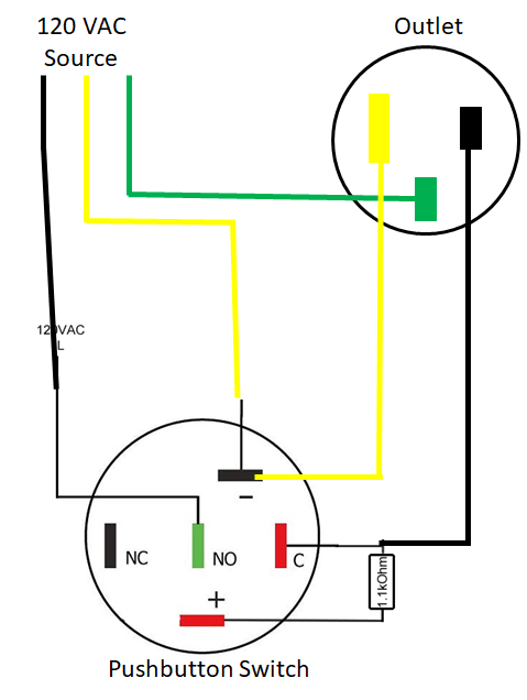

Thanks! And it would look like this???
Almost like that — I was trying to explain @cprezzi’s diagram. You still need to connect - to neutral as well in order for the LED to illuminate.
Basically, inside the switch, there are two completely separate circuits. One is a single pole dual throw switch (that’s the NC, NO, and C terminals) and the other is a completely separate LED (that’s the + and - terminals).
When you put sufficient voltage across +/- you illuminate the LED. If you put too high a voltage, the LED draws too much current, and you burn out the LED. (Incidently, if you want to make the LED a bit more dim, you can reduce the current by using a higher resistance; say, 2K; this will also prolong its life.)
Each time you press the switch, you alternate between connecting C to NC, and C to NO.
Do I correctly understand that you want to know that the outlet is energized, not that the K40 power supply is energized? If so, and your goal is that when C is connected to NO, then you both connect the hot 120VAC source to the switched outlet and illuminate the LED. To do that, you connect the switched side of the hot line to the LED through a large enough resistor to protect the LED from burning out, as well as to the hot side of the outlet.
I don’t think you need a separate diode to protect the LED. It’s common to have LED light strings with only inline resistors and using the LEDs as the only rectifying components; I have LED rope light of that sort. You just have to account for the peak voltage (170V peak for 120V nominal RMS because you multiply the nominal voltage by √2 to find the peak voltage, which was how @cprezzi calculated a good suggested resistor value) when sizing your resistor.
I believe that you shouldn’t need filtering unless you are sensitive to 2x mains frequency (120Hz in the US) flicker.
Hope that helps! Thanks again to @cprezzi for pointing out the easy solution here. :slight_smile:

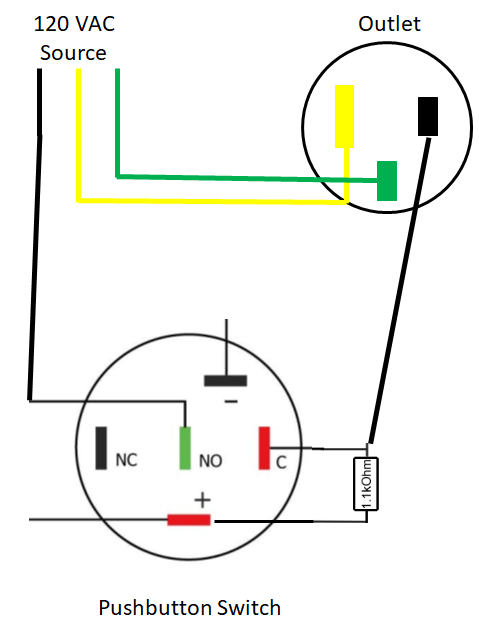

I appreciate your help (and patience). Yes, I want the switch LED illuminated when the outlet is hot. How does this wiring look?
