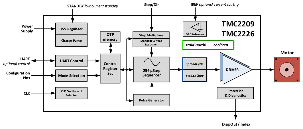

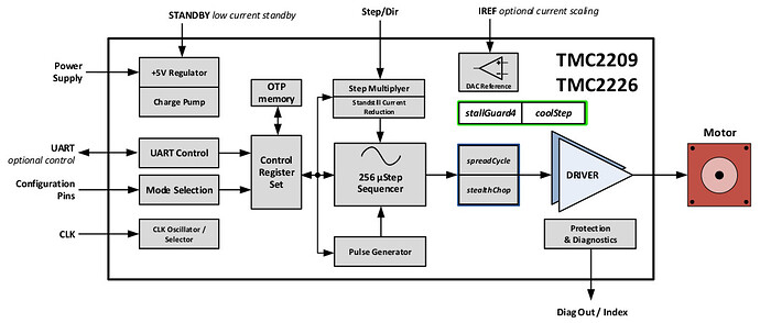

I didn’t know that the 2209s run cooler than the 2208s, but that’s at least what this article says:
In particular, this:
The flexible and stealthy TMC2130 has 400 (bottom) and 500mΩ (top) (100mA 25°C supply=24V) mosfets, and runs hot – needing a larger heatsink to keep it working.
TMC2208 is a later generation, with 280mΩ (100mA 25°C supply=24V) mosfets, – although some folk say they still run hotter than A4988, but there is a lot of hearsay in the 3D print world, and I haven’t tried them, so maybe they are similar, or maybe StealthChop requires the mosfets to operate partially in linear mode, or maybe when people use them at 12V the transistors do not achieve 280mΩ.
Anyway, just introduced, the TMC2209 has 170mΩ (200mA 25°C supply=24V) mosfets – which must cut dissipation to some extent, and might even mean heatsinks can be done away if they are directly on a large pcb with plenty of copper – thick layers and lots of layers.
