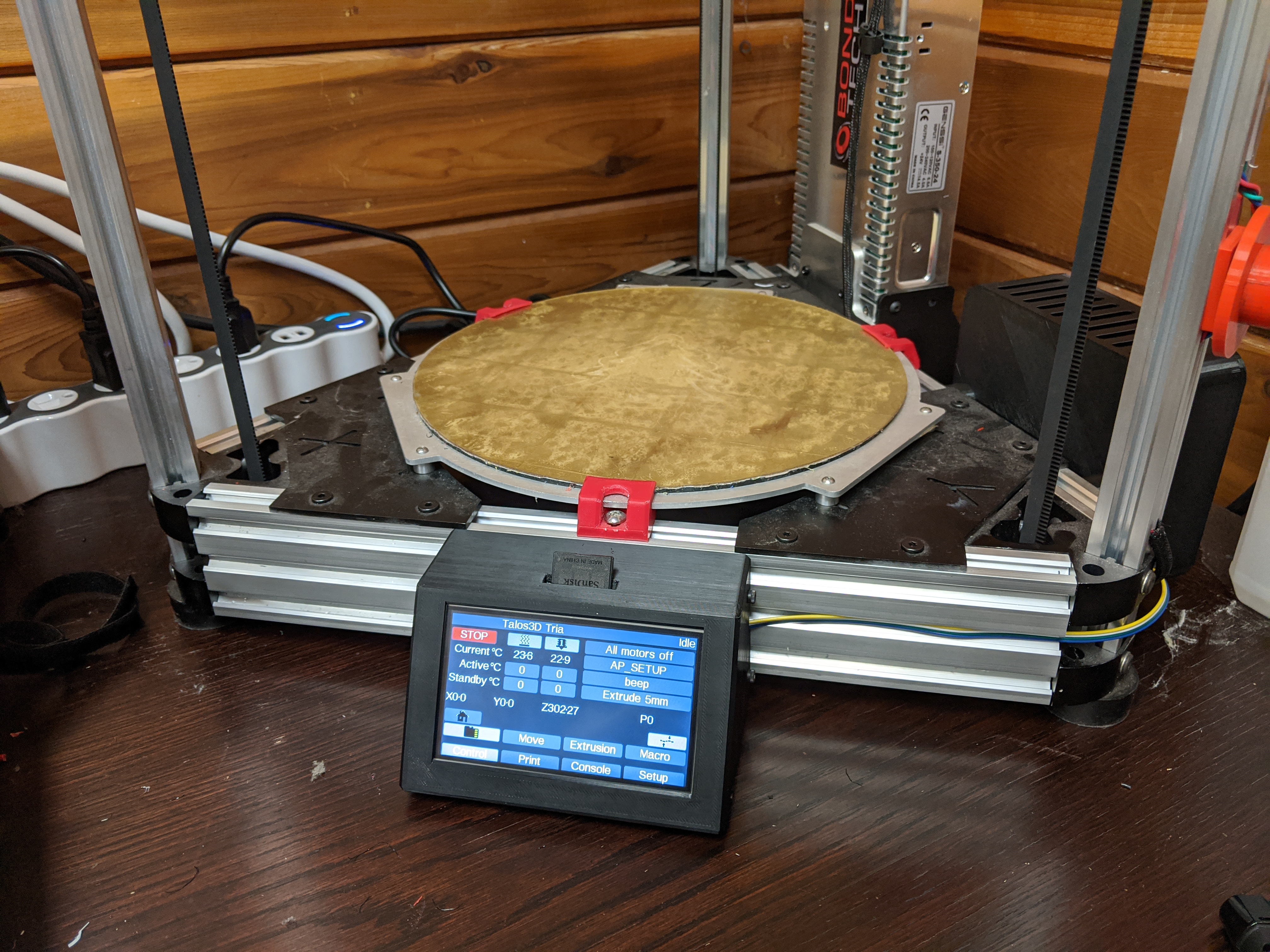

It uses the TMC 2209 drivers, so I assume current would be limited by those. I’m not using it currently on my Eustathios or HercuLien. It’s currently in my Delta printer. But it’s working really well there. But I am using an Aztec X5 Mini with socketed TMC 2209’s from Panucatt on my BoxR printer and current hasn’t been an issue there, and the XY gantry on that one has a bit of weight. I’m using it entirely in stealth shop with no skip steps.
I’m really liking the G2C board on the Delta, and having the paneldue certainly is nice. Although honestly I find I run it from my web browser way more than from the touch screen, so I think that that cost could be avoided if you didn’t need to run it at the machine. And Roy has an adapter for the G2C board that allows you to run a standard graphical LCD.
