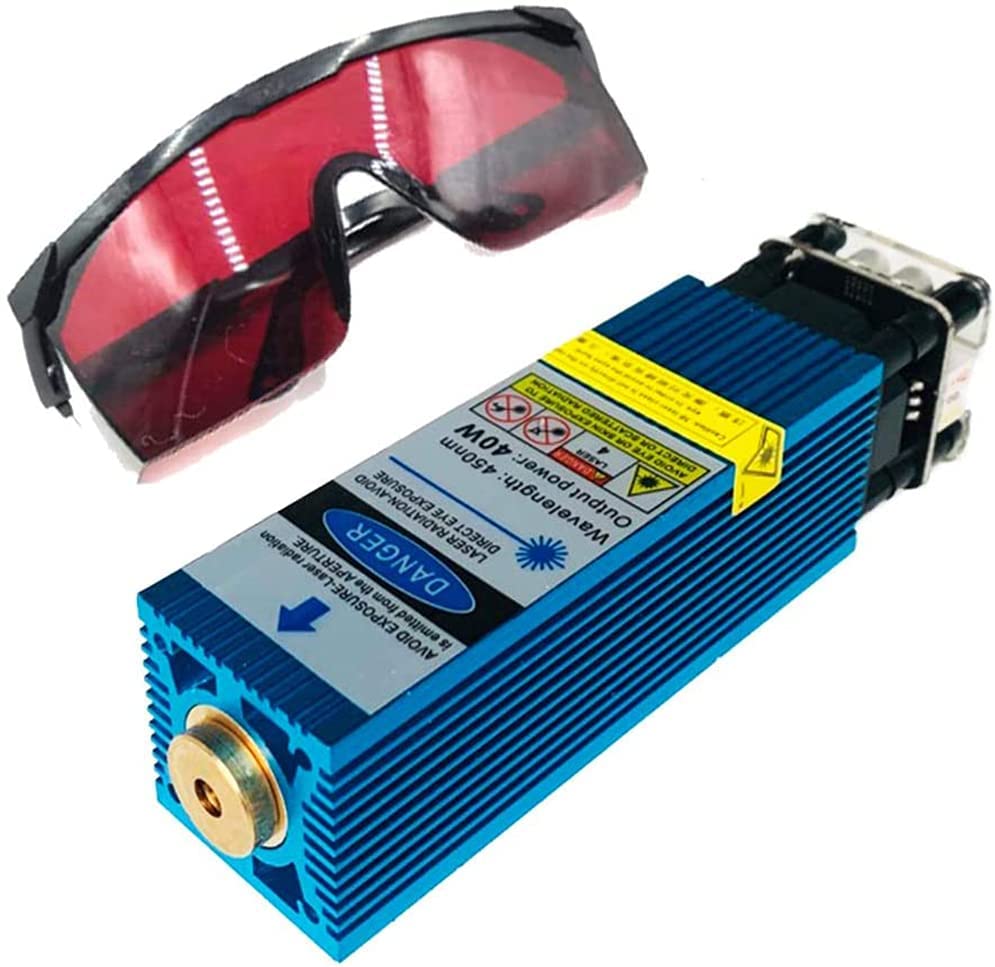

I’ve been 3D printing for a couple of years and am now wanting some more kit - specifically a laser engraver. I’ve decided to put one together using kit that I already have - a basic x-y chassis, some Neema 17s etc. I’ve bought a diode laser head for the engraving - the most powerful in my budget which claims 40W (fantasy) and optical rating of 12-14W (probably somewhere near to true).

What would be the way to go. The chassis is about 20 inches square with about 10 inches possible z travel. The head is 12V with standard 0-5V pwm/ttl (image below).

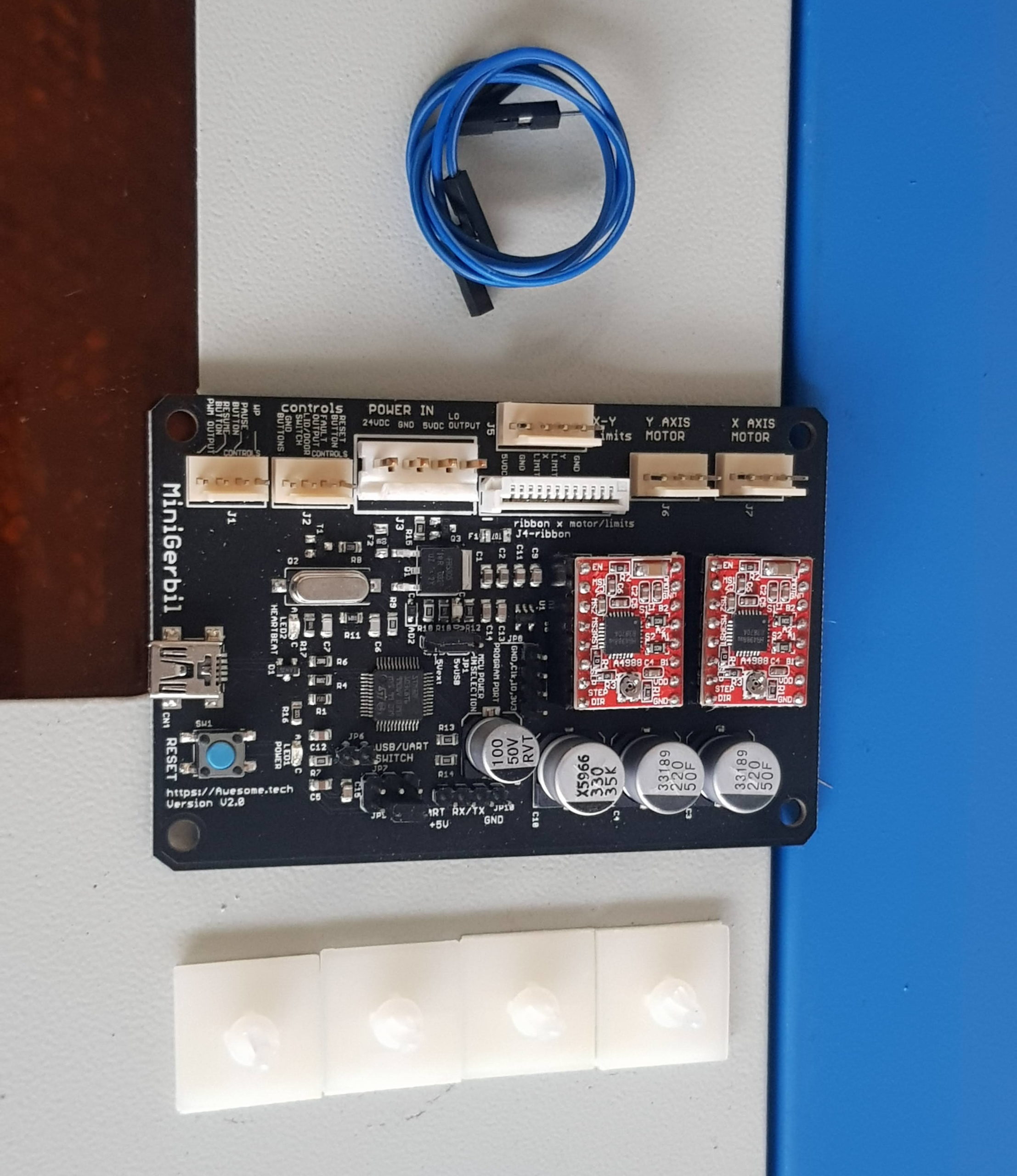

I have had a K40 for some time and have been watching the evolution of the Laser Diode engravers. I recently bought a cheap VG-L7X unit with the intention of making a unit that is much more portable and simpler than a K40. (No cooling and simple optics). That said I have low expectations for cutting with a laser diode. Turns out that I use my CNC router for cutting most times. Most of my work is in wood and plastic.
I just started my learning phase and you can monitor progress here using the search for VG-L7X tag and/or my blog. Or we just collaborate as if suits you.
I have decided to use the AwesomeTech controller MiniGrbl as it meets my needs, I know @Paul_de_Groot at AwesomeTech. Note: Paul is a member of this forum
A key need for me is the use of Lightburn to design and drive the unit. It will handle all the formats I need including Gcode that I may create from another CAD/CAM tool like Fusion 360.
