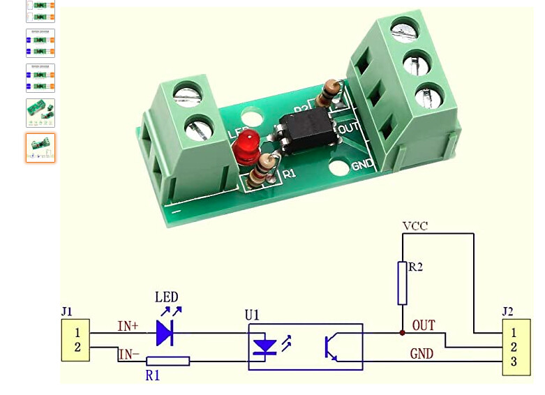

Given the info above I would give this module a try.
https://amzn.to/3ReQOa9
The intention is to convert the 0-3.3V swing to a 5-0V swing.
This would drive the L signal on the LPS. The LPS L input is expecting a ground (on) or 5v (off).
Since the L input is an opto coupler it needs to be as close to ground as possible to provide a solid “On” condition. Shifts above ground may cause the LPS to operate unpredictably. This is why I do not reccomend TTL levels.
Note: the opto isolation board has a LED and resistor in the input circuit.
Not knowing what the controllers PWM output looks like (sink/source) I would:
  • Try the module with no changes.
  • If that does not produce the proper output then remove the resistor and replace with a 100 ohm resistor.
  • If that does not produce the proper output then additionally remove the LED.

The meter output at J2 should be the same as J1 but shifting from 5VDC to 0VDC.
If the LED is still installed it should be on and or flikering during the test.

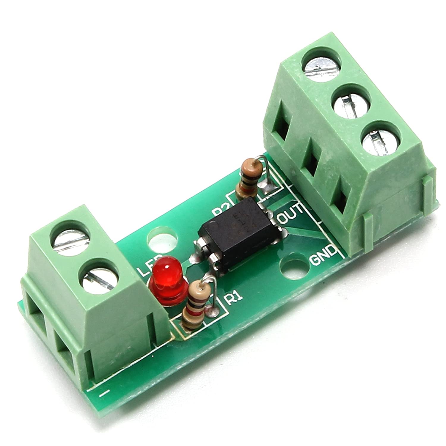

Having hard times finding the same isolation board locally, could you please check which one I can try instead of the one you mentioned:
https://www.amazon.de/-/en/s?k=Optocoupler+Isolation+Board&rh=p_76%3A419122031&s=relevanceblender&dc&language=en&crid=3BNRVIW50LN3F&qid=1675278845&refresh=1&rnid=419121031&sprefix=optocoupler+isolation+board%2Caps%2C149&ref=sr_nr_p_76_1&ds=v1%3AWPGwMXpITBLvtdU93PcBSLjeGjcmI7C3ZUhVxPBgaB0
I need a location or zip code [germany?] so that amazon search will not try and find things that can ship to US.
please use this one 10115, Germany, please check the one which will be shipped by Amazon, there are a lot of chinese sellers, it will take ages to arrive from China, thanks
Looks like this is the same module able to send to Berlin?

I did like you said, replaced with 100ohms, opto coupler with no changes provided 5v at 0% power and 3v at 100% power, but after I replaced the resistors it was 5v constant, same after replacing led, there is a chance that I did something wrong, but actually it wasn’t something complicated so it looks like I followed your instructions exactly as it written… Should I order another one and try again ? There are 2 resistors, should I replace them one by one or same time? What are the voltages we are looking actually at the output? 0-5v ?

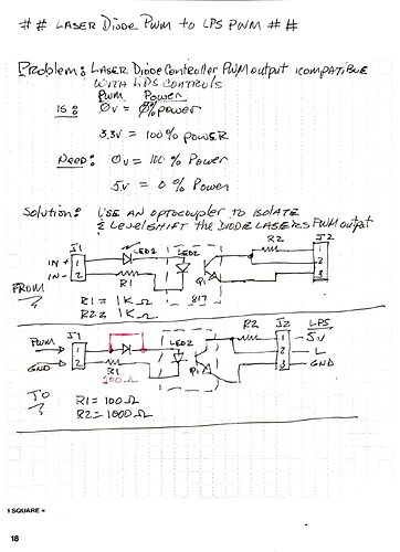

I will send you a restart set of instructions later today in visual form.
I should have been clear about which resistor to change. It is only R1 that should be changed.
Wouldn’t hurt to go ahead and order another one or two.

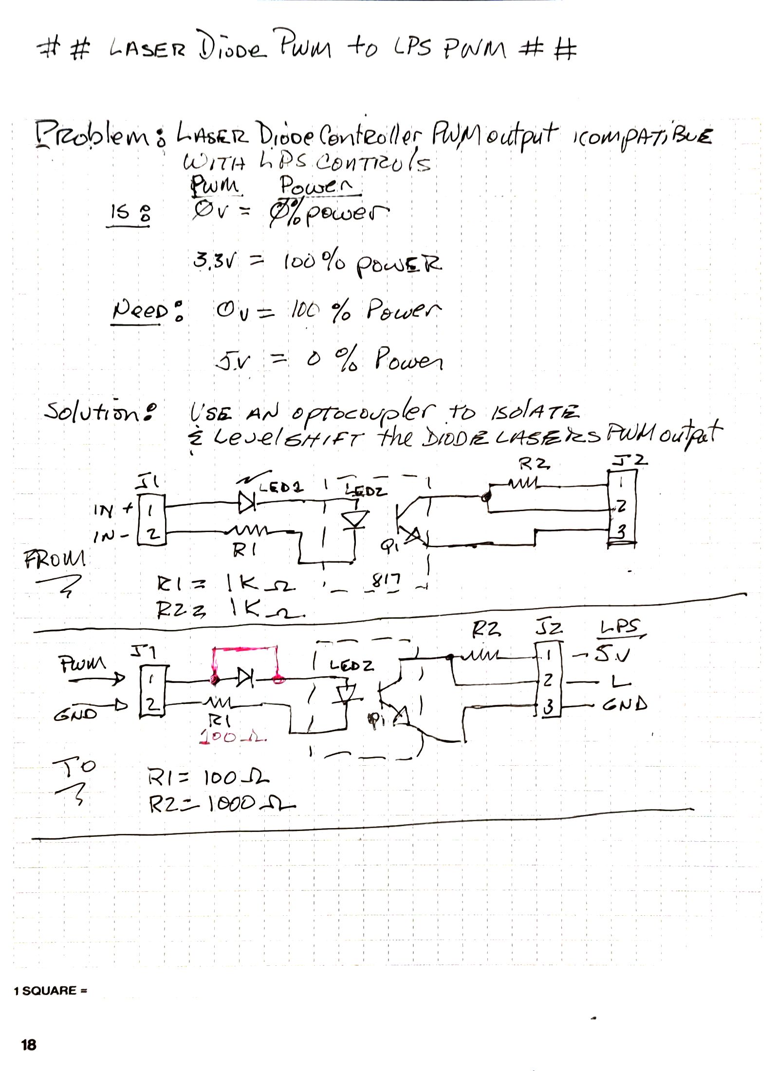

Below are more detailed drawings that I hope will help.
First off:
In answer to your question:
This may work but it’s possible you won’t get full power from the LPS.
You can tell if you are getting full power from the LPS by:
  • Connecting IN to 5V
  • Push the test button on the LPS and note the current (Caution this should fire the laser)
    This will represent the max current you setup will produce
I still recommend the setup we started with. You get a few benefits:
  1. Proper level shifting
  2. Additional Isolation between the controller and the LPS since we do not know what the controller’s output circuit is.
  3. Local control (pot) of the overriding laser power
This drawing shows the before (as shipped) and after configuration of the optoisolator for this setup.
  • R1 is changed to 100 ohms
  • Led1 is shorted out. You also can remove and replace with a wire.
  • No changes to R2
Note: this is setup to drive the LPS L pin.

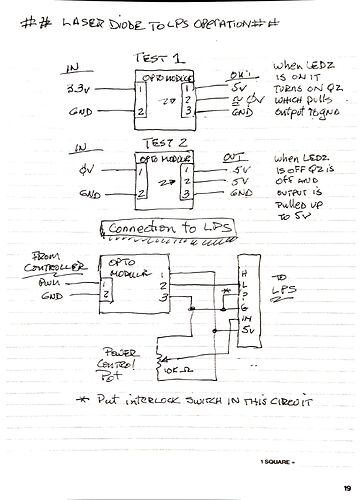

This drawing explains how to test the setup before connecting it to the LPS including a description of how it is supposed to work. If the setup does not behave like this then something is wrong and we need to discuss it again.
That drawing also shows how to connect the isolator to the LPS.
Note as the drawing shows you also need:
  • The IN to have a local pot to control the power. Alternately you can just connect it to 5V. It cannot be just left open
  • The P (or wp ) must be grounded
