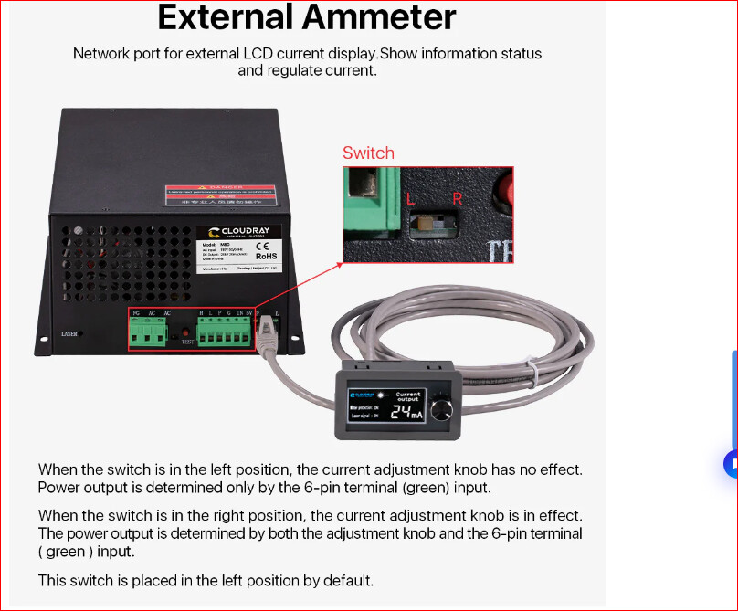

  1. If you are referring to the remote meter function that can be connected via the cat5 cable it looks like switching the selector switch [see image below] to the right allows the remote control and the “IN” port values to work together. Not sure how they would work together so I would leave the switch in the right position and not connect anything to “IN”.

Switch to the right just enables the cat5 remote control, switch to the left ignores it, with the switch to the right you can use both - cat5 remote control and potentiometer between G IN 5v, cat5 remote control has a priority, if you set it to 50% you will control the power by potentiometer between 0 and 50%. But if there is nothing connected to IN, the laser will not fire, does not matter switch left or right. so there should be always something connected to IN. At least this is what I was able to discover by some testing. Will get the new opto and revert with results, thanks!
Of course :slight_smile:
So you found that:
The remote pot (when enabled) sets the max power and the pot on IN adjusts from 0 to that max power.
I do not have any supplies that have a remote control so that function is new to me :).
