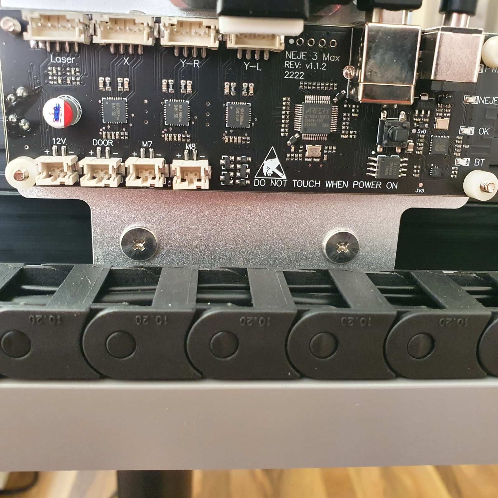

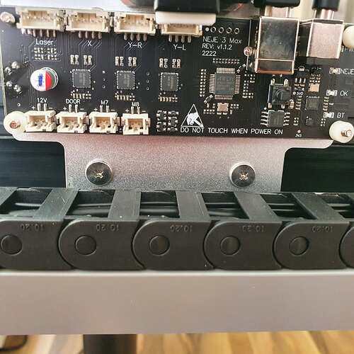

Hi, I have a Diode laser and would like to upgrade it to CO2 without changing the control board and frame since it is amazing equipment. The control board has a PWM signal which I need to convert to 5v TTL in order to be able to control CO2 laser power supply. The PWM control of my diode laser works like this: 0% power - 12.17v /// 50% power - 10.52v /// 100% power - 8.87v. So it is inverted PWM control in a limit of 3.3v total. Does anyone have an idea if there is a chance to convert this to 5v TTL, and to point me out the right direction. I have attached pictures of my control board and CO2 power supply. Many thanks!

that looks like an STM32 clone and I see 4 empty .1" on center header pin sockets at the top of the board near the USB connector. That is likely the ST-Link programming connector and on that will be 3.3V and Ground along with a data and a clock line. Use your DMM in Resistance setting and measure from the case of the USB connector to each of the 4 empty pin holes(WITH POWER OFF and USB DISCONNECTED). You will find one of those gives you ~0 ohms resistance.
Put you DMM in voltage scale(0-20V), power on the controller and with the black/negative DMM test lead on the pin hole you found with 0 ohms you can then put the red DMM test lead on each of the other 3 and you should find a steady 3.3V on one of them. Under the board it is likely marked Vcc and this validates you have found a good ground point for the board.
Now move the red DMM test lead over to the 4 pin Laser connector and make your measurements.
You are measuring the voltages on the Laser connector “relative” to Ground.

can’t wait to share with you my findings :slight_smile: you were absolutely right, so firstly I found the pin with 0 resistance, it was the first one, 3.3v was the first + fourth, than I measured the laser socket pins and the third one was 0v - 3.3v signal according to laser power (0v - 0%power, 1.65v - 50% power, 3.3v - 100% power), so what does it mean for us now? Is it enough to control the co2 lps or not yet? many thanks!
good to hear and remember, measuring voltage is a relative thing. Much like how we measure people’s height relative to the ground… Measuring voltages is almost always measured relative to the Ground potential(sometimes marked as Neg like on a car battery or even 0V) and usually with a black colored wire and black test lead. The red test lead is what you move around to measure the voltage potential ABOVE ground. A measurement of a Low TTL signal should be 0V but sometimes below 0.8V(TTL) or 0.3v(CMOS) are acceptable due to how electronic circuits trigger and switch states.
