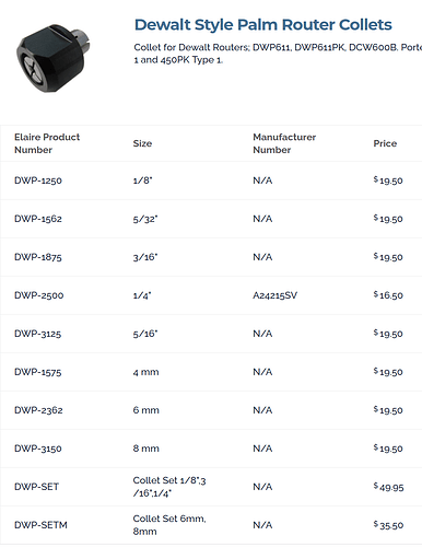

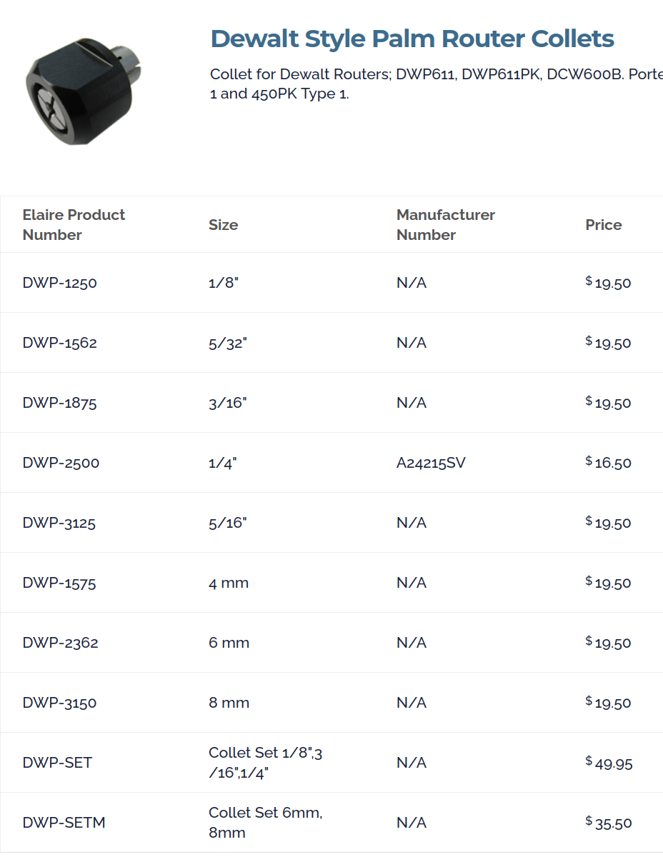

Elaire Corp. has a very good quality set available:
(scroll down and verify that you have the correct selection for your model)
The Precise Bits folks have even nicer setups:
That is a substantially larger range from Elaire!
Then this was a surprise at the bottom of that page:
If you require a sizes [sic] not listed, please contact us and we can accommodate
