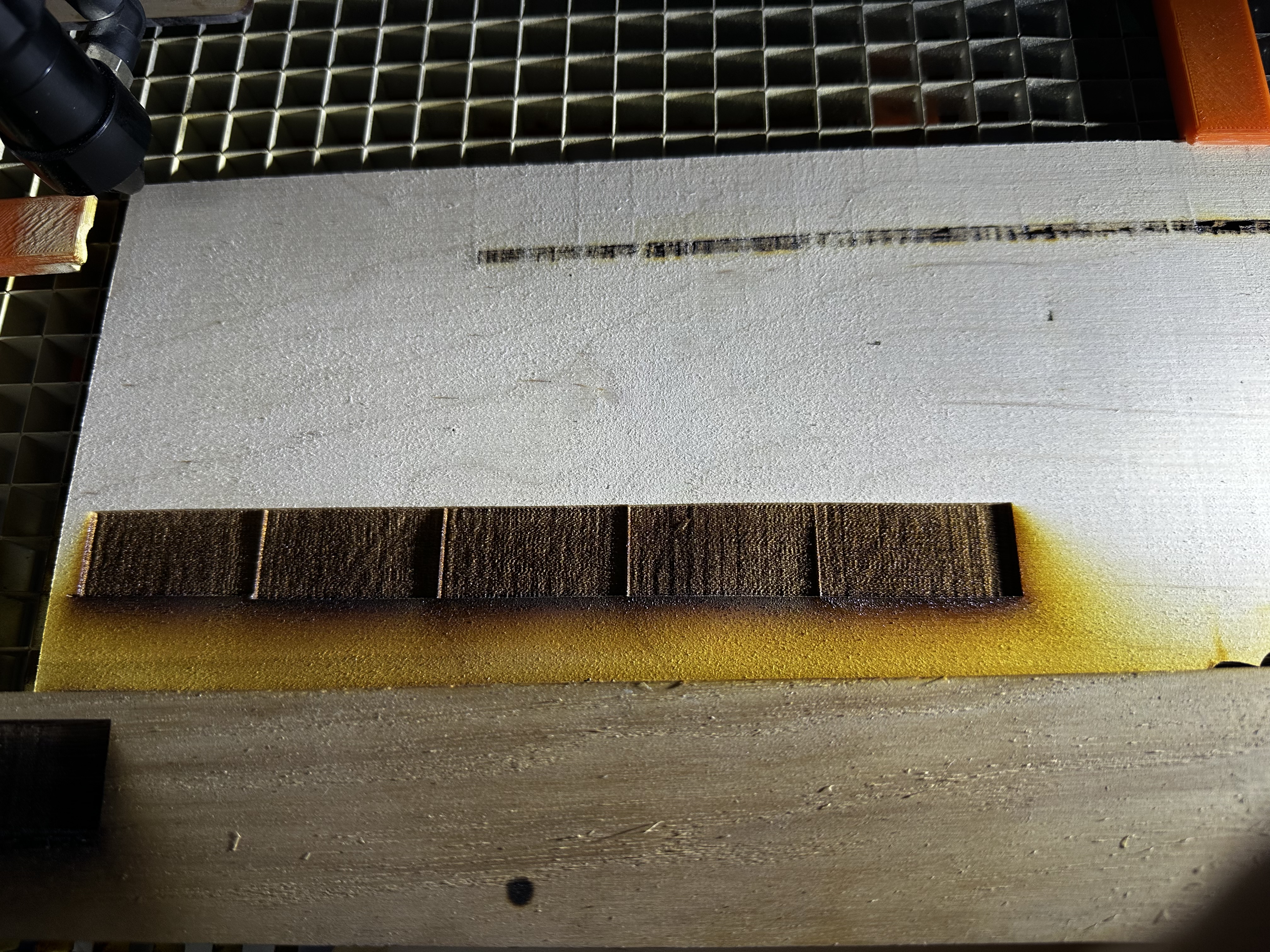

“Curtains” in engravings
after finding it I was reminded it was spotting throughout the engraving, not the banding you are seeing. Laser glitching around text
Frankly, I’m quite surprised you are seeing the same results at fast(200+ mm/s) and at slow(~50mm/s) speeds. Seeing the same period/spacing of the bands at different speeds, AND when you had the belt inverted just doesn’t sound right.
The spacing of the bands does change with different speeds. You can see that in the image I posted above (quoted below), apologies if I was not clear on that. Now what does not seem to change anything is inverting the belt. I did at one point have the GRBL controller connected to the big laser, it was displaying the same symptoms as the FluidNC controller. I swapped them because the guys developing the FluidNC software had a devastating bug with the Espresiff SDK and I was suspicious.
When I look at the picture below, all I see is a reflection of the GT2 belt pattern. It is damn near identical…
Somehow I must have missed the important fact that the pattern does change when you change speed. When I mentioned running at different speeds I thought you just said it still does the banding and nothing more.
Did you measure the spacing of the bands at different speeds to try and determine a correlation between speed and banding period? And I’m sure you know that as you change speed you also have to change power so that you’re getting the same amount of power dumped into each pixel.
It would also be helpful to provide the link to the post with the image instead of creating a low resolution image of a previous post.
I did not provide explanation. It’s not your fault, its mine. I did say “it still does the banding”. It does seem like the banding changes with speed, besides the images I have provided, I have no empirical evidence that shows the actual speed associated with the images I have posted. I will make a few burns tonight and associate them with speed and power settings. I will then make another post so I can provide more concrete evidence of what is happening and at what speeds and powers.

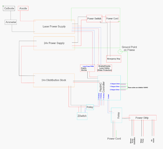

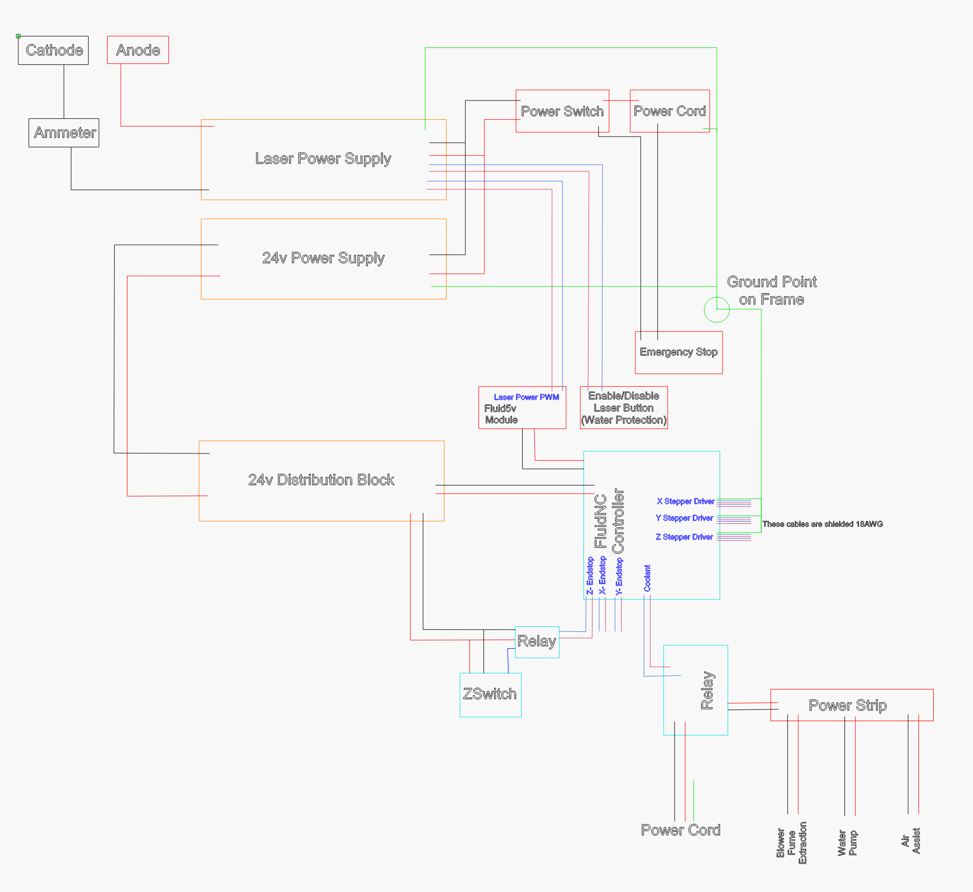

Varying with speed makes me wonder about how you are managing laser power. I don’t think you have shared a schematic with us?
Are you using an analog pot to set the max power, so that you can use the full range of digital PWM? If you aren’t, then you are using only a small portion of the 8 bits of PWM duty cycle, and I think you could end up with aliasing like this. This would be a difference from the K40 where you would be using a larger proportion of the digital range, and thus see less of an aliasing effect. I’m just listing one thing that could be related here, could be something else.
In any case, it’s worth listing all the components you used in the big laser with a schematic of how they are connected.

Here is a schematic of the current setup:
So then maybe you put an analog meter on the laser and adjusted a POT inside the LPS to set your maximum power output?
Normally( DIY, K40, everything but Ruida ) uses a voltage set on the LPS-IN input(usually using a pot across 5V and the wiper going to LPS-IN) which sets the avg max power output and then you set your firmware so 100% PWM equates to this “max power”.
@jkwilborn on the LightBurn forum dug into this and found that the LPS still sends 100% power in a pulsed fashion(much higher freq ) even when the LPS-IN is set lower. So he has opened his LPS and adjusted the onboard POT(dangerous if you don’t know what HV is and how it can kill you) to limit the LPS from outputting more than the tube is rated for.

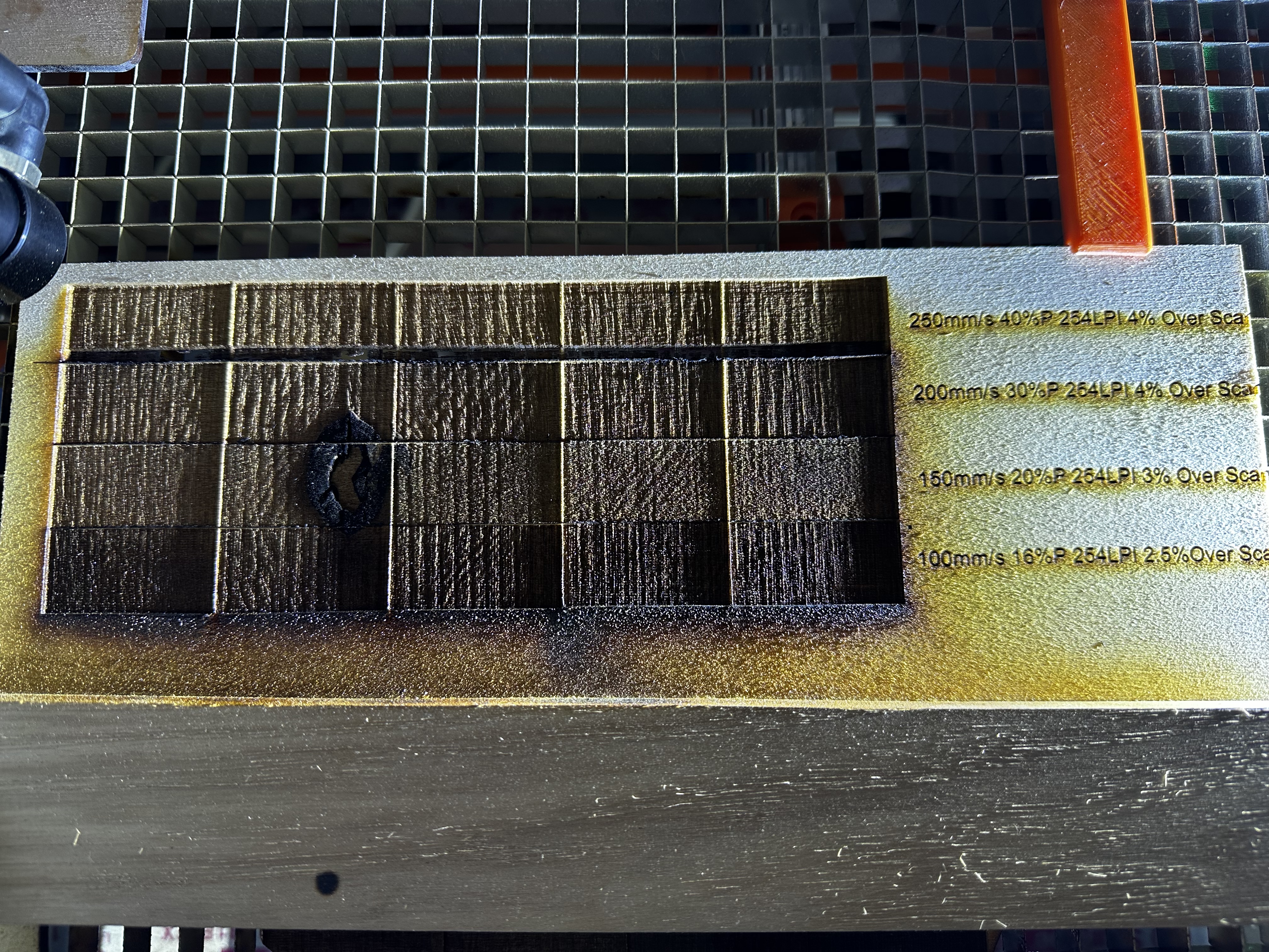

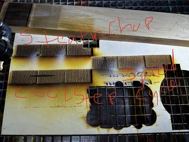

Well, I was wrong. Apparently it’s exactly the same at every speed. I don’t know how the image with pine in it had the lines so close together. This is essentially what I’m battling, a seemingly completely inconsistent result. Some days I swear I come out to the garage and it works for a few burns, and then the next day, or ten minutes later, it’s not working.
In this image, each row has 1 speed and power. I have it this way because as you can see the pattern appears differently across each 40mm x 20mm square. Each square was engraved individually.

Have you tried changing the pwm_hz Laser config setting to see whether it has any impact on the pattern? Try 50000 and see if it looks any different.
Edit: Oh, that was written before I saw that you were seeing the same thing at every speed.
To me, that points in the direction of mechanical and not resonance. Bad bearings, bad belt, wrong pulley (an MXL pulley with a GT belt will do this because MXL pitch is 2.032mm and GT2 is 2mm pitch and their tooth profile is different — but very close and so sometimes confused. I know that what you ordered was GT2 so that seems unlikely, but wanted to mention it because we have seen results that looked something like this, so trying to be complete).
I’m wondering why you are running StealthChop on y vs. CoolStep on x?

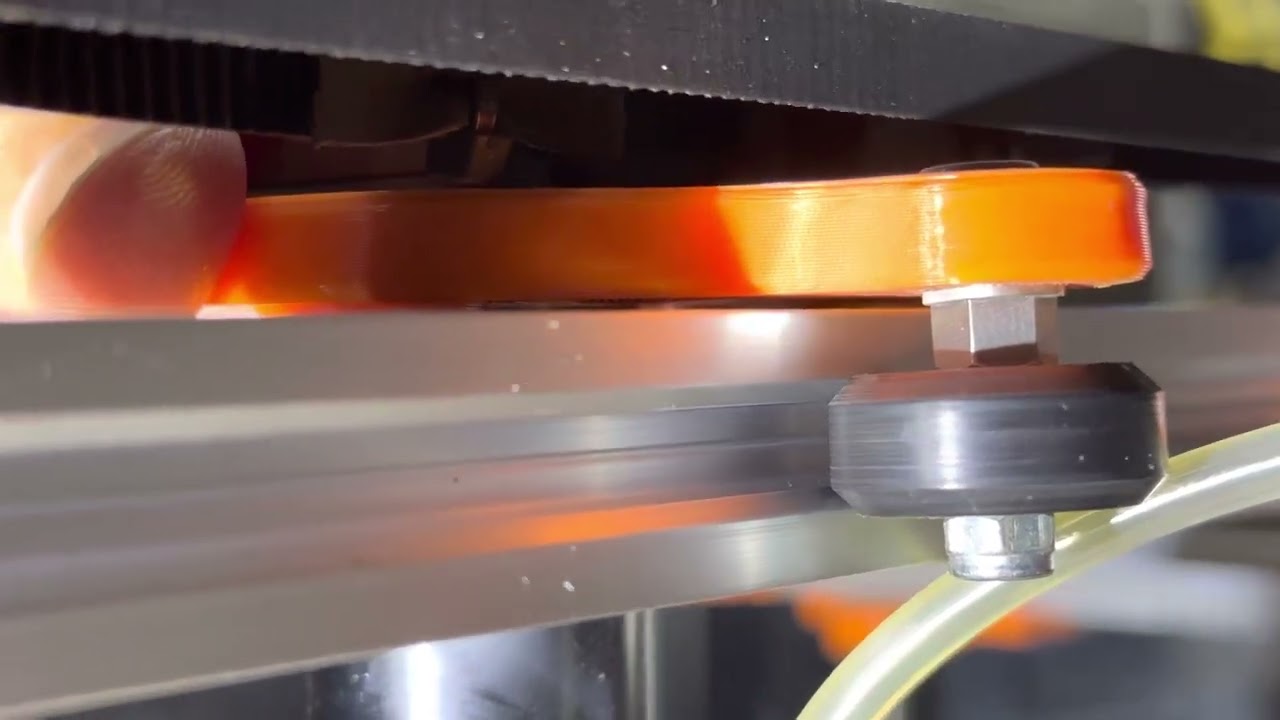

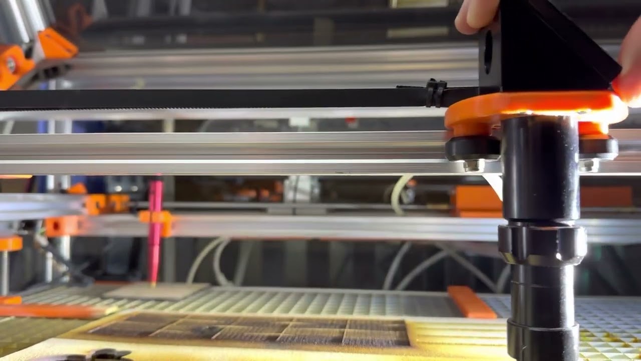

I cleaned up the X-Axis wheels and inspected them. I didn’t see any physical damage to the wheels. As I glide the gantry back and forth, I don’t feel an odd acceleration or wobble that might be caused by an oblong wheel. Do you have a better way to check for roundness?
Here are some videos of the actual X-Axis after I cleaned up the wheels…
To answer your question, the configuration file was given to me by Bart Dring himself. I’ve had multiple issues with the file I was given. I should have reviewed it more thoroughly. Doing a walk of shame to my laser to see if this is the issue…
This is 250mm/s 40% power 4% over scan with stealthchop enabled on the x axis. The x axis sound completely and entirely different running in this mode.

I have tried upto 7800 and didn’t see any differences. Never thought to go up to 50,000. Trying now…
Here is 50,000 hz with at least two different stepper modes. I don’t think FluidNC supports spreadcycle, but it didn’t throw an error when I loaded it into the config so I ran it.
The harmonics on stealthchop and spreadcycle are so much different than coolstep its wild. Crazy what software can do.
Overall though it seems like 50,000hz is what is making the big difference. Not calling this solved until I burn at least 50 ornaments without seeing this pattern re-emerge.

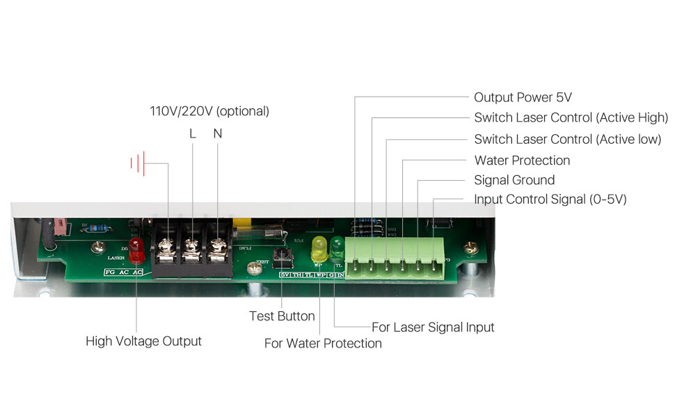

I think there are two ways.
The general idea is that you hook a 1K or 10K linear potentiometer across signal ground / input control signal / output power 5V
Then I think I’ve seen two ways to connect PWM:
  1. connect an open drain control signal to the input control signal
  2. connect the PWM control signal to the appropriate switch laser control line, either high or low
I would trust @donkjr to know which is appropriate here and why. :smiling_face:
Here’s the labelled connections for this particular LPS:
