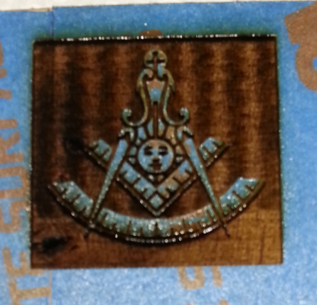

I have attached some images that show the patterns showing up in different incantations.
I did this burn that resulted in some curtains…
Followed by this burn immediately after which had no curtain’s whatsoever:
Here is the most intense curtaining I’ve seen come from the laser:

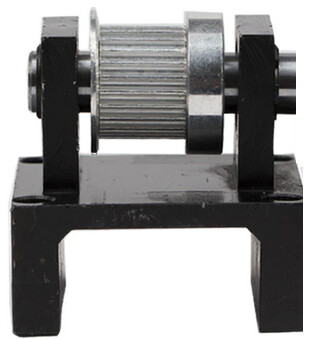

  • Resonances from the GT2 belt rolling over a smooth idler bearing - tried multiple things to

It’s hard to capture in a photo, but the lines seem to have gone from vertical to horizontal when I switched the scanning direction:
This is also very strange. Last night while doing some burns, one burn came out very nicely. After blowing it off with come compressed air, this seemingly perfect sine wave was revealed. This one is a mind bender for me. No idea what to think about it.

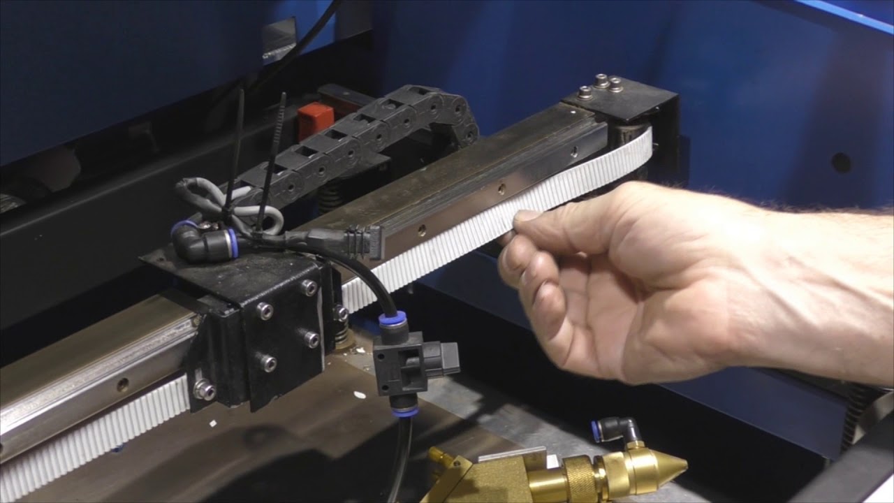

The wave form makes me wonder about broken cords inside your belts. Do you have steel core or fiber core belts?
It appears to be fiber to me. The amazon product page doesn’t say, there is one question that is asked that happens to be if it is fiber or steel. It looks like a customer replied saying fiber.
A sampling of the variation that I see in my “curtaining”
It’s pretty obvious when you cut timing belt with steel cords in it, so you would have noticed. Less likely for fiber cords to have broken. That’s probably a red herring, sorry! I’ll go back to lurking…
