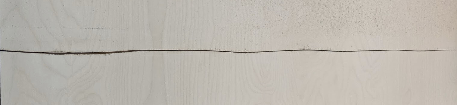

I have been using a plywood blade but I think it has seen better days. It’s a hollow-ground thin kerf blade, and the long-reach fence which makes it easy for the saw to get behind or ahead, rack, and not cut straight. (See also this thread; I’m not alone.). I think that the thin blade with no significant relief is also very susceptible to flexing. It rubs and heats and burns and I’m sure once that starts, it accelerates the dulling process. So time to throw it away. Here’s the evidence:

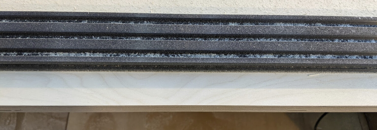

I tried the Diablo. (Fast shipping!) I had to put the fence against the short (outside) side of the sled because I don’t have low-profile clamps; the extrusion itself fits under the motor but not the clamps. Both of my remaining cuts were oriented to rip with the veneer, so more likely to tear out than the earlier cross cuts.
My first cut had one hair of tear-out (inconsequential) and some light scorching in a few places. I pushed the second cut faster and had no perceptible tear-out and minimal scorching; minor darkening of a few plys.
I think with a little more experience with feed rates I would not expect consequential scorching at all. Cut was true and smooth to the touch. Here’s a representative section with the fence still in place:
I’m satisfied.

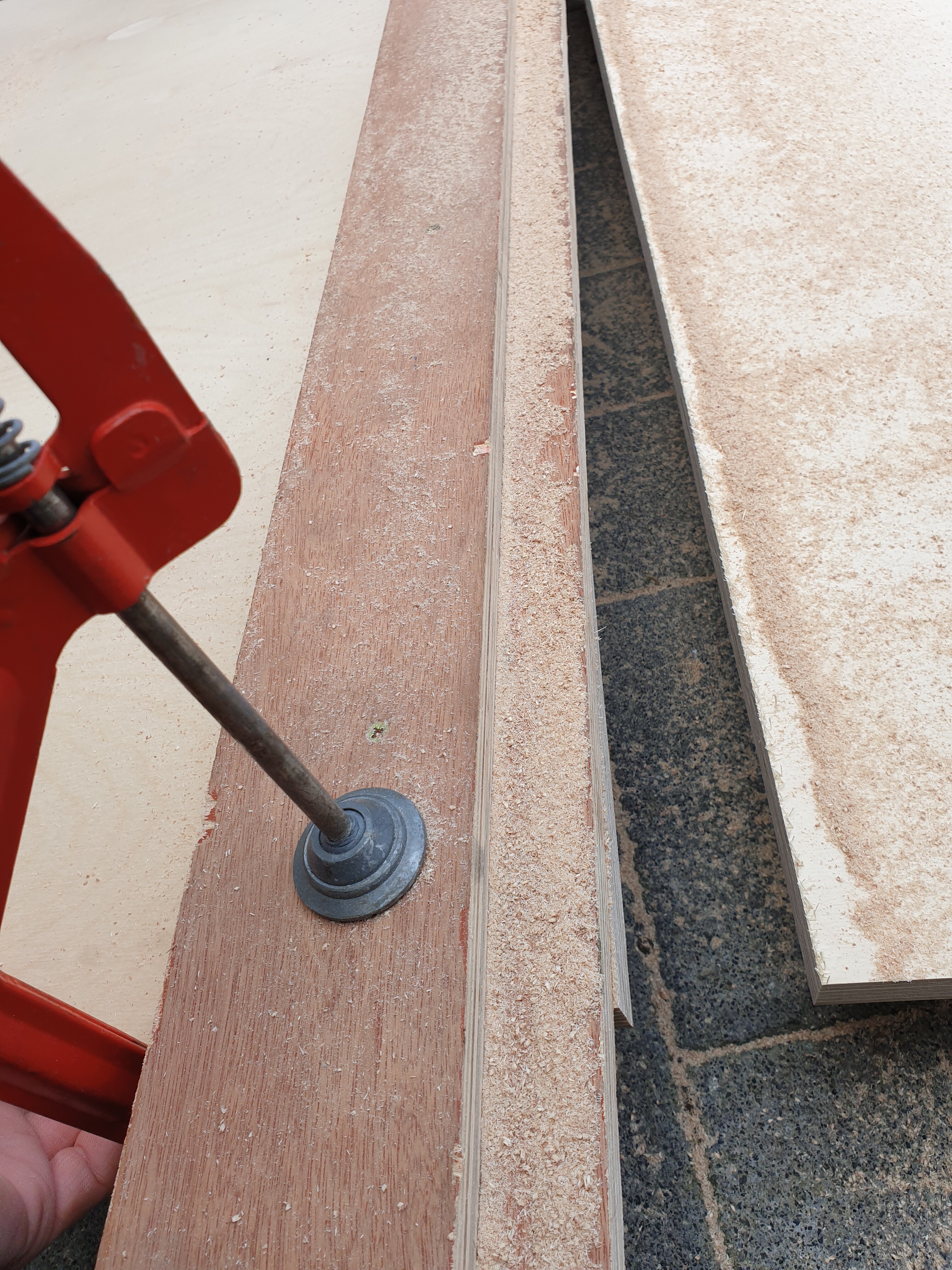

This is what I use. again I generally only use it to cut plywood up for the CNC but get a fairly straight cut.
Plus it’s cheap and quick to make.
Keep meaning to put a block of plywood under the unsupported side of the saw to get more support.
