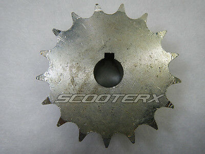

If I understand you are looking for some type of pulley/sprocket that is compatible with a 14mm dia D motor shaft? Of course, the type of drive system you want [chain, belt, etc] matters as to what exactly to search for?.
Did you notice that the motor manufacturer also offers motor and wheel sprockets?
Example: 11t Pitch Motor Sprocket for a MY1016
Strangely I could not find the size of the bore on any of their sprockets?
I would email them and ask them for help in finding a compatible motor and wheel sprocket et.

One thing to be aware of is that mounting a pulley against the fan can block cooling air flow if it’s too big. I think that the sprockets that @donkjr found are more what they have in mind. I’ve seen DD sprockets and I think timing pulleys before, but as far as my recollection goes they have only been plastic.
As long as it’s small enough, any 14mm pulley will work if you can drill holes for set screws (grub screws) in it, or if it comes with the holes already there. With the DD shaft you want opposing set screws.
Note that for a pulley with a keyway, you could cut key stock to fit the keyway down to the face of the D cut on one side, but I’d expect that to have play and for that play to wear the shaft face, so it wouldn’t be my first choice.

The diagram does make it look like it’s a 14mm shaft but that is the distance between the flats. The shaft is 17mm diameter on the round sides. Closest sprocket or pulley I ever seem to find is 17mm diameter on the round side and 12mm on the flat side.
I took your advice to email them and they said they didn’t have any leads and my best bet was to get a local engineer to make something suitable.

Thanks, unfortunately the diagram isn’t super clear and the shaft is actually 17mm diameter and 14mm from flat to flat. I can’t find any pulleys or sprockets that fit those dimensions and the motor supplier suggested getting an engineer to make one would be easiest.
That’s a good point about airflow. I think using set screws could work and I have found sprockets with a 17mm bore and set screws at a right angle to each other but so far no opposing set screws. I may just drill and tap the second screw in the location I want.

Drilling and tapping a new hole is reasonable and shouldn’t be too hard.
Have you drilled into a convex surface before? Do you have experience tapping? If you already know how, that’s great, but if you haven’t done either or both of those before, happy to share tips to help you succeed! :relaxed:
