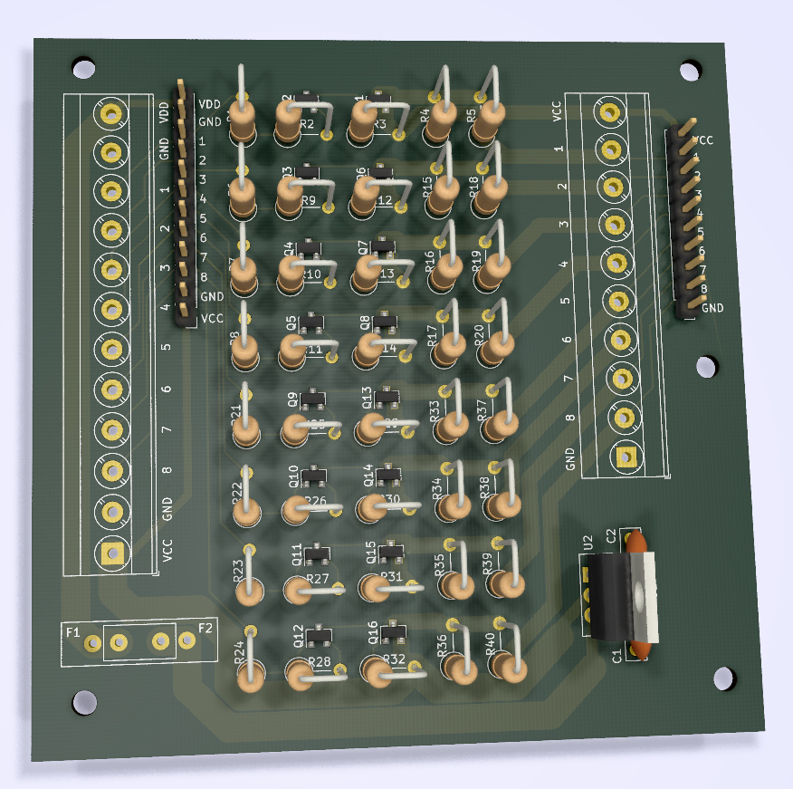

Designed an 8-channel high-side non-inverting switch board
I ran into a problem that the ESP32 couldn’t source enough current to reliably drive the LV8727; especially not two of them in parallel for the Y axis on my router. The LV8727 are common-positive, so I can’t just invert the signal and use n-MOSFETs to switch ground.
Even if I switch to opto-isolated TB6600 drivers and invert the logic signals, I still have to drive the opto-isolators, and that would require the enable GPIOs on my ESP32 to source about 70mA; just too much. The LV8727 will drive higher voltage to the steppers (45V) which gives me more headroom; one more reason to make a high-side swith.
I kept thinking there must be an inexpensive part to just buy to solve this problem, but I didn’t find it yet. (Yes, I know about typical MOSFET/resistor level shifters, as well as integrated level shifters like the TXB0104 and TXS0108E; they shift voltage, but won’t source much current. Already went down that path.)
Hopefully posting this project will cause someone to tell me what I’m missing, and I can give up and buy something simple and cheap that I didn’t figure out how to search for.
I haven’t tested this. Not even breadboarded it yet. But I rendered it!
I’d appreciate circuit review.
Edit: Now with PDF of schematic, I guess not everyone keeps kicad around to look at random circuits. :relaxed:

I may misunderstand what you’re doing, but have you considered P-FETs for high side switching? This may just convert the problem to “well the ESP32 can’t sink that much either” but I don’t know.
The latter, but logic inputs on that are directly connected, no optos, and they are shared ground so I can’t use nFETs because GND is shared. I measured current at LV8727 stepper configuration information - #14 by mcdanlj - CNC Routers - Maker Forums at 40mA per pin at 3.3v. With four of them on a single EN line that’s trying to pull 160mA from one ESP32 pin, which… it turns out doesn’t work well. :roll_eyes:
That’s how I got into this in the first place.
This board holds channels of which each channel holds a pair of MOSFETs with associated needed resistors (current limiting, pull up, and pull down) to make a non-inverting driver. The nFET drives the pFET.
I went hunting for an example I didn’t create, so maybe this writeup is clearer?
I just made a PDF of my schematic.
I could drive pFETs straight from the GPIOs by inverting the signals in software, but I do need to have pull-up resistors that pull them all the way up or they won’t actually turn off, which means that the GPIO is exposed to full supply voltage for the pFET, which is at least 5V and in the general case (with this board I can drive other devices, so as high as 20V or 30V depending on the FETs I choose) could be higher. I’ve heard that ESP32 are tolerant of 5V with a large enough current-limiting resistor, but that might make it slower than using an nFET for gate drive, and if I use an nFET for gate drive I don’t have to invert the signals, so win-win.

That is not obvious to me at all… each line gets a mosfet connected to - (clk, -dir, -enb) and can be switched to ground. The fact that they share a ground is OBVIOUSLY irrelevant.
Something is wrong with my understanding as this situation is normal for stepper drives and I do not have this kind of input current problem and they all essentially work the same way using simple single ended drivers.
According to this datasheet, the logic pin input current is max. 70uA (micro!) at 5V and high level needs only 2V. This could by directly driven by the ESP32 without any problem.
https://www.onsemi.com/pub/Collateral/ENA1998-D.PDF
@cprezzi you are quite right. I thought that µA would have made more sense for logic level current. I wonder why I (thought I) saw much higher current in practice. I guess I must have accidentally selected µA instead of mA range on the meter, and then read in the datasheet what I thought I had seen? I normally start with a higher range and then go down to lower ranges when measuring current.
Seems clear that my next step needs to be to again measure current.
