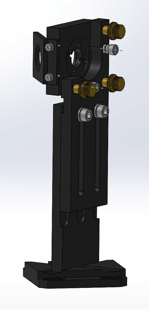

I would just get a head from cloudray. Wanted to do this on my K40 but it would not fit.
