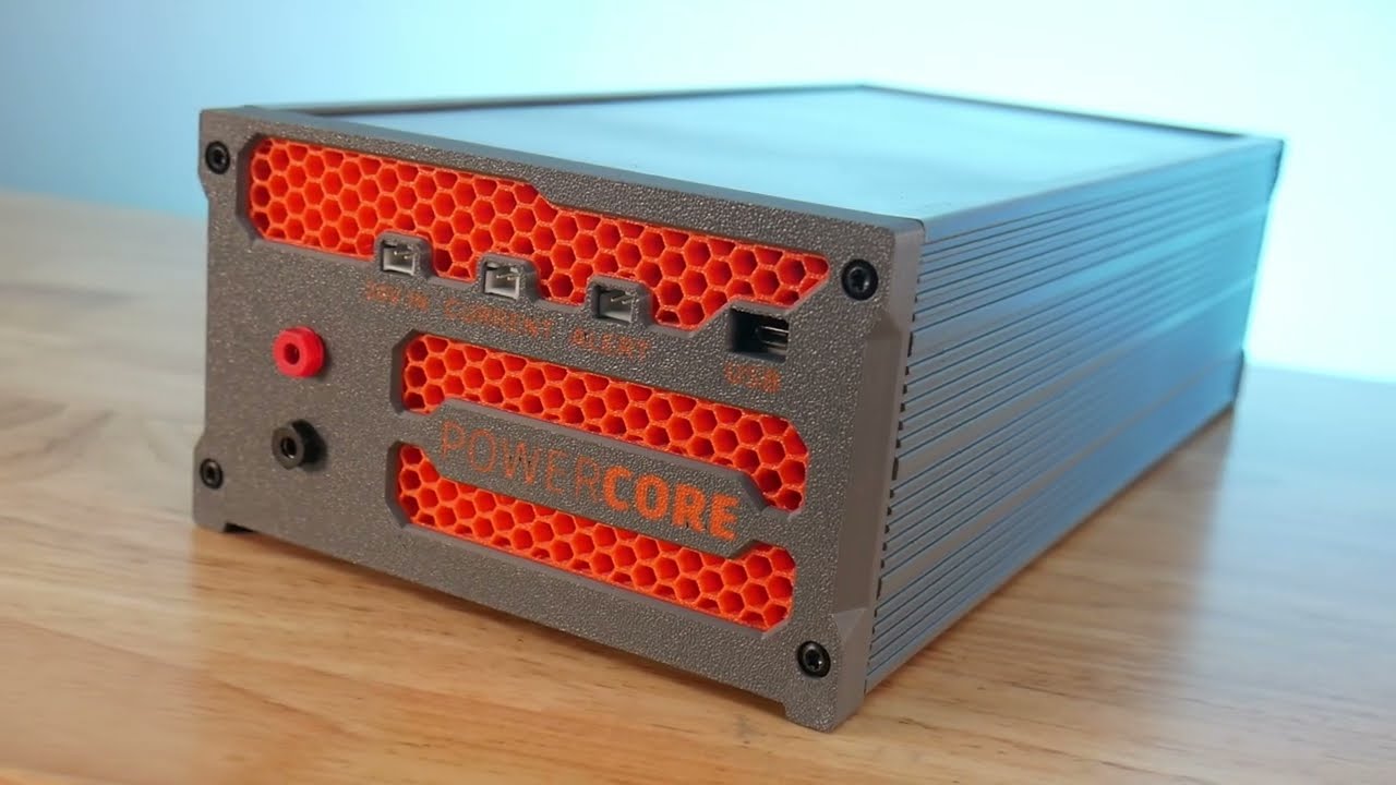

OK, so this is basically an inexpensive EDM power supply which to be fair is the hardest part. :smiley:

I don’t think I can link to a comment, but quoting the designer:
The specs for the Powercore are simple: 72 Volts, and it comes pre-programmed for 2 Khz with a 80% duty cycle. Those settings are optimized for cutting aluminum. We do not recommend using steel or titanium yet. Thin aluminum is recommended because it minimizes the required water flushing. With a wire mechanism, and good flushing, you should be able to machine much thicker aluminum. We have not tried this yet. However, Dominik Meffert has used a similar power supply design (60 volts, 2 Khz, 80% duty cycle) to do wire EDM.
The fastest we have cut thin aluminum (0.5 mm) is 15 mm / min. We generally stick to 8 to 10 mm / min. Cuts succeed 50% to 80% of the time. We use a 1/16" brass electrode (1.5 mm). We have a gcode post processor to compensate for electrode wear by moving the electrode down as the cut progresses. With this method, you can cut a length of 800 mm of aluminum with 40 mm of brass rod.
Given that my interest would be more steel than aluminum, I think I’ll pass…

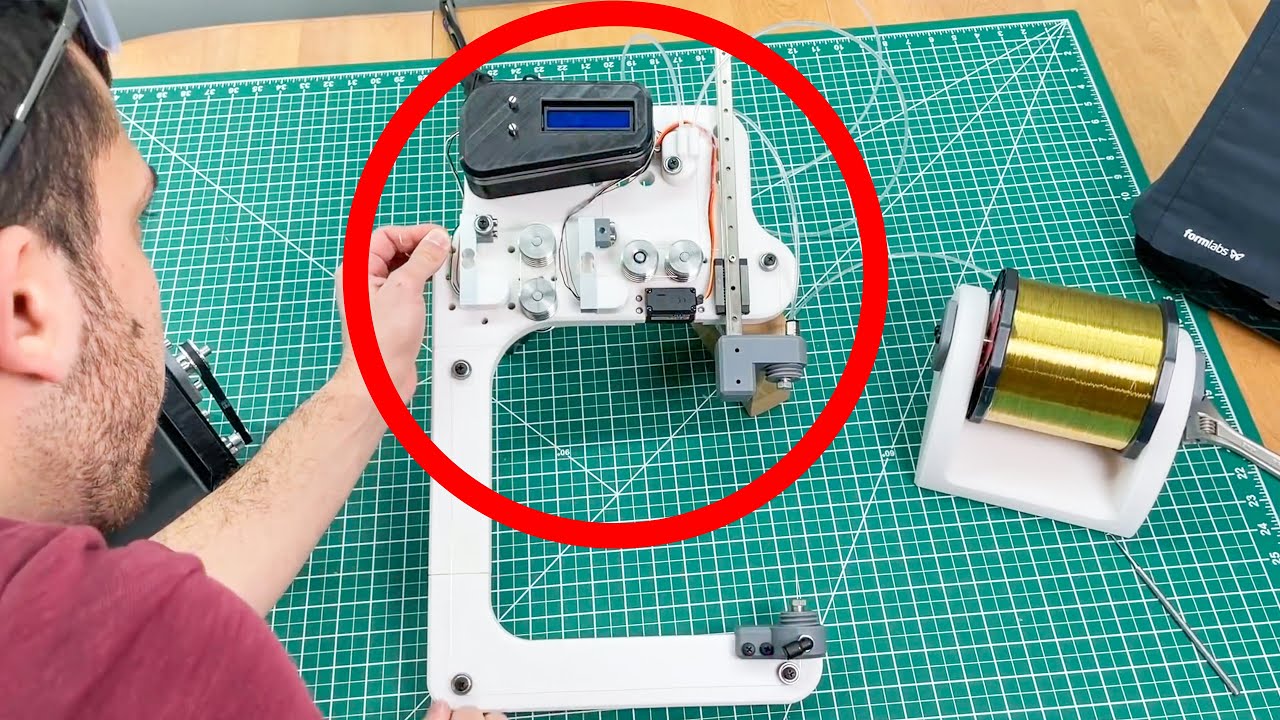

steel and SS are possible but here’s a wire version which still needed some work:
Since you have a CNC machine @mcdanlj this design might be of interest.
The FAQs said that the power supply voltage was fixed, and chosen for aluminum, which was what I was referring to.
And yeah, wire EDM seems more interesting.
