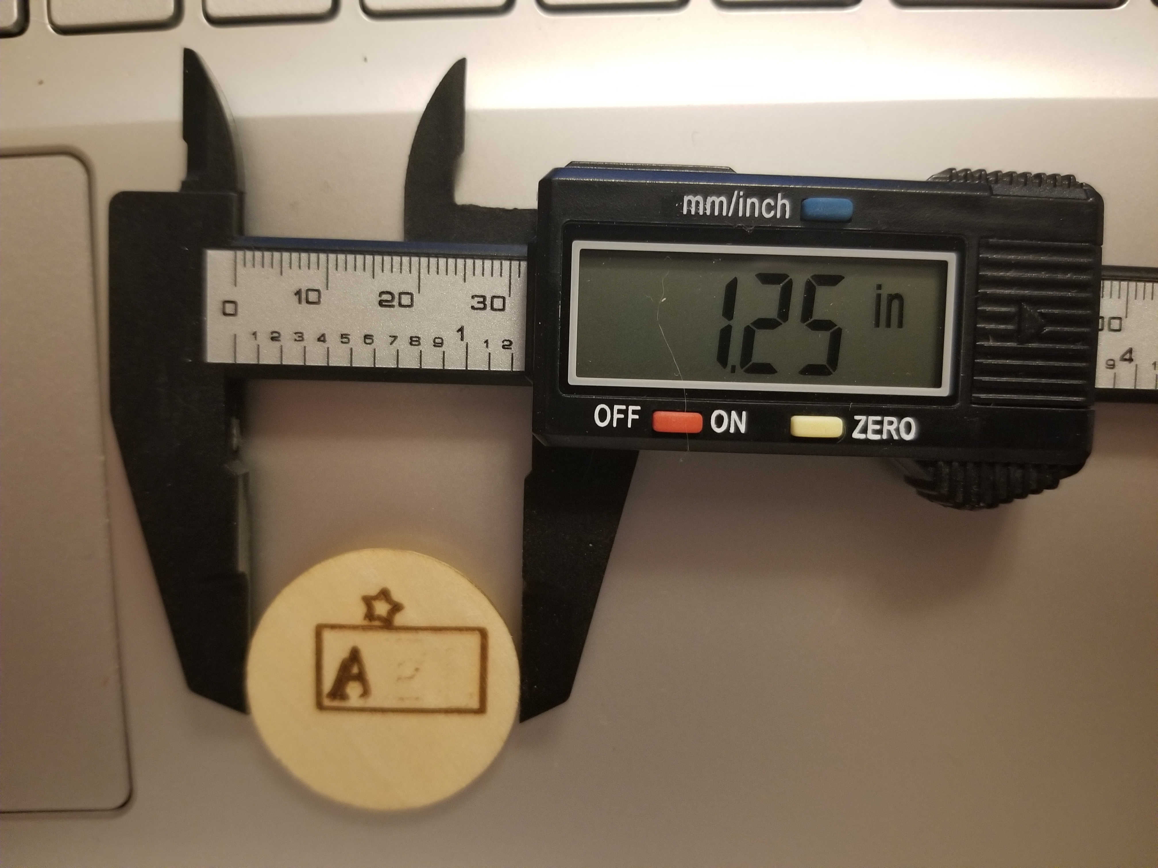

Our machine arrived last week, and the next few days were spent setting up the water cooling system, inspecting all of the wiring and mechanicals, tidying up the inside, and aligning the mirrors. I also went with Inkscape and K40 Whisperer instead of the native software. Not being familiar with Inkscape and only having watched a basic tutorial everything was being output as rasters. I was running very small tests, a few letters and shapes on 1.25" 3mil wooden disks. After I finally figured out how to properly set up a file for vector engraving, I started the next test.
(the “ghost” image is from a prior unsuccessful test)
It got as far as the rectangle, star, and most of the A in AEL, then completely turned off. There were no alarming sounds, no odd smells, no flashes or anything that would lead me to believe that an arc had occurred. I have checked all of the wiring that I can see, all of the circuitry, the fuse at the plug, and the integrity of the laser. All seem normal. The water cooling was still running, and the surge protector was unaffected.

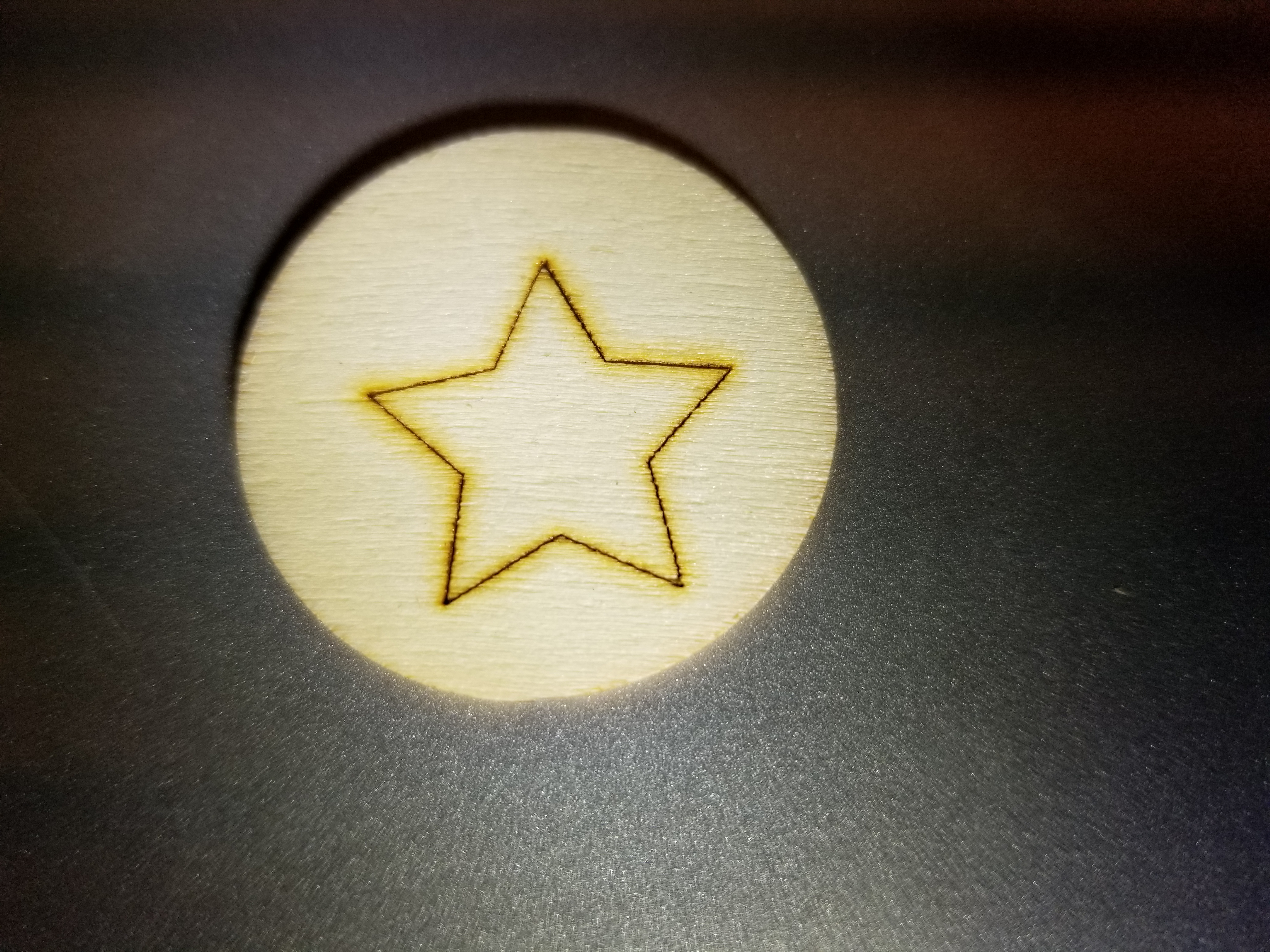

Sample of a test before the down time:
