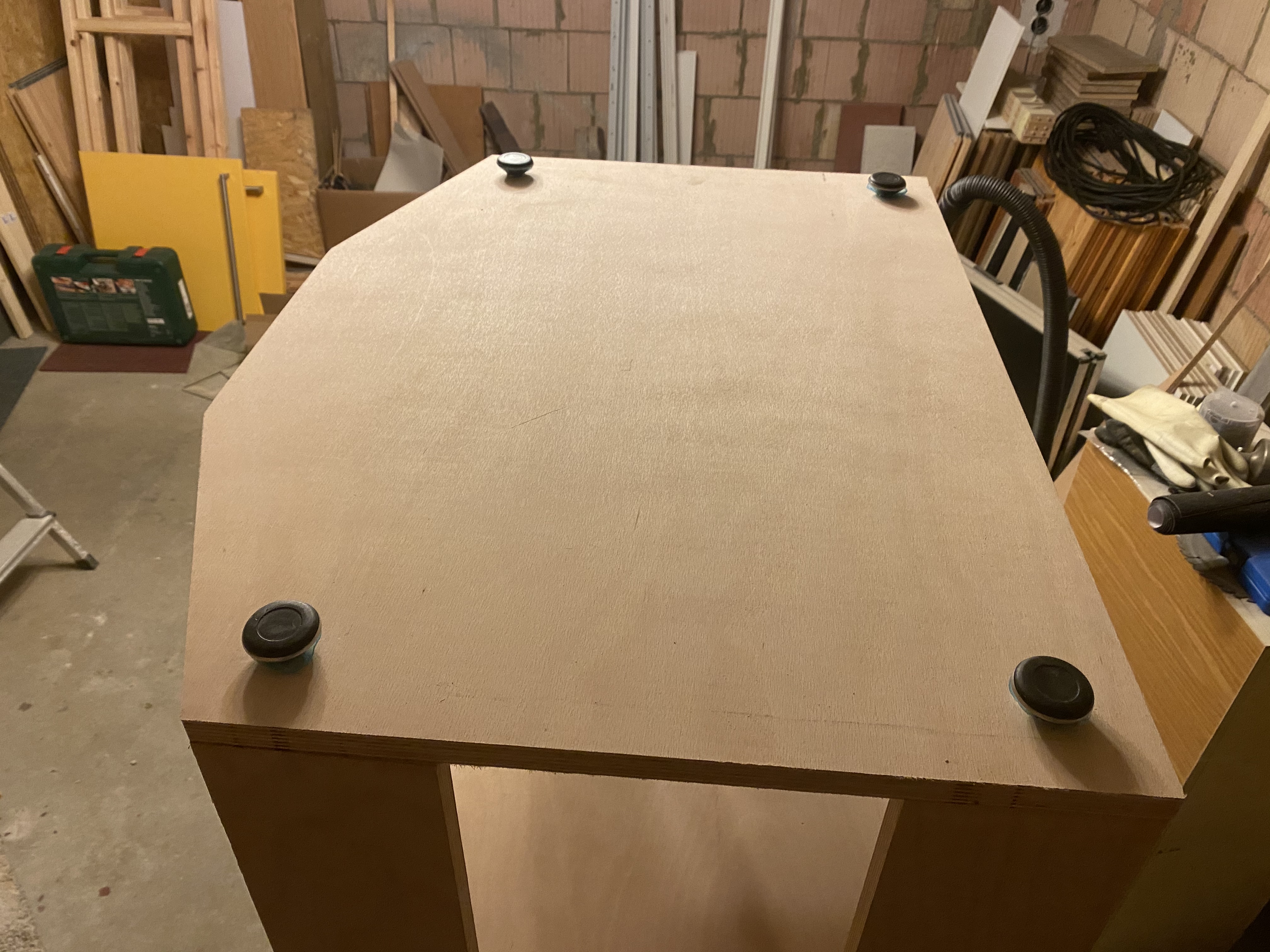

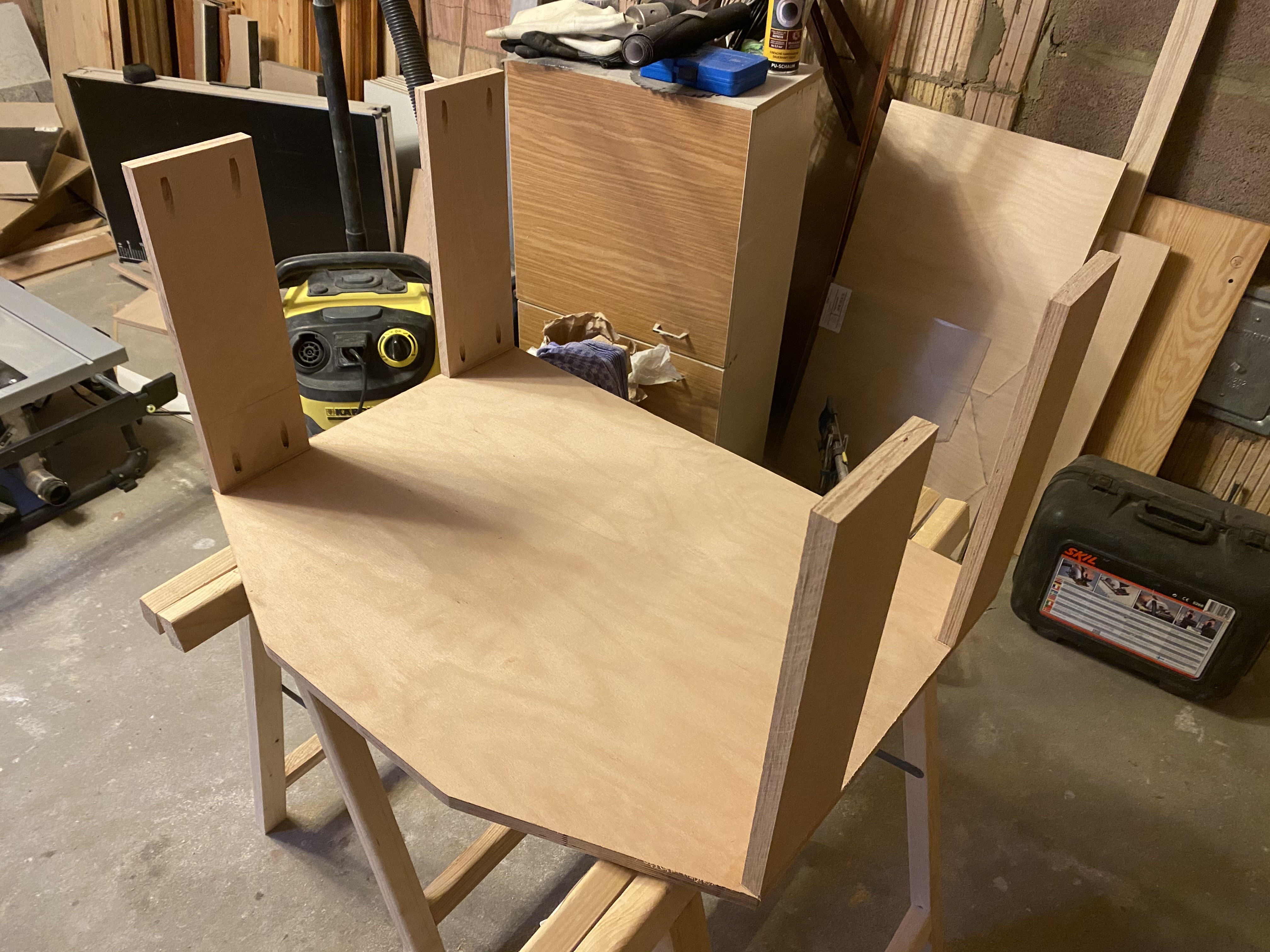

At first, I build the base of the cabinet. (I went with a 3 piece design, so it would be easier to transport the whole thing)
I made it from plywood and with pocket holes. It isn’t beautiful, but it works in the end and is hidden inside the cabinet.
I also installed some leveling feet underneath, so I could adjust them if necessary.

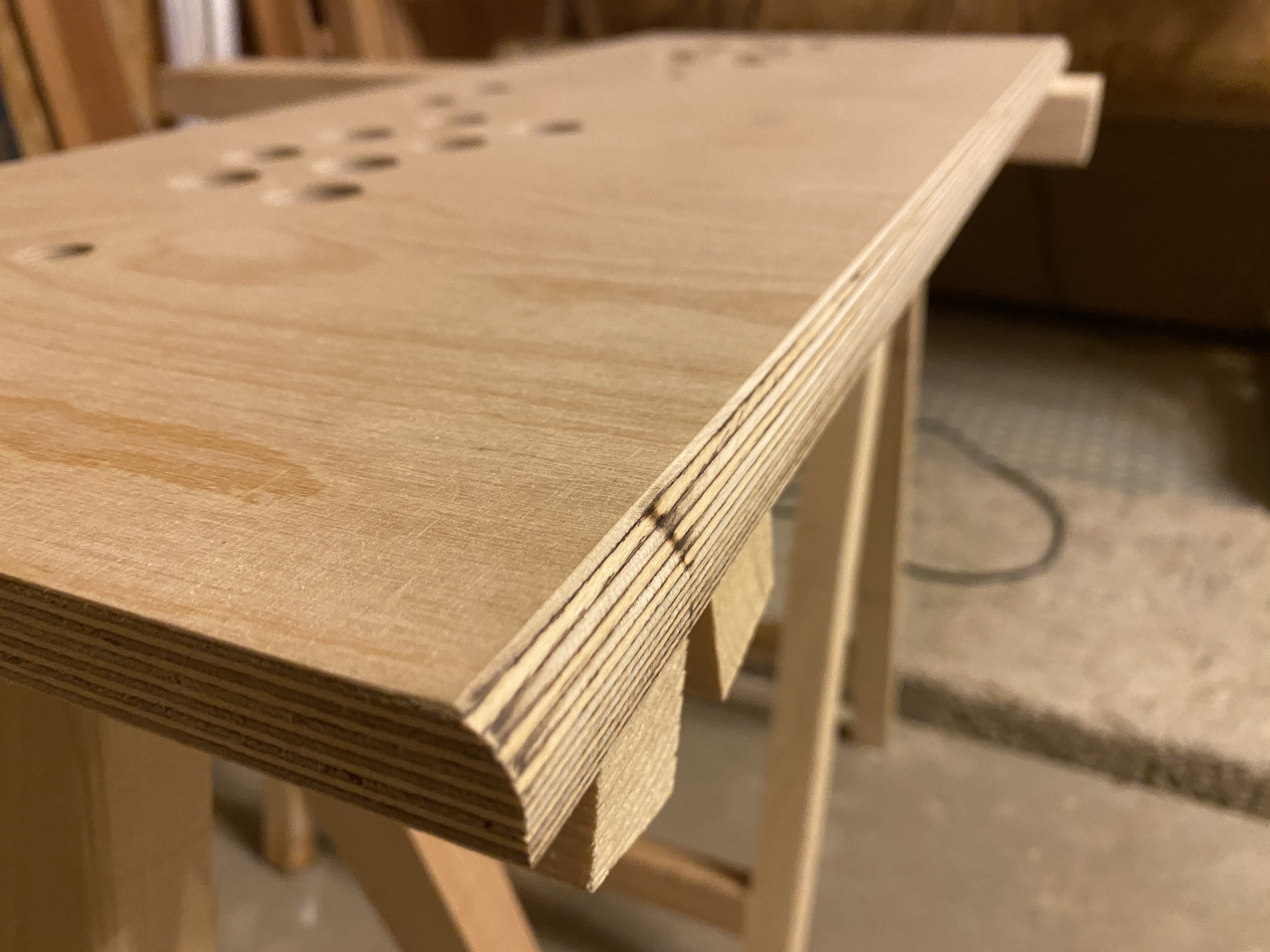

I found a controller layout online from existing cabinets and took one, which I liked for my machine. I printed it out and used some spray glue to adhere it to the cover, so I could drill out the holes.

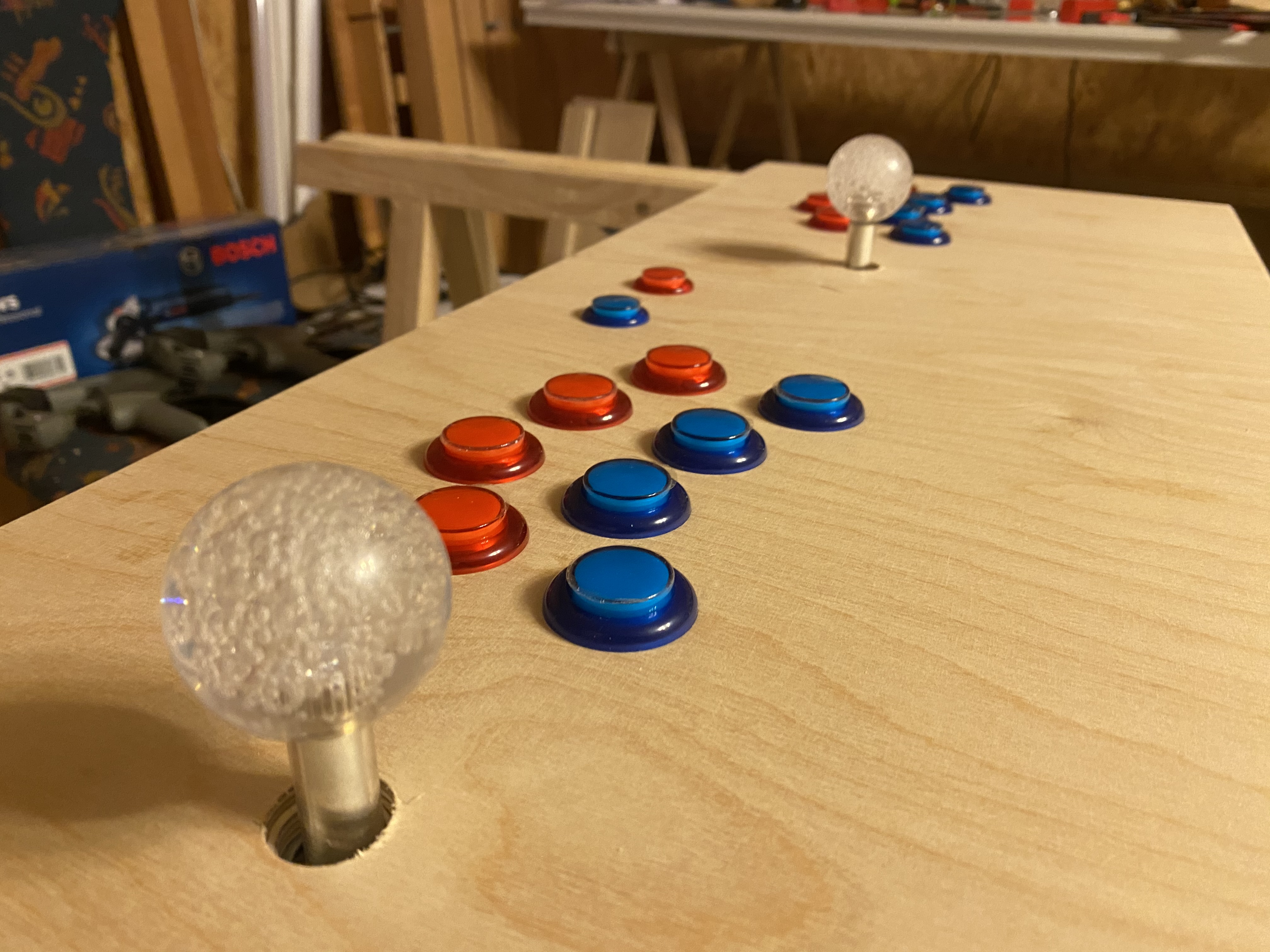

After drilling, I roundover the edge with the palm router and testfitted the Buttons and Joysticks.

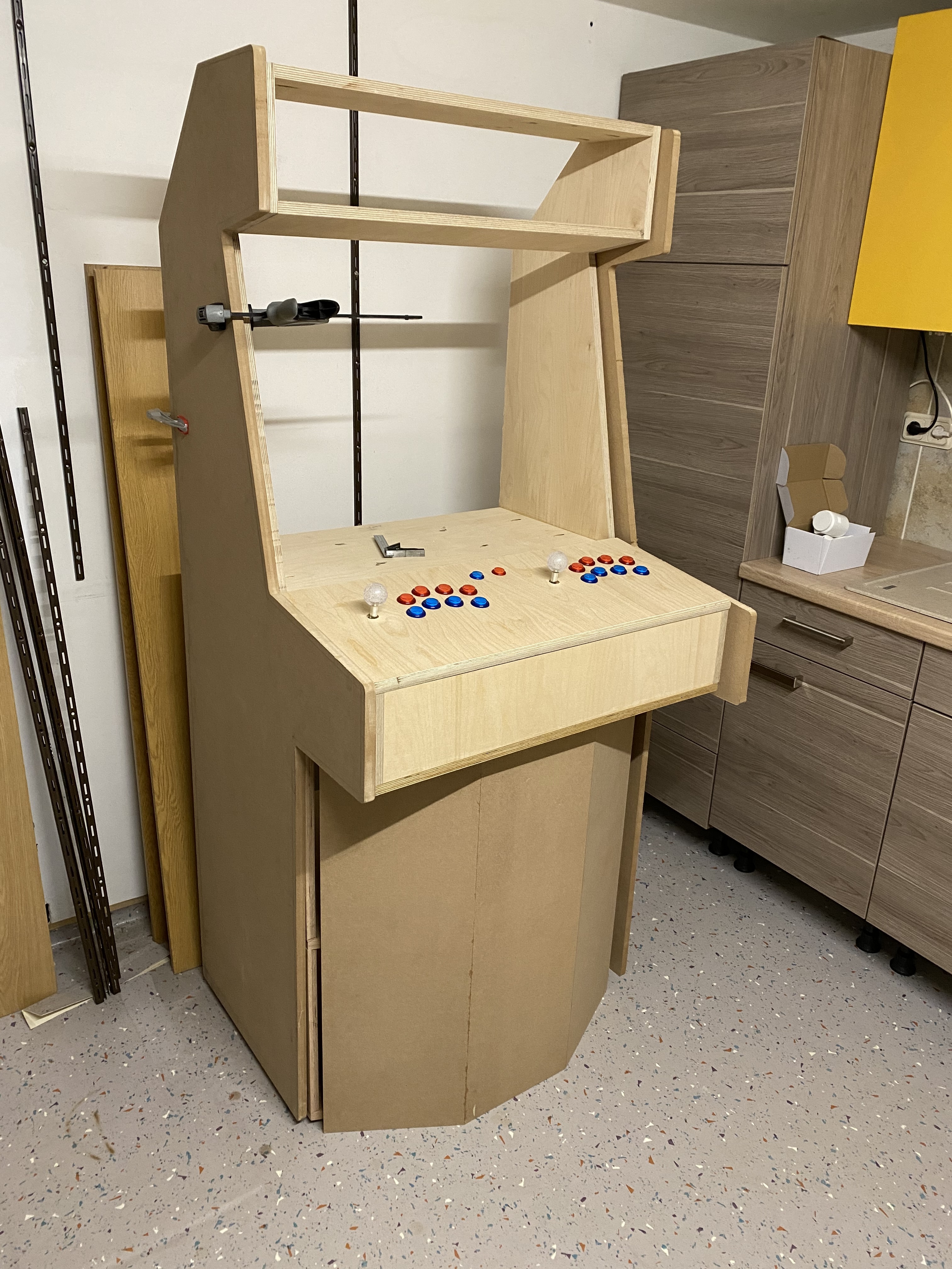

And like with everything, you just have to put it temporarily together to get a feel for the whole thing. :wink:

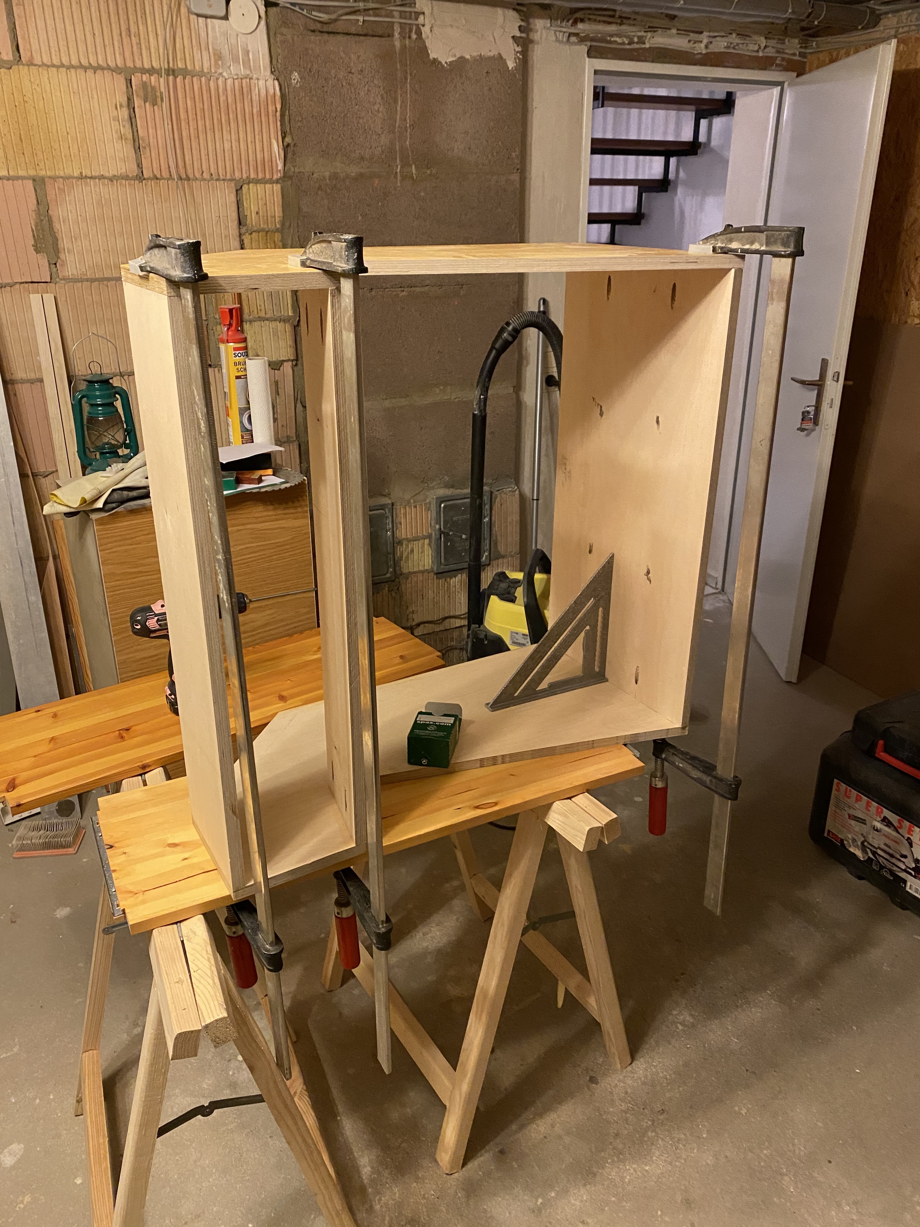

And the third part of the design. marquee and monitor (upper) part:

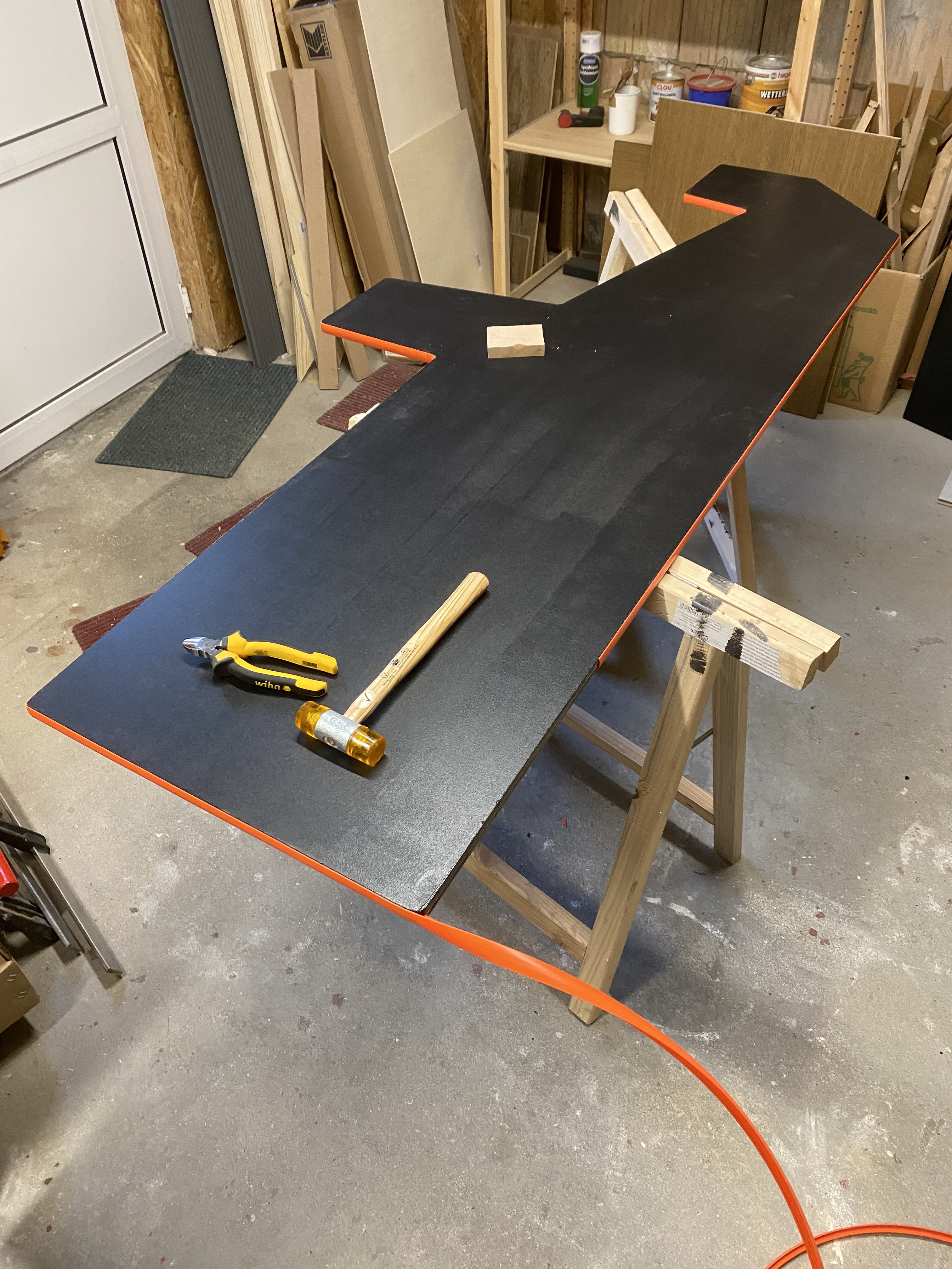

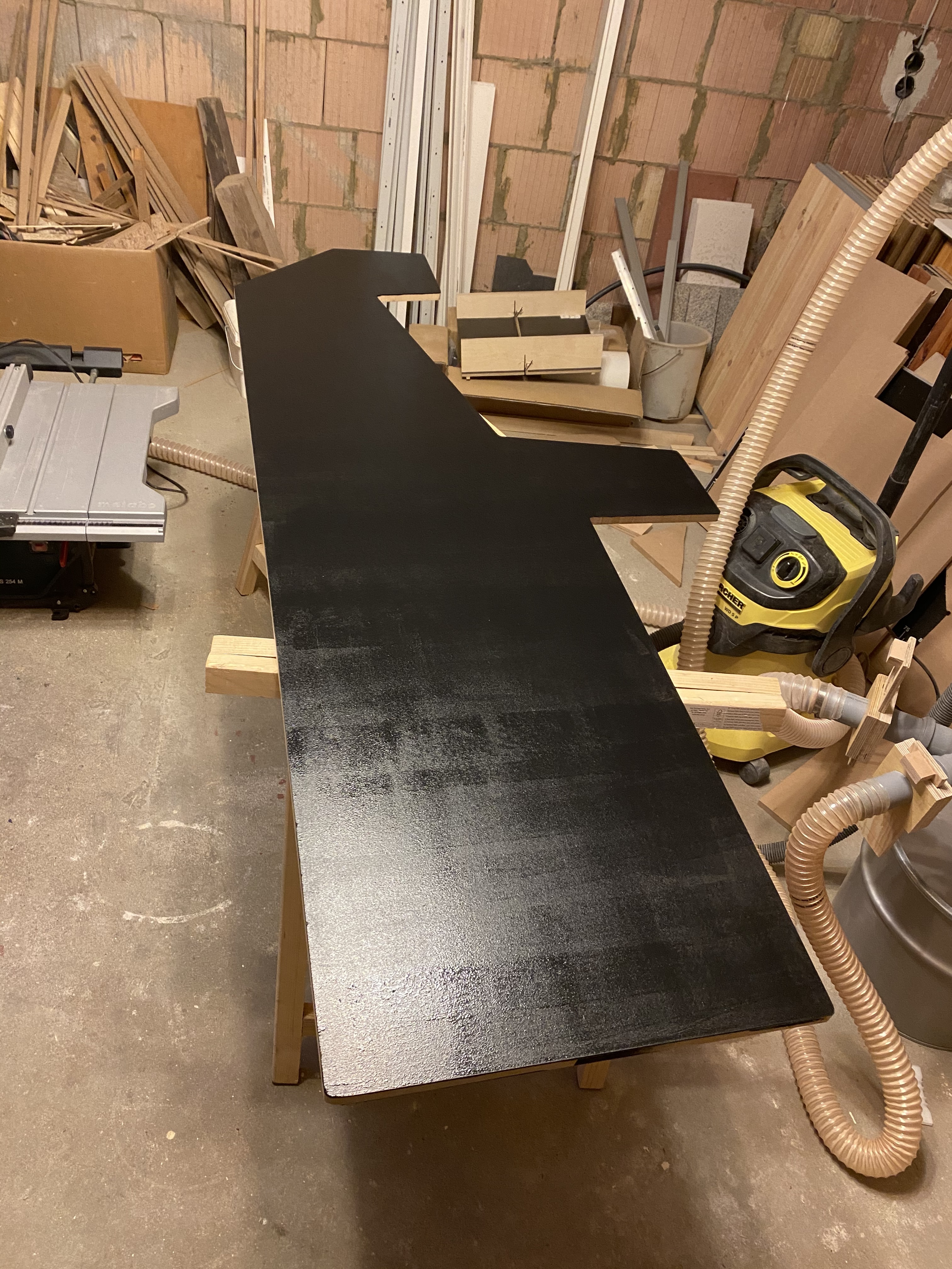

For the big side panels I put all three parts on the sheet of mdf and marked around it with some space (approx. 1-2 cm) from the body. Later I was lucky that I did that, because it ended fitting nicely and didn’t end up to short. To make sure I have two exactly identical pieces, I used a flush trim bit in my router.

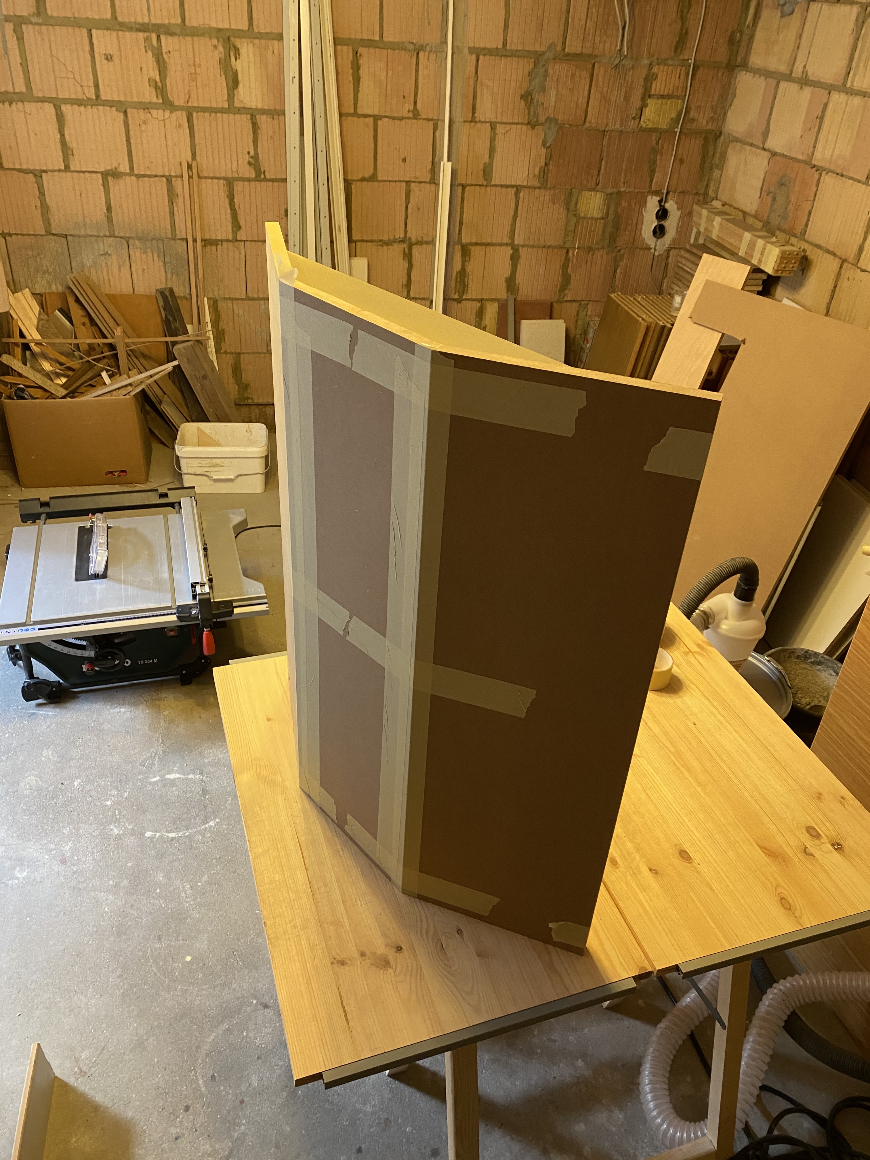

For the door in front of the cabinet, I wanted something more interesting then just a flat rectangular one, so I introduced some angles… which made me curse myself in the process :smiley: . Because the first version didn’t match the angles on the cabinet, since I did the math wrong. :exploding_head:
So, I ended up gluing up the door twice…

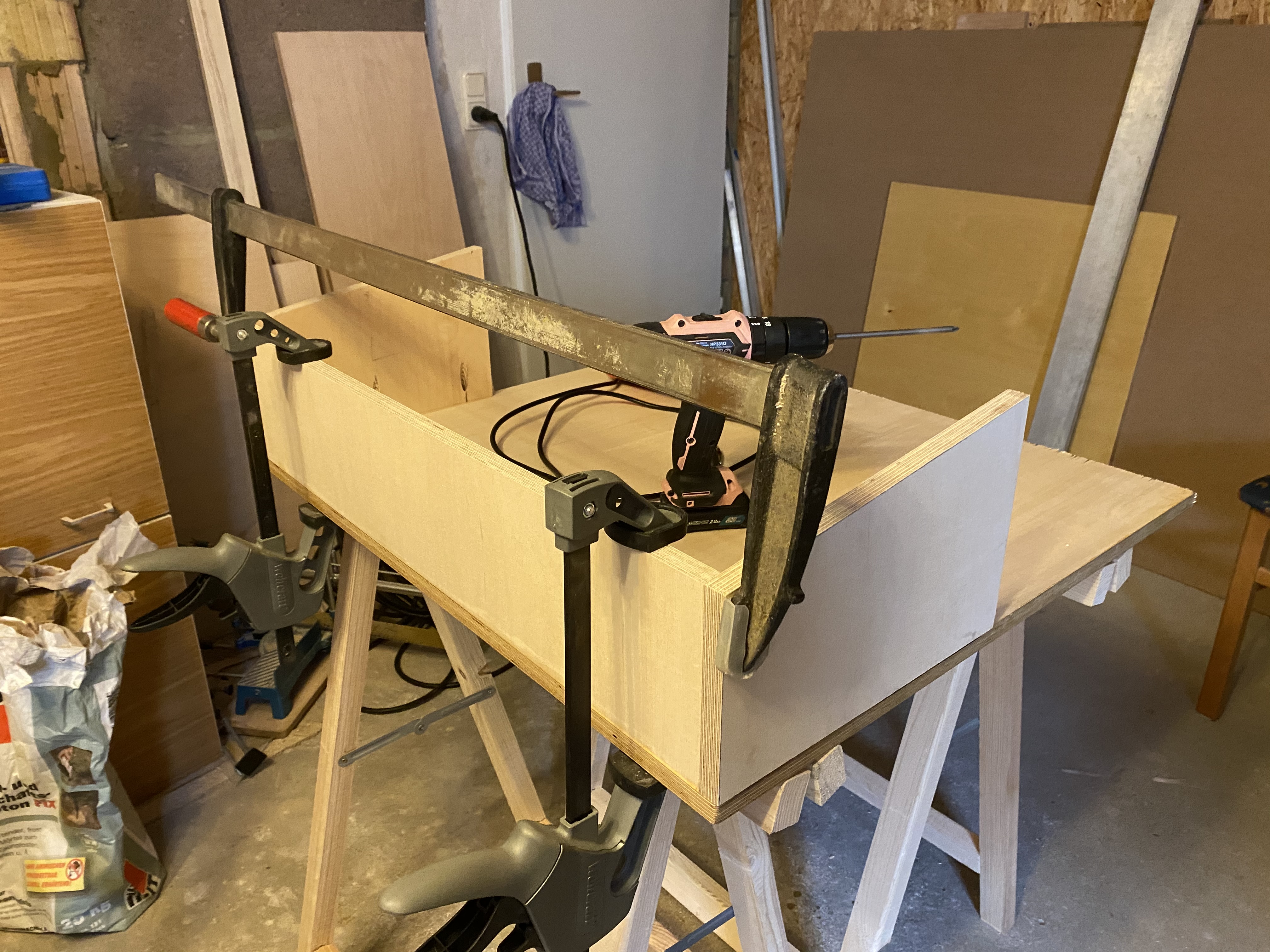

Next I gave the part of the controller box which would have to carry the monitor, a little more structural integrity. :wink:
I worked on a bezel for the monitor and test fitted everything in the upper part of the cabinet:

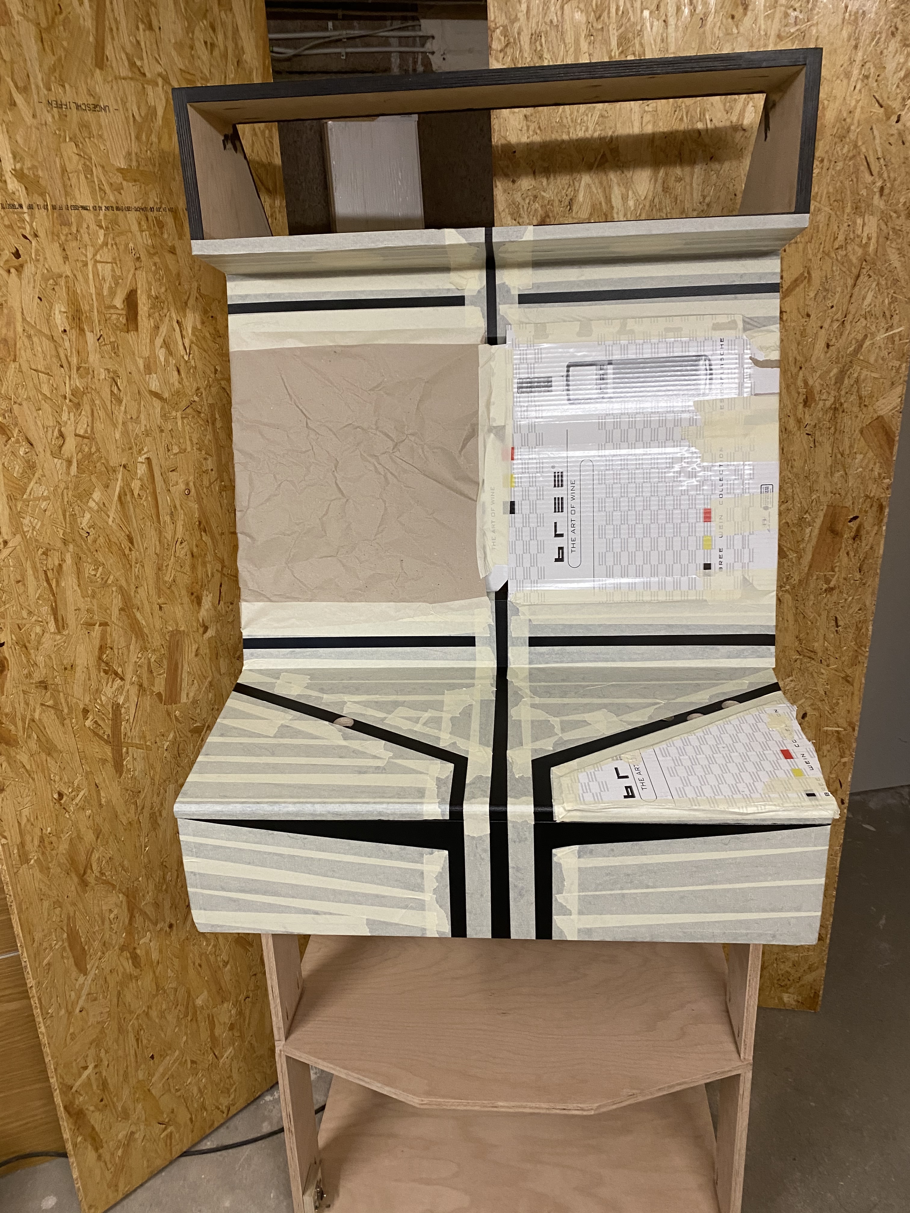

Then it was time to paint everything with a black primer/paint combo.
And for some accents…
The side panels got some T-moulding to protect the edges and give it a more authentic look. :smiley:

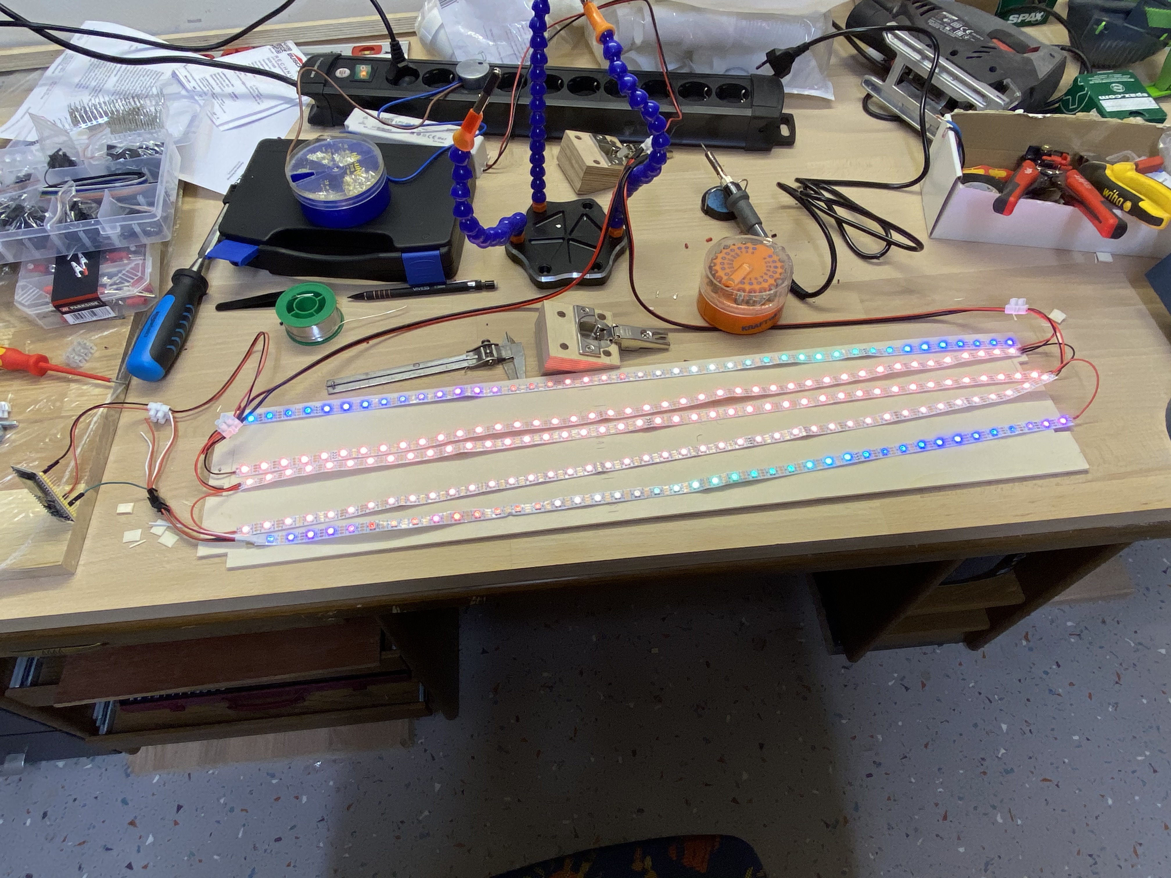

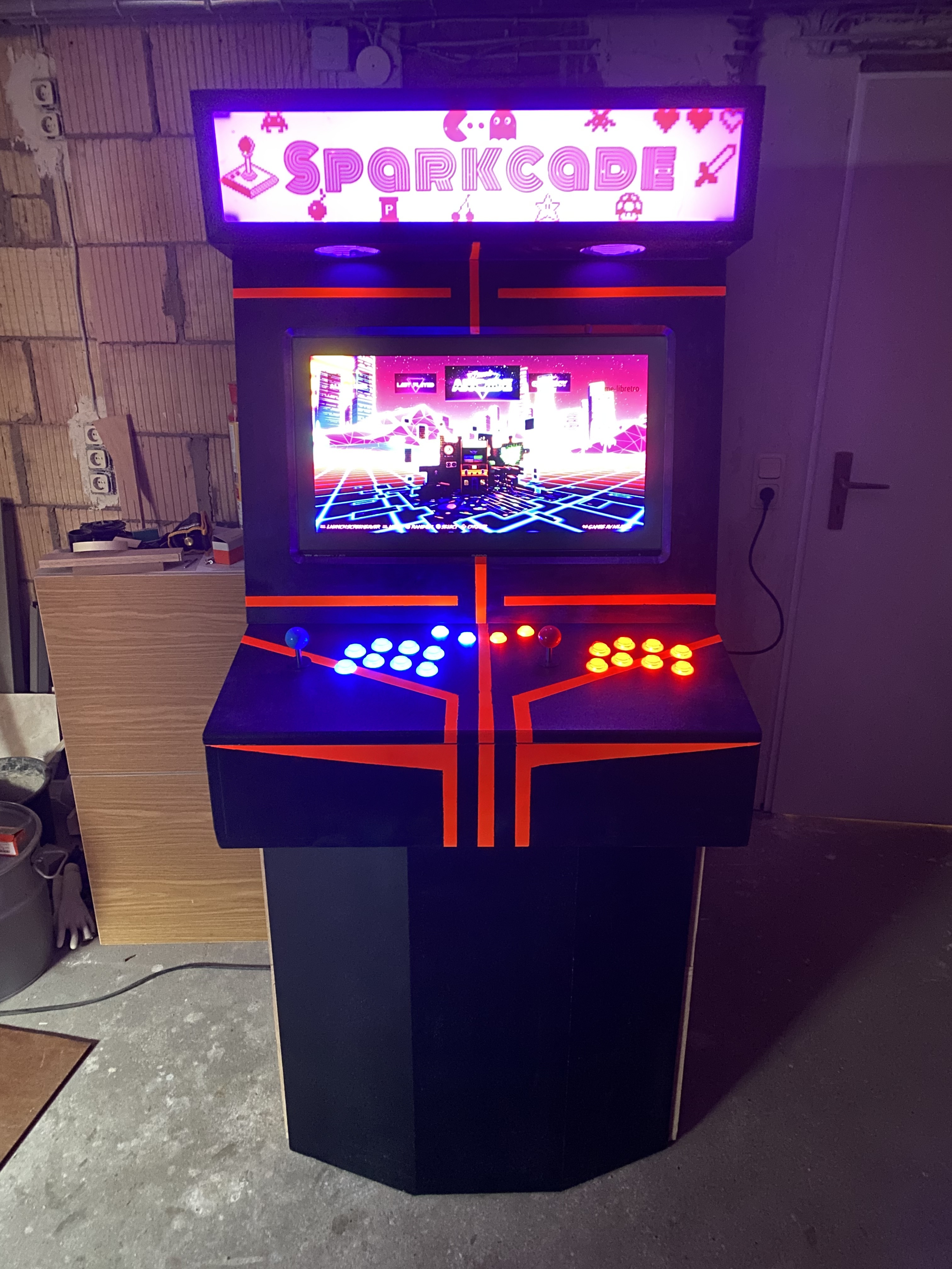

No arcade cabinet would be complete without a light up marquee. I used an esp32 and some neopixel leds to make my lights for the marquee.
Later in front of it I installed a white acrylic plate, which diffuses the lights and where I stuck my marquee artwork on.
I also wired all the buttons and joysticks:
And now it all just had to be assembled together… (one last test fit with the raspberrypi installed in the shop:

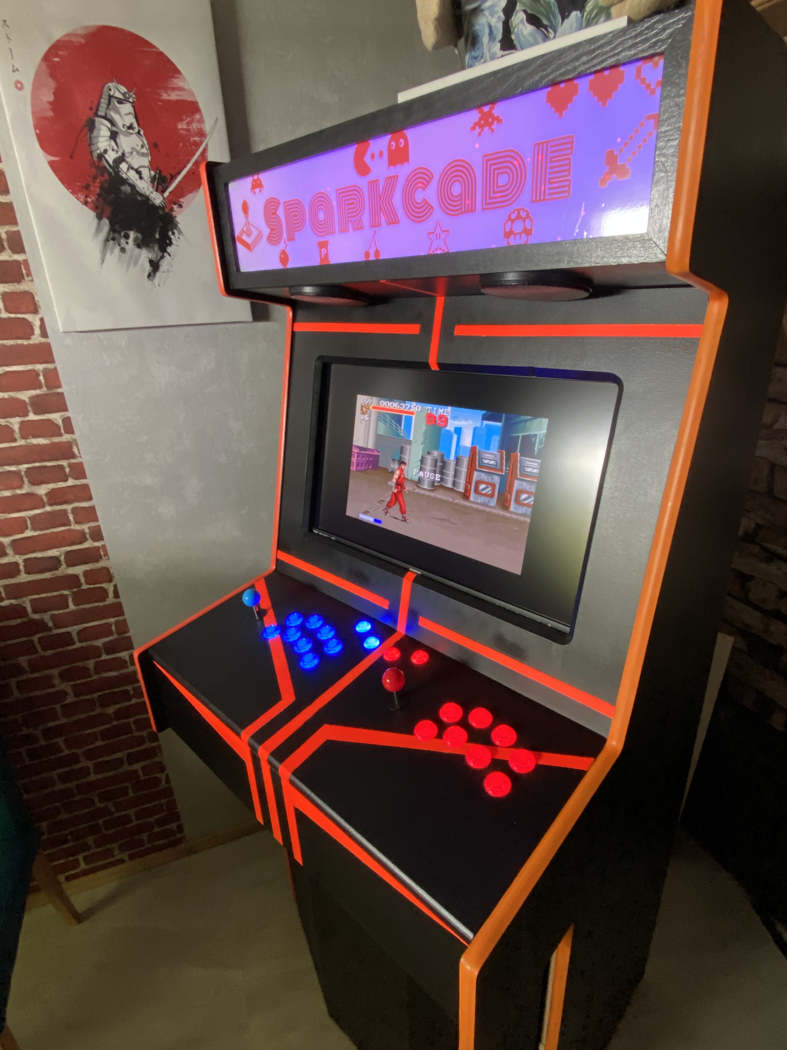

And at it’s final destination in my room:
